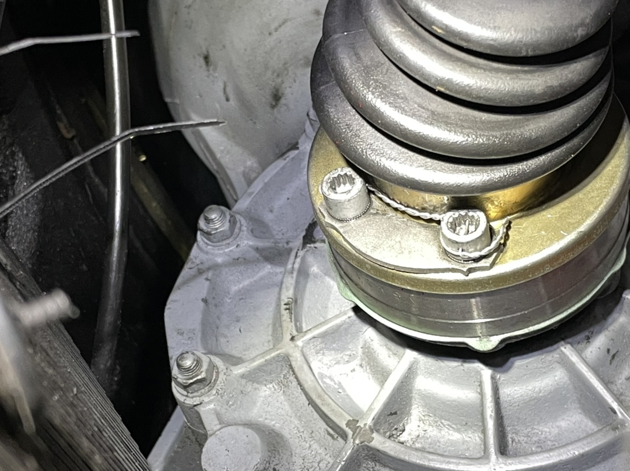

Are you missing the gasket between the CV joint and the transmission hub? 914.332.237.01.

QUOTE(Karl R @ Aug 8 2023, 08:05 PM) *
Karl,
Yes there is a gasket , its black not green so hard to see there, but there is a gasket. Got it torqued down , this must have worked loose on my last drive to C&C so caught it early , wasnt even that much grease slung too badly , not enought to want to repack them. I will get the bolts safety wired before driving again. That was lazy on my part on last install. It will be done,

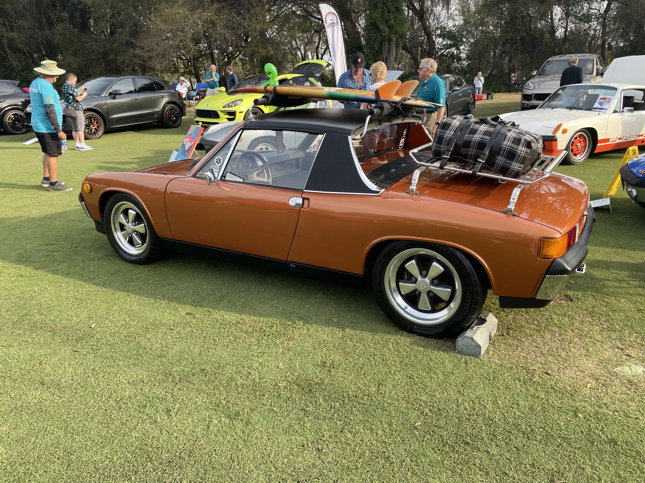

@DRPHIL914
Bitchen! (IMG:style_emoticons/default/smile.gif)
DRPHIL914
post Aug 9 2023, 08:47 AM
Post #484
Dr. Phil
Posts: 5,971
Joined: 9-December 09
From: Kennesaw, GA
Member No.: 11,106
QUOTE(Shivers @ Aug 9 2023, 10:26 AM) *
@Shivers
Thanks! that was a fun dayfor sure, BTW great picture! I like the rack but need to come up with a different way to mount it on the rear trunk the brackets are not the right angle and are made for a roof drip rail like on a 911, but for now i actually have thesuction cups from a bike rack bolted on, workse great but not classic looking.
Phil

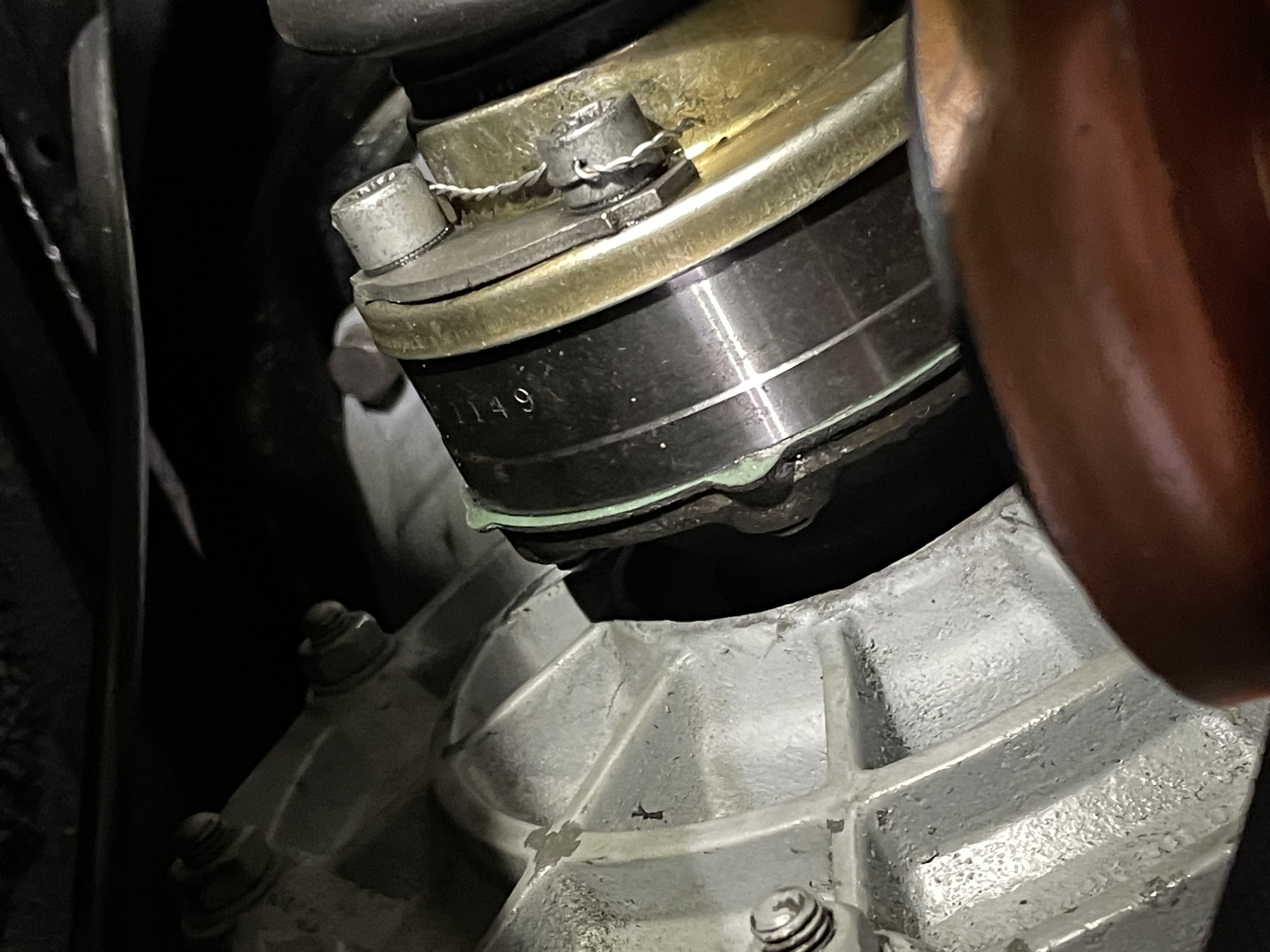

well i finally got around to putting new Schnor washers in the CV bolts and safety wiring them, but you were right, Karl, no gasket!! so now there is a proper gasket !
i will miles sure to check these after few drives but i think we’ll be ok now for trip to Townsend, TN next month!!
Phil

QUOTE(DRPHIL914 @ Aug 25 2023, 07:19 PM) *
Phil
Hey Phil, that looks great and I'm not busting your chops but the next time you safety wire those bolts do it in a fashion that the wire limits the bolts travel so that it can only turn clockwise. About 35 years ago an old WW2 A&P chewed my ass out for that. Not as critical in automotive applications but.....You can also reuse those Schoor washers since the bolts are safety wired. (IMG:style_emoticons/default/beerchug.gif)

QUOTE(76-914 @ Aug 26 2023, 12:28 PM) *
Phil
you are right, i did the other one correctly but that one should have gone into the bolt on the other side so that if the lower one did loosen as it spins counter clockwise it would tighten, this would keep it from coming out completely but it could do a half turn. i realized that after it was done lol. but the other one on that side and the side are correct.
Good eye and i can always appreciate some constructive criticism!!!
So now the next thing i do has to be putting new engine lid brackets on. my original ones are cracked and the right one is really flexing bad!!! i have to find a welder that won’t charge me an arm and a leg!

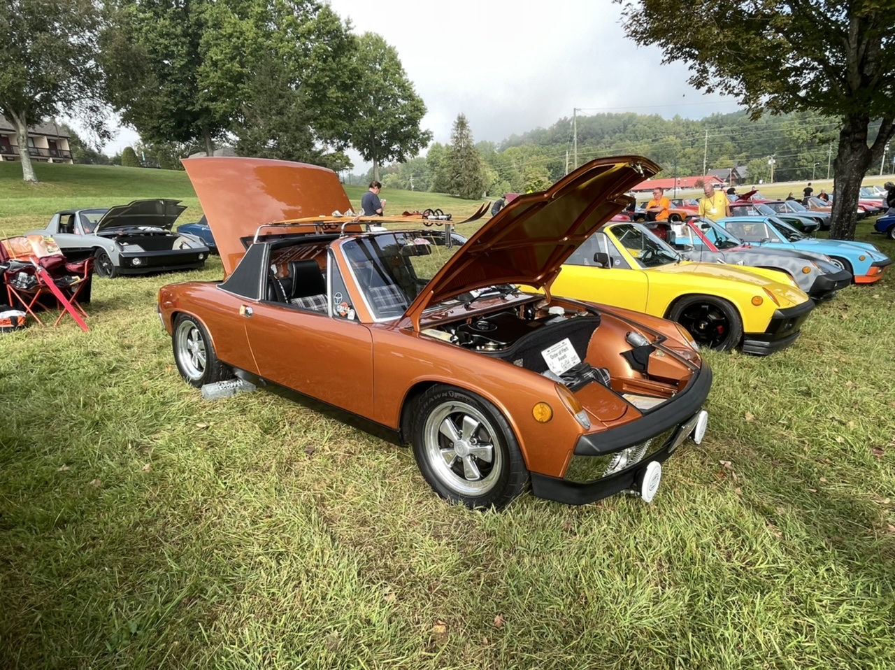

Tail of the dragon Okteenerfest 2023-
new fuse board,
-awards!

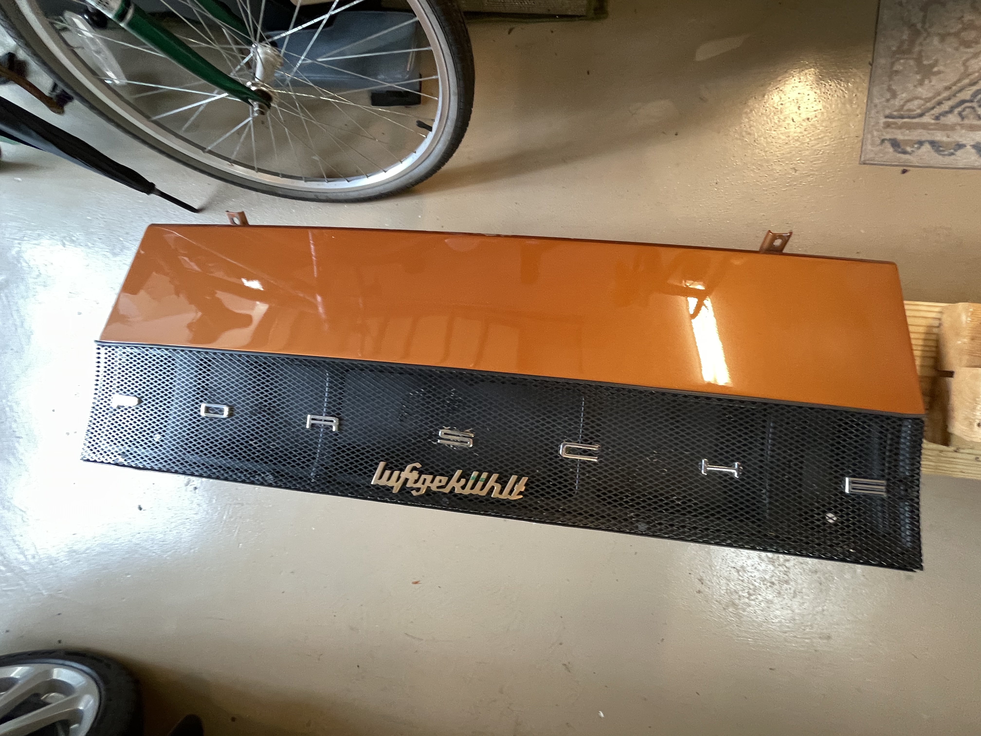

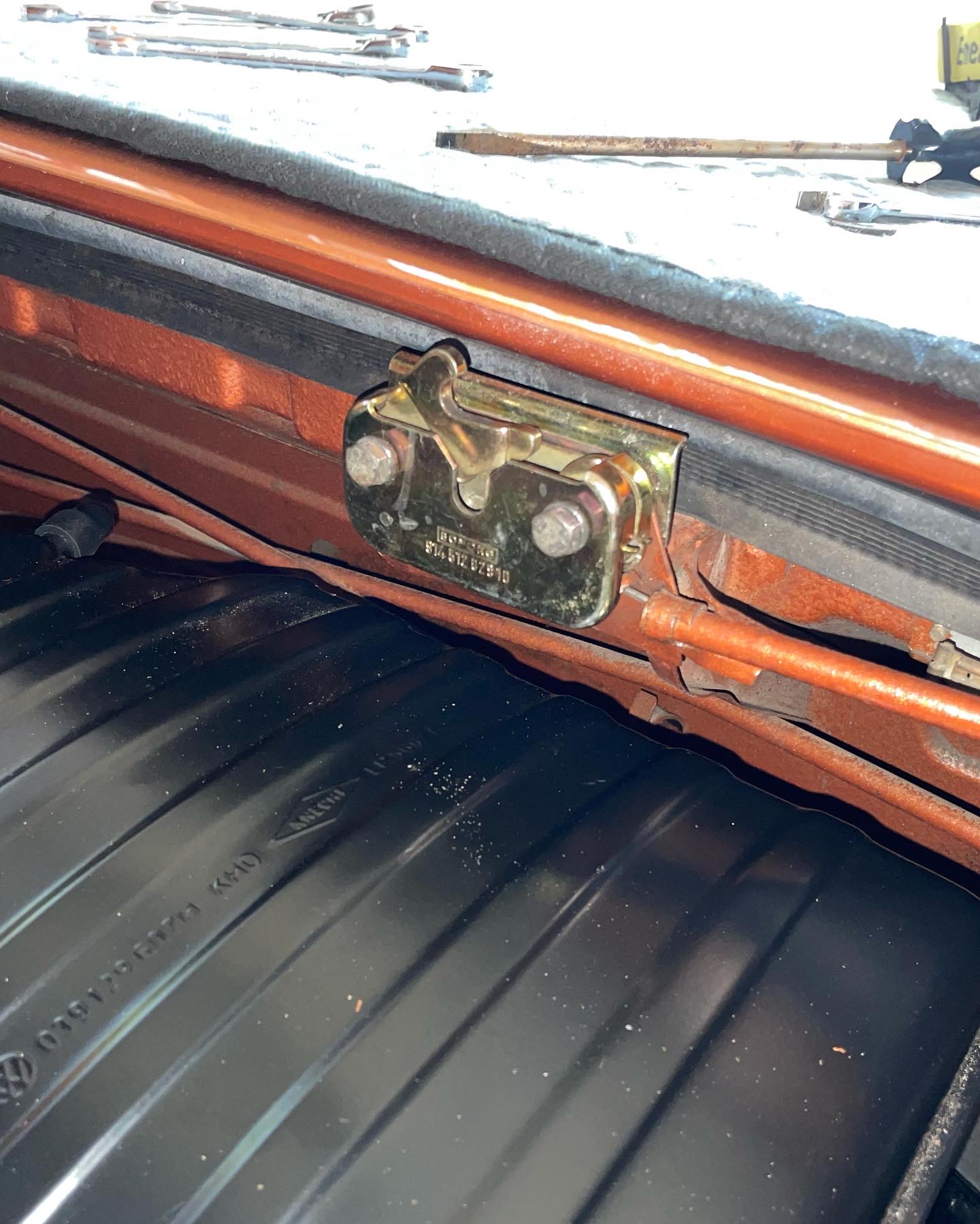

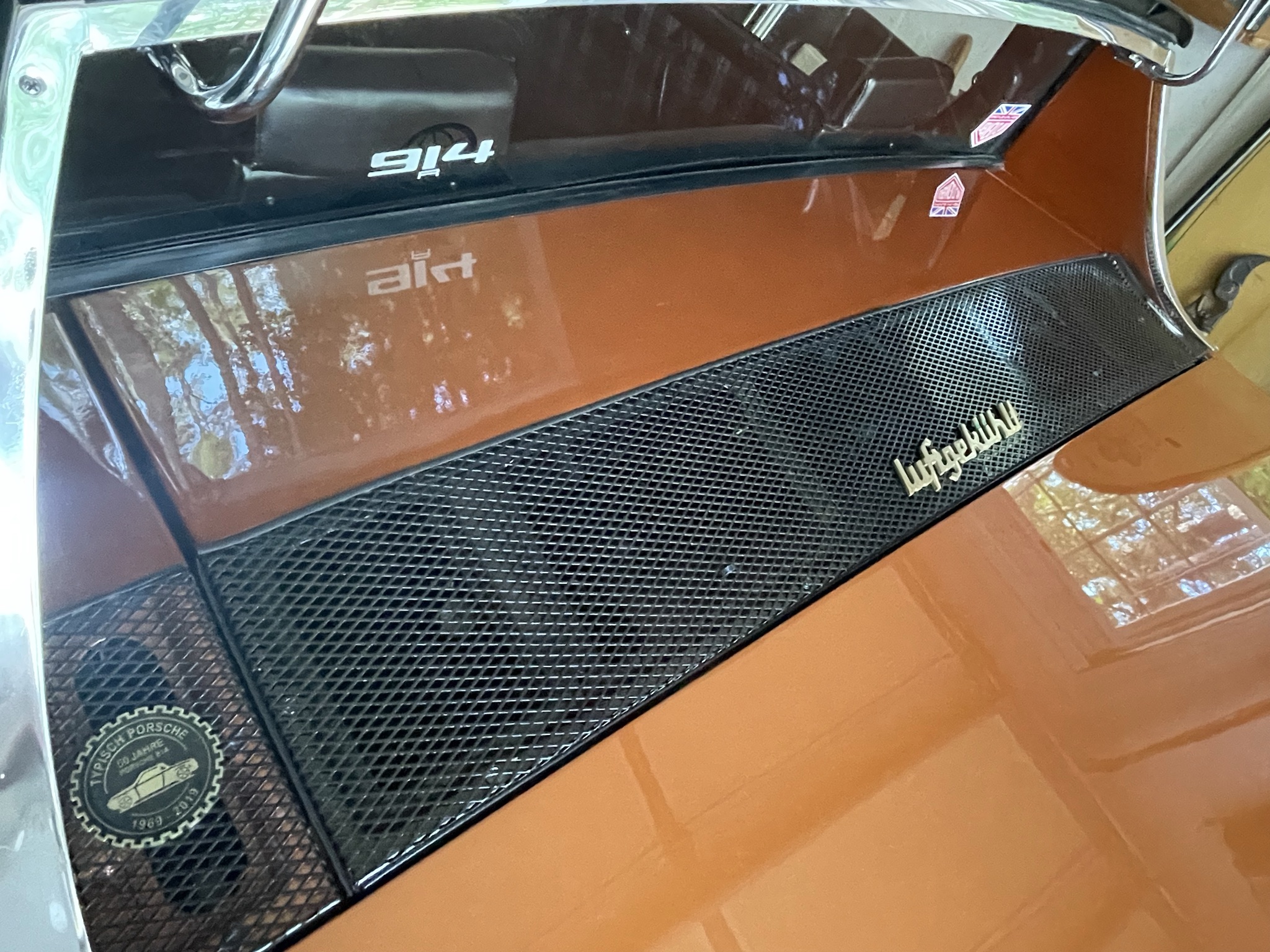

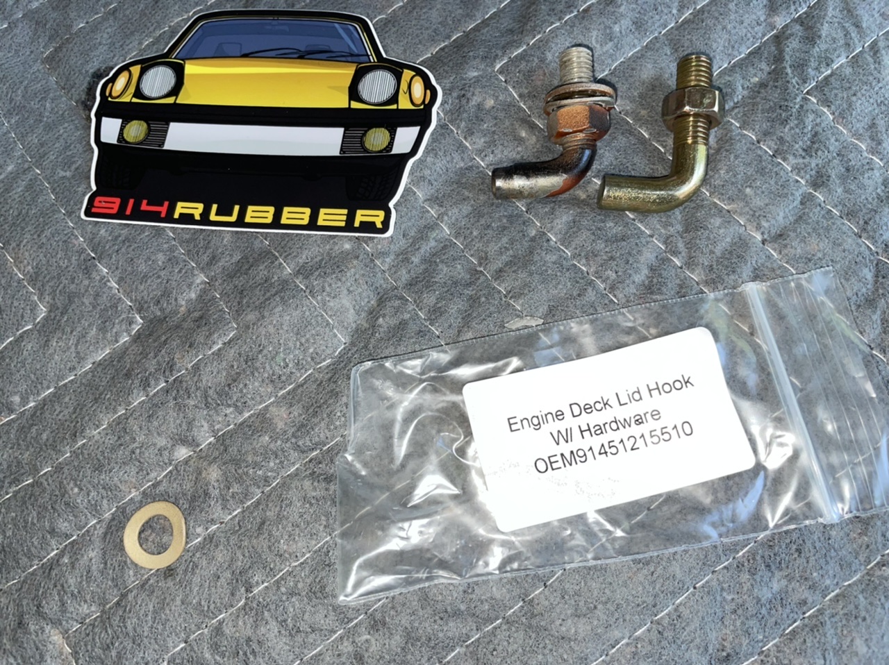

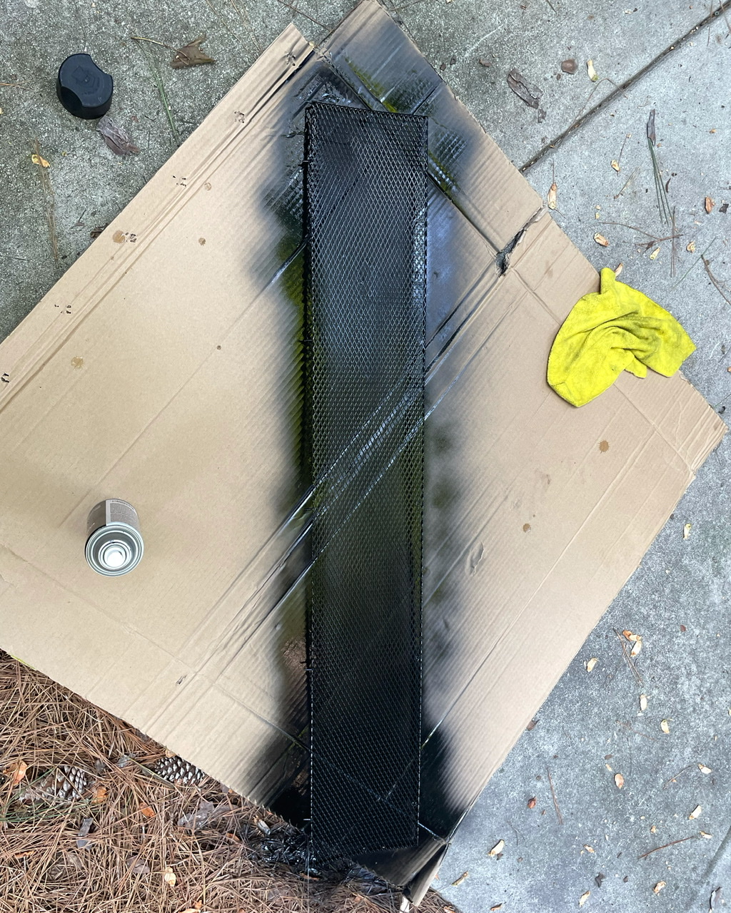

deck lid repair with all new seals, repainted , new stops , repainted mesh, new welting and edging, here it is scratched up pretty good, took the letters off and replaced the welting , the rubber stops, etc,
DRPHIL914
post Oct 4 2023, 07:38 AM
Post #493
Dr. Phil
Posts: 5,971
From: Kennesaw, GA
Member No.: 11,106
lid lined up and back in place,, still have to replace the hinge mounts on the firewall, will do this later.
also new cable, zinc plated latch, new pull button and escutcheon from 914rubber.

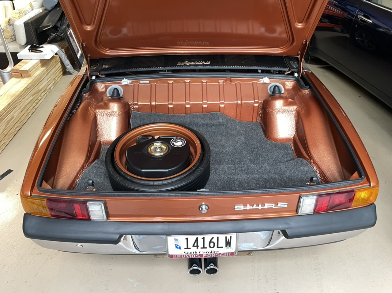

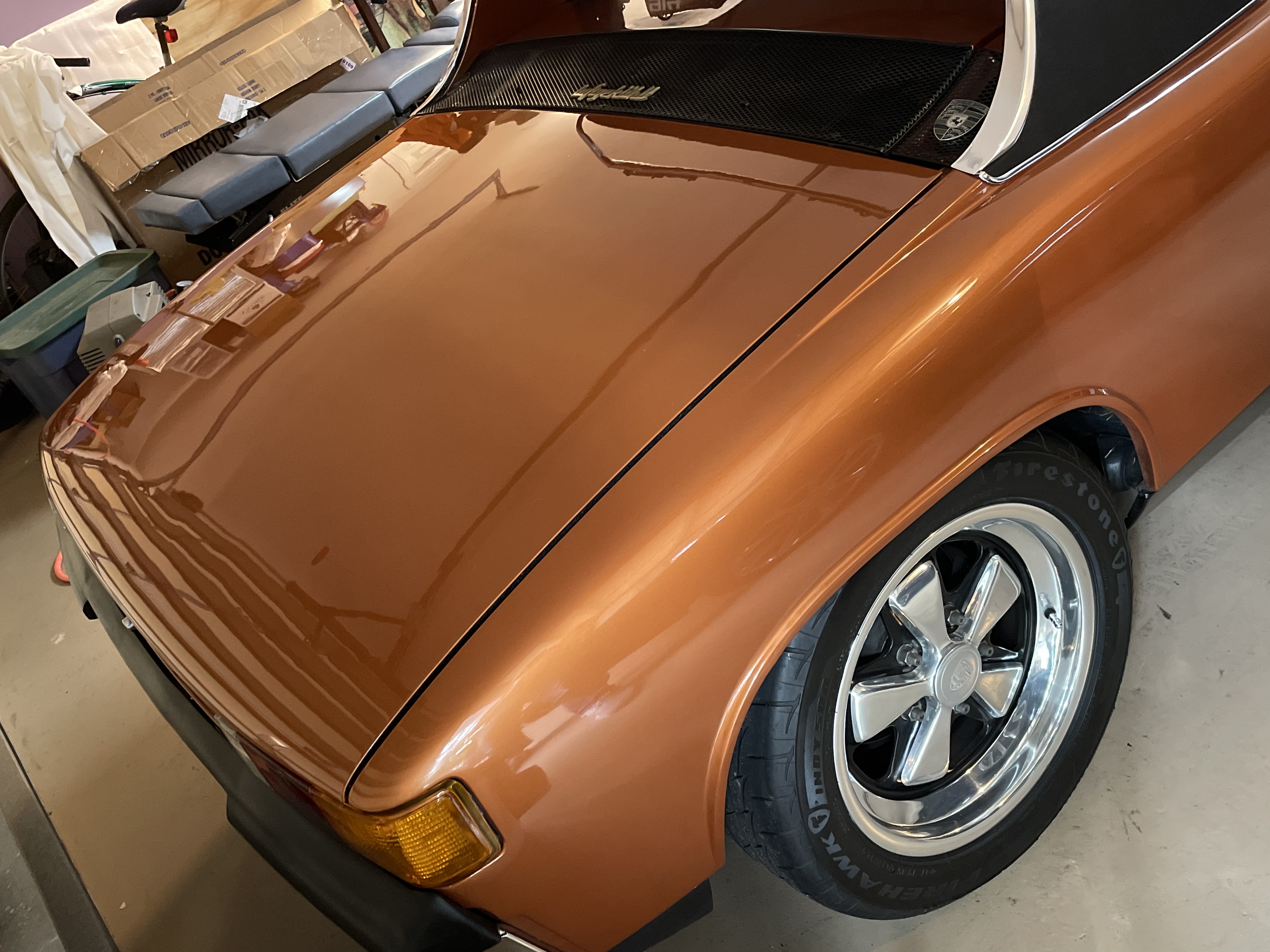

all cleaned up with new rear trunk seal! was ready to go to show.

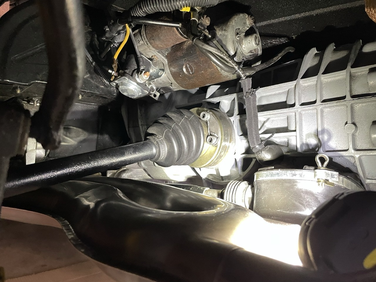

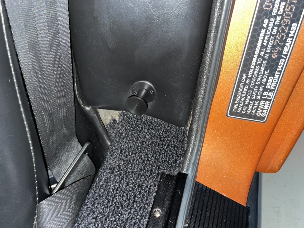

after installing the ford starter solenoid, new seals on the inner CV with safety wires CV bolts!
new door stay and hinge parts!

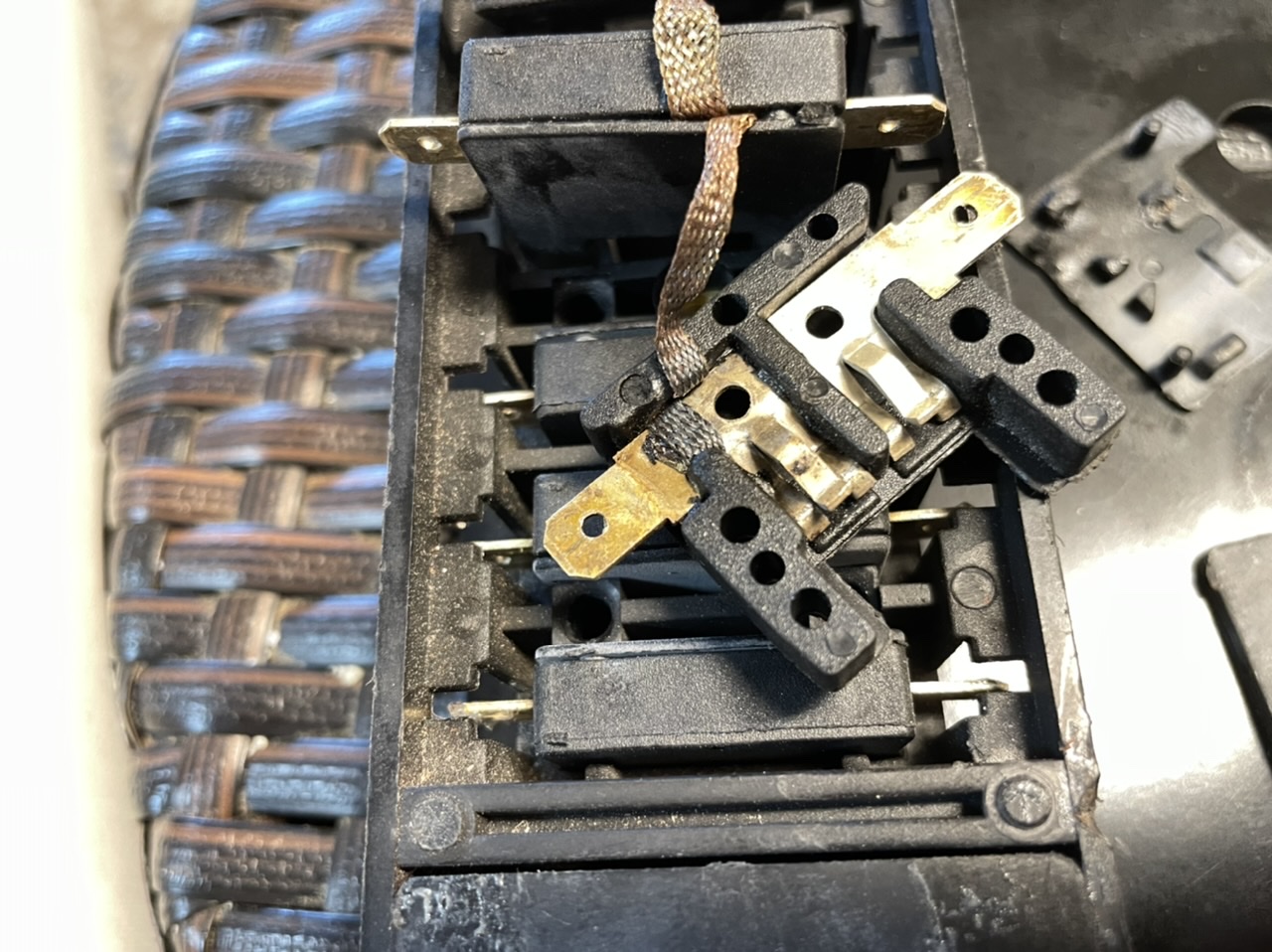

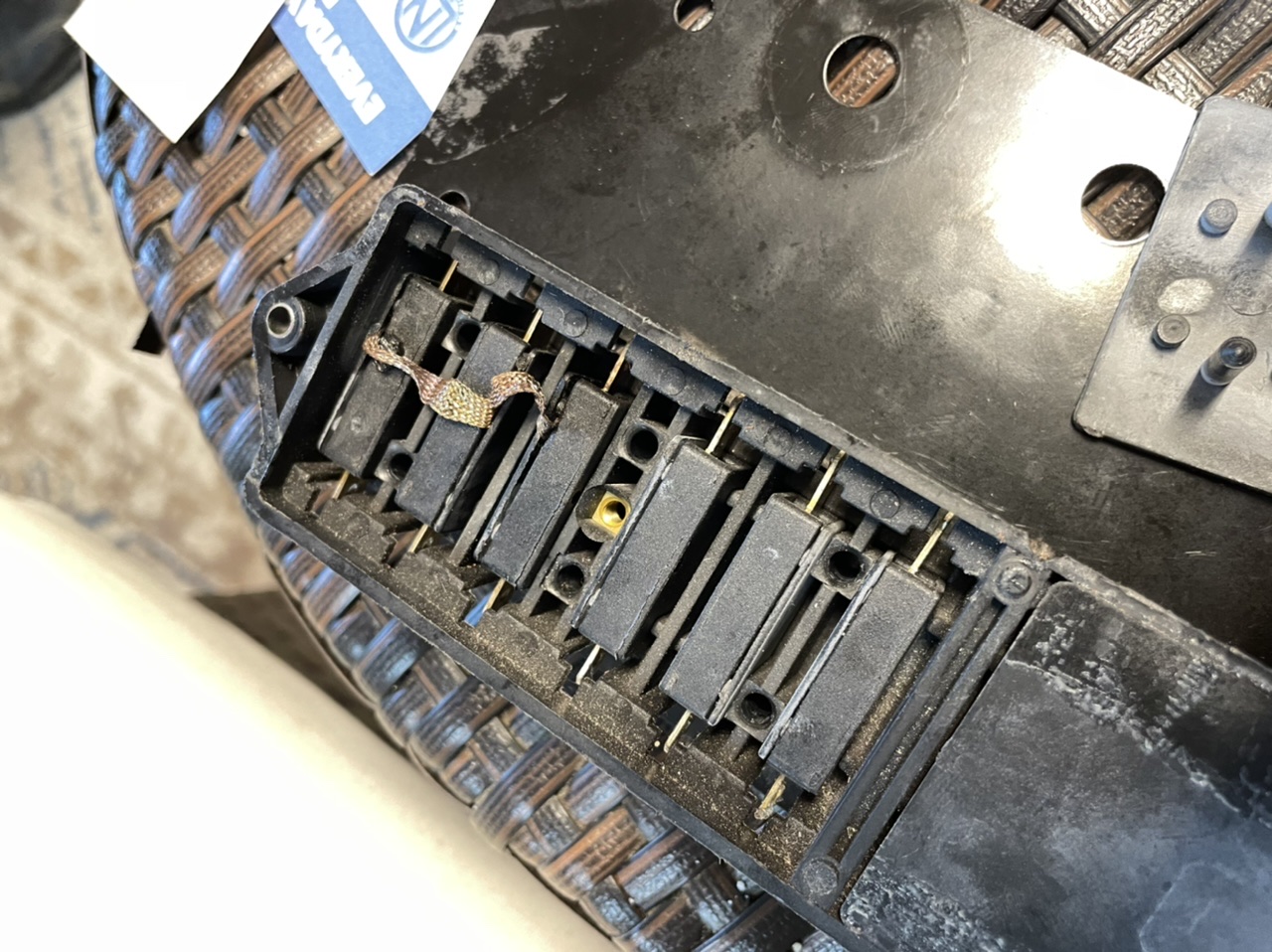

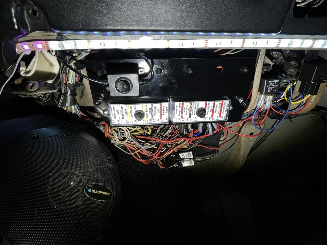

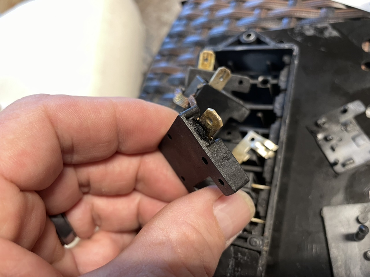

the new J-west Fuse board was a must i had a short in the old one- melting parts lol, the extra relays seen , one is for thr 911 windshield washer pump, and the Hella driving lights.
inside of the old Egman board, the last 3 are connected together, it was shorting out, had some melted plastic in there, and i was loosing for lights ans dash lights as it would short out while driving!!! , well since new board was installed that is no more!!

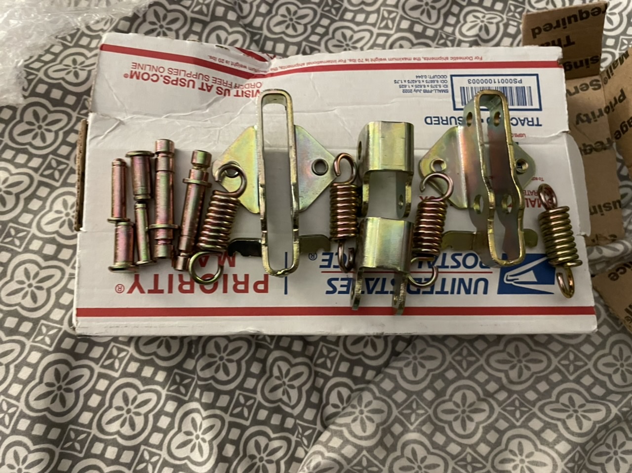

the new door hinge parts came from member @yeahmag !!
i have the other parts with new rollers from 914rubber.
lots of stuff i did when i first got the car i am now finding after 10 years need to be done again, like some of the seals. Some parts were not available 10 or even 4 years ago following repaint, or i couldn't afford all of it and it wasn't necessary. , but as stuff comes up or becomes available ill get it done. i cant stand having crap done part ways!
its great that we have so many members that are supplying parts and service for our cars. so many classics dont have those resources! .

Dr Phil -
Maybe a stupid question: as the 914 is far from an aircraft, are the safety wires really needed?
Not a bit of overkill?
Nice touch for sure on a Concours level car like yours for sure.....
GN
QUOTE(DRPHIL914 @ Oct 4 2023, 07:43 AM) *
Shivers
post Oct 6 2023, 08:16 AM
Post #500
Posts: 3,685
Joined: 19-October 20
From: La Quinta, CA
Member No.: 24,781
QUOTE(Gatornapper @ Oct 6 2023, 06:38 AM) *
Dr Phil -
GN
I’ve had them come loose, not dropping on to the driveway loose but still loose.
https://forums.pelicanparts.com/porsche-911...come-loose.html
