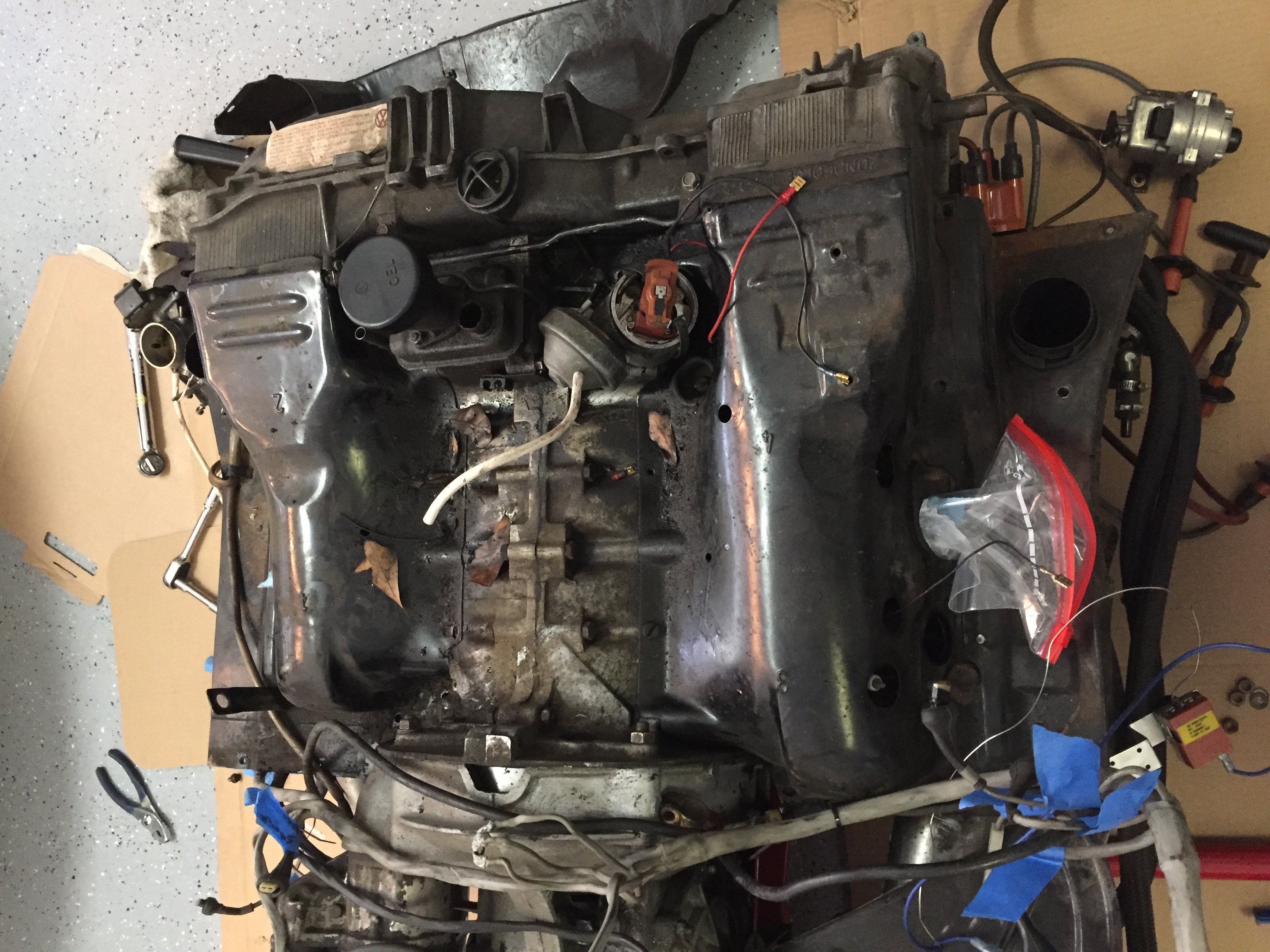

dirty motor

so dirty, lots of undercoating spray and 40 years of dirt oild and dust

so much nicer !

shroud back on
but the Alternator cover i got is wrong, told by mechanic here its foe a 912, so i have to find correct one - oh and need to get a 55 amp alt or a 75 if i can

assembling the new clean runners with zinc plates fuel rails

new motor mounts and brackets

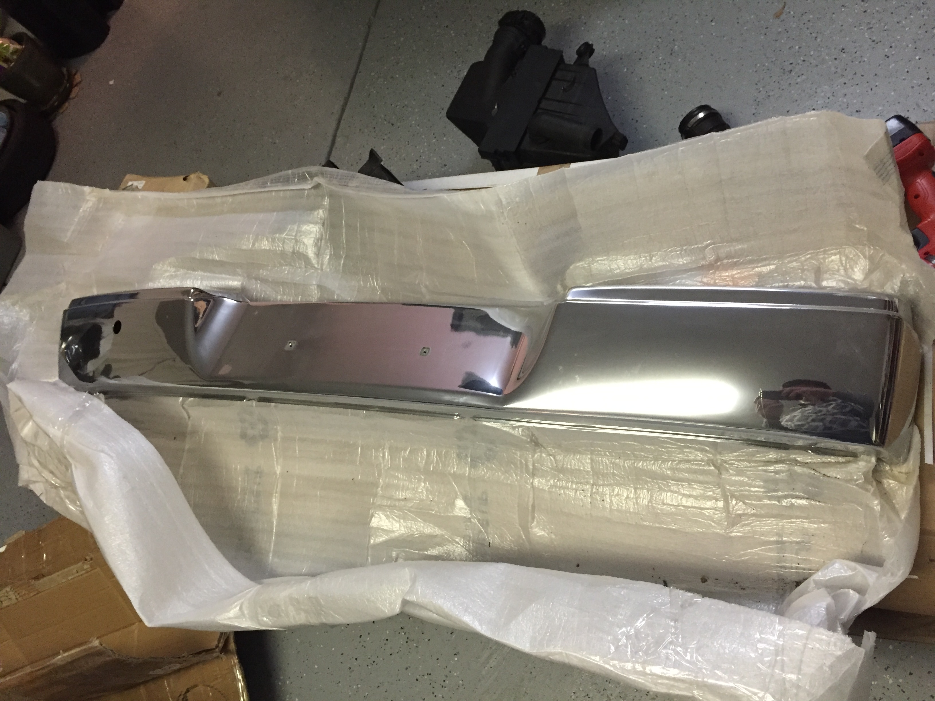

bumpers!

feont bumper with top- i have 2 now ans will have to sell one

this one has the holes for bunper guards and has a few dings some fading- if i can get a food price dor repair and chrome i might get that done before i relist it for sale

so new door, was way better than the old ine with rust in channel, inside and thru- some po used a bunch of bondo to cover up - now new door primed and in the car- rear bumper and a front bumper with super nice top sourced last weekend locally,
trying to decide about using early bumper no guards etc or this later one that will need some work and has thr holes for thr tits, either paint it or rechrome it we will see- been trying to get some prices on chrome work and repair

#66 is a great example of the brackets/mounts as part of a trans conversion and the correct routing for the factory oil temp wire. Nice picture.
