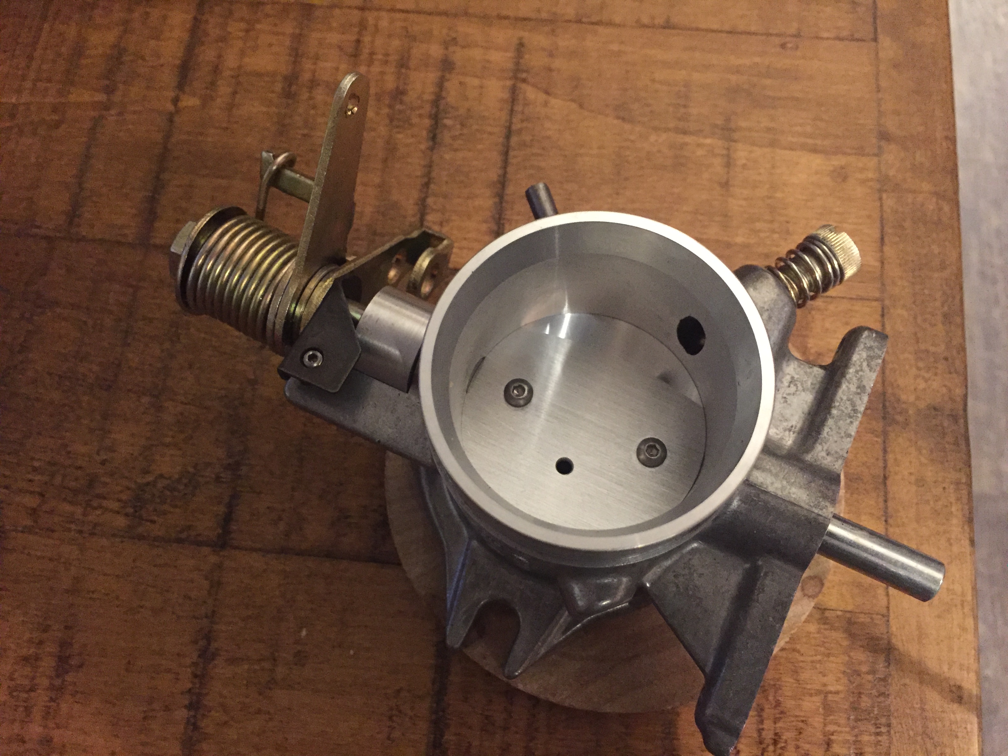

nothing horrible, its 45 years old, a bit sticky on full return, and at first opening, I did clean it but the butterfly valve gets wear as does the shaft, I just decided that it would be nice to have one that was like or better than new to put back on car - I was getting a weird occasional buck that I could never nail down for sure. might have to do with the hotspark module, or TPS but the TPS has zero wear was an NOS one I picked up and installed. It doesn't do it on full hard acceleration , like it used to when I had a worn bad TPS circuit board. either way I guess its another think to try and eliminate- it will be interesting to see if that occurs with the 123ignition distributor vs the stock one- I wont know for probably 6 weeks.

i will bet this throttle body didnt look this good brand new!
just got it back from Phil in NM. so what do you think? I also have a bag of new vac hoses, new TB seal, intake runner seals etc.
i am just buying time waiting foe the body and paint to be done. not updates in that front at this time.
