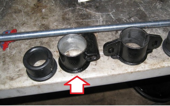

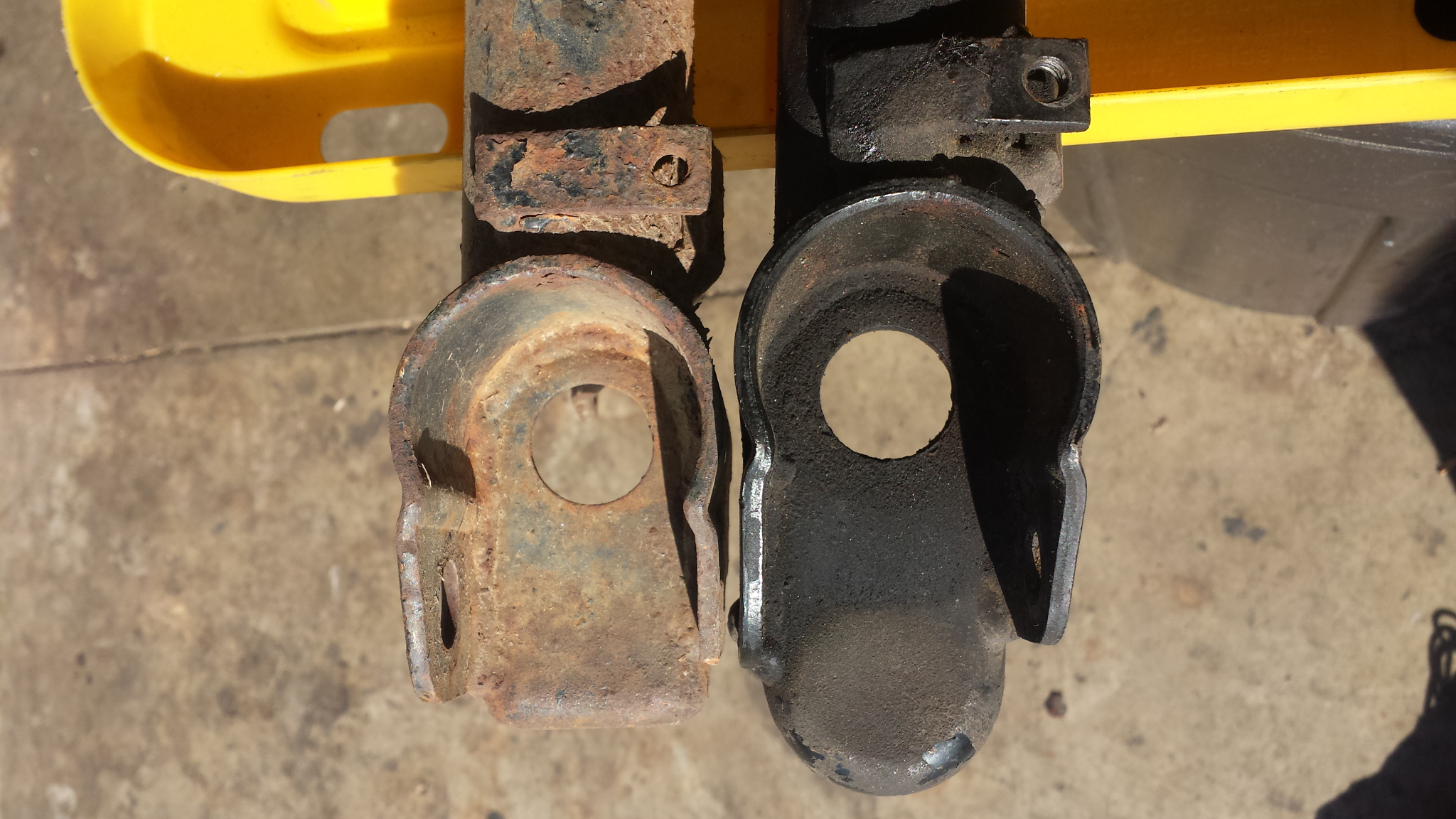

Not sure what these are properly called, as they don't seem to have a unique p/n in the PET (just part of the wishbone assembly), but I need both left and right of what the arrow is showing. I can't find mine. I think I may have left them at the powder coater when the rest of the assembly was done earlier this year (IMG:style_emoticons/default/headbang.gif)
FWIW (but I don't think it matters), it's a '75.
Not my pic, but useful for pointing out what I need:

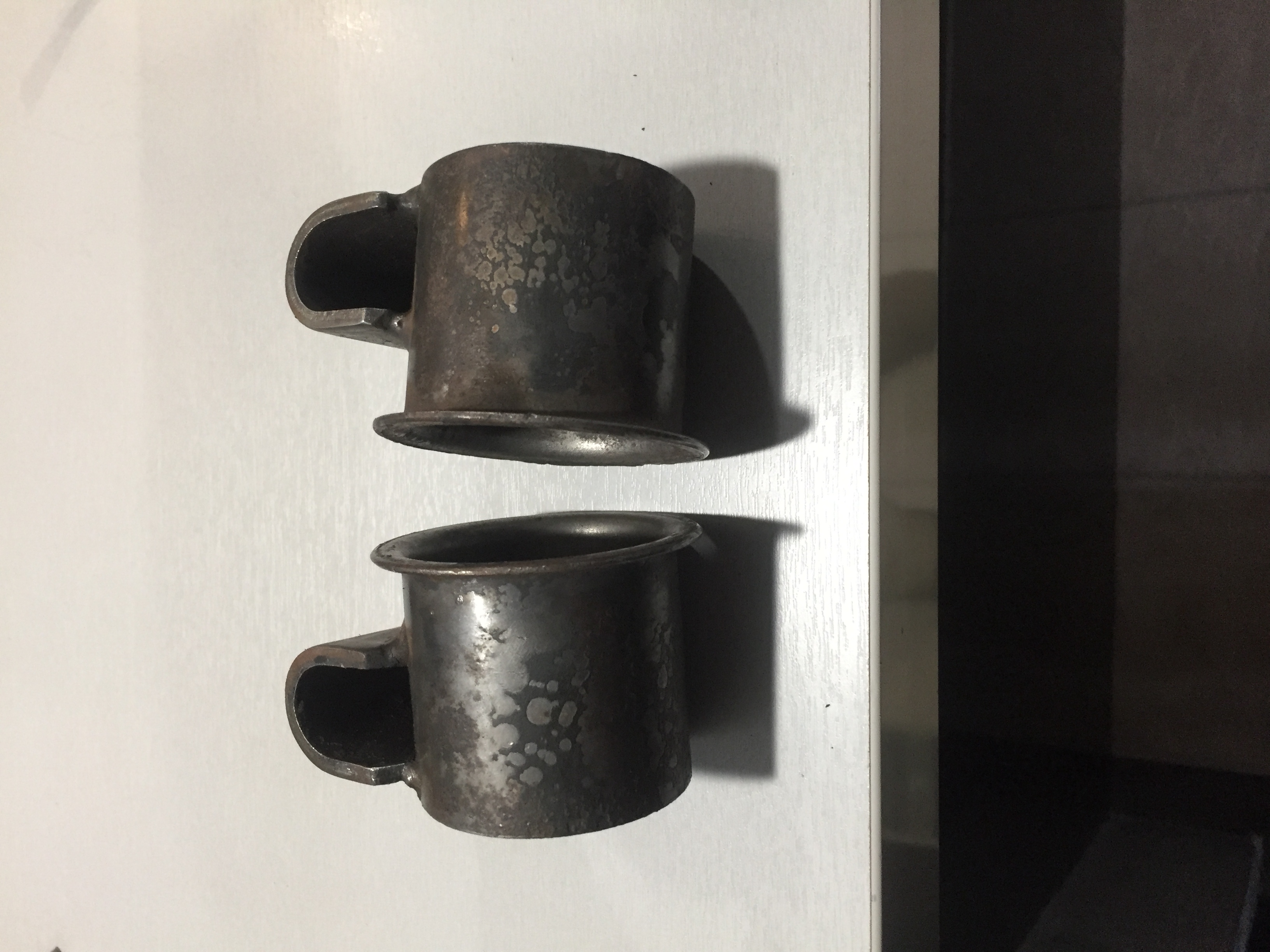

I have some that you can have for the cost of shipping.

Be aware the rears are left and right specific. They install with the big end of the loop up and towards the outside of the car. The fronts install with the oval reinforcement up. I have installed many sets and have my own method using a long piece of thread-all to pull them on. You need to knock out the Welch plug to clean out the inside of the A arm or the dirt and crude will get in the splines and interfere with the torsion bar installation.

Rob, I dug out a pair and they fit in a small Priority Mail box.

Right you are, Mark. This is for a -4.

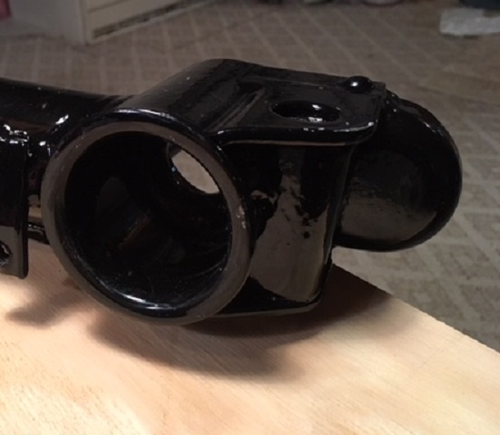

Here's a pic of the end where the "collar" would go, in theory. Does this look stock? I'm struggling to see how the collar would fit or mate into this. It almost looks like it's built into the this assembly and not a separate piece. I suppose I'll be able to confirm, and maybe I'll figure it out, once I get Kevin's that he's sending.

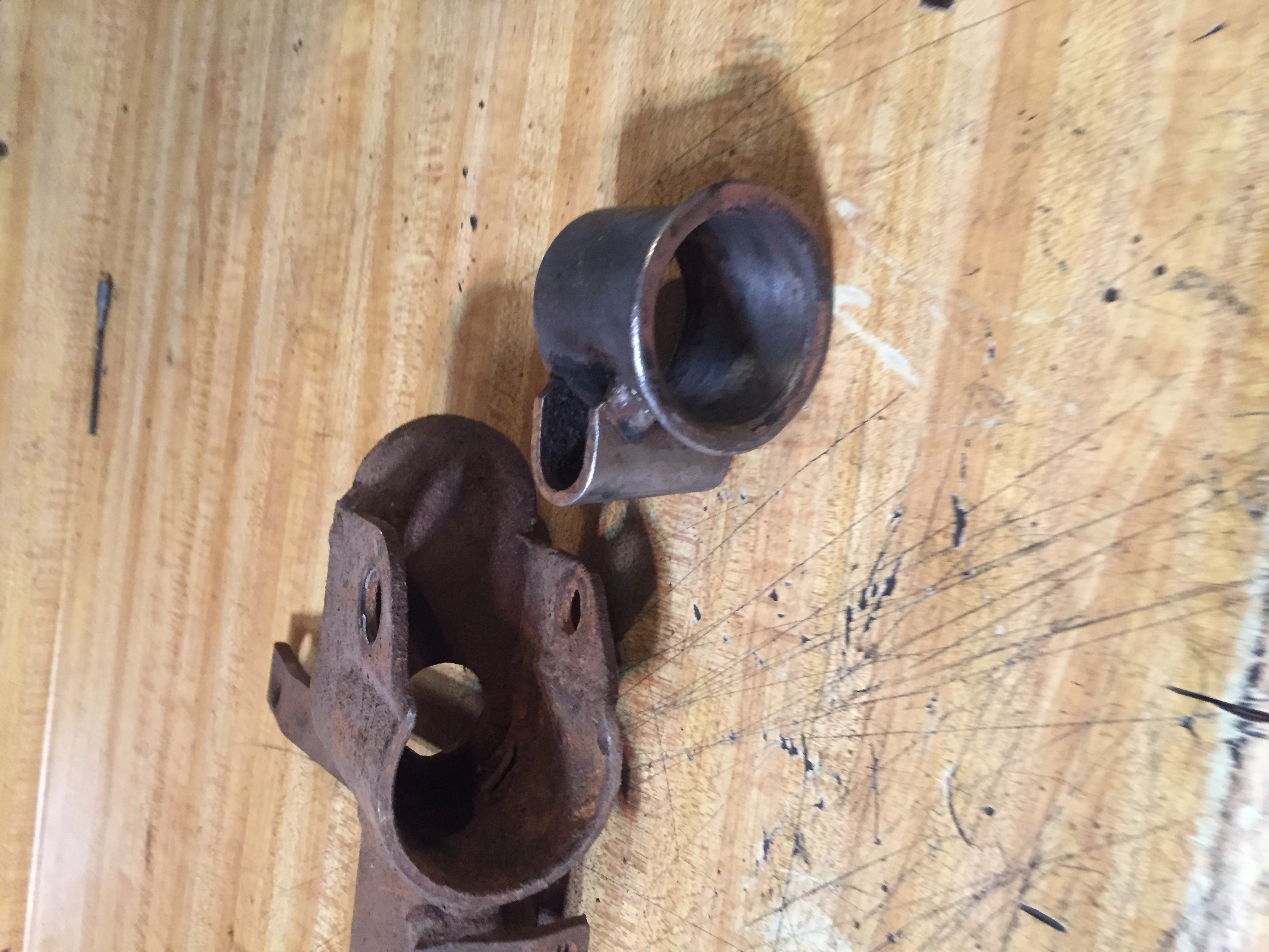

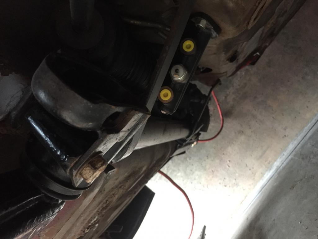

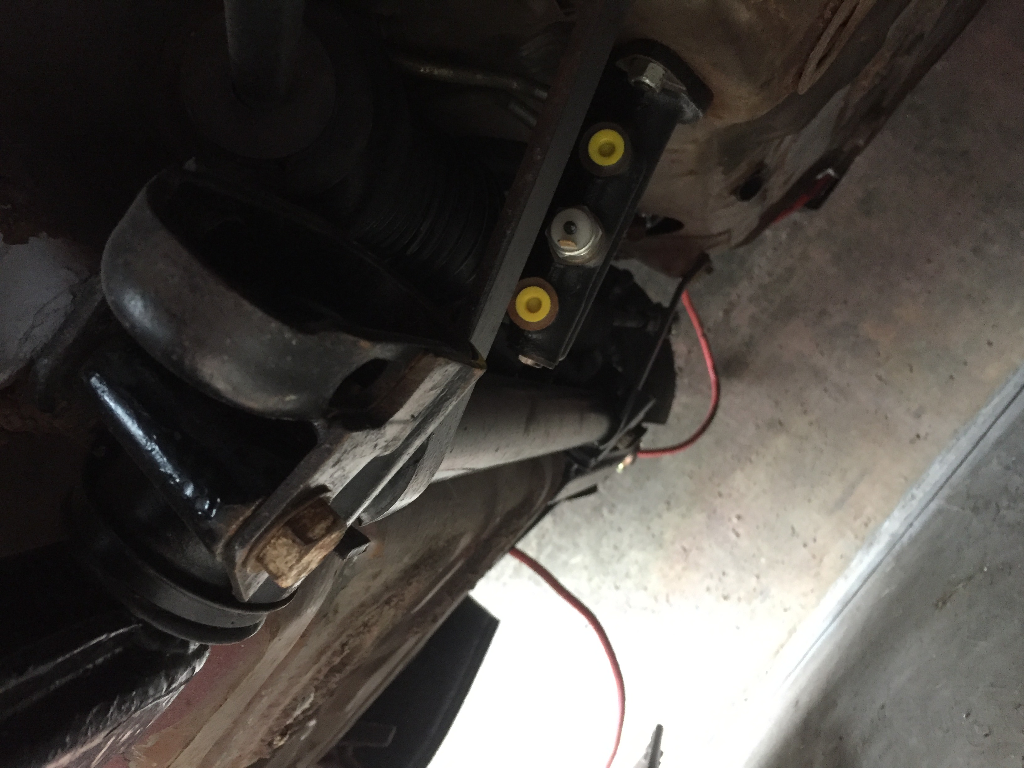

Rob, I crawled underneath mine and took a couple of pictures.
BeatNavy
post Oct 29 2017, 02:49 PM
Posts: 2,954
Joined: 26-February 14
From: Easton, MD
Member No.: 17,042

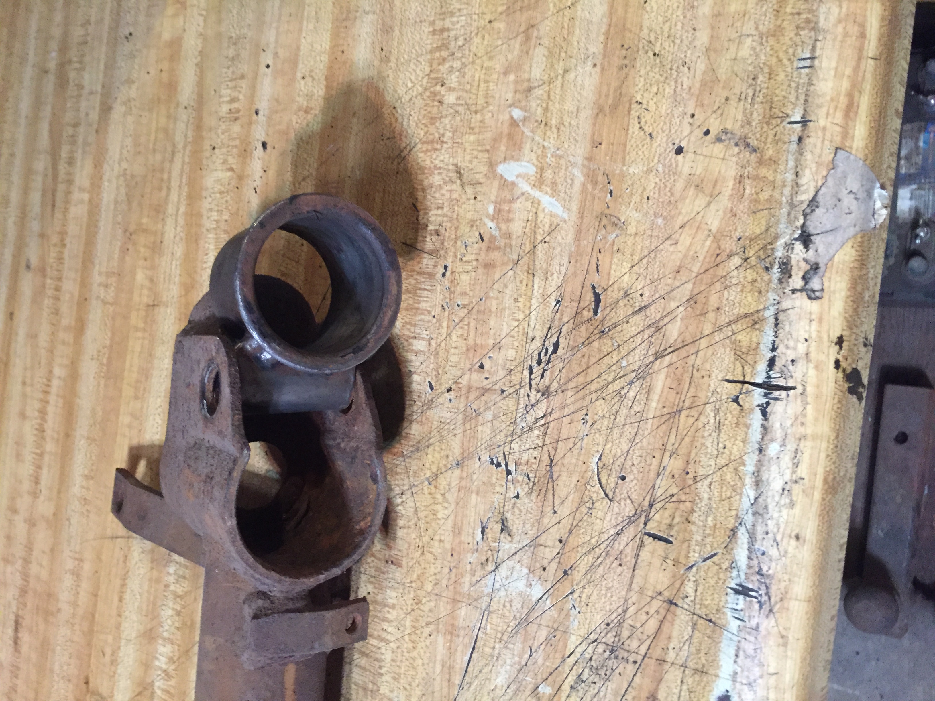

Hey Kevin, thanks for doing that. I had my '72 on a lift yesterday, and it definitely looked different. Am I going crazy? It looks like in your picture the tab where the bolt goes through is a separate piece, while mine appears to be integrated into the support itself.

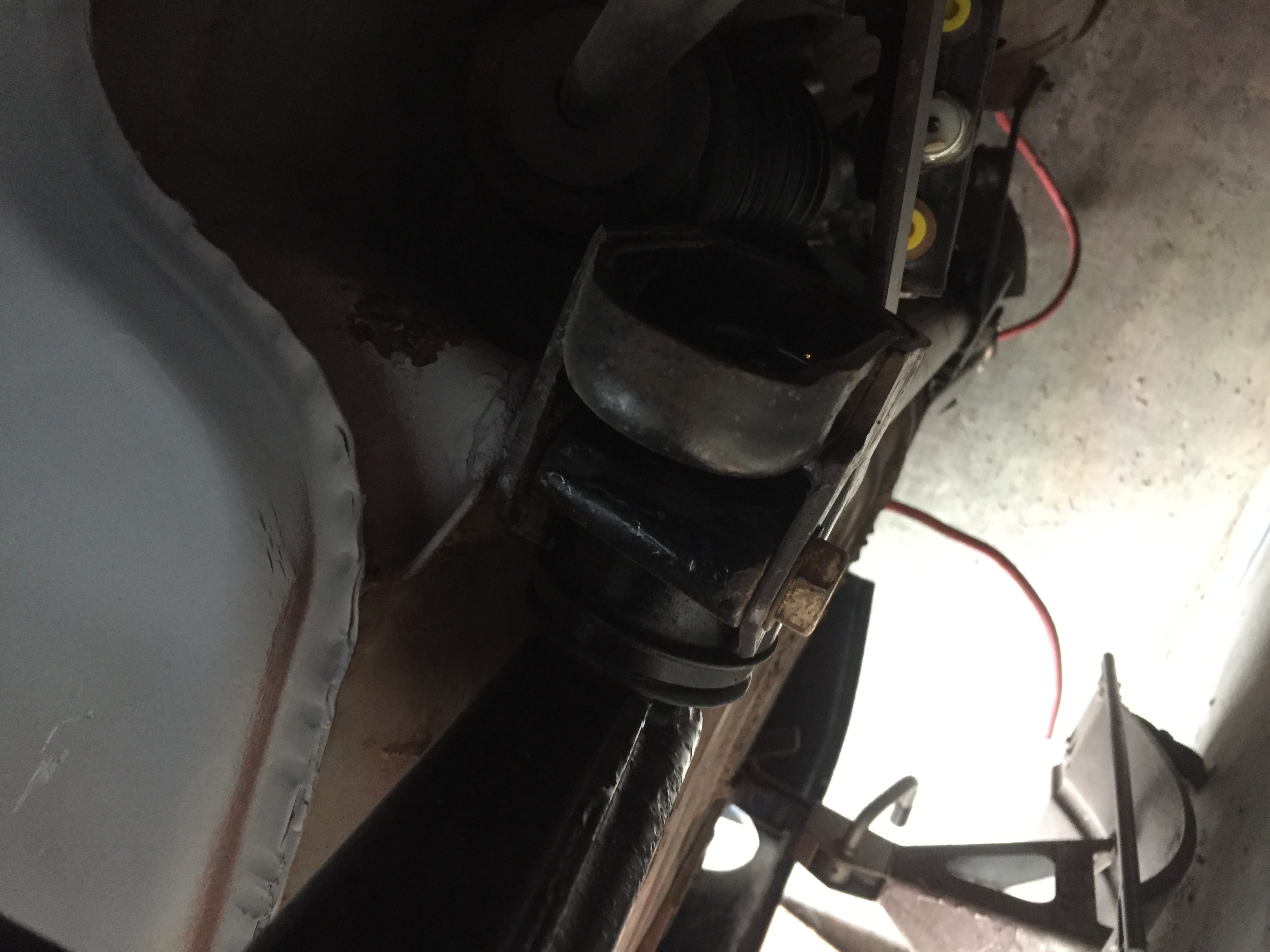

QUOTE(BeatNavy @ Oct 29 2017, 12:49 PM) *
Here is more pictures
BeatNavy
post Oct 29 2017, 02:59 PM
Posts: 2,954
From: Easton, MD
Member No.: 17,042
Well that seals it. My aux support / cross member is "different" in that it has this piece built in. That would explain why I couldn't "find" these collars. I never had them.
My question now: is this stock 914 or something different? And is there any issue putting the elephant control arm bushings in these? This thing came off of a '75 that is/was totally stock, as far as I know.
Thanks, Kevin!

Rob, I have a 75 as well, I also parted out three other 914’s. 2-73 and 1-74 and all of the cross members that I have look like the one in the picture. I am not sure what you have. I would ship you a cross member for shipping costs if you need one.

It's hard to tell for sure from that single picture, but it looks like your collars are actually in place in that cross member. Maybe that's why you couldn't find yours -- they were already there.
See if you can pry them out. They are supposed to be a snug fit in the cross member, so it might take a little muscle. I had to use a pry bar between the cross member and the vertical tube of the collars to get mine out, you will probably need to do the same thing.

QUOTE(BillC @ Oct 29 2017, 07:51 PM) *
Oh, geez, I'm an idiot. Bill's absolutely right. I took a closer look at them this morning and got them to slightly budge with a little prying - they are in there tight, but definitely in there. I guess with the initial dirt on them I didn't notice, and then when they were powder coated that way it looked like one integrated piece. Getting them out may be "fun." Sorry to waste everyone's time, but at least I'm smarter (marginally) than before. Kevin, I'll PM you.
