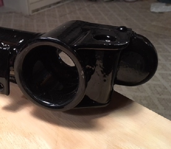

Right you are, Mark. This is for a -4.
Here's a pic of the end where the "collar" would go, in theory. Does this look stock? I'm struggling to see how the collar would fit or mate into this. It almost looks like it's built into the this assembly and not a separate piece. I suppose I'll be able to confirm, and maybe I'll figure it out, once I get Kevin's that he's sending.

Hey Kevin, thanks for doing that. I had my '72 on a lift yesterday, and it definitely looked different. Am I going crazy? It looks like in your picture the tab where the bolt goes through is a separate piece, while mine appears to be integrated into the support itself.

Well that seals it. My aux support / cross member is "different" in that it has this piece built in. That would explain why I couldn't "find" these collars. I never had them.
My question now: is this stock 914 or something different? And is there any issue putting the elephant control arm bushings in these? This thing came off of a '75 that is/was totally stock, as far as I know.

It's hard to tell for sure from that single picture, but it looks like your collars are actually in place in that cross member. Maybe that's why you couldn't find yours -- they were already there.
See if you can pry them out. They are supposed to be a snug fit in the cross member, so it might take a little muscle. I had to use a pry bar between the cross member and the vertical tube of the collars to get mine out, you will probably need to do the same thing.

Good catch. After looking more closely at the picture I agree they are there
and need to be pryed out.

Oh, geez, I'm an idiot. Bill's absolutely right. I took a closer look at them this morning and got them to slightly budge with a little prying - they are in there tight, but definitely in there. I guess with the initial dirt on them I didn't notice, and then when they were powder coated that way it looked like one integrated piece. Getting them out may be "fun." Sorry to waste everyone's time, but at least I'm smarter (marginally) than before. Kevin, I'll PM you.

They get stuck in there as the bolt pinches the cross bar. Pry bar on the back bearing bracket should get them out.
