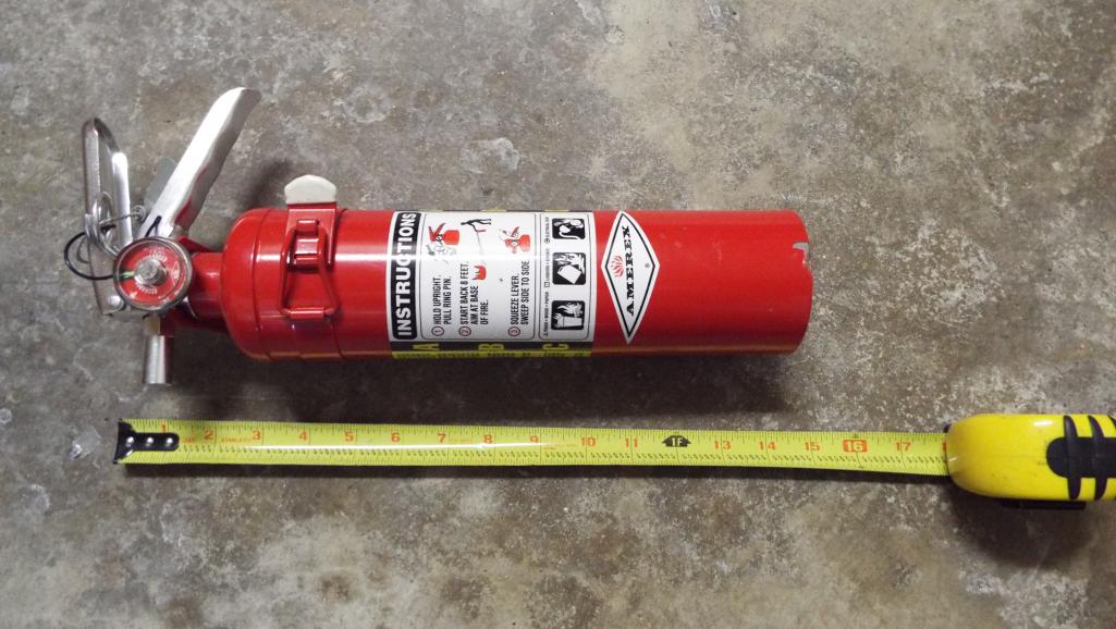

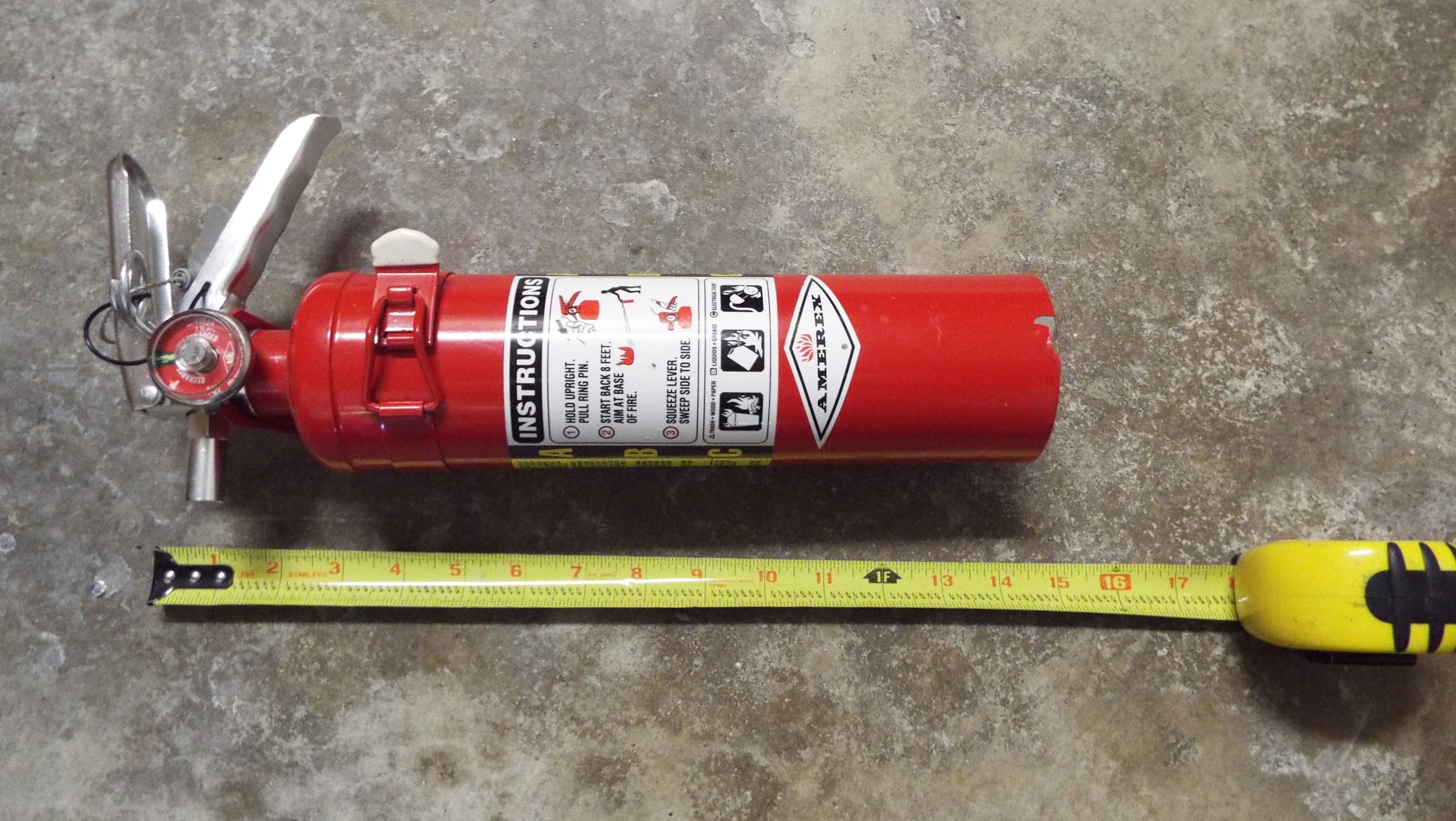

I currently have this ABC extinguisher but I think I'm going to be shopping (IMG:style_emoticons/default/smile.gif)

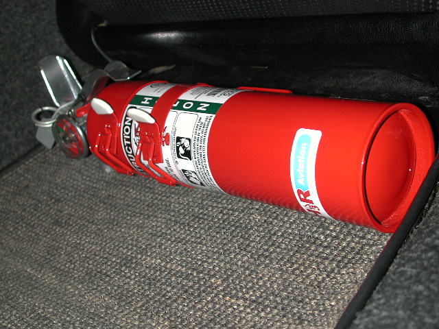

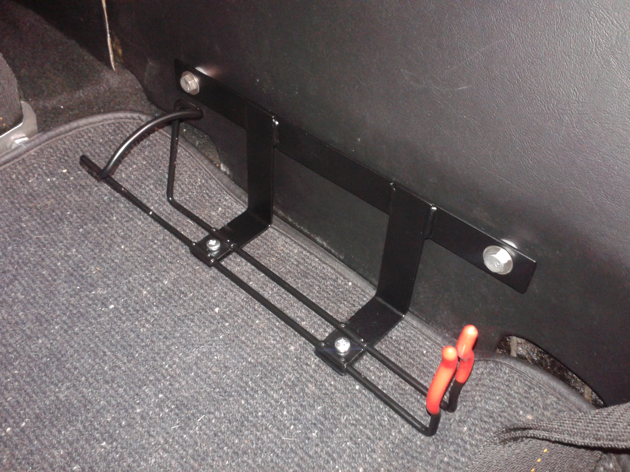

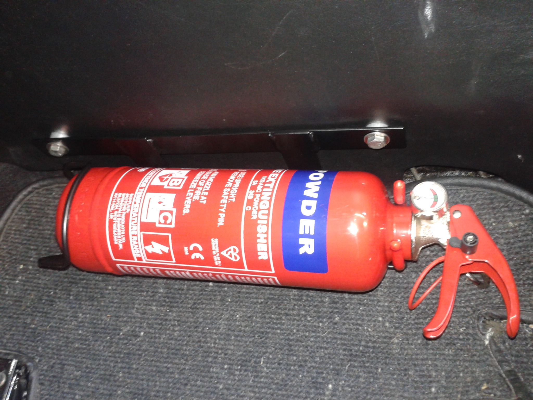

Personally, i didnt want anything directly under my feet (bit messy in the cabin) but i did want it close to hand, so welded up, and powder coated, a bracket which mounts directly behind the driver's seat. Note spacers turned up on behind bracket. Neat and simple installation (thanks Darren for the idea if you're reading !).Attached Image Attached Image

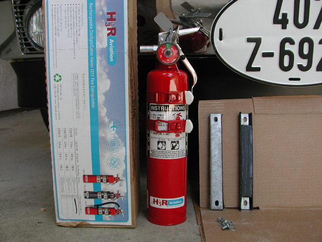

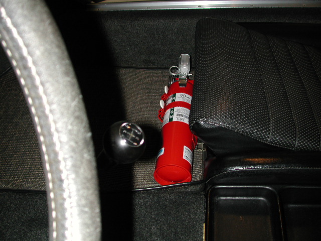

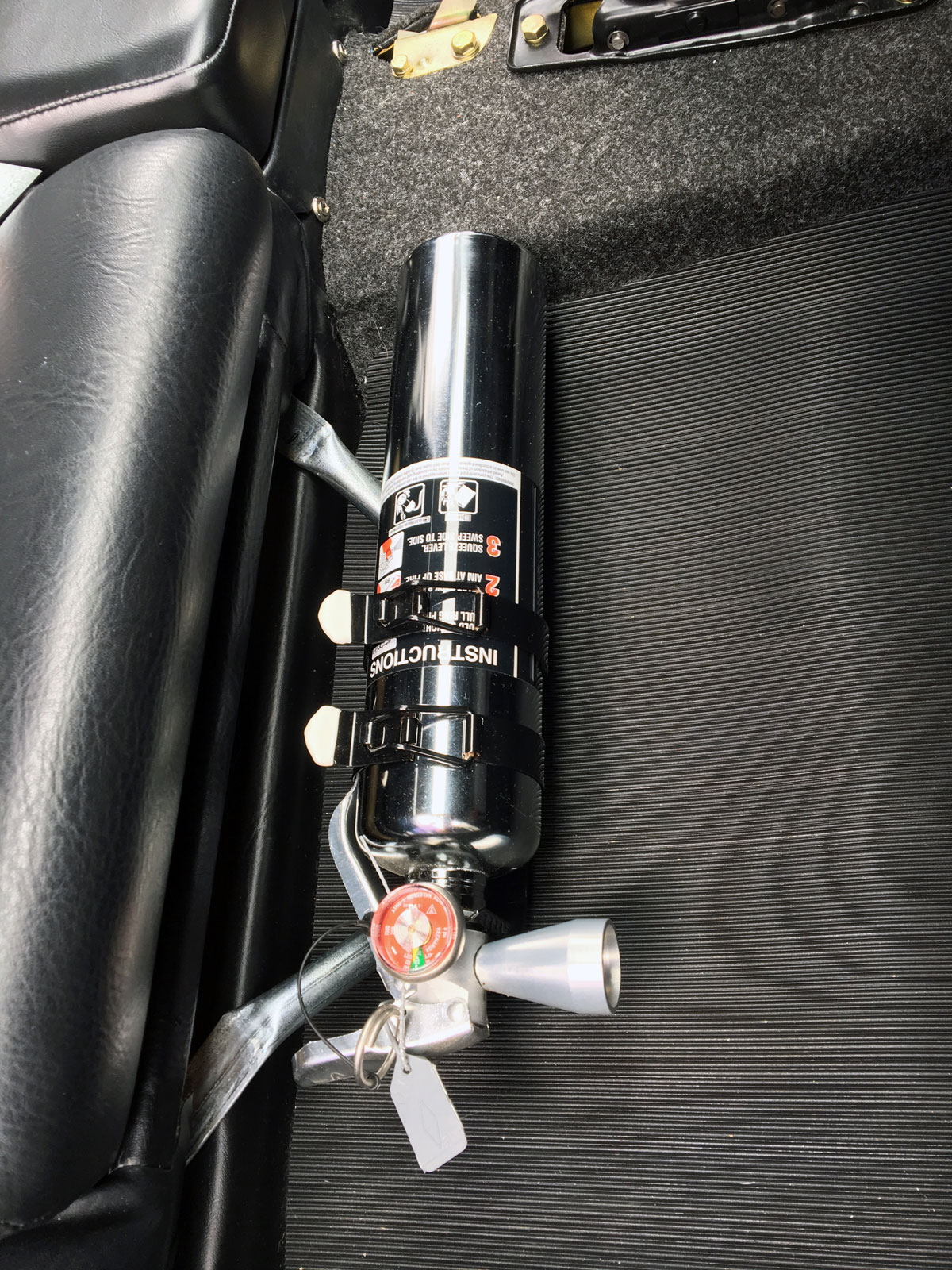

Halon extinguisher mounted to heavy-duty magnets attached to the (fixed) bottom of the passenger seat on a 1970/4

Made mine. Pretty easy to do...No drilling

QUOTE(Biggles @ Nov 23 2017, 11:43 AM) *
Nice tidy solution,I prefer that option and will most likely do the same but on the passenger side, I have a second one I will mount on the front fuel tank bulkhead,as a" just incase".

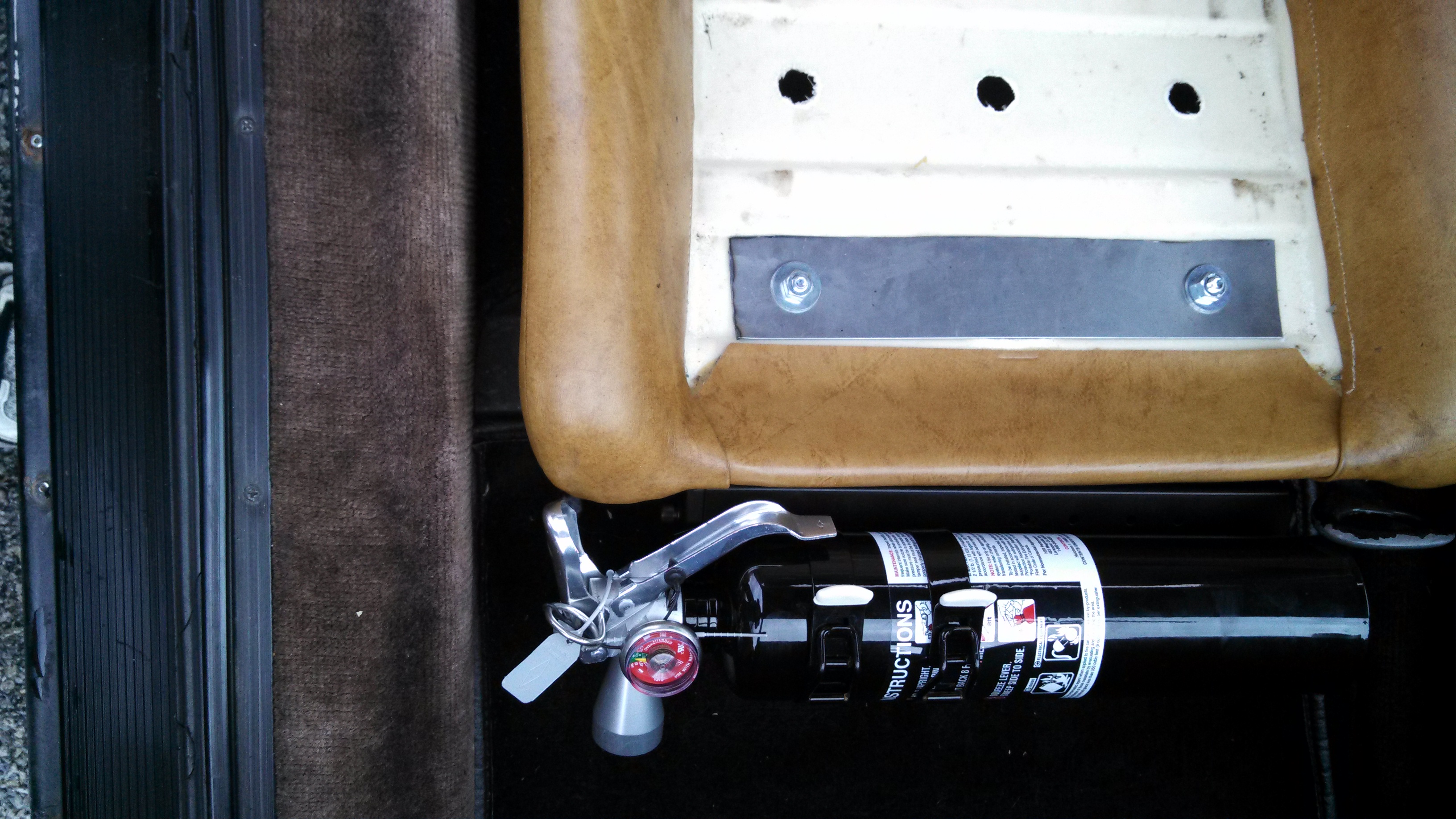

QUOTE(23e Heure @ Nov 24 2017, 05:32 AM) *
Has anyone had success with this specific mount, or a similar off the shelf item?
I used this mount, but did not attach it to the seat rails, just the seat itself:

QUOTE(1970 Neun vierzehn @ Nov 23 2017, 01:31 AM) *
Is this the H3R C352TS Model you are using?

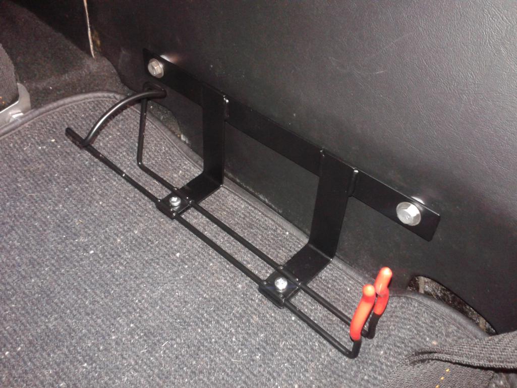

Not sure if I posted this before. I wanted the extinguisher to be in plain site but completely out of the way. This one is mounted up under dash with a CNC bracket with a quick release pull pin. In this photo the extinguisher looks to be in the way but is actually pretty high up and very much out of the way. When driving you can barley see, but is very easy to access. (IMG:style_emoticons/default/biggrin.gif)

QUOTE(pvollma @ Nov 21 2017, 11:29 AM) *
Found a universal seat mount which worked fine for the passenger seat of my 914:
Would you mind sharing where to get this universal mount
Thanks
913B

QUOTE(1970 Neun vierzehn @ Nov 22 2017, 07:31 PM) *
Magnets ? Has it detached from the magnets during driving ? Harbor freight magnets maybe or more stronger type ?
Thanks

QUOTE(porsche913b_sp @ Nov 24 2017, 03:36 PM) *
Thanks
Fire extinguisher seat mount

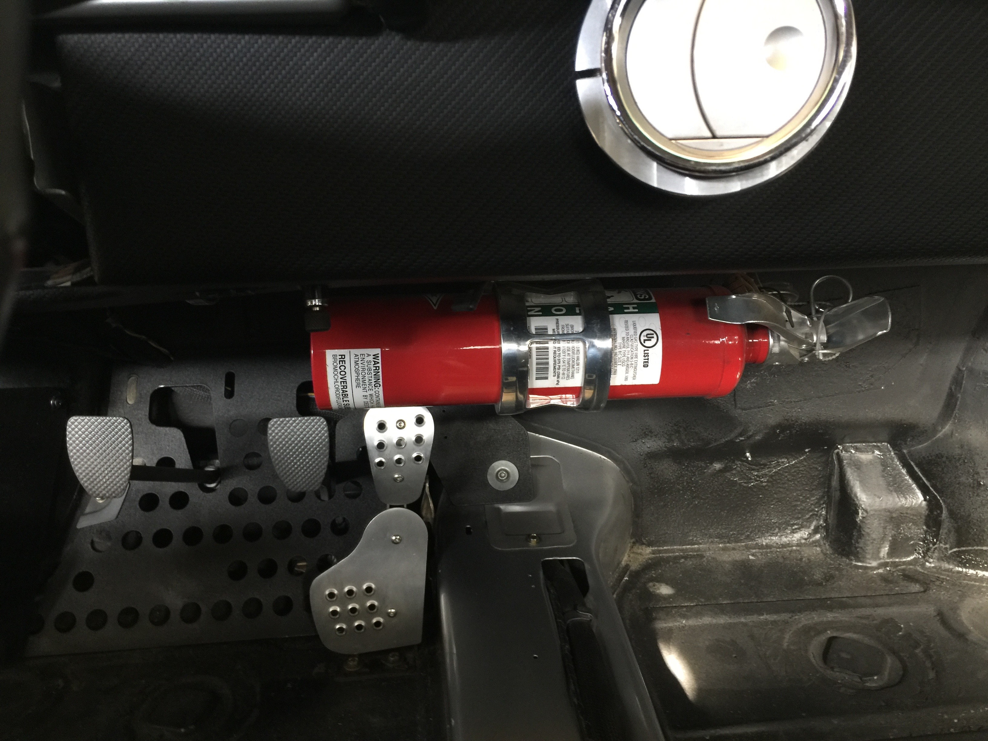

I also mounted my Halon extinguisher in front of the passenger seat in both my 70 band my 73. It doesn’t interfere with the legroom and is easily reached from the driver’s seat. If I was buying another extinguisher, I’d consider a foam type as it would smother the fire and cool the area to help prevent reignition.

QUOTE(porsche913b_sp @ Nov 24 2017, 11:38 AM) *
Thanks
Extremely hard "panic" stops and rather extreme cornering maneuvers (all on large, empty lots) do not dislodge this extinguisher mount. The magnets were obtained from a new car dealer that I had a long association with. The magnets are typically used at dealerships to mount license plates to cars for test drives or transport moves to other locations (think dealer trades).
