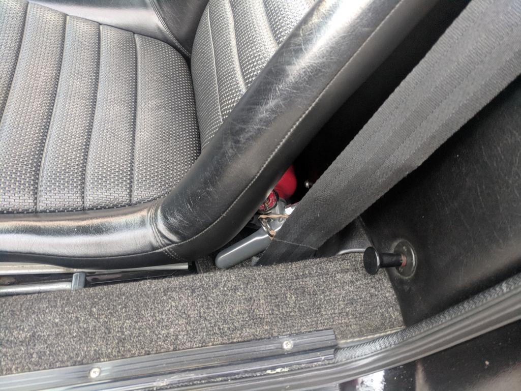

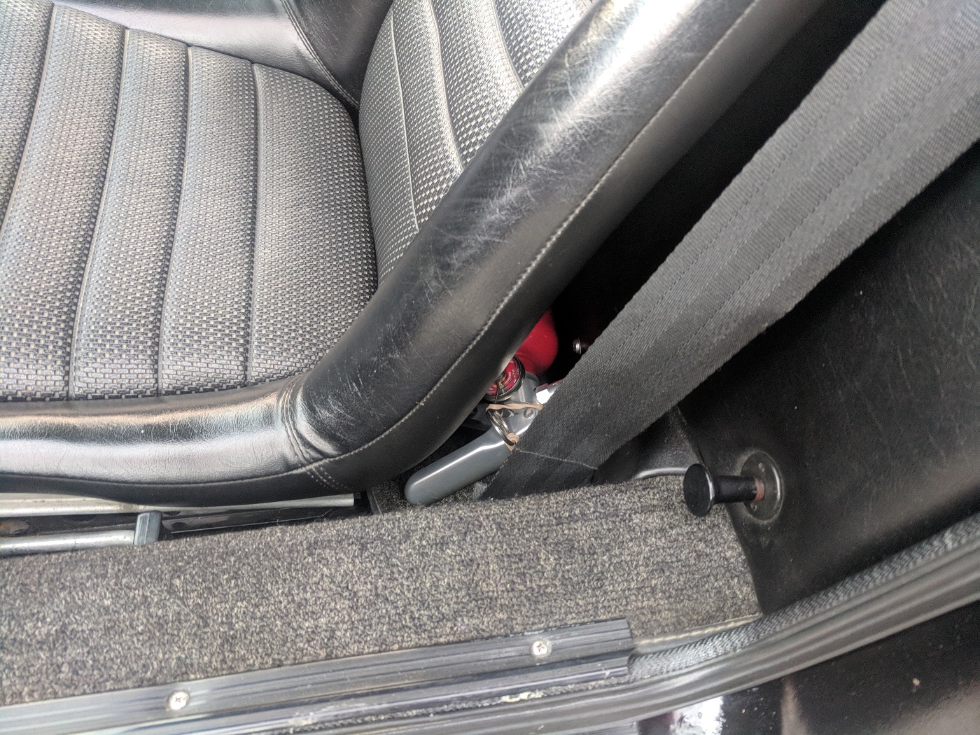

post Apr 24 2018, 04:56 AM
Post #48
Posts: 1,790
Joined: 16-July 13
From: Edgewood, New Mexico
Member No.: 16,126
Instead of mounting, it fits perfectly behind the seat. Any problems to this?
