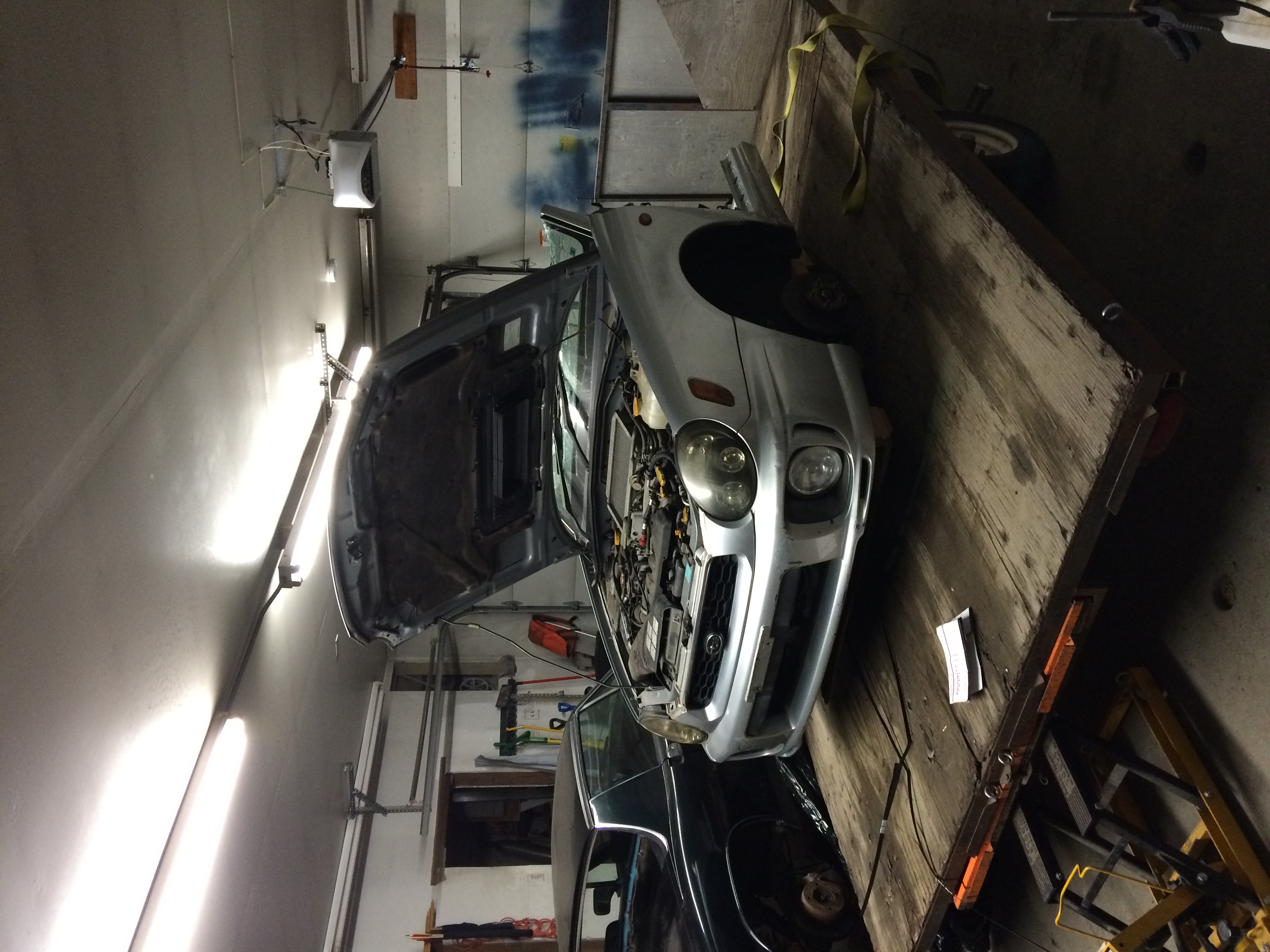

my first step picked up a 2003 wrx half cut from japan...sorry about it being on its side it rotated autamatically

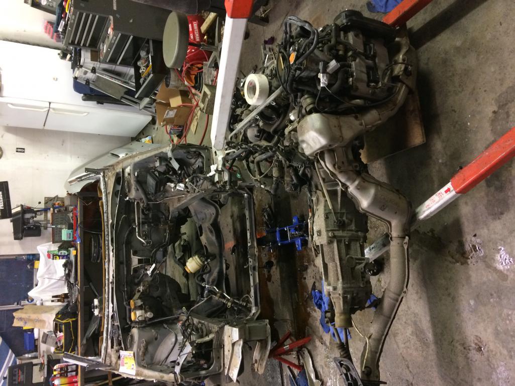

step 2 engine and trans out

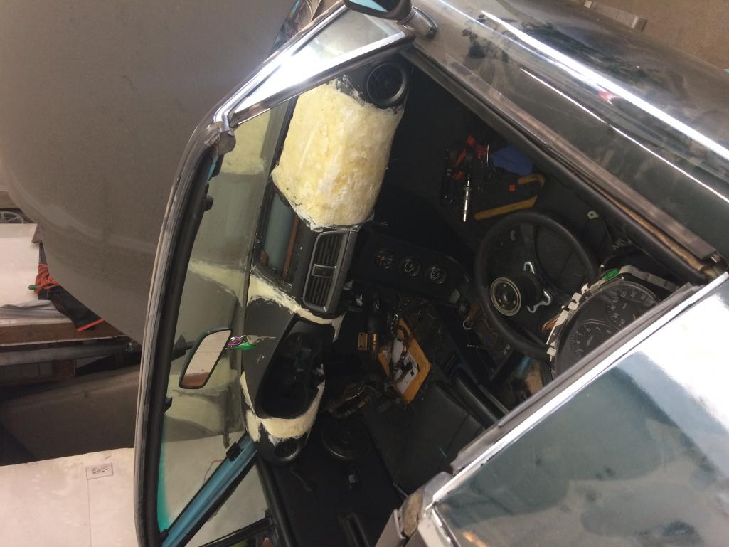

Decided to use the Wrx gages and dash but it was a right hand drive...fun to flip it all around and fit it all together. time for fiberglass and paint.

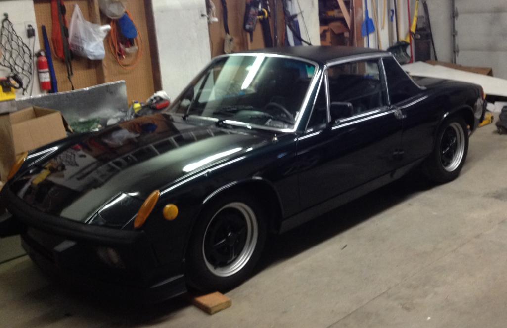

This will be fun to watch! Can we see the 914?
