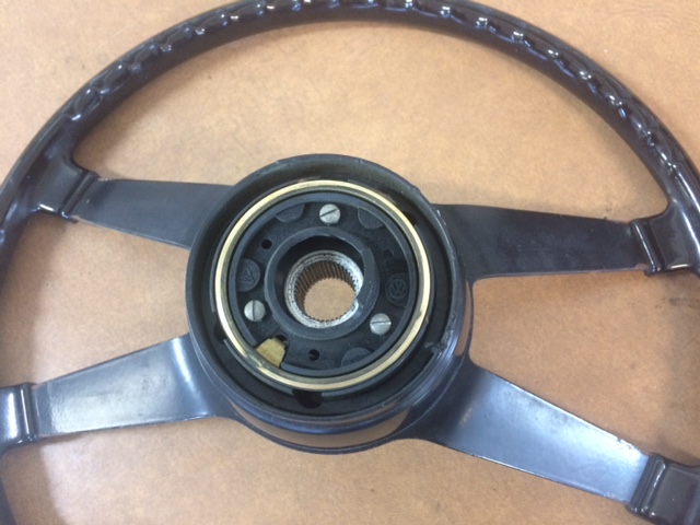

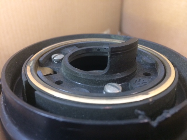

Changed out both the Directional switch and the Wiper switch in the 914 a week or so ago. Seems to be working fine EXCEPT - the wiper return to off capability still doesn't work.
I have the following steering wheel, part number 914-347-8041, a hard plastic phenolic ?? wheel with the following return post, see pics. Seems the return post isn't long enough to mate with the switch mechanism. Is it broken off or is there another part I should be looking for ??

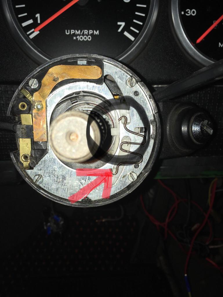

mzalanka   I have dealt with this same issue. It shouldn’t ...   Dec 3 2017, 12:32 PM
North Coast Jim   I have dealt with this same issue. It shouldn’t...   Dec 3 2017, 01:12 PM
mzalanka   Ok good. You’ve ruled out a problem with the swi...   Dec 3 2017, 01:27 PM
SirAndy   the wiper return to off capability still doesn...   Dec 3 2017, 01:23 PM
North Coast Jim   [quote name='North Coast Jim' post='2554193' date...   Dec 3 2017, 03:02 PM
North Coast Jim   [quote name='North Coast Jim' post='2554193' date...   Dec 3 2017, 04:08 PM

Valy   Is the canceling tab on the steering wheel mounted...   Dec 3 2017, 10:54 PM
Jonathan Livesay   Is the canceling tab on the steering wheel mounte...   Dec 4 2017, 10:43 AM
barefoot   Is the canceling tab on the steering wheel mount...   Jul 11 2025, 05:23 PM
North Coast Jim   Thanks all for the valuable input. Will try these ...   Dec 6 2017, 10:30 AM

914sgofast2   I had the same problem when replacing the turn sig...   Jul 12 2025, 02:57 PM
jim_hoyland   Thanks, good tips :) Were there supposed to be 4 ...   Jul 12 2025, 03:34 PM
914sgofast2   No washers under the switch. I was referring to th...   Jul 13 2025, 02:17 PM
