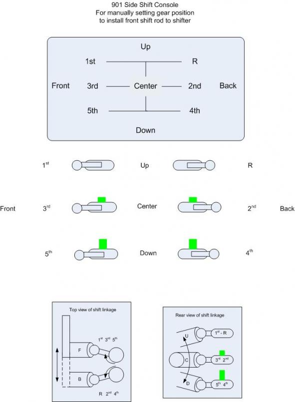

Follow up on Aarons question. I have rebuilt a spare...actually John Larson did the rebuild before he passed.
I want to bench test the slider engagement. Is there any position diagram that shows the shift lever position ...meaning at the trans and the gear No.?
Thought this might be on Dr. Evils CD?

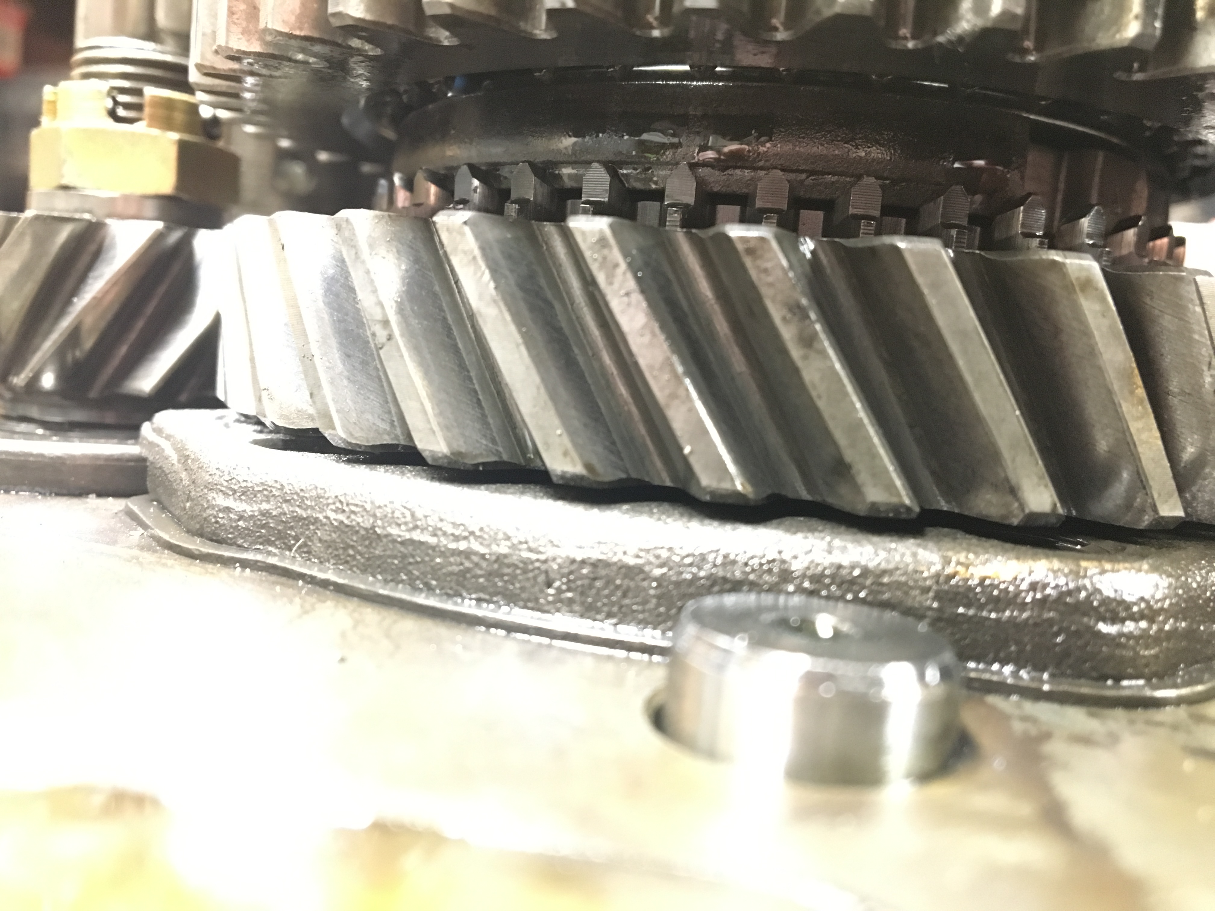

First gear synchro is worn on the replacement box and it’s obviously been apart as both gaskets on either side of the intermediate plate are torn.
I guess this will be the box that I do my rebuild on…

QUOTE(yeahmag @ Dec 13 2017, 06:34 PM) *
Wow...brand new 1st dog teeth and new 1st synchro band in there and your down about thyat? pull it on out and see if they did any more(prob not tho)
Montreal914
post Jun 13 2025, 10:53 AM
Posts: 1,841
Joined: 8-August 10
From: Claremont, CA
Member No.: 12,023
QUOTE(yeahmag @ Dec 13 2017, 07:34 PM) *
Question is; do you trust the thickness of that gasket between the intermediate plate and case? That is your pinion depth adjustment... (IMG:style_emoticons/default/sad.gif)
rjames
post Jun 13 2025, 11:21 AM
I'm made of metal
Posts: 4,280
Joined: 24-July 05
From: Shoreline, WA
Member No.: 4,467
QUOTE(914_teener @ Dec 13 2017, 06:58 PM) *
NARP74
post Jun 13 2025, 11:47 AM
Posts: 1,374
Joined: 29-July 20
From: Colorado, USA, Earth
Member No.: 24,549
Thanks for sharing that. I started making my own, pencil and scrap paper for when I need it. Lost the paper...

QUOTE(Montreal914 @ Jun 13 2025, 08:53 AM) *
If the gasket is black or grey I would say "no". If its tan and there is at least 2 of them, then, "maybe". I think a 1st gear job was done there and does have some miles on it but looks better than most. Since the gasket got separated I would go ahead and pull out the guts and see if the shafts have been unbolted before.
