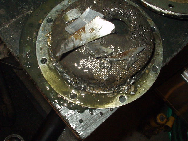

Car is a beauty but engine is a boat anchor. Pulled case drain plug and needed an umbrella. Out came about 3 quarts of water with a little oil residue. Been in there for almost a year. Pulled screen and found shrapnel. This engine was supposed to be fresh from Motormeister and in process of installation/conversion when the flash flood hit the shop in PA late last summer. Spoke to shop owner where car was when flooded and he said conversion was near complete but not yet running. Could "fresh" engine have been sent by Mm with the alloy "crumbs" included? JP and I think they are cylinder pieces rather than piston skirt. Won't know for sure until tear down. See my ad in classifieds seeking running engine!

The motor seems to be a 74 2.7L(normal), not the 2.2 as advertised. There was some rude language used when that stream of water came out the drain plug.
The odd thing was the upper end looks fresh.....grease (the wrong stuff of course) used on the return tubes has no dust or grime stuck to it....maybe the flood washed it clean. (IMG:http://www.914world.com/bbs2/html/emoticons/biggrin.gif)
Some where along the line, the thing pitched a rod, me thinks.

*Something* is funky here. The motor was supposedly never
run in a car. Jim was told that the first motor from MM was no gud so MM replaced it with this one.
Logically, the first motor would have to have been run to come to the bad motor conclusion. One would think that to accept this one, they would run it. The was a good collection of shrapnel around the screen which would be drawn there by the pump.
It's possible that MM replaced the busted cyl (and piston prolly), did a top end and buttoned it up with the shittage in there. (IMG:http://www.914world.com/bbs2/html/emoticons/blink.gif) It would run, I think......hard to believe tho.

I have to admit, I don't take the screen out and clean it every time I change oil. Lay a flashlite on it & if it's clean, I leave it in...in fact, it's never dirty or clogged. I take it out sometimes to run my finger over a low spot in the case to see what's setting in there. Just oil is gud......a layer of aluminum sediment
is not so gud (IMG:http://www.914world.com/bbs2/html/emoticons/sad.gif) . Chunks is definitely bad .
The oil pump would chew up any aluminum small enuff to get thru the screen......short term at least...it's a stout sumbitch.
