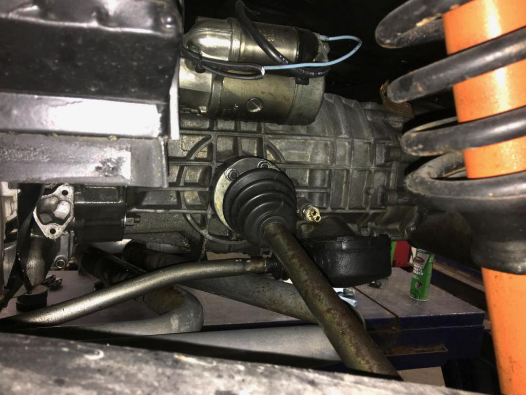

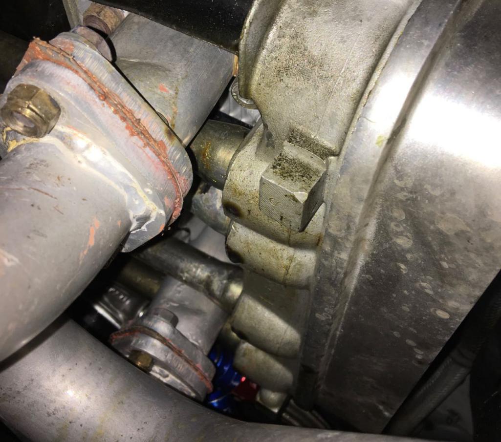

Mechanic road tested my car and didn't get the clutch to slip. The clutch slipping problem seems to happen less often than a couple months ago when the car first came here. What could cause that?

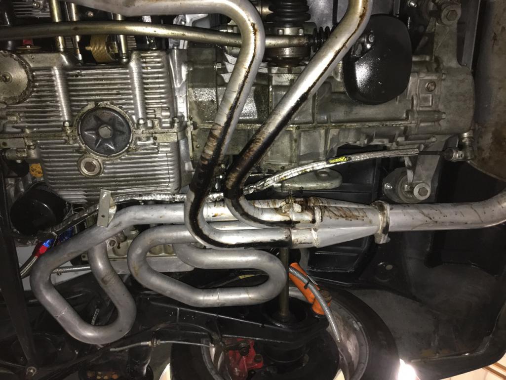

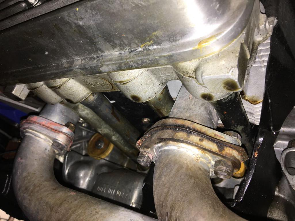

The engine seems to run nicely with the new Dellortos ... no idea why it's underperforming on the dyno. Here's the exhaust system. We're having a hard time figuring out exactly where the leaks are coming from. Someone else said he also smells transmission oil burning on the exhaust (it smells different?). The transmission fluid level was slightly lower than the opening when we checked it today.

If it is tranny fluid It looks like it coming from the front seal in the bell housing or the clutch pivot point. Either way you need to pull the transmission to fix.

First thing to do is figure out the leaks.

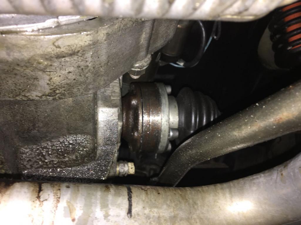

Looks wet.... gear oil has a distinct smell kind of like sulfur. Looks to me like either the
input seal on the transmission is leaking or the rear main seal on the engine.
Stick your finger in one of those drips hanging off the transmission and smell it...yuck. Easy to tell if its gear oil.

Rear main, trans out put, or ball pivot could all provide lube that could contaminate the clutch. Drop trans and check them all. Self healing clutch? I guess anything is possible. My experience has been once they start slipping they are done, but that has been on well used parts. You'll learn more about the condition of the clutch and flywheel once the trans is out.

Show us your rear main seal. I bet its oily.
And this will contaminate your clutch and allow slippage.
Also looks like your pushrod tubes may be leaking.

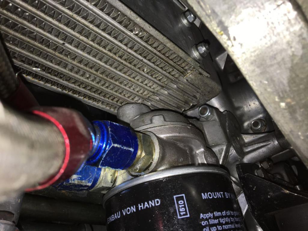

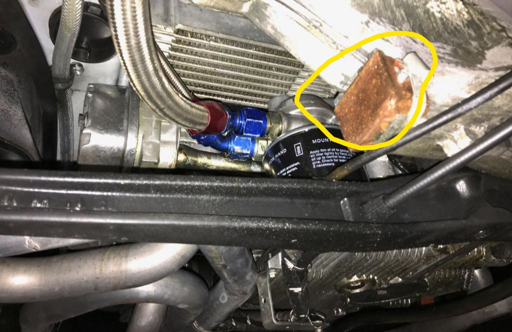

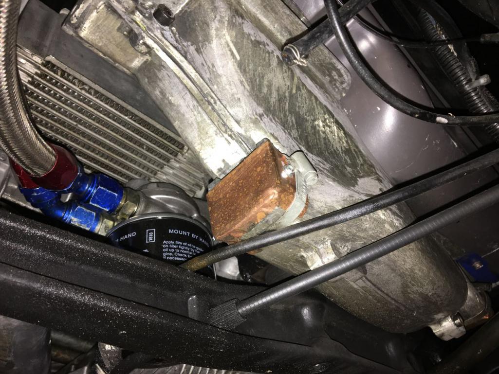

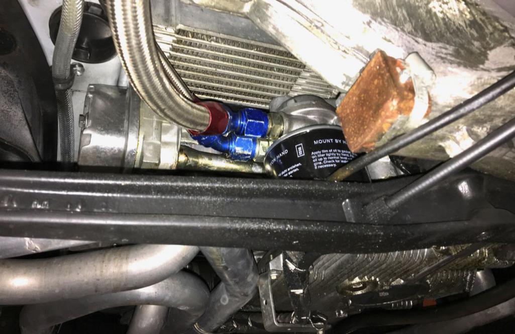

I noticed you have an additional oil cooler, if you remove these copper pieces that are blocking the air from exiting the fan shroud, your stock oil cooler will work properly. Trust me I've made this mistake before. That air has to escape out the bottom of the shroud (heater ports) for the cooling system to work properly.
