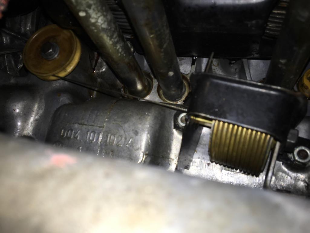

Yes, the car came from the San Jose CA area with a front oil cooler and those sealed shroud ducts. Maybe PO wouldn't have needed to add the oil cooler if he'd left those ducts open?
For two months here in Seattle the problem has been getting oil temperature up though. I've got that white milky condensation under the oil filler cap.
The air thermostat appears to reflect the correct cold position. I haven't found a way to test that the air flaps are actually closed with the tin on.

You absolutely need the external cooler with that displacement.
In fact, the stock cooler is almost no help compared to a front mounted cooler.
Another thing to consider - sandwich plates for external cooler take-off may create a separate issue related to cooling: Backpressure from the external cooler may cause all the oil to bypass the filter and the cooler. That's because of the bypass valve in the filter bracket which opens at a fairly low pressure differential.

Uh oh — would this also keep the filter from working?
What’s a better way to set it up?
In two months of ownership in the winter here, oil temperature slowly creeps up to 80ºC, then doesn’t budge above that. I have assumed there is an oil thermostat at work, as one was supposed to come with the Patrick Motorsports kit a previous owner bought.
