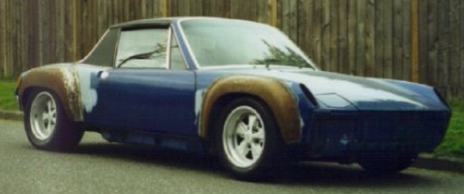

QUOTE(sixnotfour @ Feb 17 2018, 01:59 PM) *
some pics, 15x8 RSR weidman, I added a single piece form another Fuch, single seem, Now 15x9... 15x8 with inch addedd to inside.....
They look good. Will these fit rear GT flares?
they will not fit PMBs 914.... evidententally your not getting it...when it comes to anything other than a 15x8,,,,tire cross section is huge....16x9 usaully fit. but they really never made a decent sized street tire , most 245/16s might as well be a 225... back in the 90s
the GTs with race tires there are 2 types period correct or lower profile modern......if you look at the GTs that the wide Minilites/big rubber in back you have to know there has been some work done....
that said the inside 9s, at least you can shim in and out.. unlike an Factory 15x9
when you see a combo you like request a measurement from inner fender well to inside outer fender..then you have some facts....
I have 2 GT's can run all the same tire wheel combos, one is factory GT flairs, the other is also factory GT flairs, but with 1.5 added, lots of room .
only a finger close on the the other GT,,,,,

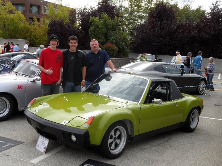

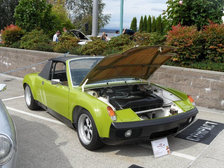

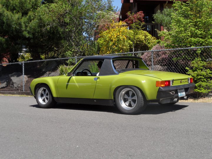

both pics both have the same wheel and tire..
Factory 15x9 Fuchs
245/50 x 15 bridgestone RE71's

Eric PMB has real tight GT fenders 15x8 max......
My Green GT has real GT fenders real 15x9 245/50....
the 15x9 with1" inside added = 9 was an attempt to put a bigger wheel under Erics GT,
that ended me with the wheels,,so no/yes will they fit

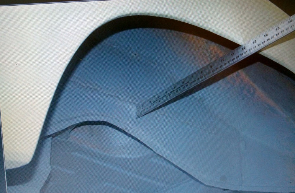

You will never know your fit limit without this measurement, Start a measurement chart tied to fitment is you real answer
Thanks Armanondo, I borrowed a photo..........

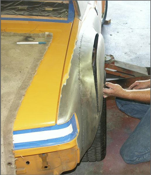

ok makes more sense. I widened my AA GT flares by 9.14mm in the rear and reduced the size of the inward pointing fender lip to mimic the thinner factory flare lip.
I will take that 'armando' pic measurement and post my numbers in a bit (IMG:style_emoticons/default/smile.gif)
I widened using similar method to this 'armando' site pic below.

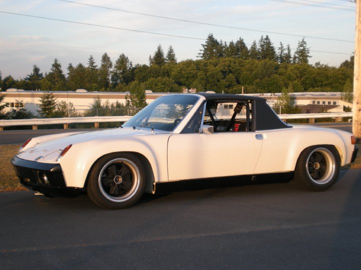

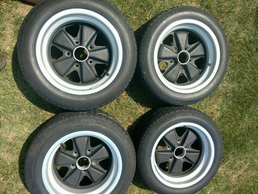

NOS 9 & 8 x 15 with 225/205 x 15 P7s (IMG:style_emoticons/default/smile.gif) 5k

nla pirelli sport cup 225/205 x 15 on 9 /8 x 15 Fuchs, my GT

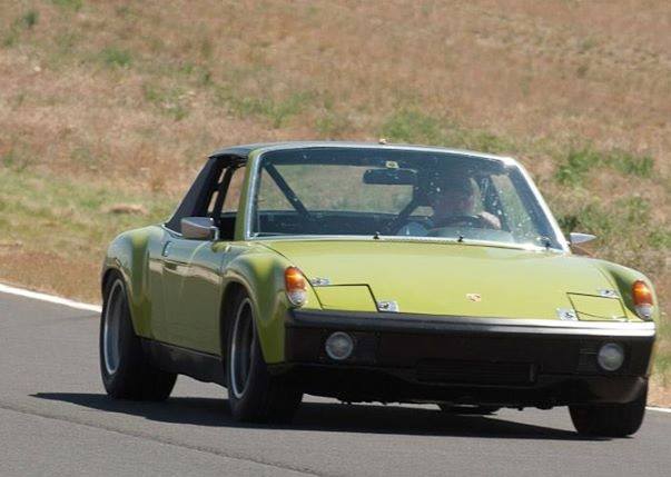

9 / 8 x 15 Fuchs 245 / 225 x 15 bfg dot R1's old
gothspeed
post Feb 21 2018, 09:57 AM
Post #115
Posts: 1,539
Joined: 3-February 09
From: SoCal
Member No.: 10,019
QUOTE(sixnotfour @ Feb 21 2018, 04:17 AM) *
8's & 9's and ride height look great on the white car! (IMG:style_emoticons/default/beerchug.gif)
Do the wheel lips sit proud from the tire, on this wheel tire combo (9 & 8 x 15 with 225/205 x 15 P7s) ?
QUOTE(sixnotfour @ Feb 21 2018, 04:39 AM) *
Do you have any side view shots of this tire combo (9 / 8 x 15 Fuchs 245 / 225 x 15 bfg dot R1) ?

BTW the white GT and the green GT same 914..

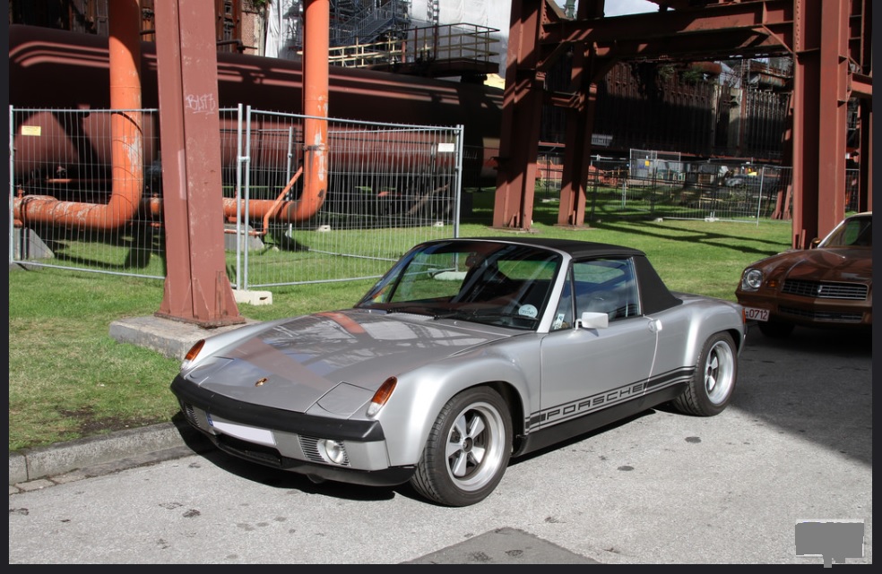

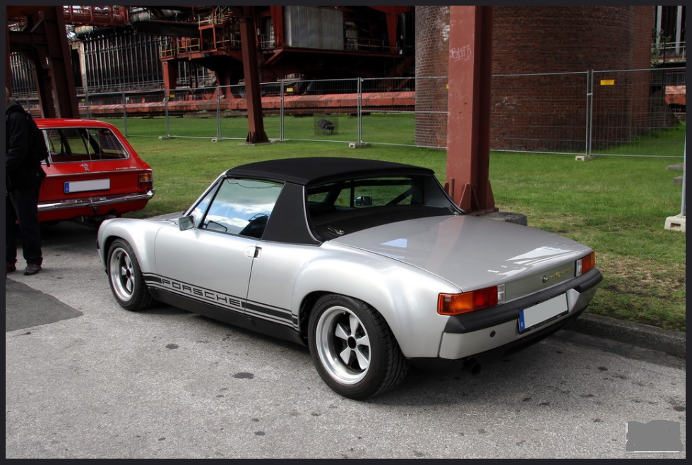

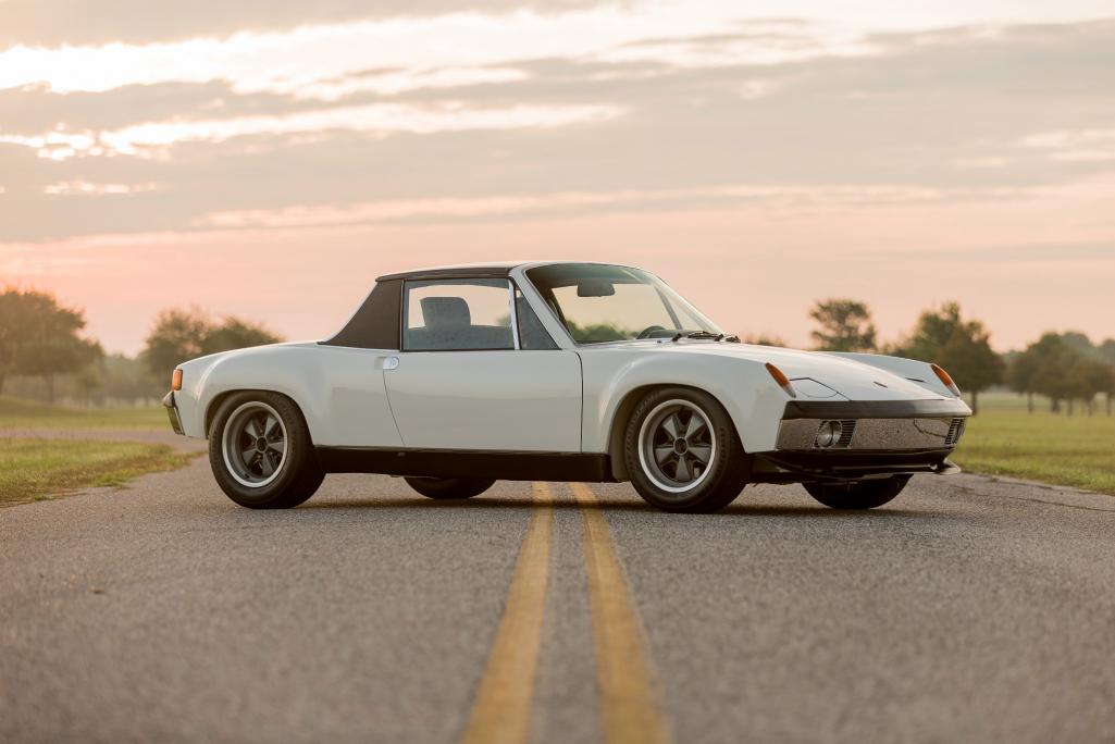

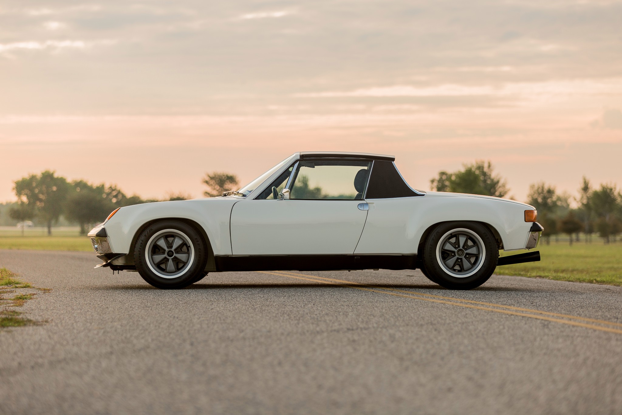

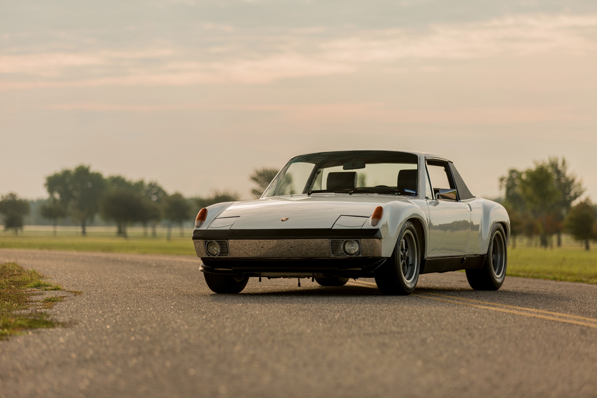

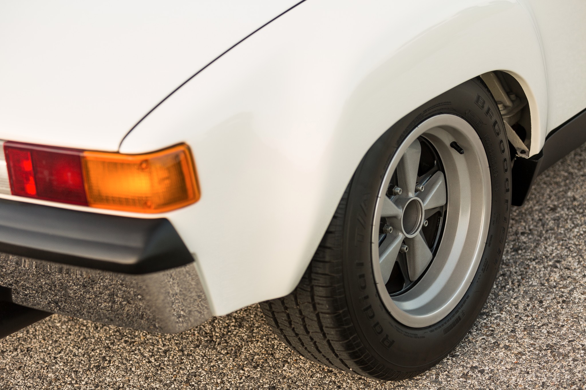

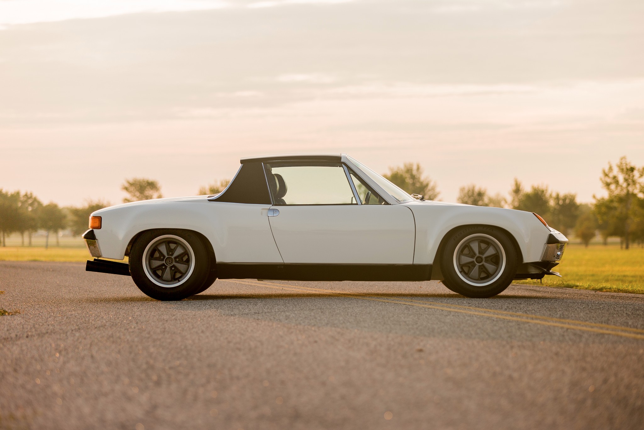

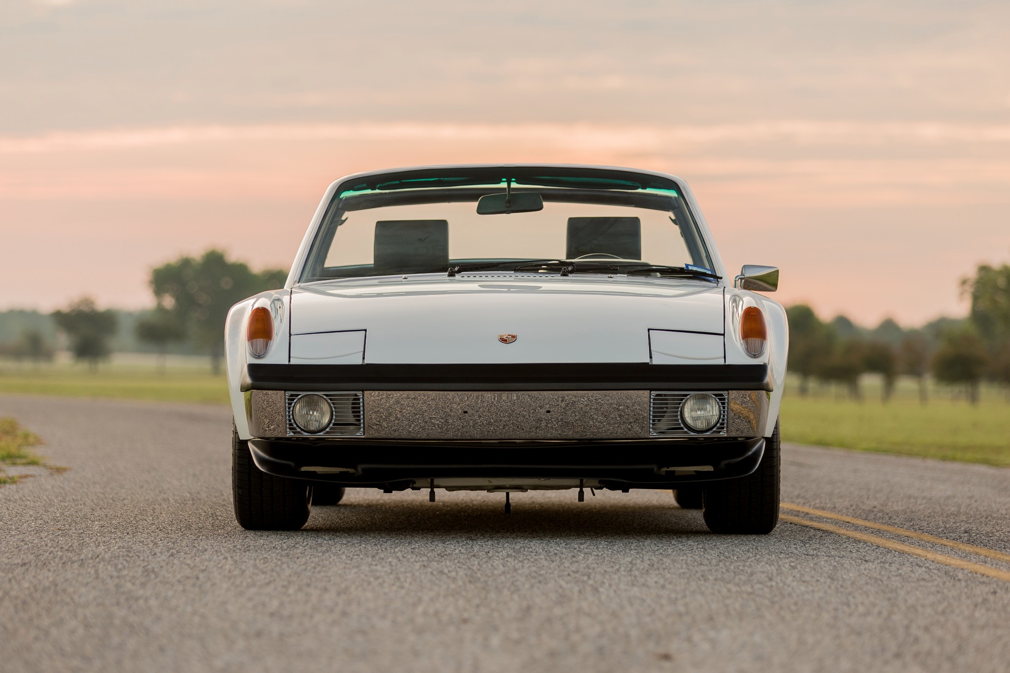

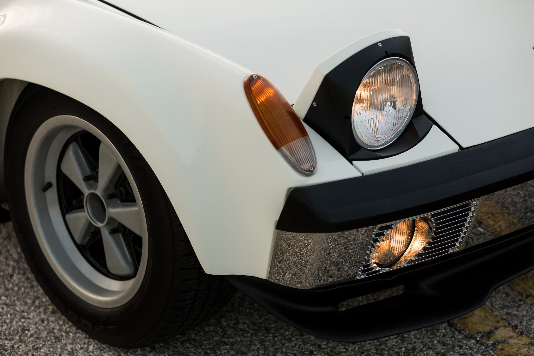

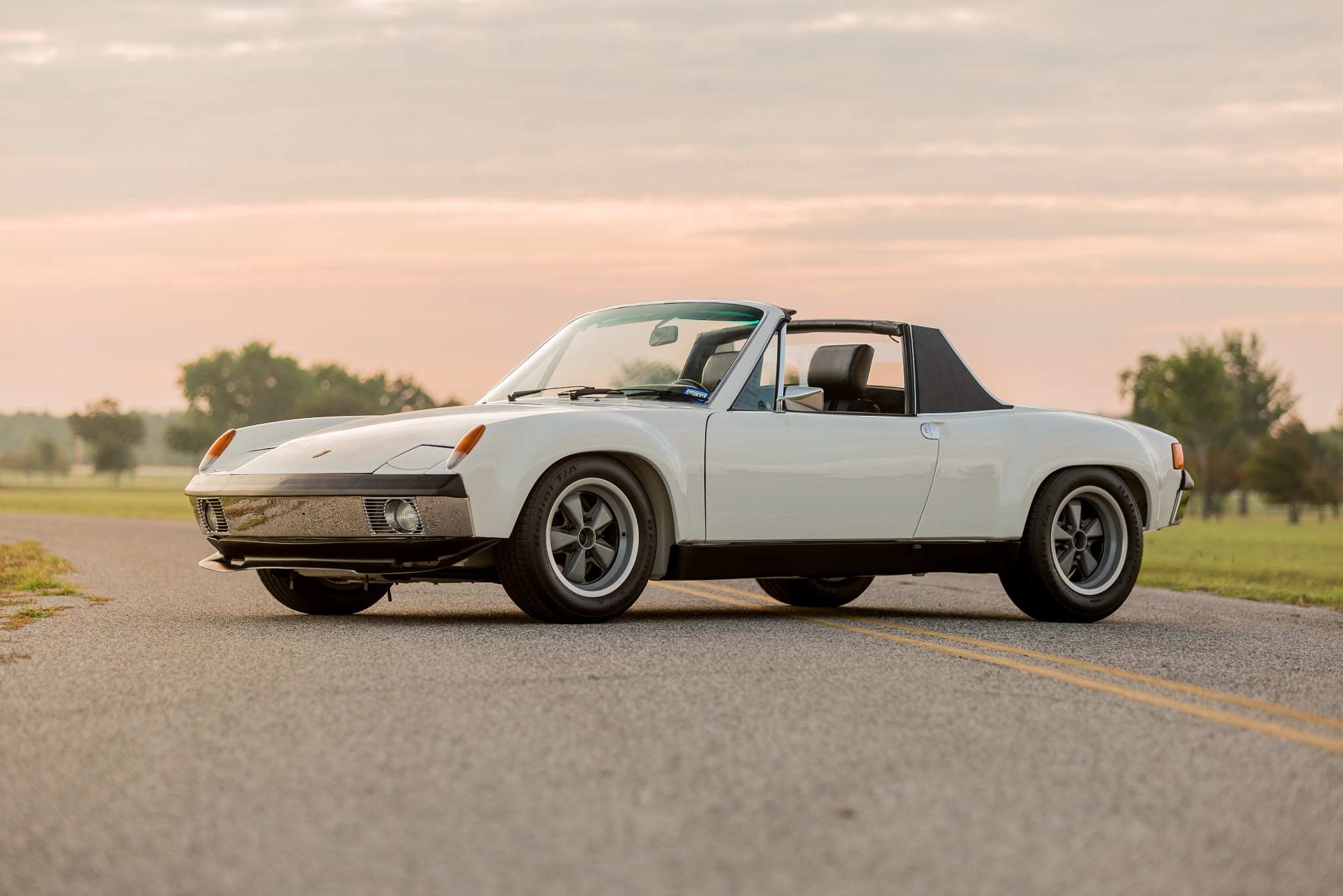

More GT pics! 7s & 8s x 15 (zoomed on rears and size looks like 225/60-15)
pics source:
https://bringatrailer.com/listing/1975-porsche-914-6-gt/
Attached Image Attached Image Attached Image Attached Image Attached Image Attached Image Attached Image Attached Image

8x15’s are pretty cheap, 7x15’s are getting pricey. 9x15 are just expensive.

QUOTE(mepstein @ Feb 22 2018, 09:38 AM) *
Due to tire options and wanting to keep the drivetrain and un-sprung weight on the lighter end of the scale ... it appears 7s and 8s are winning out (IMG:style_emoticons/default/smile.gif) .... I also do not want to tax the chassis and suspension too much with excessively wide/soft rubber. (IMG:style_emoticons/default/beerchug.gif)
another (7s & 8s x 15):
