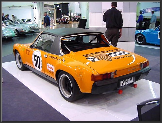

More pics (IMG:style_emoticons/default/stirthepot.gif)

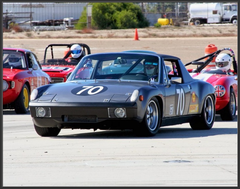

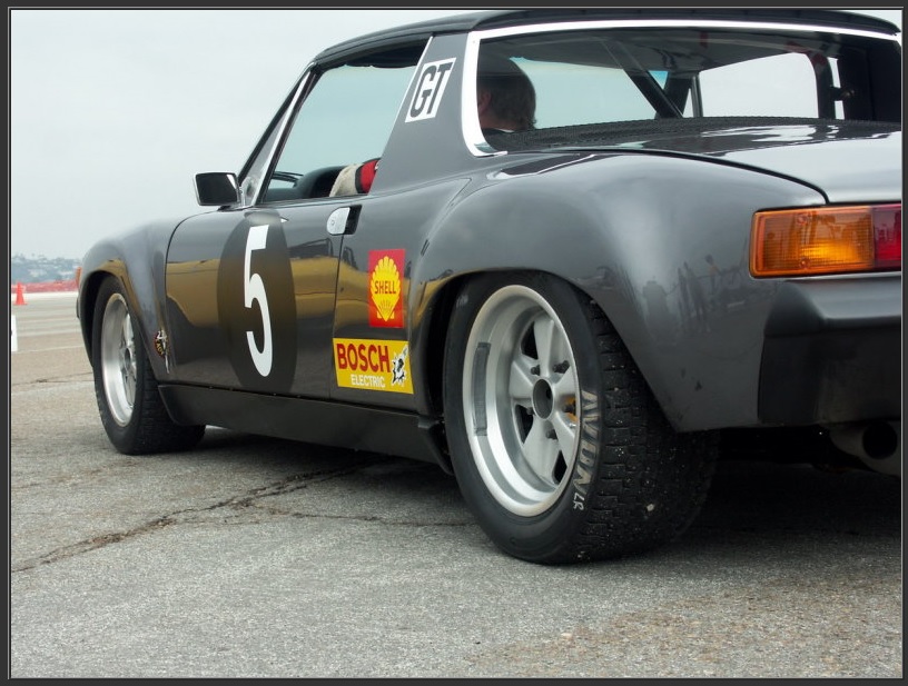

I've been hearing for years that 16x6's -- which used to be the cheap undesirable ones -- have been swooped-up to make custom 3-piece 17's and so forth.
Here's part of my stash off and on the car. I exclusively use 15x8" Fuchs and 15x9 Braid now and have some black centered and some RSR style.
(IMG:http://www.914world.com/bbs2/uploads_offsite/farm5.staticflickr.com-21-1516857853.1.jpg)
(IMG:http://www.914world.com/bbs2/uploads_offsite/farm5.staticflickr.com-21-1516857853.2.jpg)

^^^ awesome!!! so those are 8s & 9s x 15 in the pic above? any spacers used?
