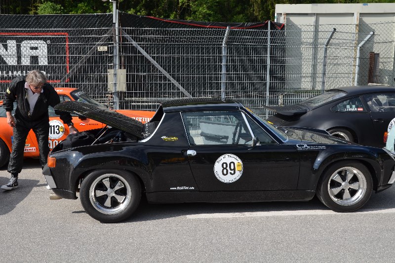

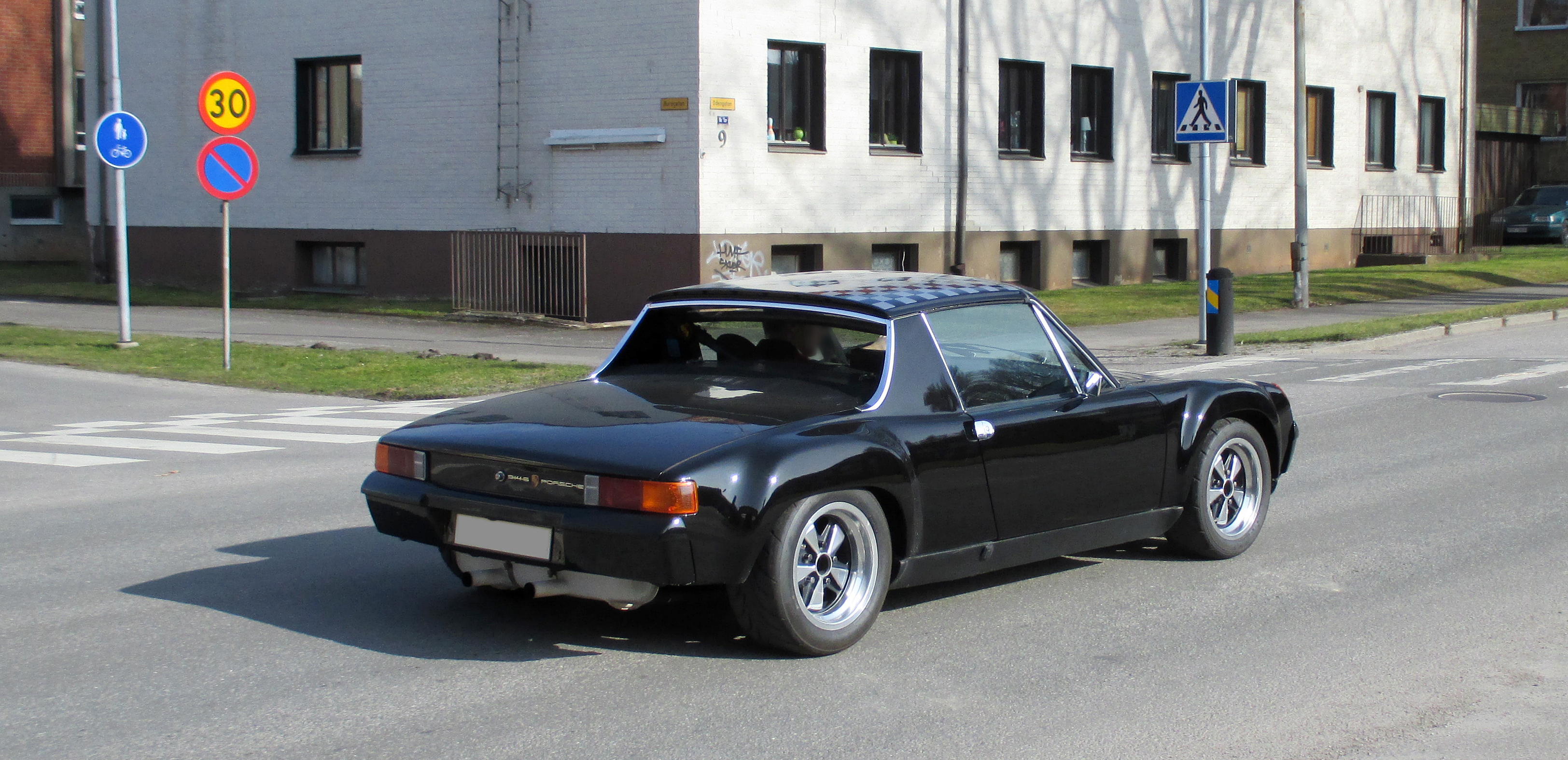

Wheels look like 7 & 8 X 15 ... Do you know what tire sizes are on the Adriatic blue car? (IMG:style_emoticons/default/smile.gif)
Anyone want to guess tire sizes on these black beauties below? (IMG:style_emoticons/default/sunglasses.gif)

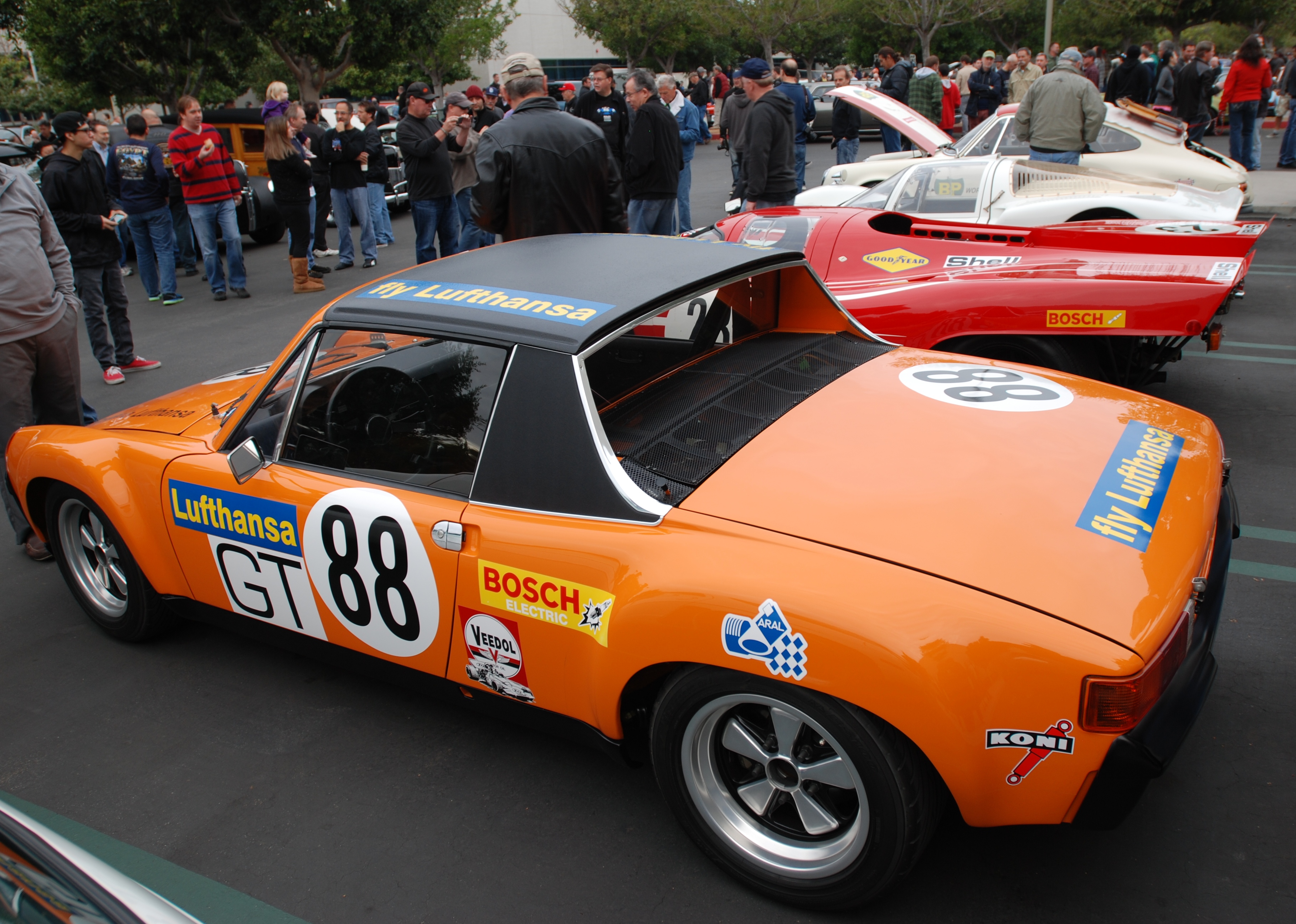

The orange car has nice looking wheel/tire choices and the black car also has wheel/tire choices that look 'just right' IMO.
Orange car are 8&9 x15 wheels but I have not seen tire sizes.
Black car wheels seem to be 7&8 but because of the side view they might also be 8&9 x 15s
Now if I can figure out the tire sizes for both of these ... (IMG:style_emoticons/default/idea.gif)

Orange one is chris's/campbellcj car

On the Blue GT car, the rear is 23/62R/15
I can't quite make out the front
18/80R/15 ?
Looks like they may be MICHELIN TB's
TB15 or TB5 tread
18/60R-15 = 215/55R15
23/62R-15 = 270/45R15
Coker Tire is making them again...see what you think
Chris needs to post his tire recipe! (IMG:style_emoticons/default/smile.gif)

QUOTE(mepstein @ Feb 8 2018, 12:37 PM) *
Hi all,
On my Phoenix Red racecar #673 above, the tires I'm currently using are:
Hoosier Circuit Racing Radial Slick, S80 compound
P/N 43558 215/580R15 Front
P/N 43568 245/580R15 Rear
Previously I used the Hoosier R6 in 225 Front and 245 Rear. I wanted to jam a 255 or 275 in back, but they wouldn't clear.
Before that it was a narrowbody car and I ran whatever Hoosier Rx flavor was current at the time, in a square 205 front/rear setup on 15x7's. The rear fender lips were rolled and slightly pulled for clearance back then.

Here is a flared -6 with what looks like 8s x 15 all the way around (tires are 225/50-15)
