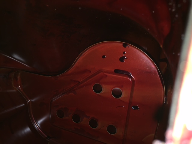

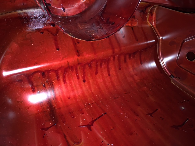

Had mine done 2 years ago. Ran all summer with no issues with the
gas in the CIS system.
Some pics:
