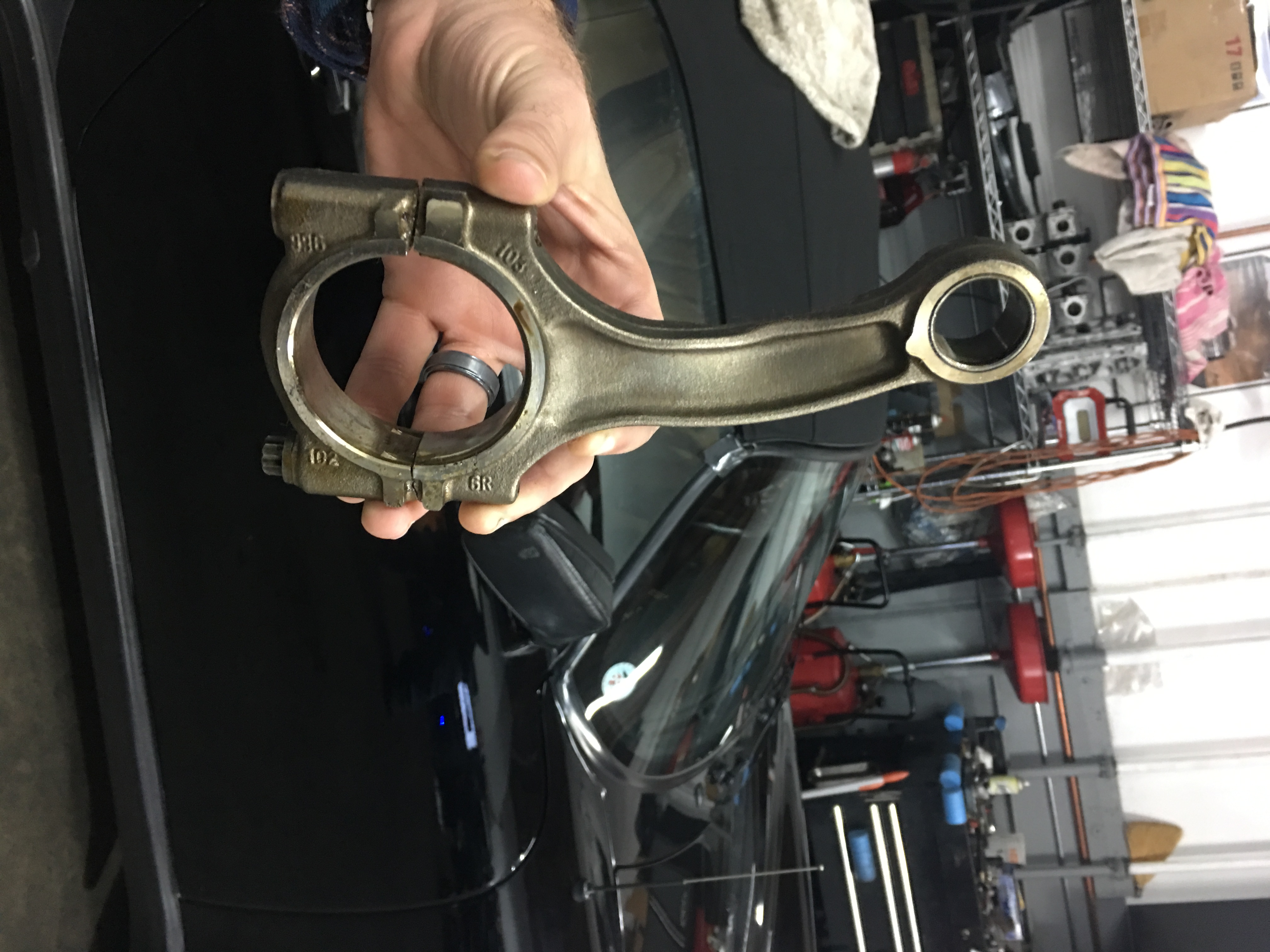

The good news is that rod was not from my engine... The bad news is it is not the ring and I am on my second new relay in as many weeks. (IMG:style_emoticons/default/confused24.gif) (IMG:style_emoticons/default/beerchug.gif)
