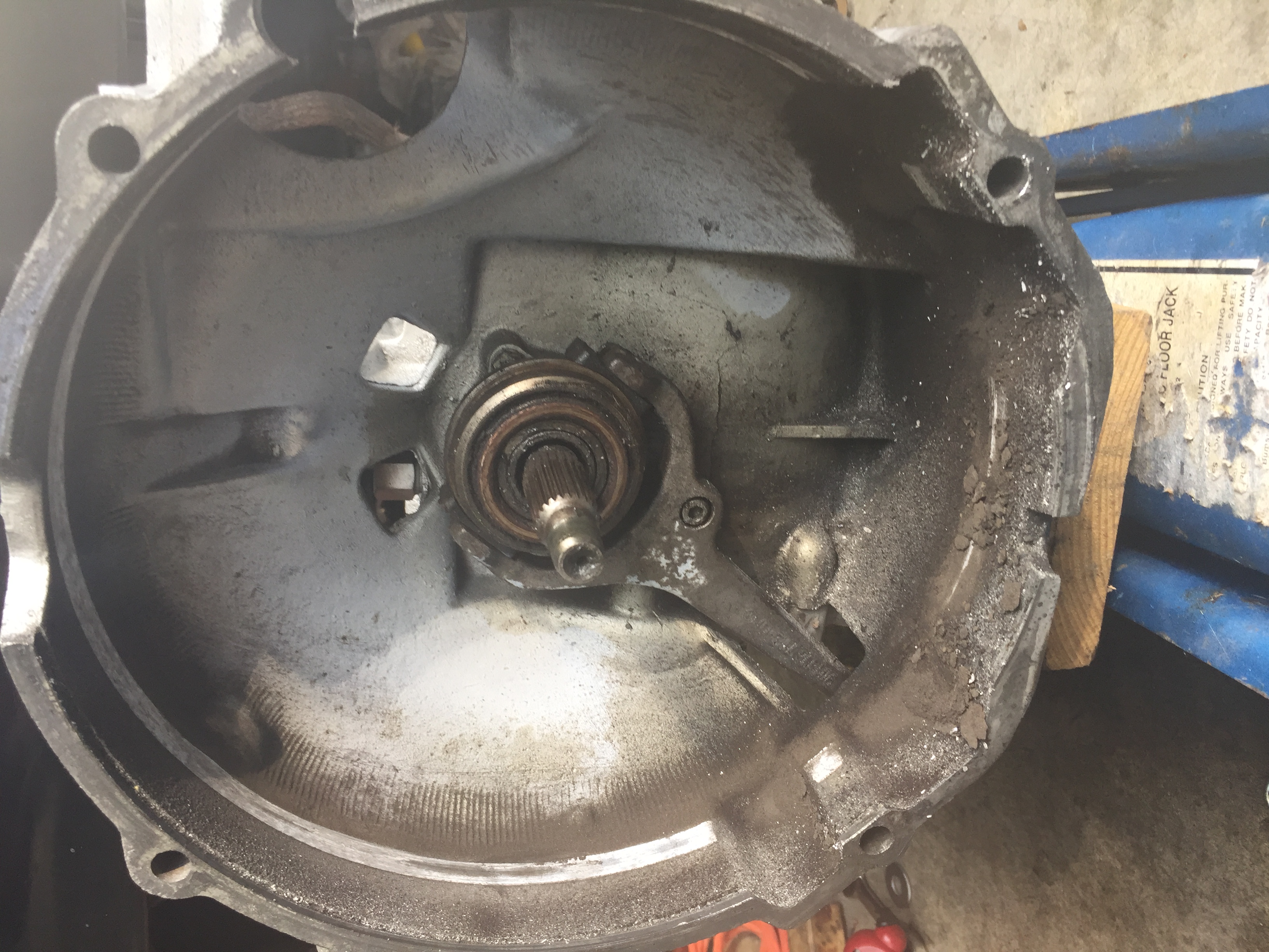

Anyone got spare engine? Spun rear main bearing I think. So loose fly whell hit trans case.
Looks like I am done.

Anyone got spare engine? Spun rear main bearing I think. So loose fly who’ll hit trans case.

Sorry to see this. Maybe the flywheel is loose? That’s a lot of radial travel!

A spun bearing would cause a dull thud in the engine when running. For the flywheel to hit the bell housing would take a lot of travel, and it would lock up due to the rod journals hitting something in the case.

Well it did not lock up but chunks of bearing in sump. Dropped it out a stripped it down. I have a rebuilt 1.7 of unknown quality but just can’t see me getting it in before Thursday and driving it. Looks like I will be having beer at the Hotel
