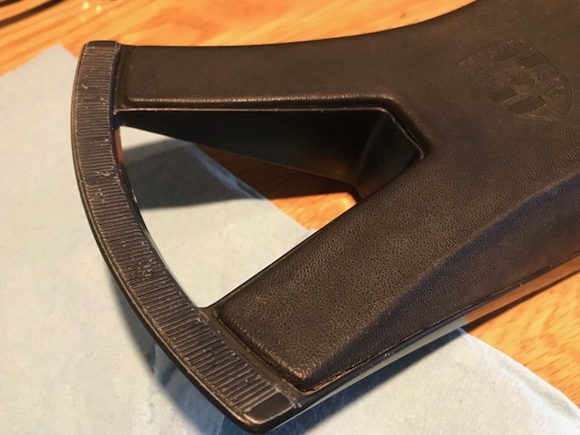

I'm having my steering wheel recovered so would like the trim on the horn pad to look better as well. The steel parts, especially the grippy areas for activating the horn, are missing some paint (not from me, I only use the horn when it's well-deserved). Has anyone painted the steel areas on the horn pad? It looks like a flat black to me but it seems every other black piece on the car was originally satin. Anyone know the correct color black? Here's the current condition of mine:

Pop the foam pad off the frame from the back ( I use my thumbs) and paint the frame with black satin truck m paint. Use a strong contact adhesive to glue back the foam.

you can use a thin butter knife to help separate the foam form the metal. The rubber is old, so you are correct in being careful (IMG:style_emoticons/default/smile.gif)

I carefully masked my foam pad and the results were perfect.

The foam separates easily. We use a Wolfsburg West grey black VW spray. Perfect match.

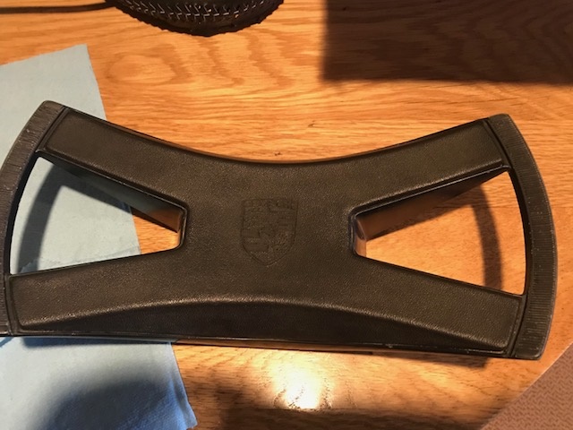

Well, I got the foam separated in one piece! Thanks for the tips. A cheese knife really helped. Below are the separated pieces.
This raises some more questions:
1. Does the old contact cement need to be removed from the foam for proper adhesion? If so, how does one remove it?
2. The foam smells like an old 914 that sat for a long time with other species living in it. What's the best, and safest, way to clean the faom and reduce the smell?
3. So the frame appears to be aluminum. Is the best practice to bead blast it or is aluminum too soft?
4. Is 3M Super 77 strong enough to permanently hold the foam on or should I get something better?
post Mar 23 2018, 10:26 AM

Bead blast the frame. I have some that have already been blasted and repainted if you need it.

The cement will come of the frame when you blast it. If its flaking off the foam, you need to remove it. If it's secure to the foam, I would just recoat. Make sure to follow instructions.
