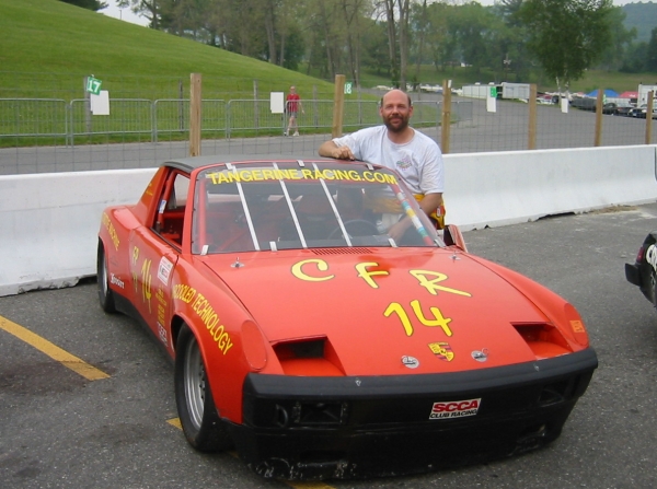

and a pic of Ed Givler's car on the pre-grid.

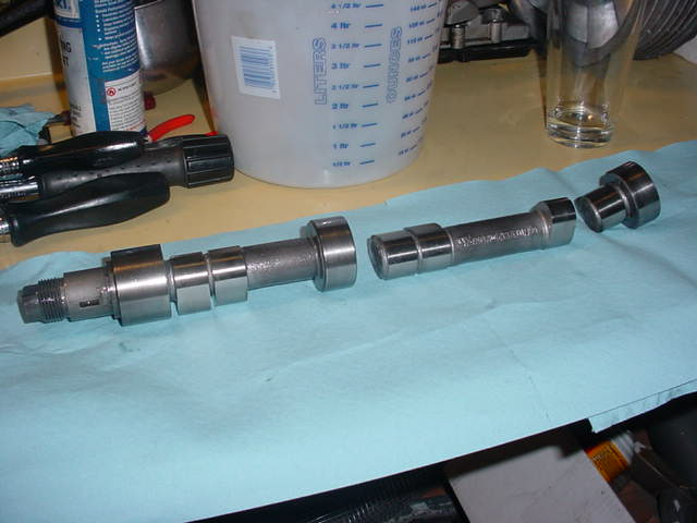

After some checking it appears i have broken a cam shaft between the center and the rear cam journal the camshaft is just loose in the housing. So the entire engine must come apart. Time to change cam grinders, Maybe this is a cam tower issue, but they felt really good when I assembled the motor. We'll see. Hope to make it for Watkins Glen. What a bummer! All the heads and everything else seems to be in good condition. So we'll see if a housing and a camshaft will fix what is ailing me.
I have all the parts except the camshaft. I have that as a core.

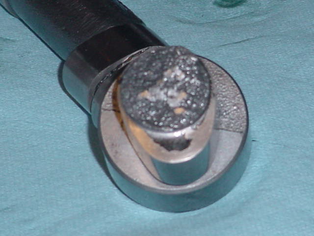

I am always one to promote personal responsibility! Own your actions and guide your life accordingly. However this camshaft failure I can't swallow as mine. It appears that when the cam was ground that a small radius groove was cut on all of the cam journals. This created a stress riser and caused this failure. The Cam tower housing is in near perfect condition with no odd wear patterns except the damage from where the cam shaft broke (it is limited) with some 600 grit on the edge of the aluminum journal it is re-useable. I will be calling the cam grinder in the AM. And Next Day airing him the broken camshaft. Really kind of pisses me off. Could have done without this problem. But thats racing. See the pics.
Erik
Thorshammer
post Jun 12 2005, 09:18 PM
Post #32
Posts: 756
Joined: 11-November 03
Member No.: 1,335
Not the best focus job, but you get the idea.

WOW I have never seen a 911 cam break
never...
is this one of the west coast cam grinders?
Thorshammer
post Jun 12 2005, 09:49 PM
Post #34
Posts: 756
Member No.: 1,335
Tim,
Me neither! I have built many 911 engines and have never seen this. I have seen cam journals scored and worn oddly from incorrect cylinder height of cylinders or cylinders that have not been torqued down properly. But this is not the case with this engine. The cam tower journals look good with no unusual wear. The only thing that points to a problem is this one incomplete radius next to the middle main bearing on the cam. All of the lobes look great, nothing wrong except it broke. I am even using the cam grinders springs, which My machinist really liked and said they were excellent./ Everything was set to the cam grinders spec. And I will say worked pretty good. It could be better.
My biggest dillema is this, do I disassemble the motor the rest of the way. Or flush it, run 14 qrts of petroleum oil through it and take my chances. it has an Oberg filter and it does have metalic flakes in the filter but it is not rod bearing material. it is not full but has maybe a 1/4 of a teaspoon of metal in it. I am unsure of the obergs ability to catch particles. I will remove the oil tank and check it tomorrow. That will give me the best indicator. ? What Would you do?

Seriously though, at a minimum it would seem prudent to remove the other camshaft for a close inspection.
Did you run a magnet through the filtered particles?

I know that Chris is running an engine on it's last bit of life whiole we continue to fight some issues with his MassIVe engine on this end as well as the hooplah that the Nickies cylinders have added to the suspense as for as legality goes.
Chris will have his "A" engine back sometime very soon, I am waiting on one component for it that should be done within the week.
Erik, Sorry to see the broken parts- It proves that even the -6 engine can and will fail in a Production race venue and that as convventionally believed they are the bullet proof "Failure proof" way to go!
I have never broken a Type IV cam, unless you count the ones that were involved with being chopped in two with a connecting rod :-)
In racing, ANYTHING within an engine can and will break, and if you don't break it either the engine wasn't modified enough or a pussy was behind the wheel not working it hard enough!
I just wasnted to stop by and see how you guys did over the weekend- I'm not back yet and won't be for atleast another 6 weeks as I have to finish Chris' engine and also Tom Burdge's run offs engine before I will even have time to breathe... By that time Len will have Kevins heads finished and it'll be time to assemble the most bad ass 2.0 on planet earth!
BTW- Erik, Tear that engine down 100% and ensure all the grit is out of it before you experience failure #2.. I have learned to NEVER take chances on this level!
Also, send me the replacement camshafts to have magnafluxed and cryoed- This won't happen again if you do.
