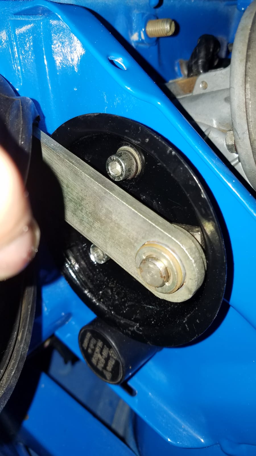

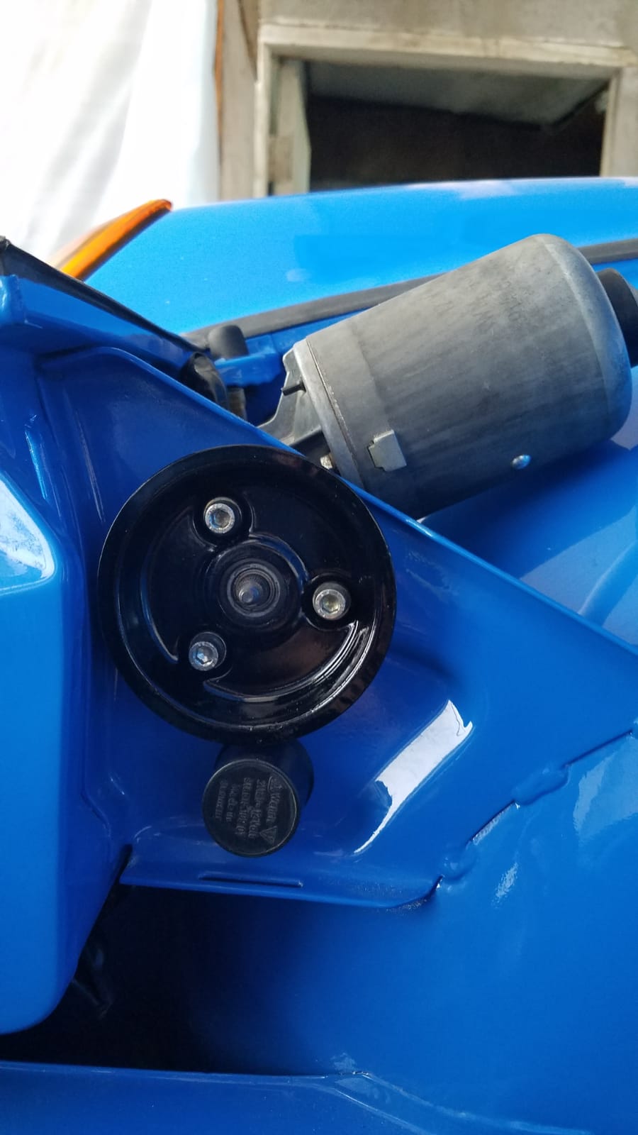

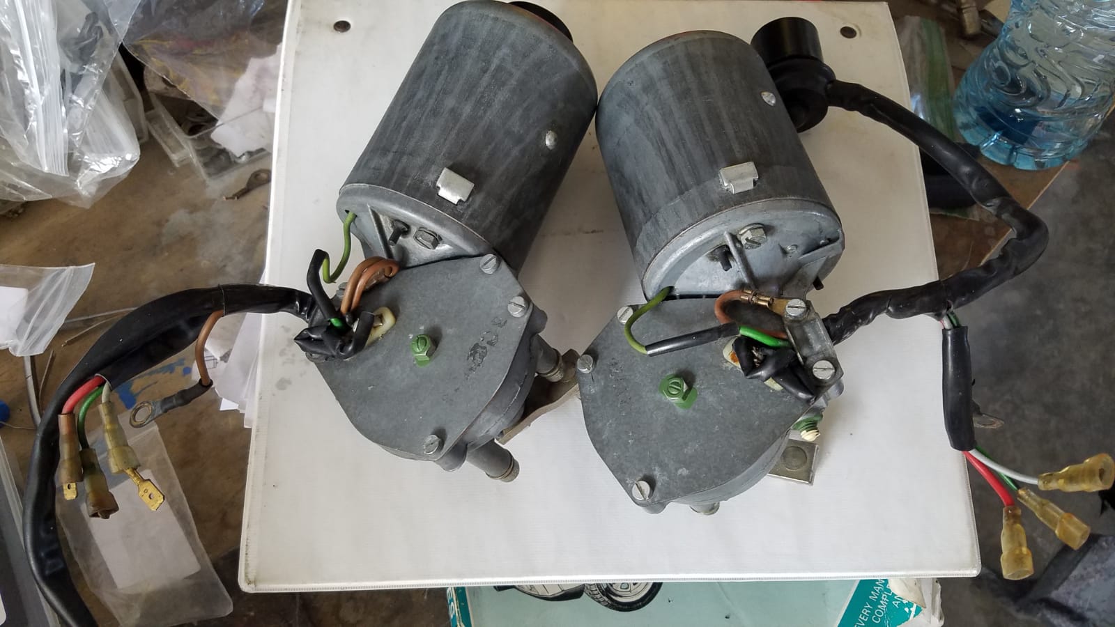

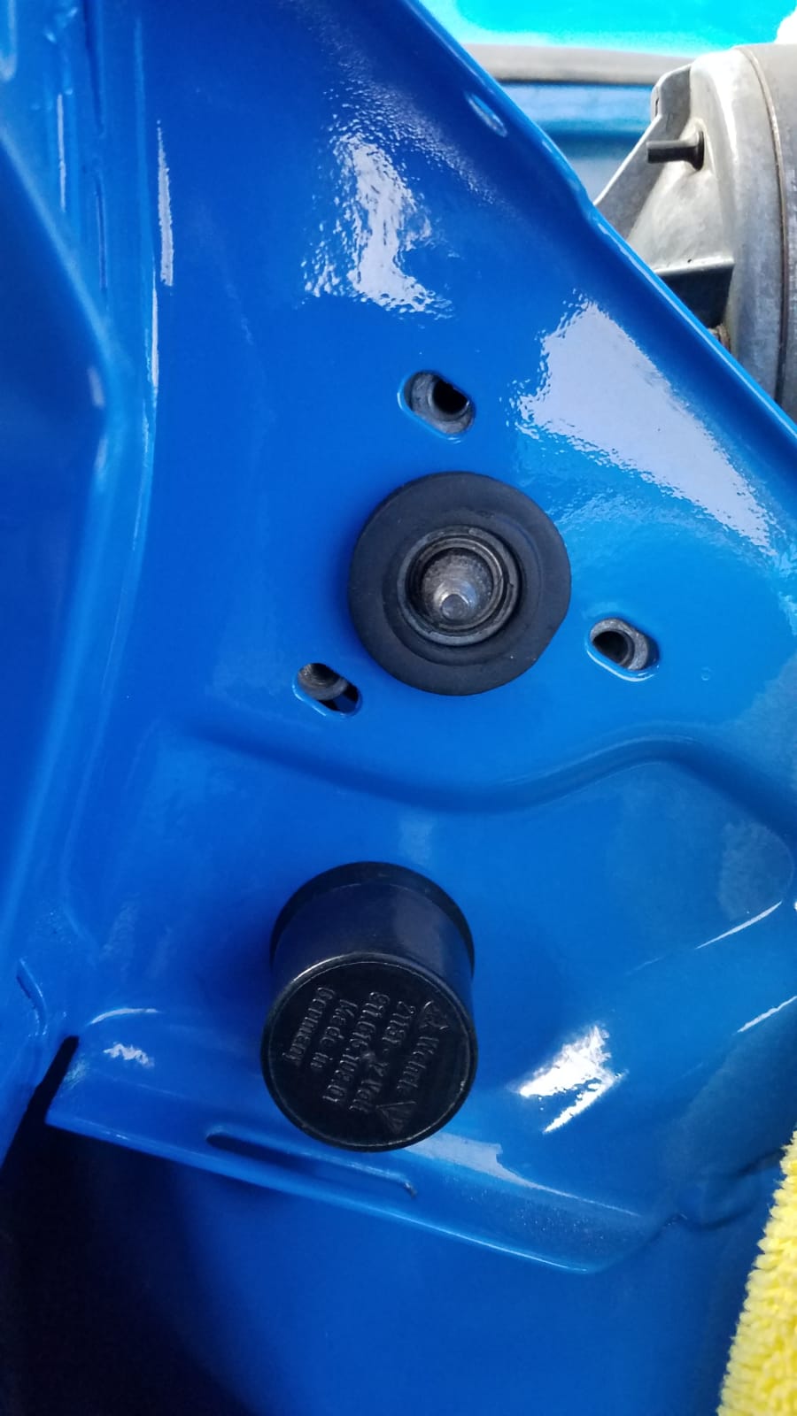

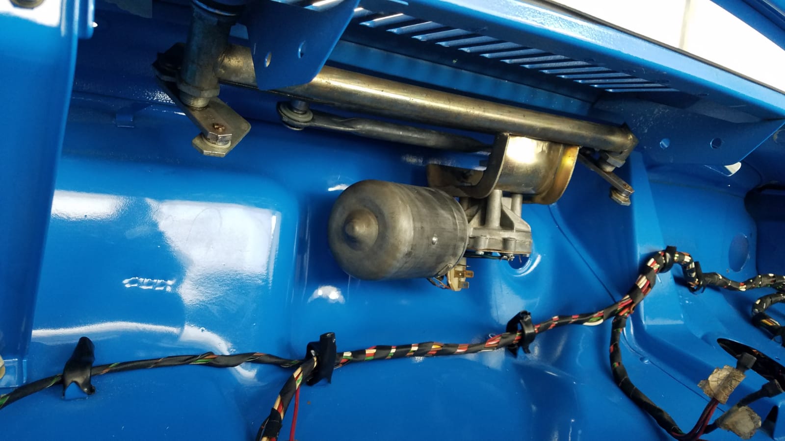

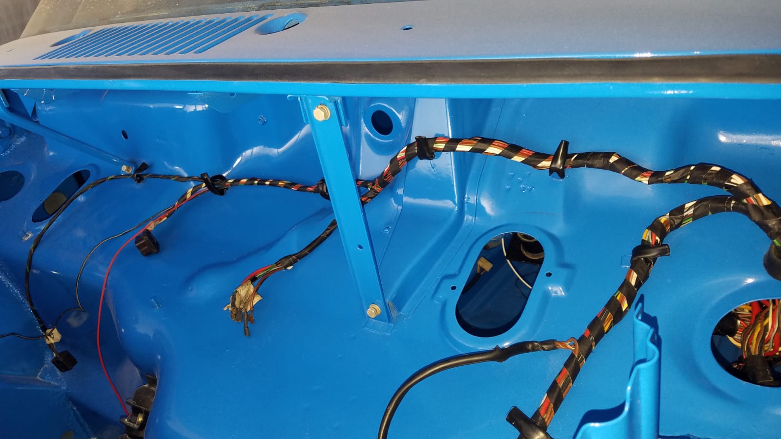

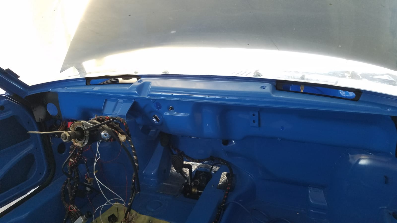

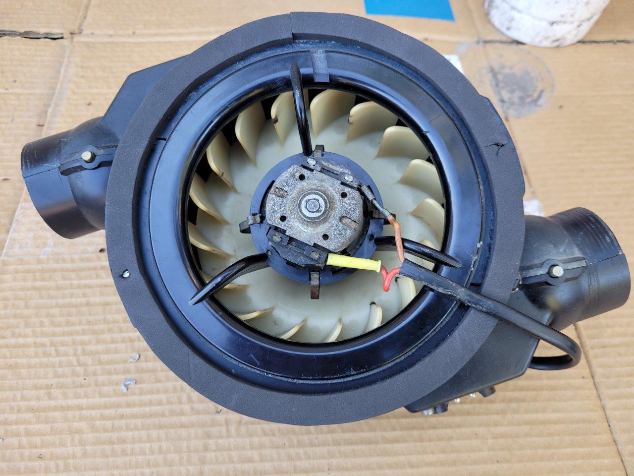

Worked some more on the harness and also the windshield wipers
Cleaned up and installed
New hardware from 914 Rubber

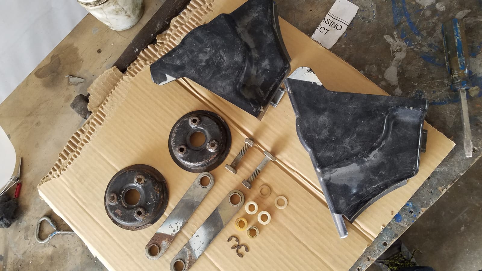

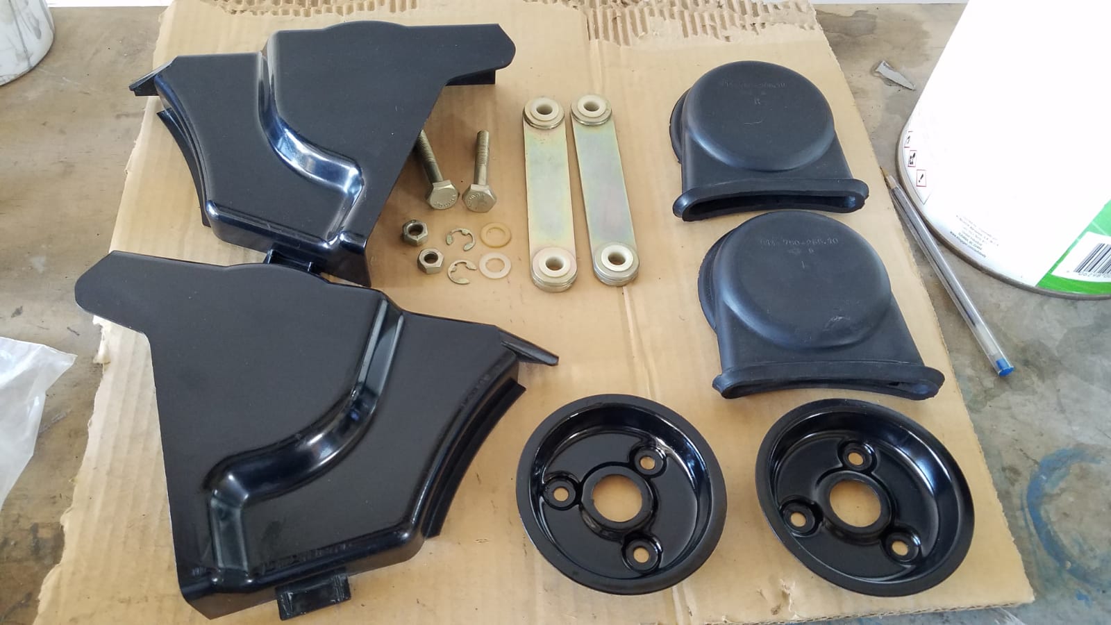

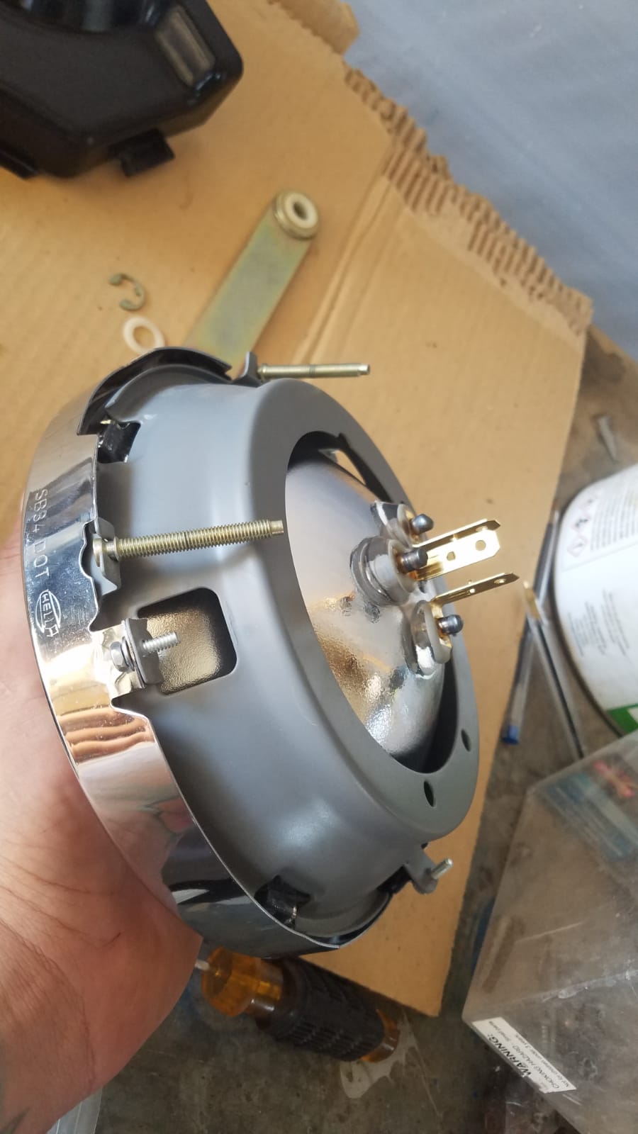

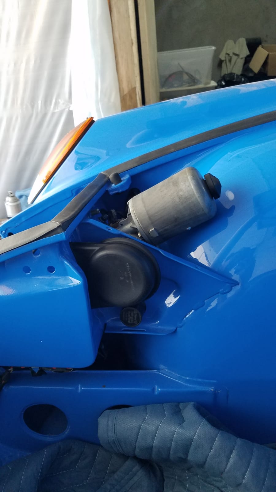

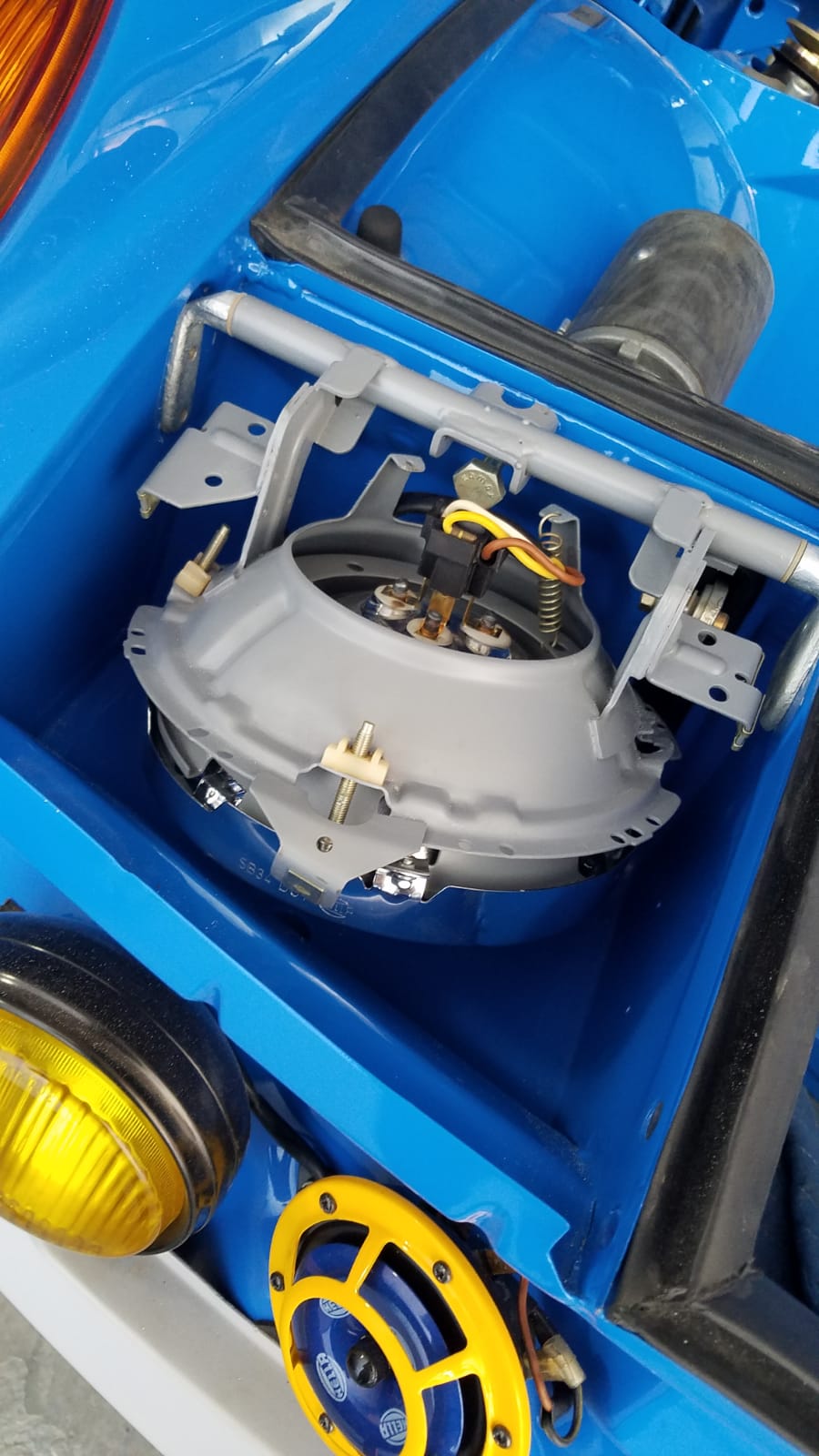

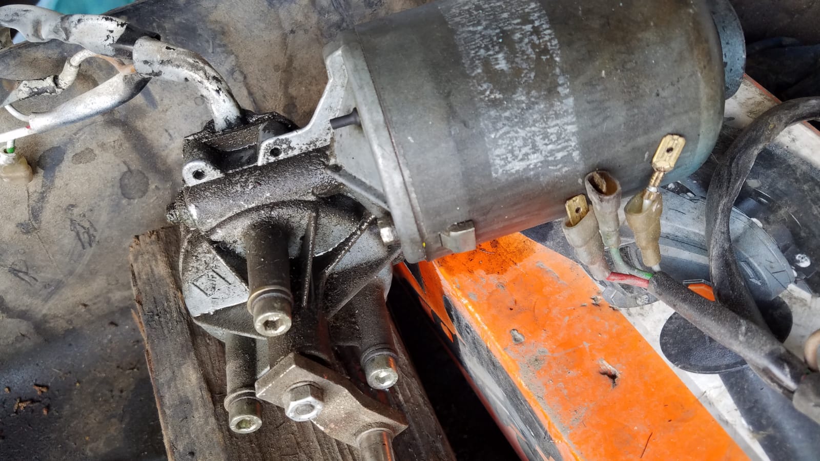

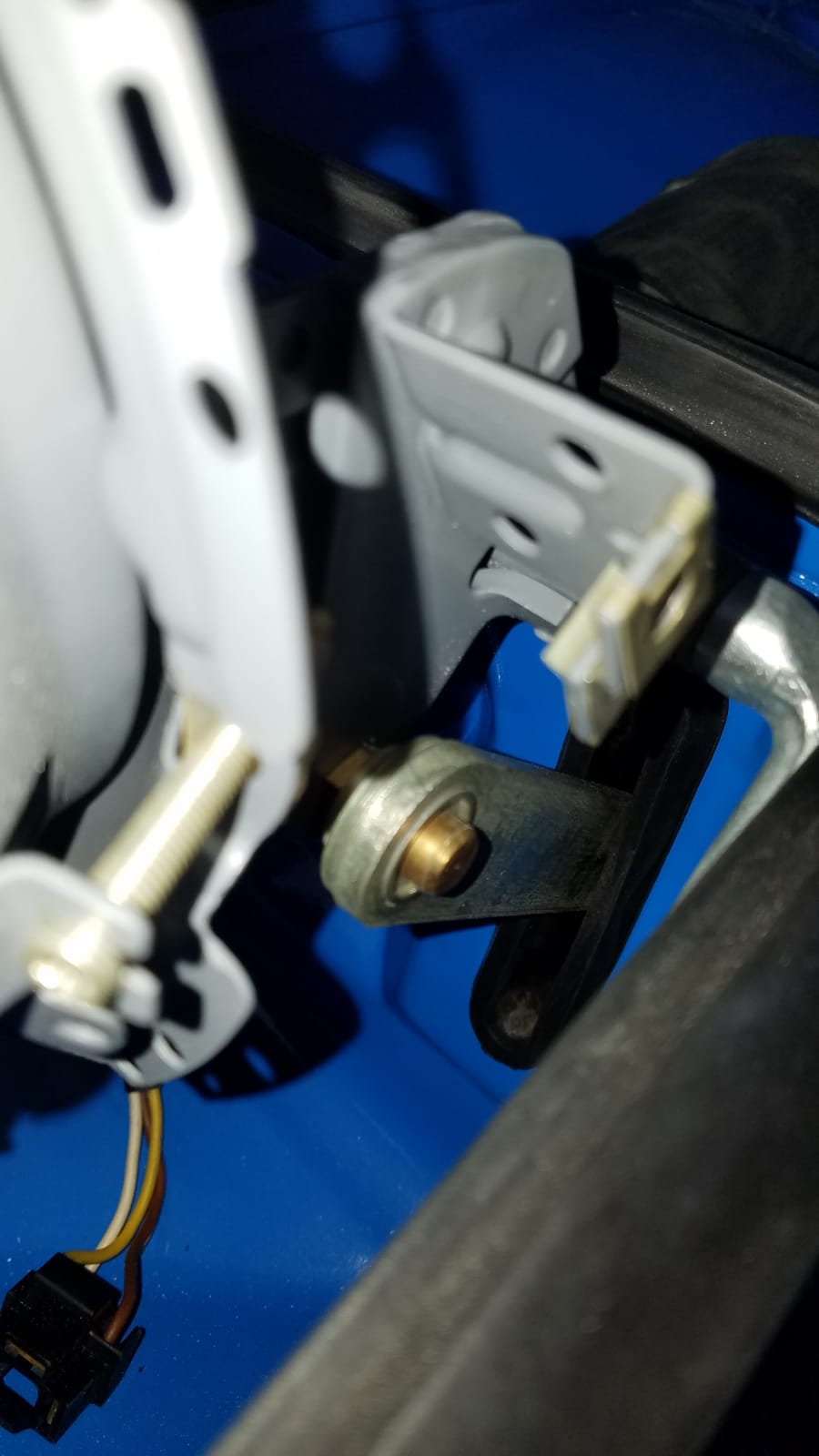

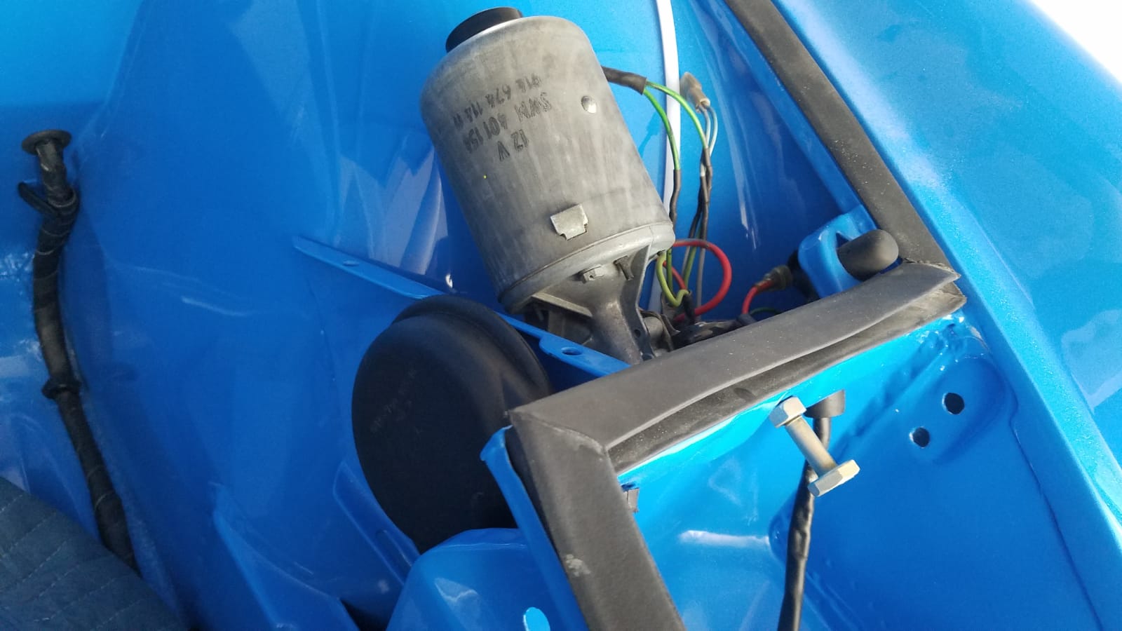

Grimmy and dirty headlight motors and hardware
Cleaned up and ready for install
autopro
post Aug 4 2022, 10:05 AM
Post #164
Posts: 306
Joined: 14-January 18
From: San Diego / Tijuana
Member No.: 21,797

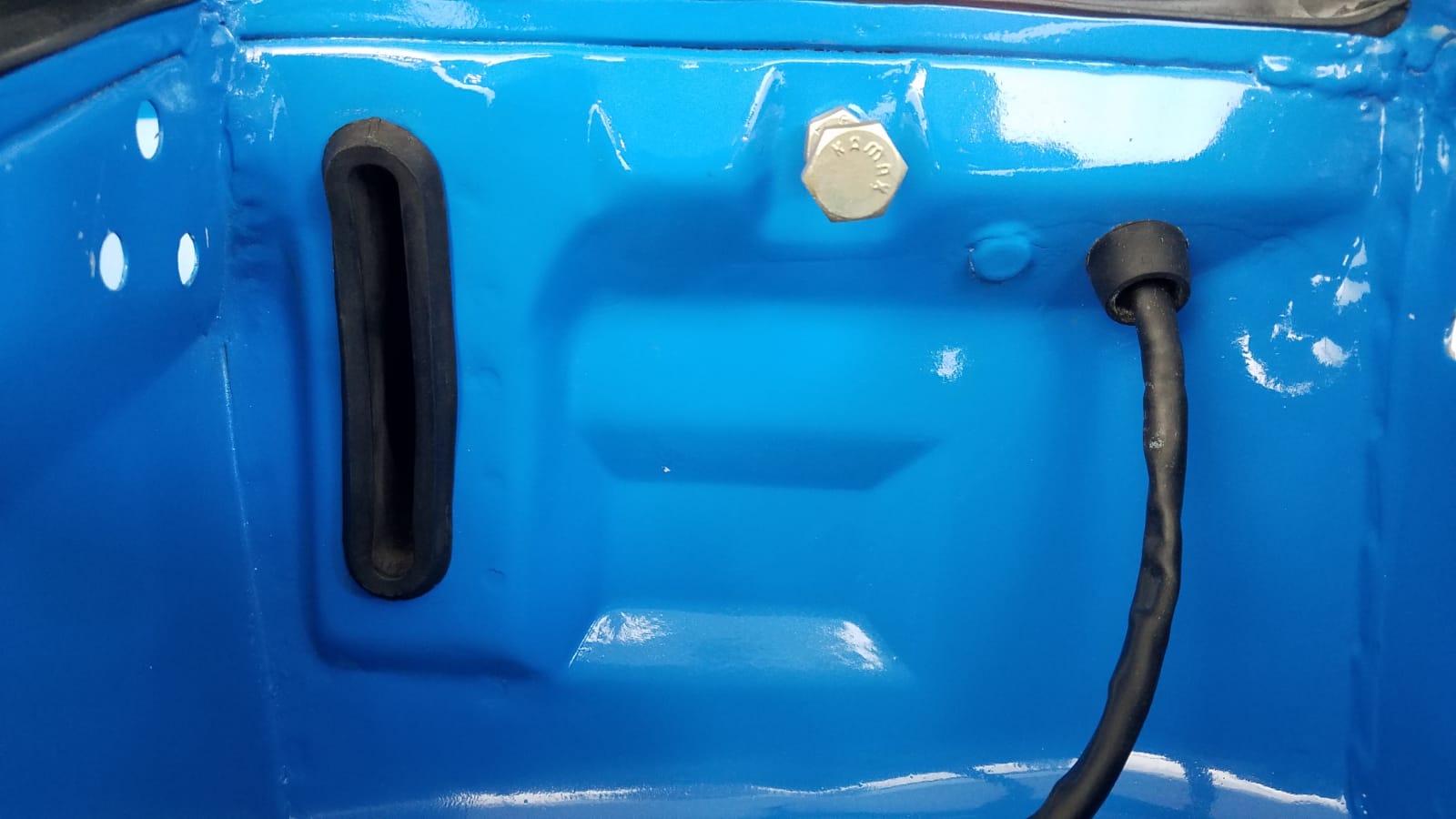

And some pictures of the installation

Some more

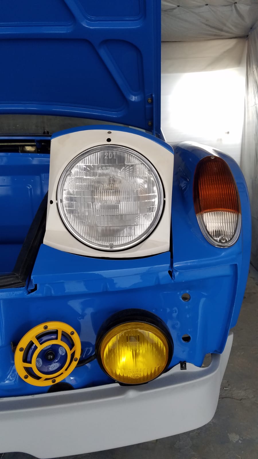

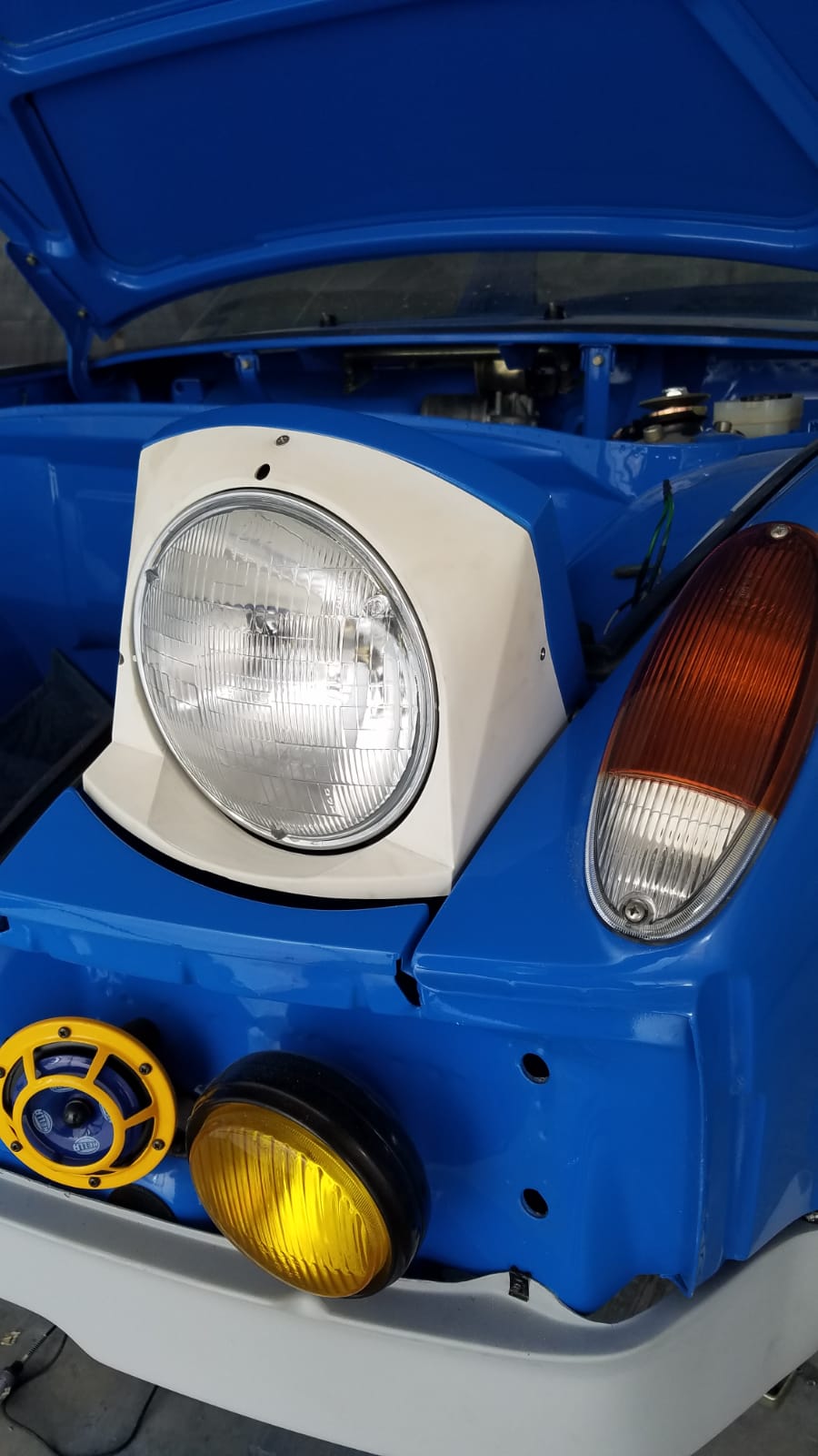

Headlight assemblies

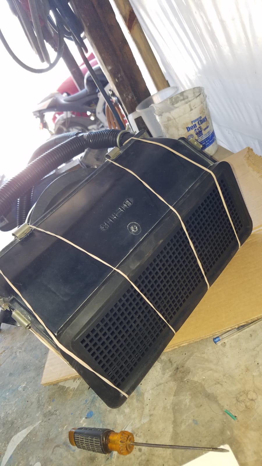

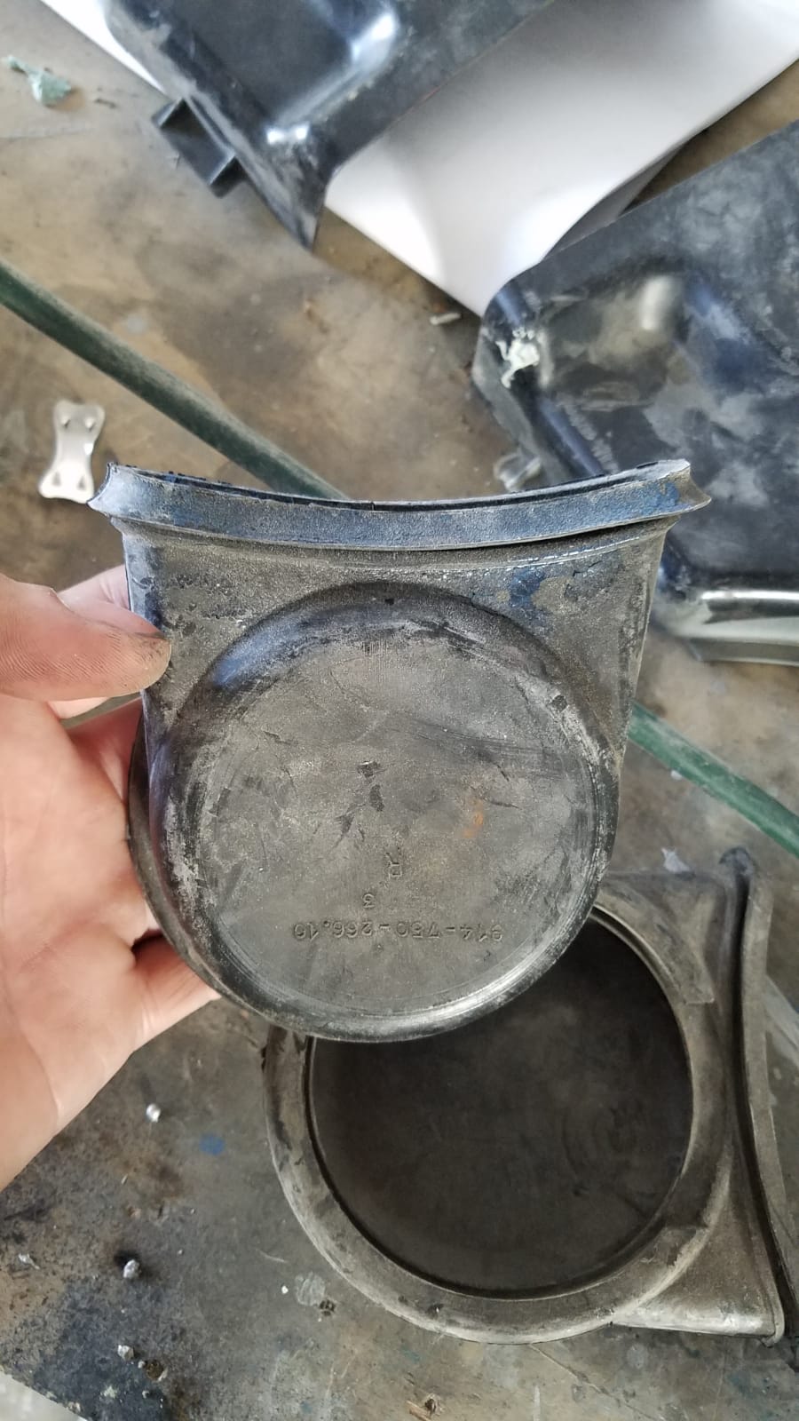

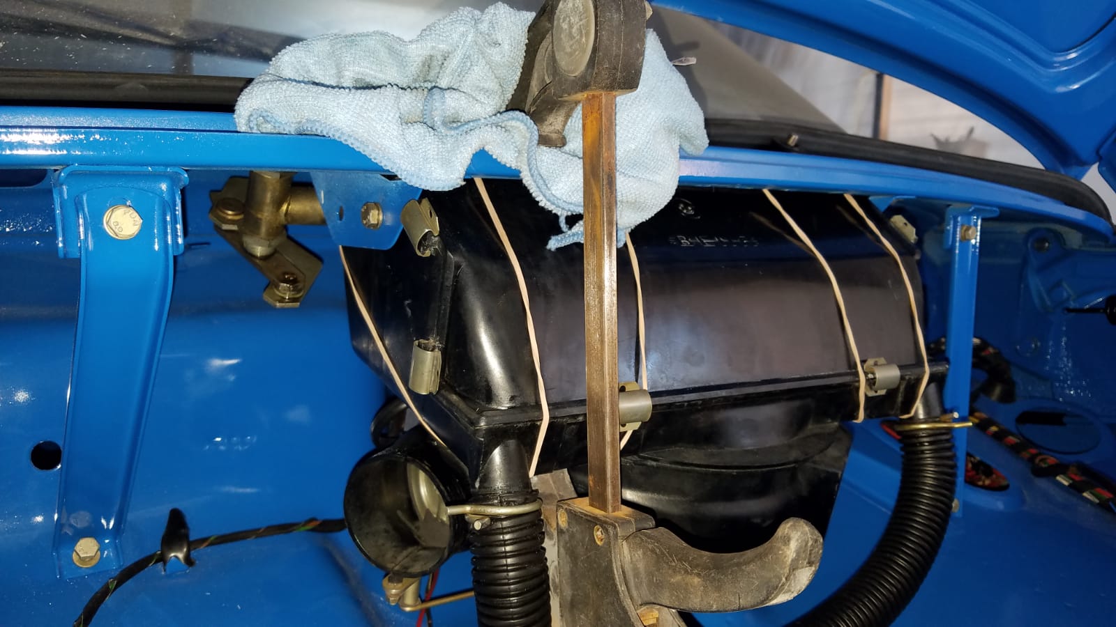

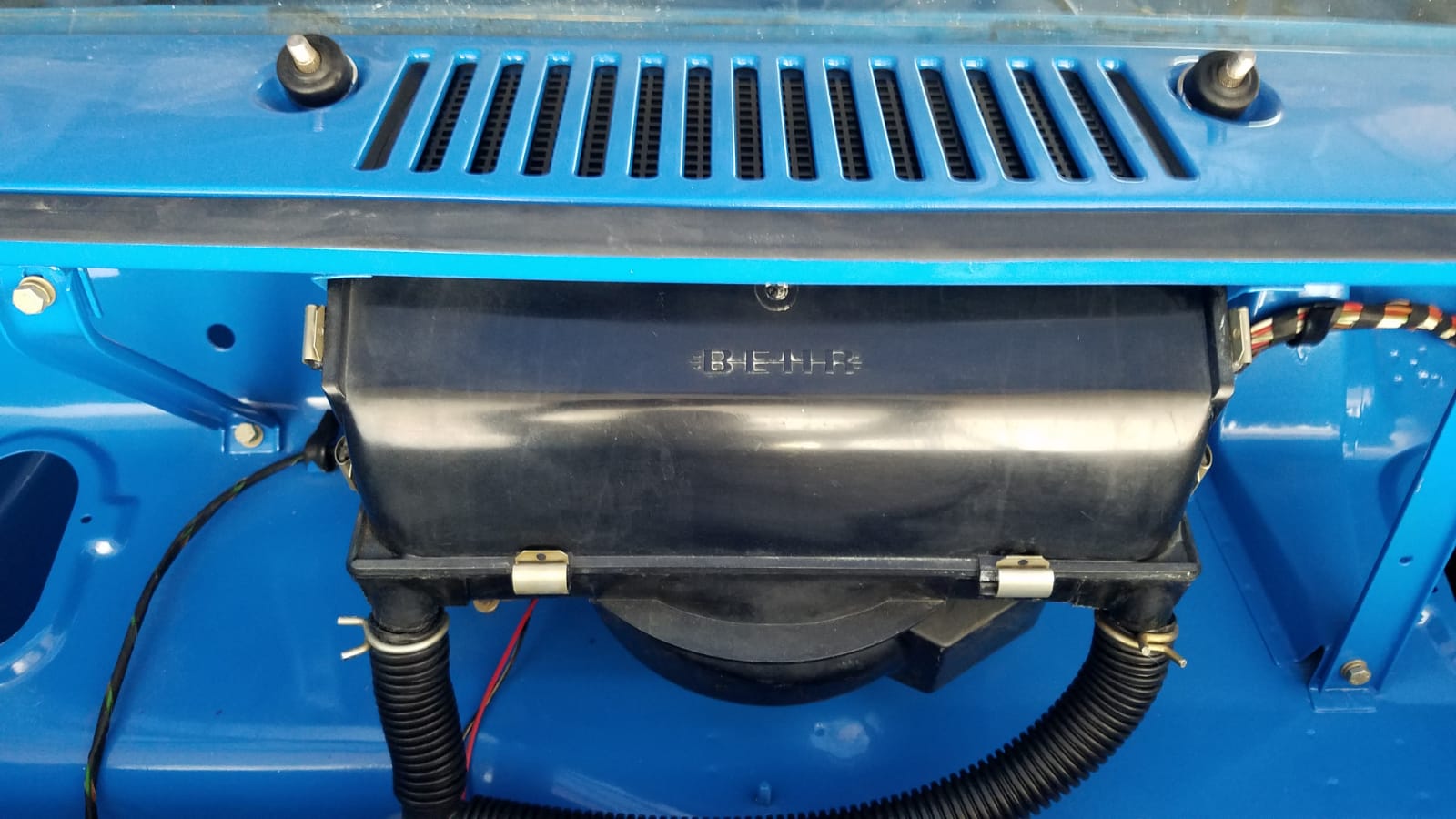

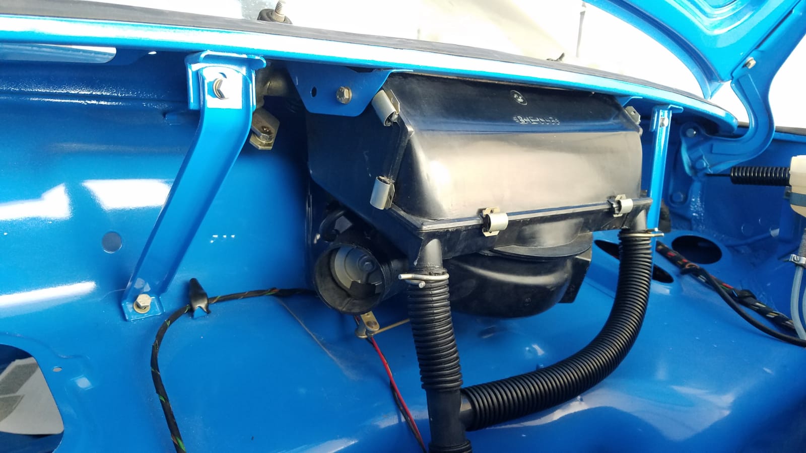

Some before and after pics of the airbox
New seals installed
All cleaned up and put back together

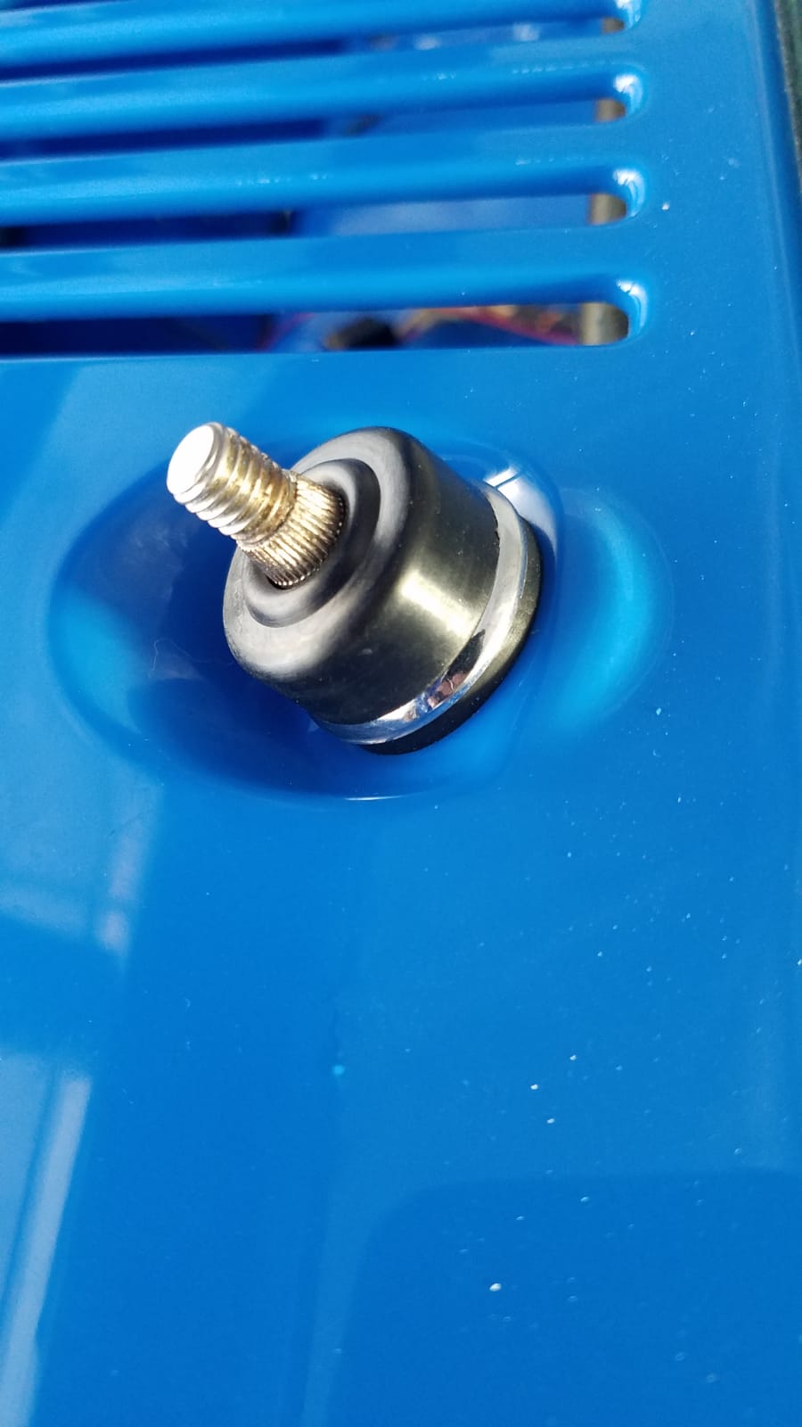

autopro
post Aug 8 2022, 04:33 PM
Post #169

Even though my car did not originally come with a grill for the airbox I decided to add it to prevent stuff from getting down there.

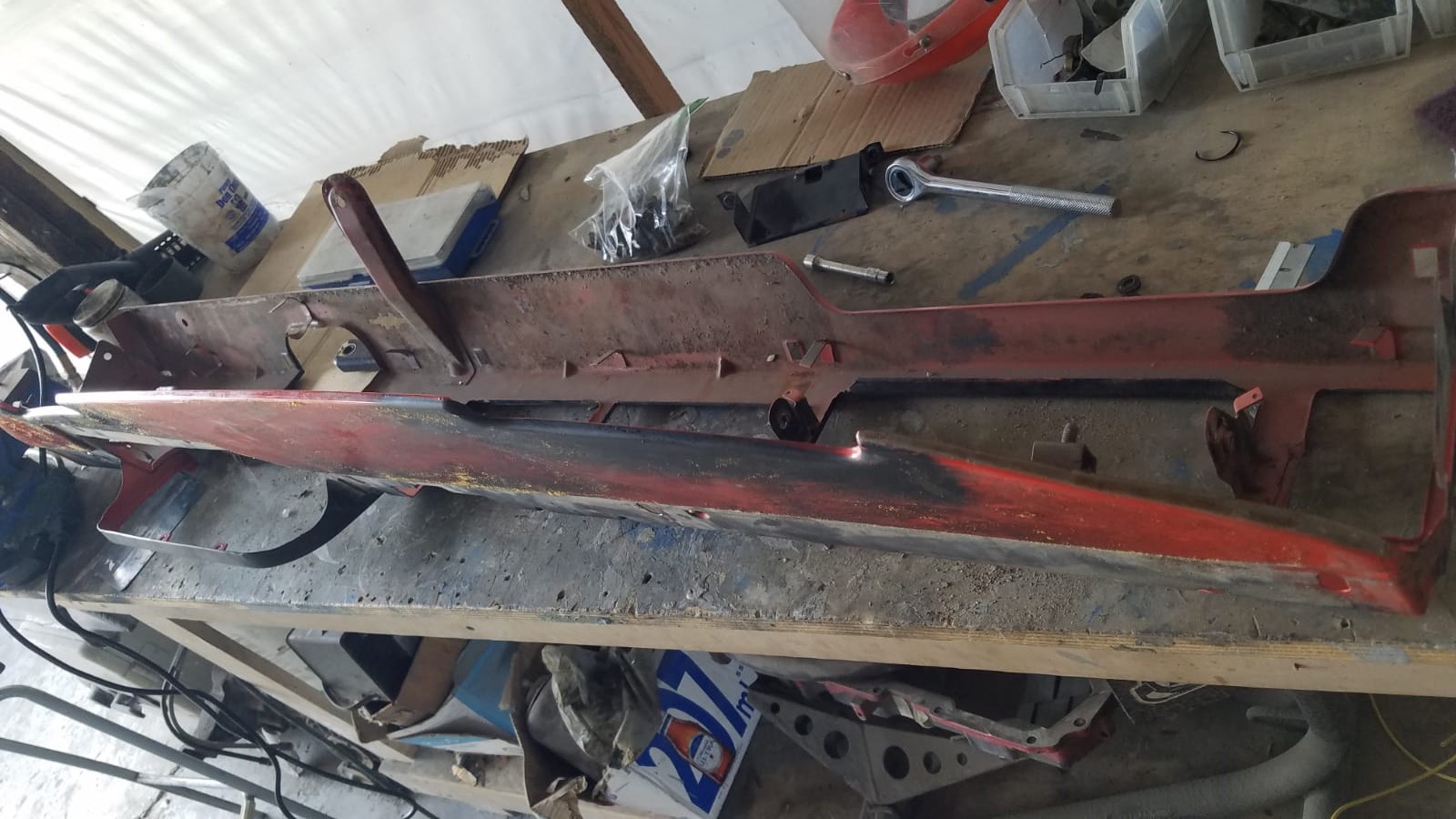

Good call on the grill; should have done that on my build. (IMG:style_emoticons/default/beerchug.gif)
I'm glad a made that call also after all the crap I found inside. (IMG:style_emoticons/default/beerchug.gif)

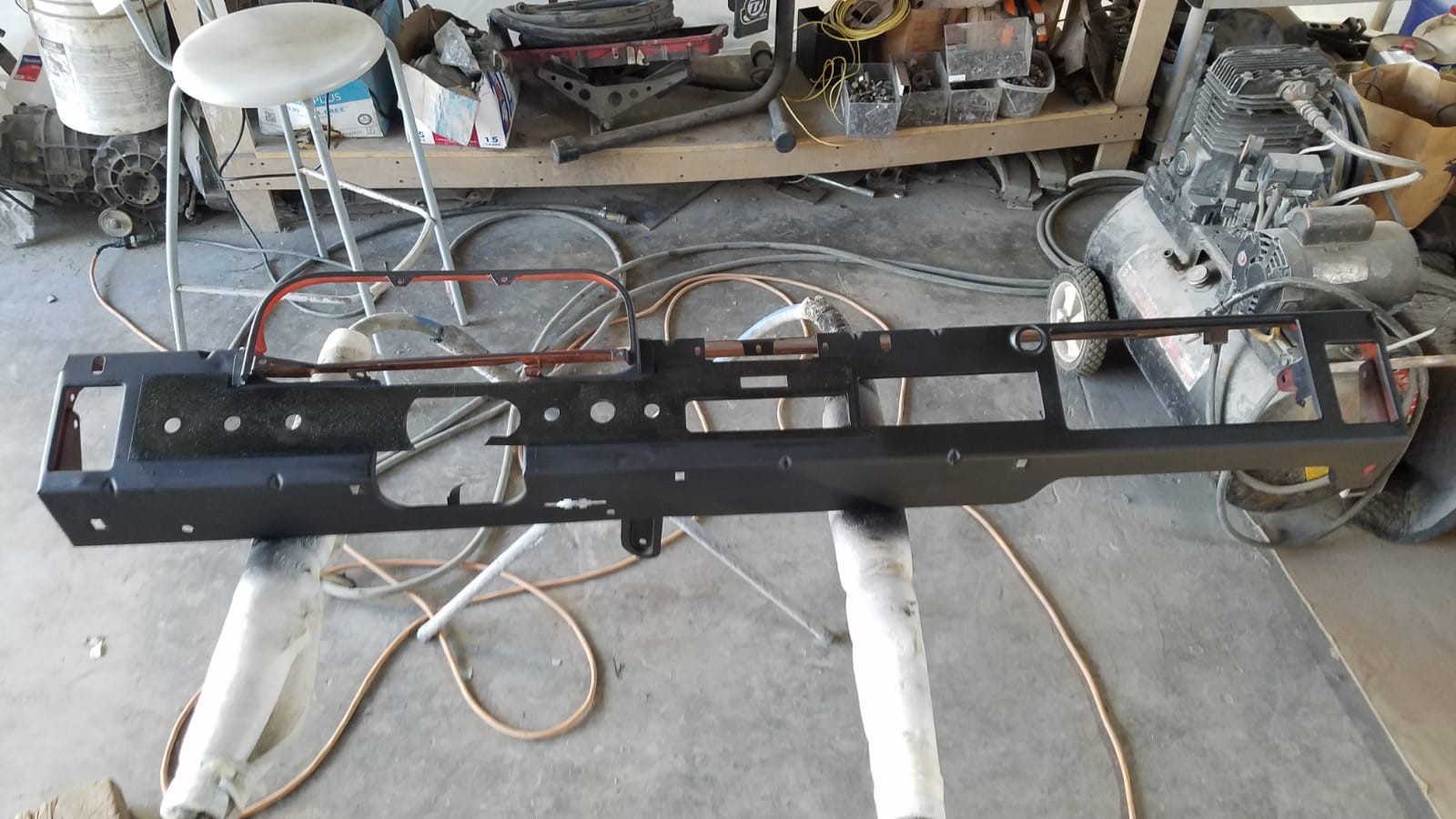

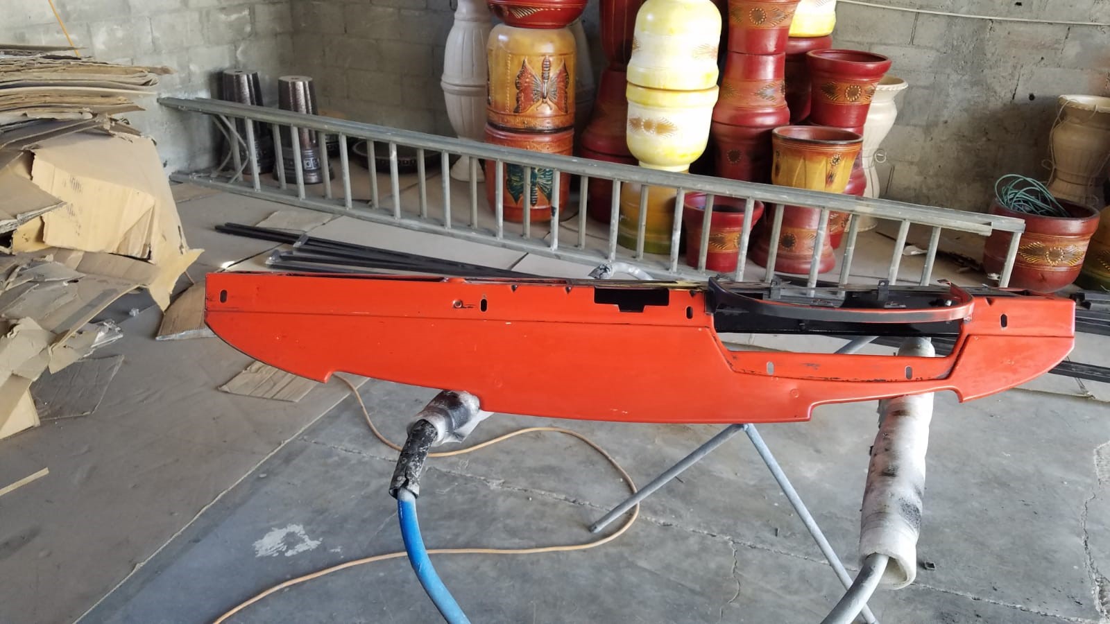

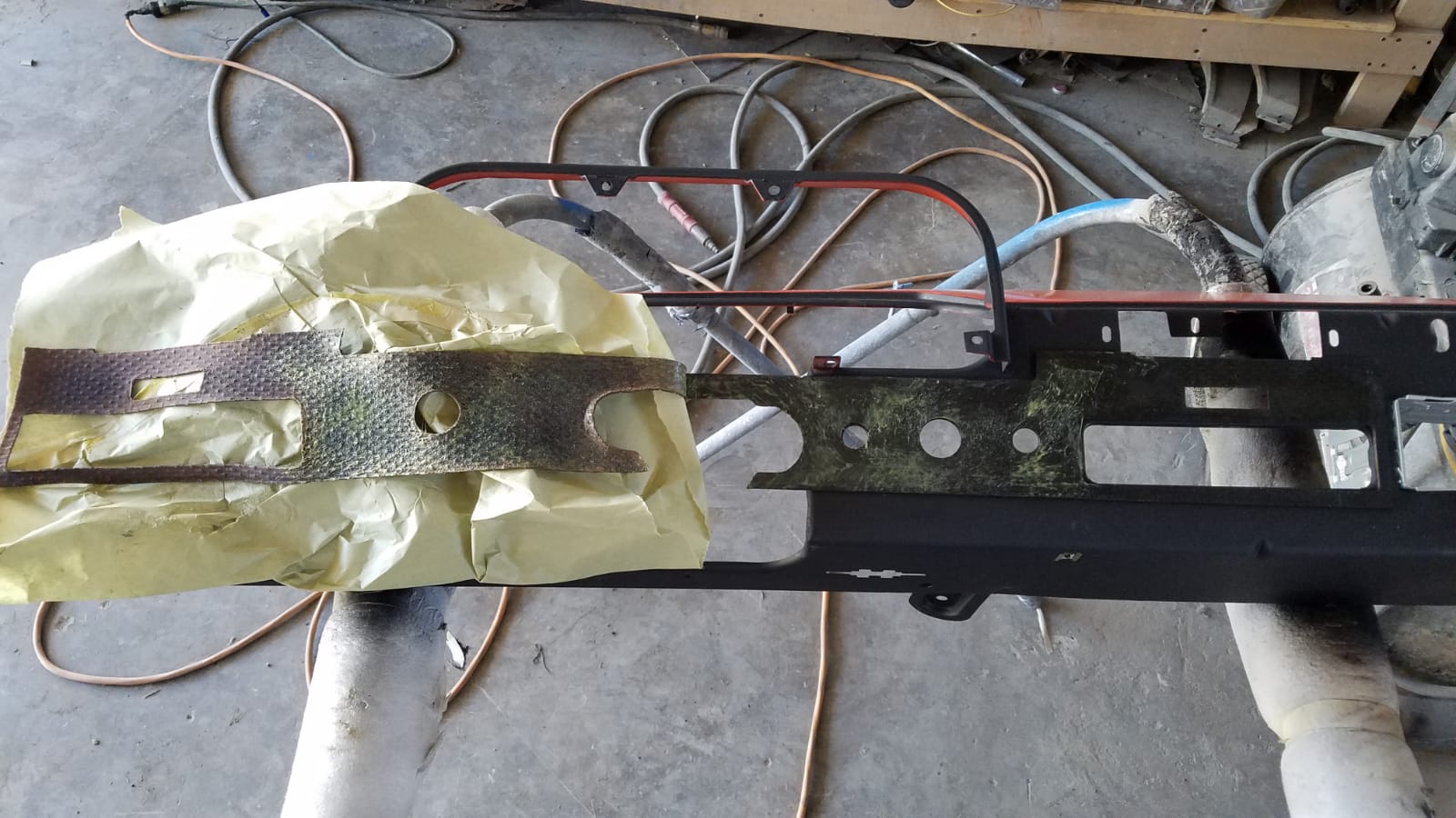

Jumping to the dash that was all crusty and dirty. Found out I had not ordered the vinyl and the foam for it so I placed my order for those parts from 914 rubber today.
Cleaned up looking much better
autopro
post Aug 11 2022, 06:37 PM
Post #173
Posts: 306
Member No.: 21,797

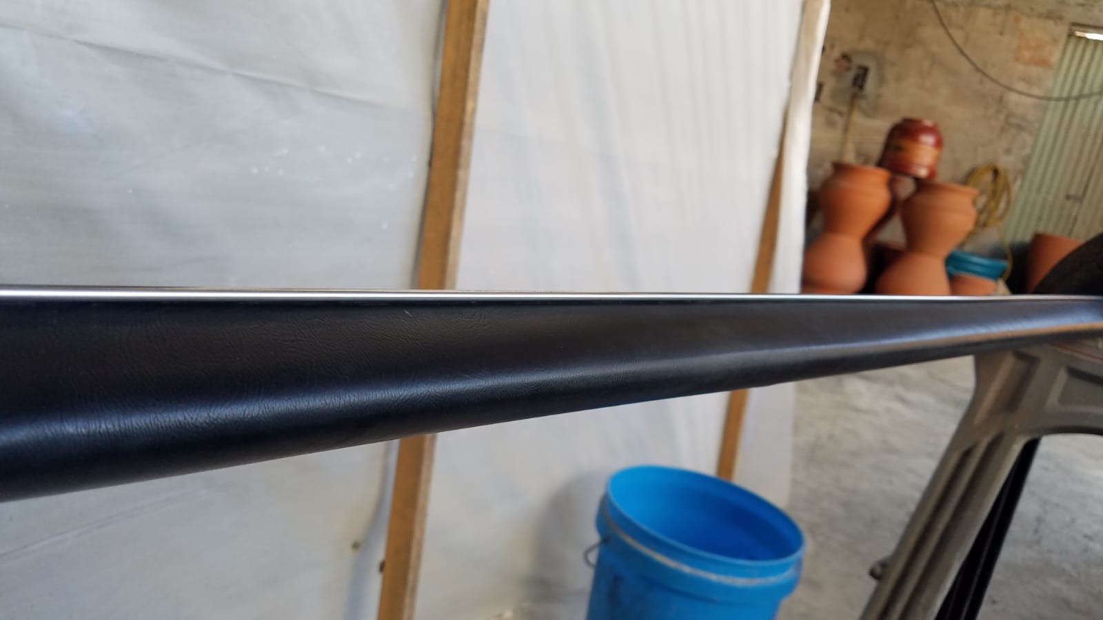

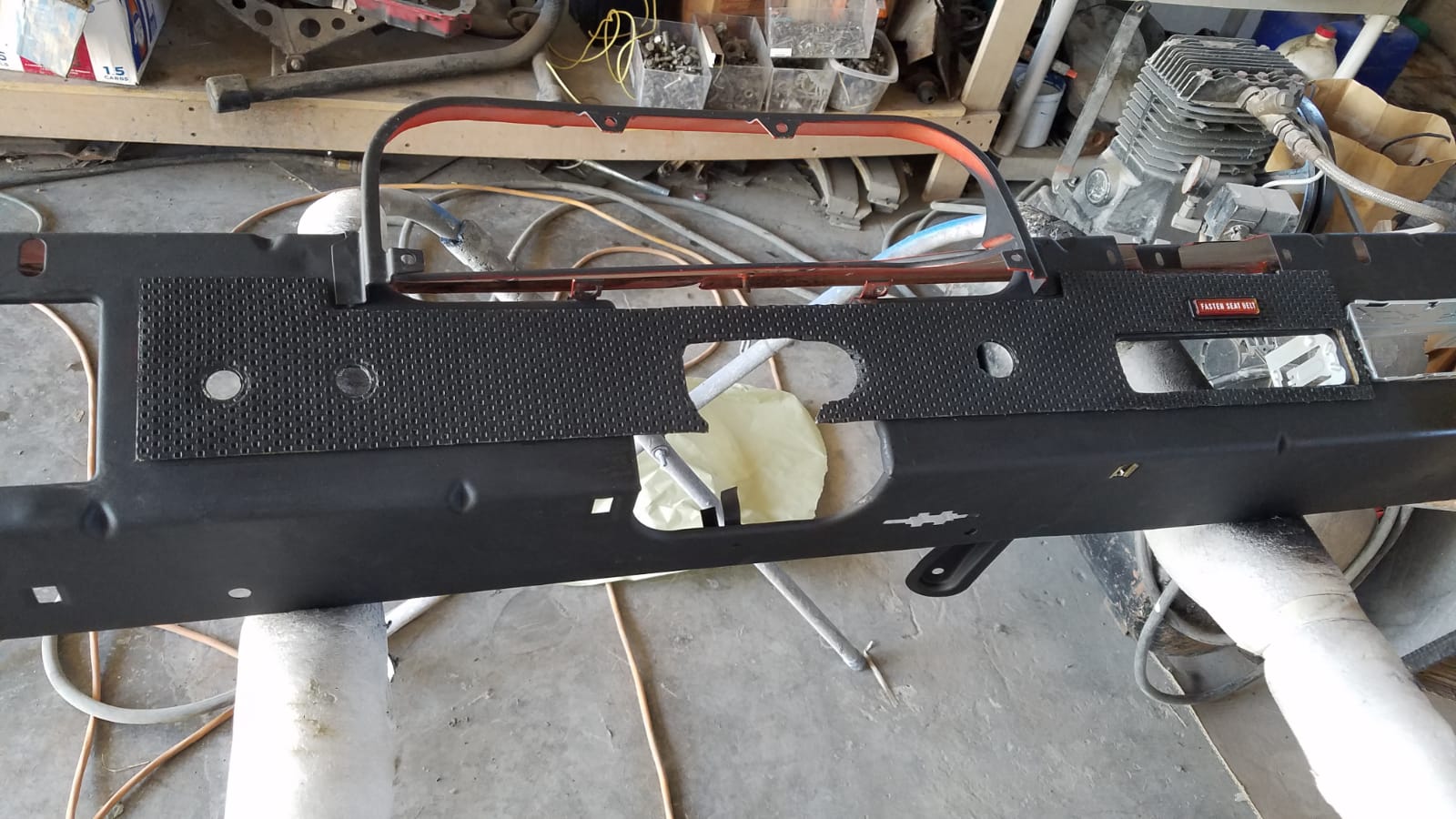

The dash material was still in very good shape, I just cleaned it with some soap and water and it looked great. Using contact cement to glue it down.

Took the time to add some black to where the air vents come out.

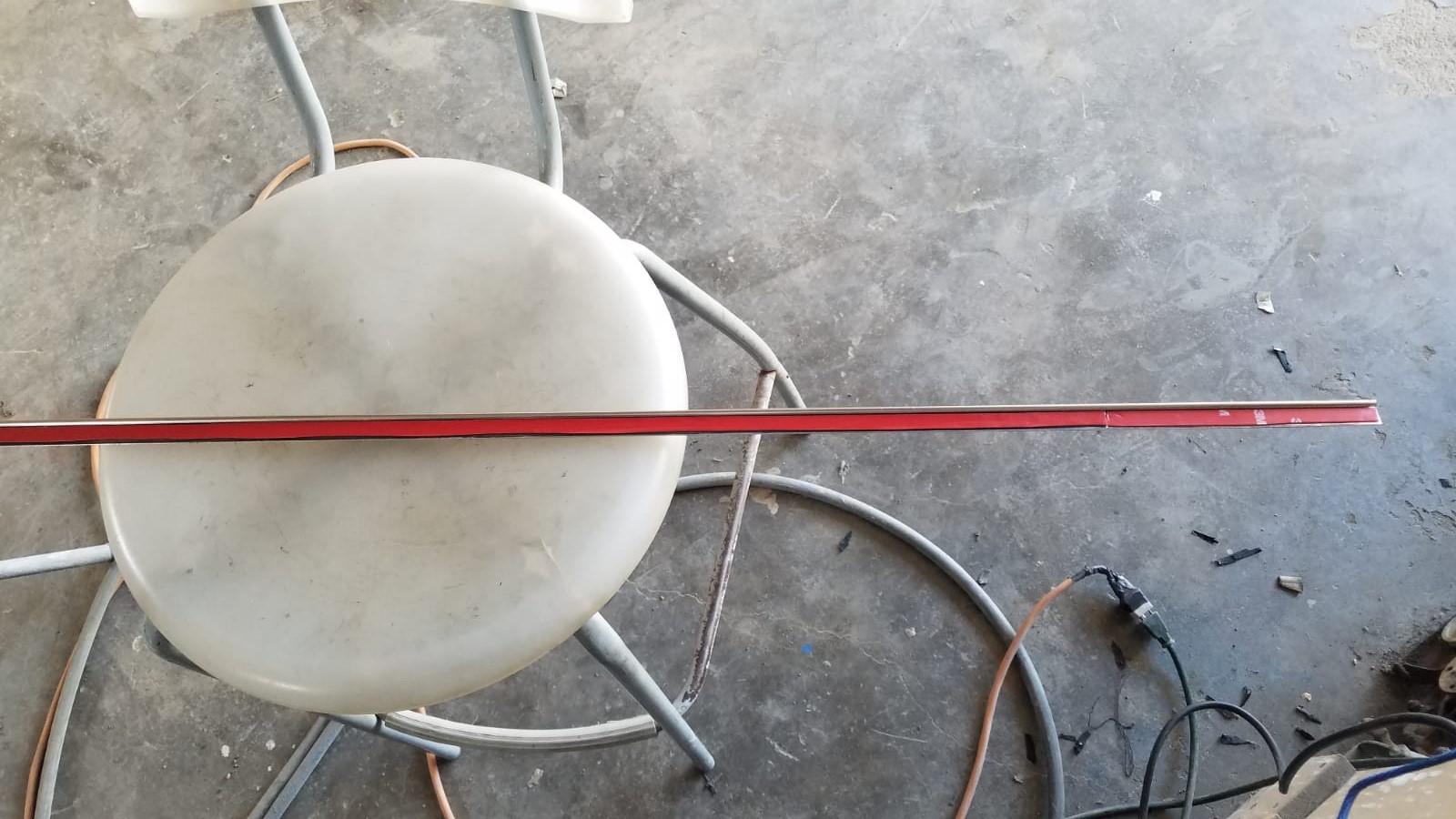

Double sided tape for the chrome molding on the knee pad

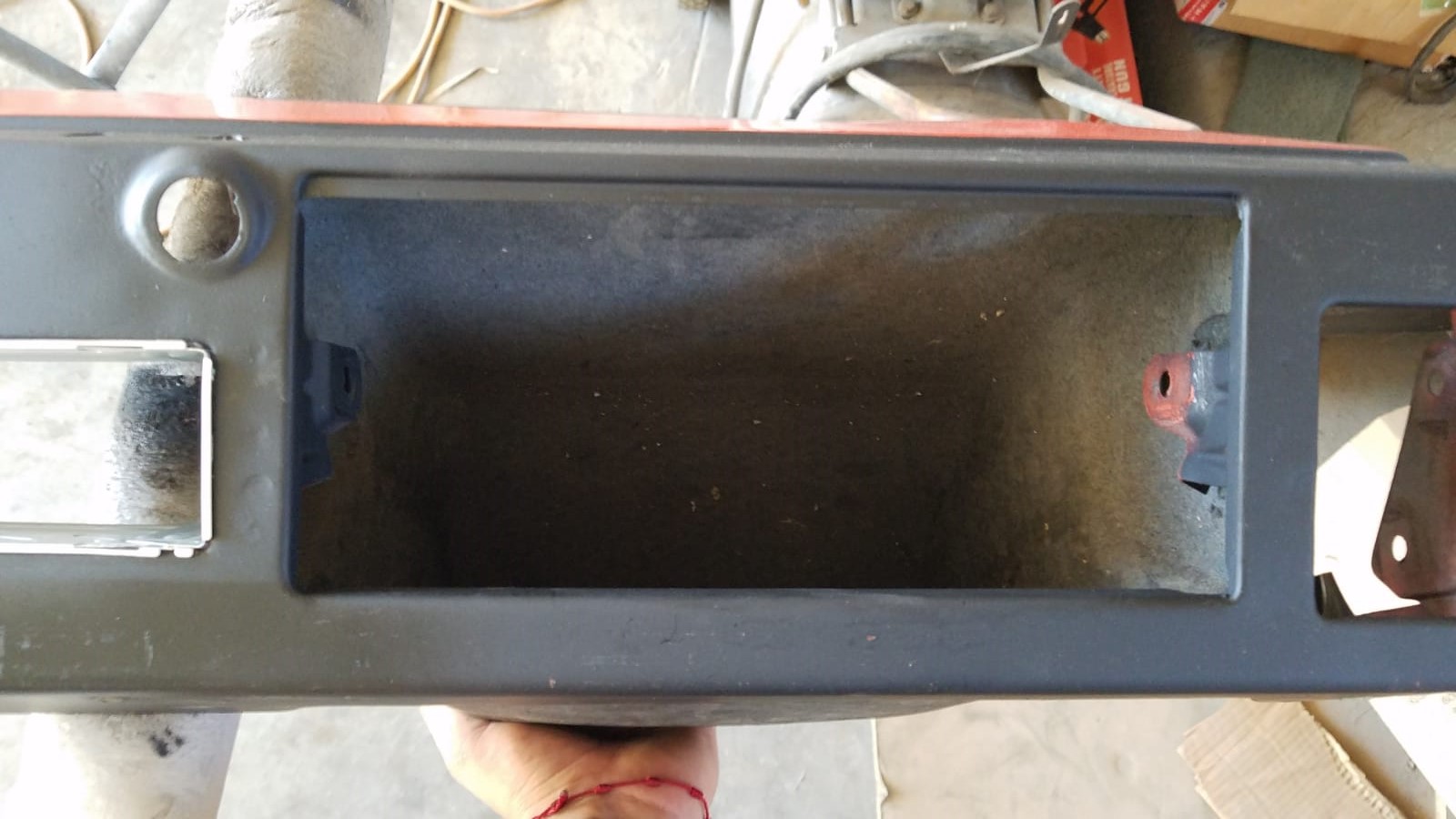

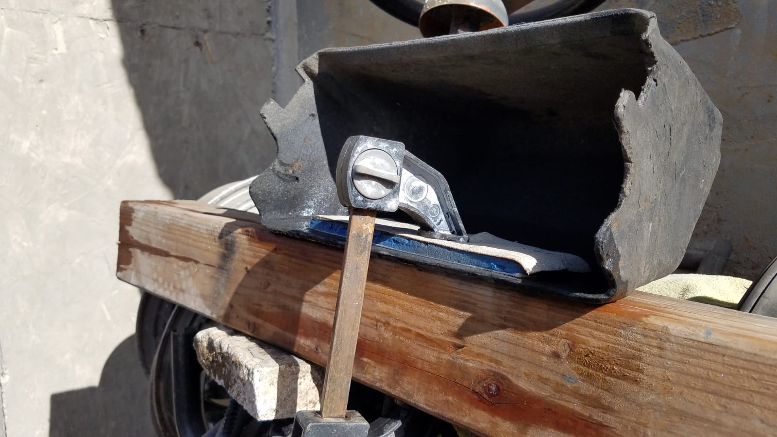

Soaked the glove box with water and then put a clamp on it out in the sun to get it back into shape.

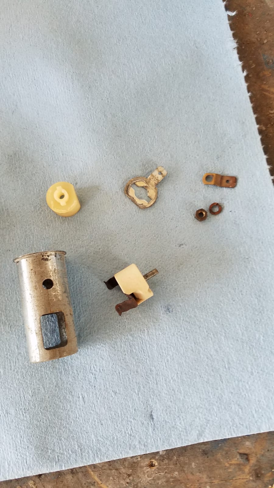

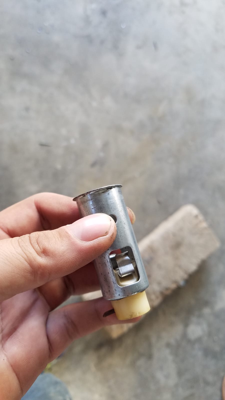

Took the cigarette lighter apart to clean it up.

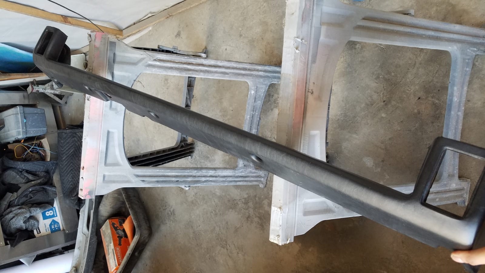

Knee pad cleaned up also, luckily this was also in very good shape. Just used soap and water, I will treat it with a protectant prior to installation.

post Aug 12 2022, 02:11 PM
Post #180
Posts: 306
Member No.: 21,797

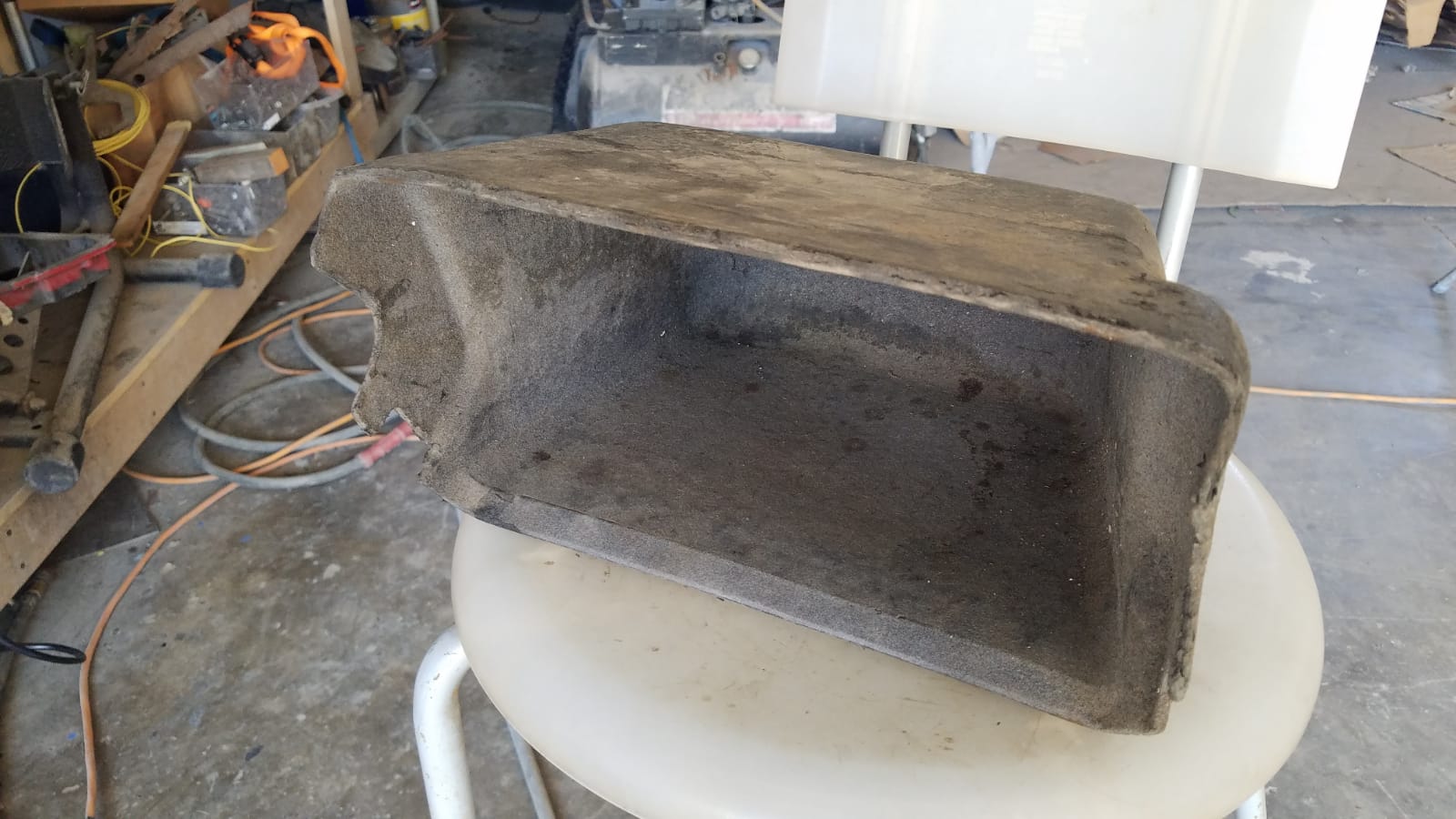

I'm happy to report that the glove box is no longer crooked. Leaving it overnight to dry while clamped did the job. Now I need to get some flock because the inside is still nasty from all the rat piss (IMG:style_emoticons/default/icon8.gif)
