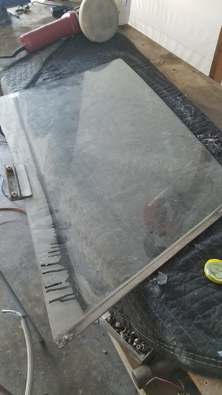

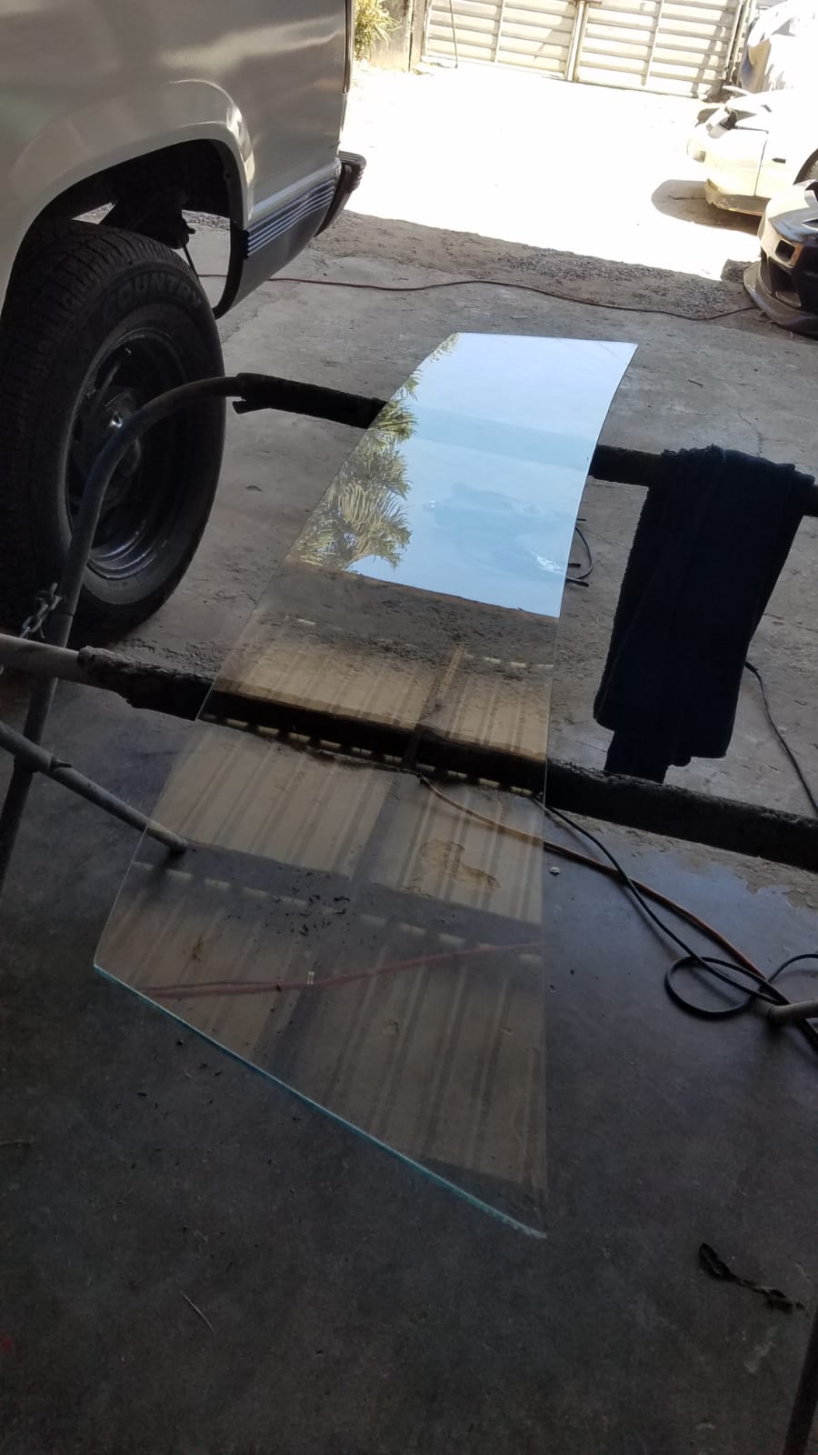

Started polishing my windows, I found a product at Walmart that is used to clean and polish glass cooktops. I used it with my sponge polishing pad and it worked great.

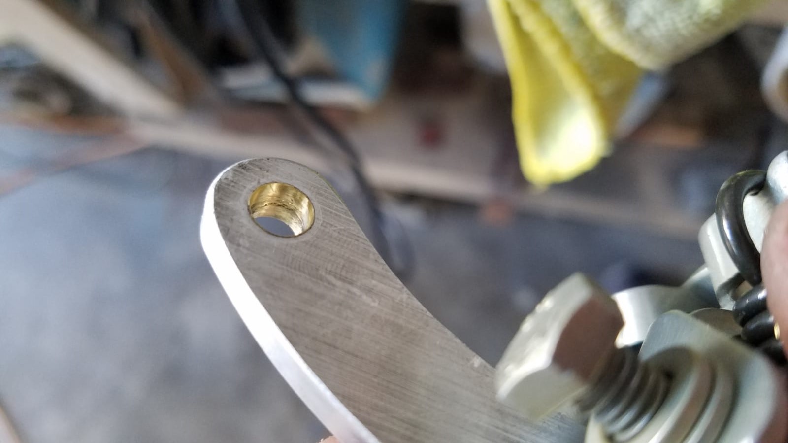

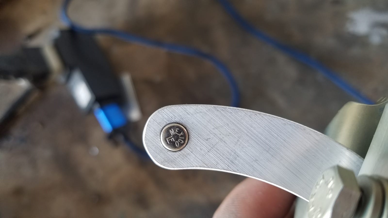

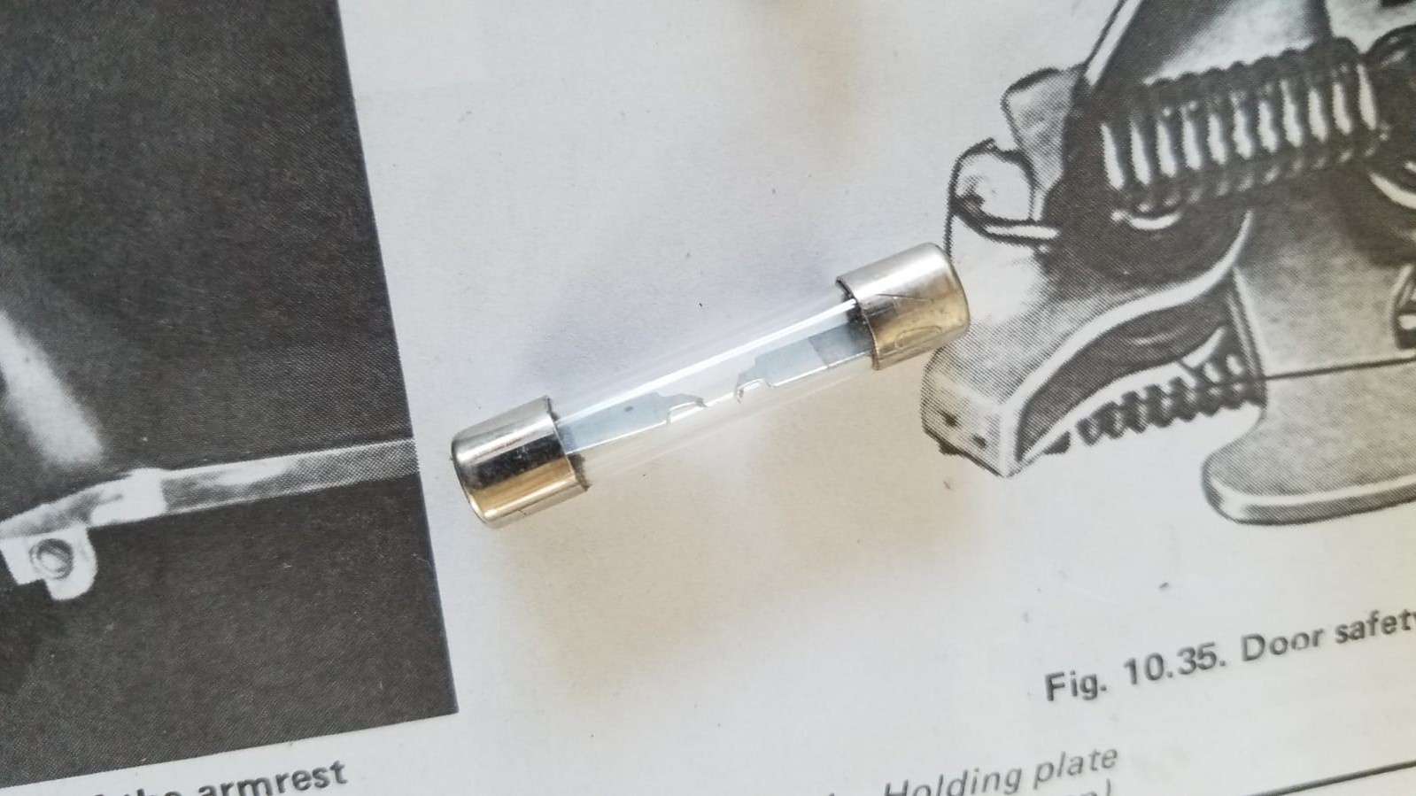

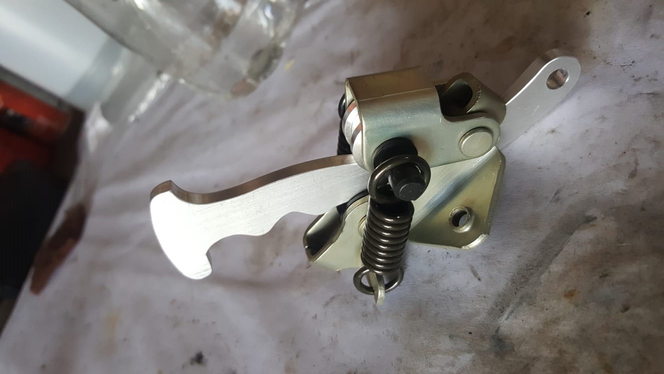

I was rebuilding the door stays and to fix the difference in the diameter from the pin to the hole in the arm I used the metal end of a glass fuse.
The diameter fit exactly.
Glued it in with some GB Weld and then grinded the end off.
And the finished product.

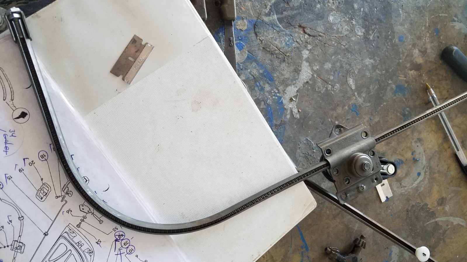

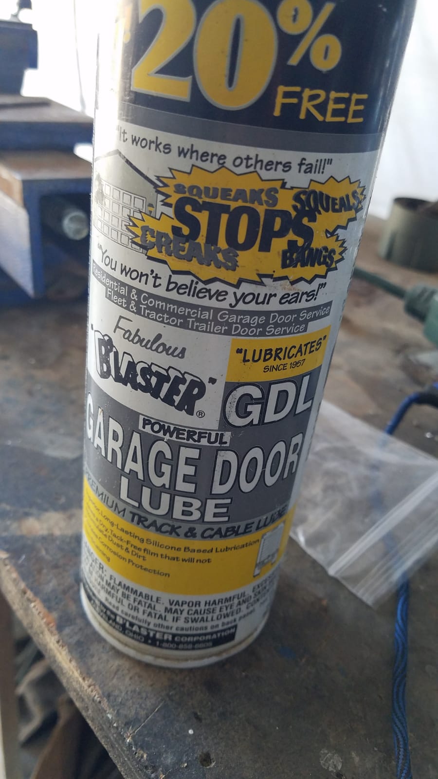

Cleaned up my door window lifts and lubed them with garage door lube.

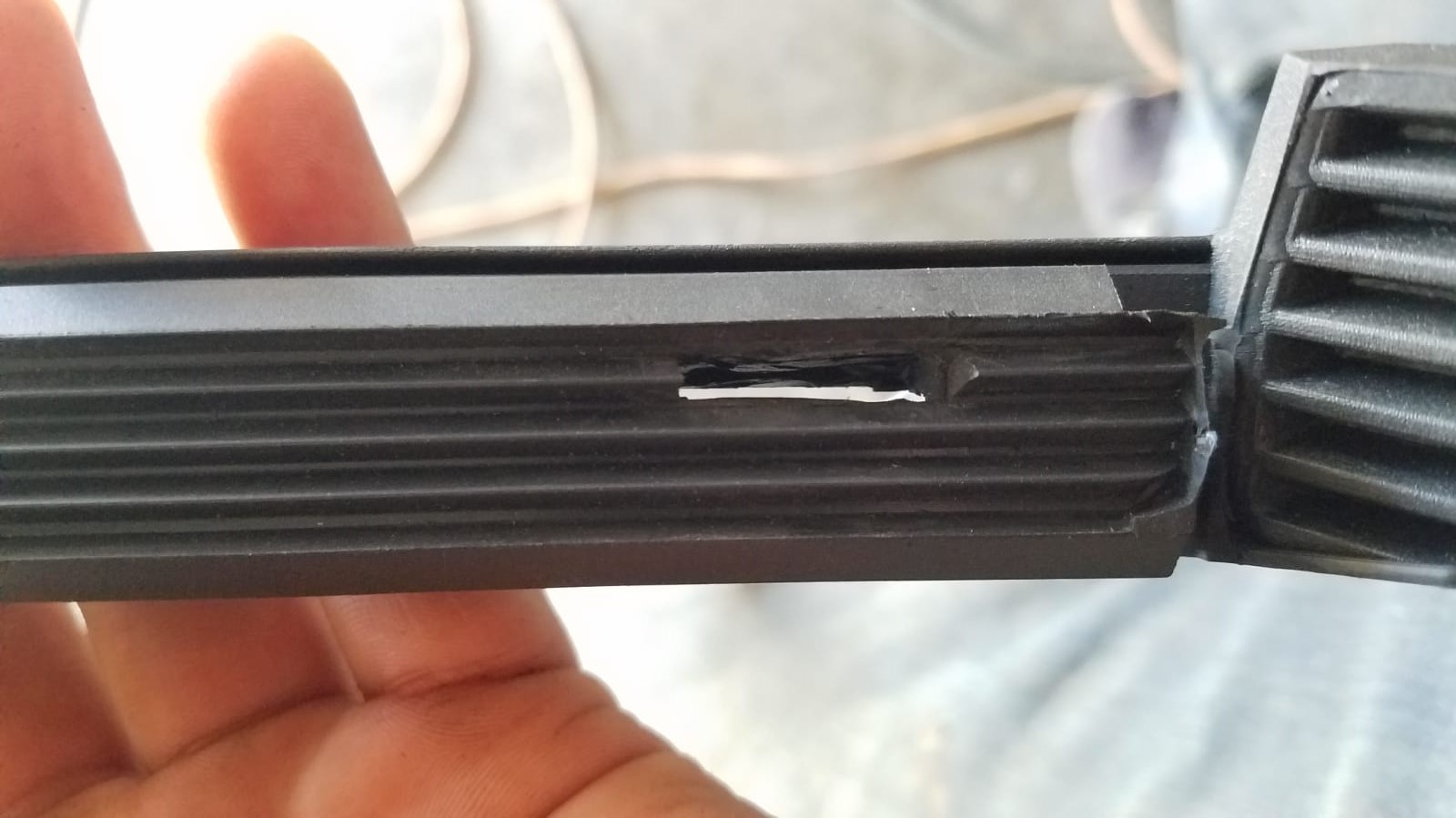

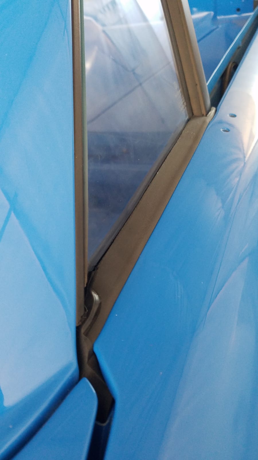

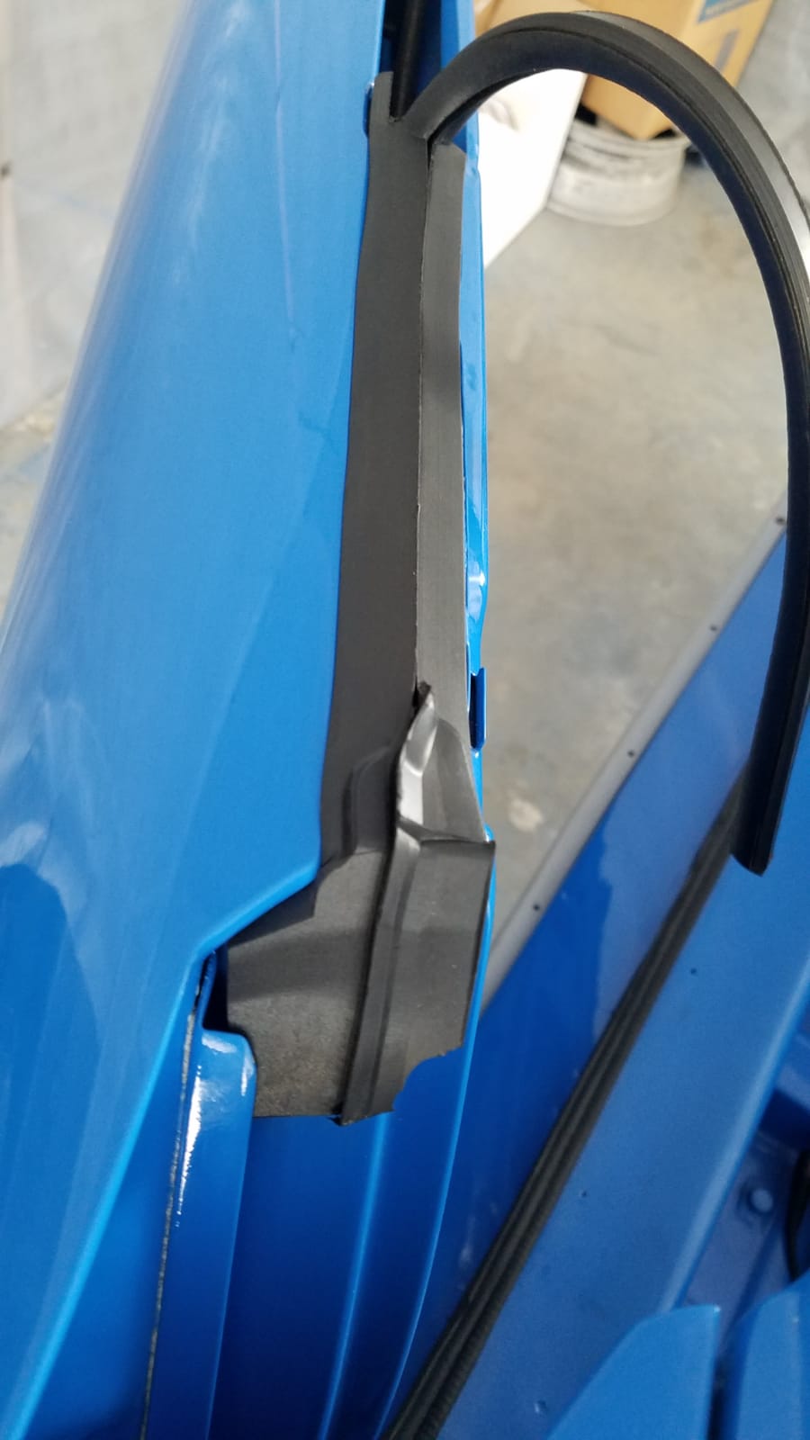

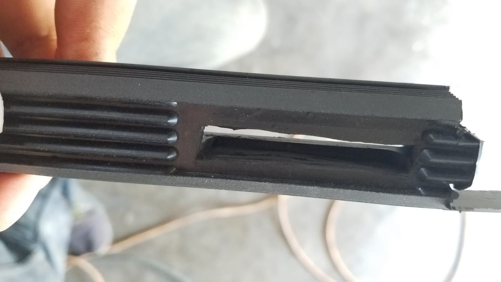

Ok, so seeing all the recent stuff about the door quarter glass seals in the threads lately made me a little bit scared about tackling this job. Luckily I still had my original seals that were in ok shape and they helped me see how I needed to modify the 914 rubber seals.
First I extended the groove for the frame, here you can see it at the bottom.
Then came the recess for the front bracket. I trimmed both recesses with an x-acto knife.
Recess for the rear bracket
Then I had to do some trimming at the front of the seal so that it would sit properly over the metal edge on the door. Just a tiny bit with the x-acto and it was fitting nicely.

Made sure the seal was fitting well in the door before trying to install it with the frame and glass. The trimming was necessary to get it to fit correctly from the begining.

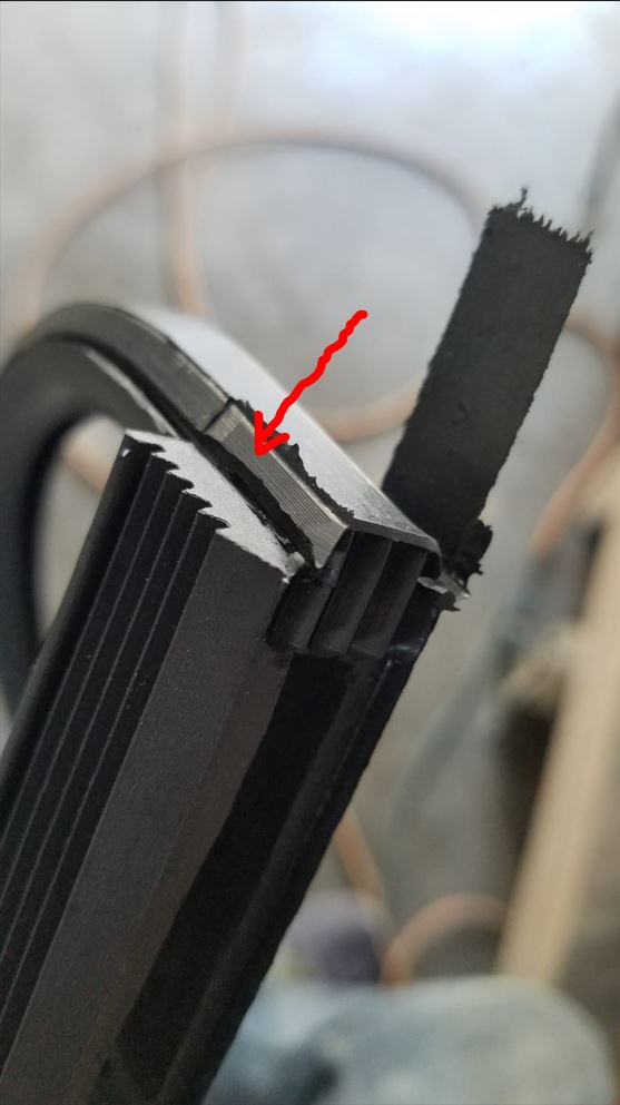

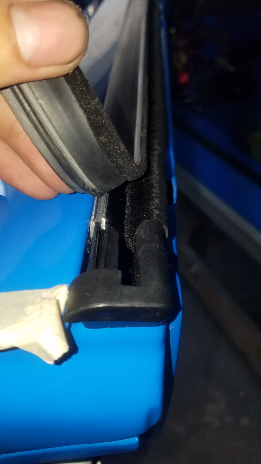

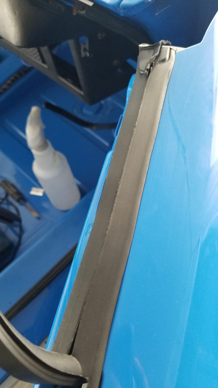

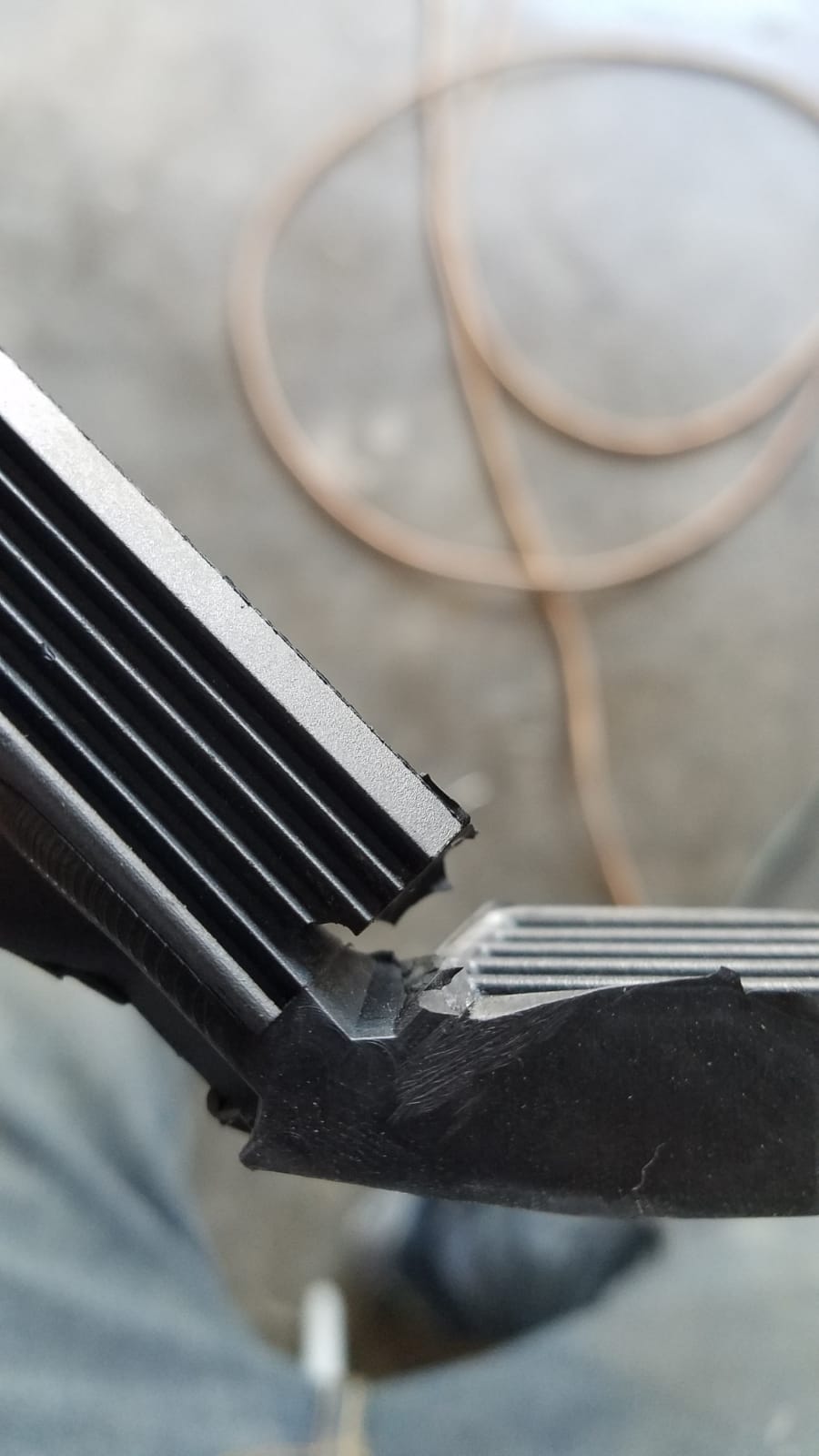

Even after the initial trimming, when I put the window into the frame with the bracket I still got a bulge. Took it apart for some more trimming until the bulge was gone.
Here in this picture you can see the bulge right above the bracket.

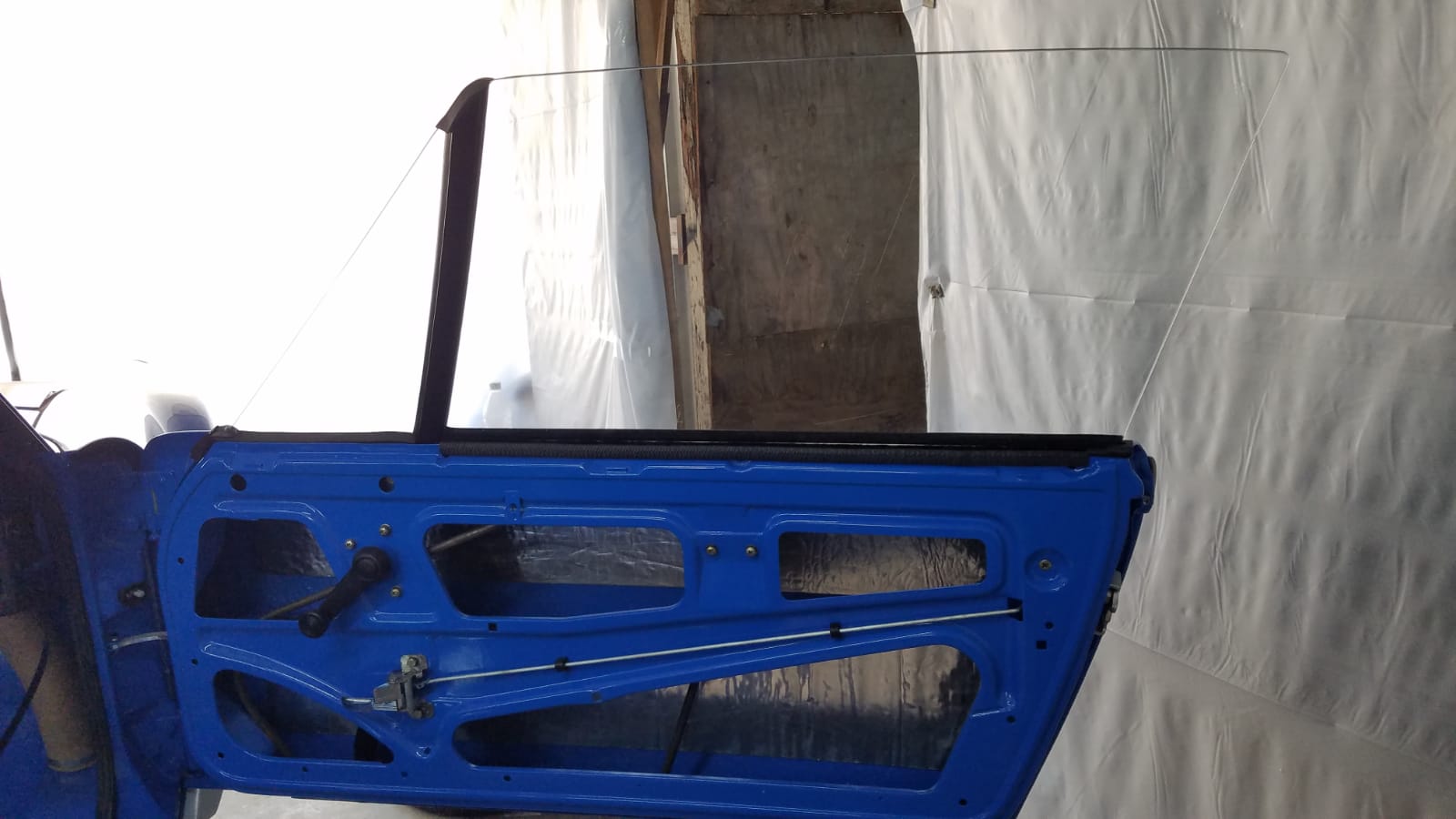

After all the trimming was done, I was able to get the windows into the frames and the brackets installed, this was about 2 hours worth of work to get them to this stage.
Installed the window lift, door stays and inside door handle.

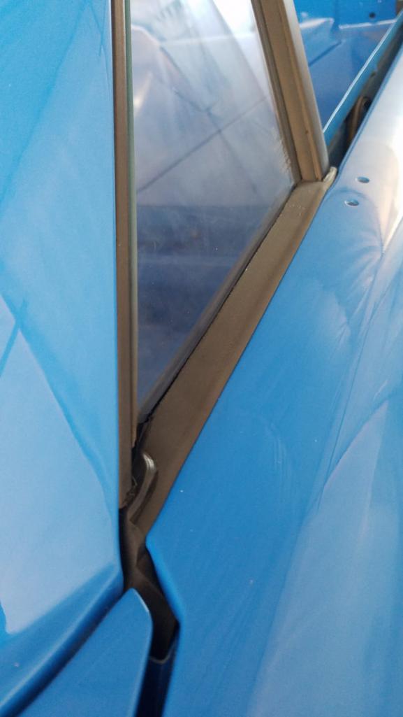

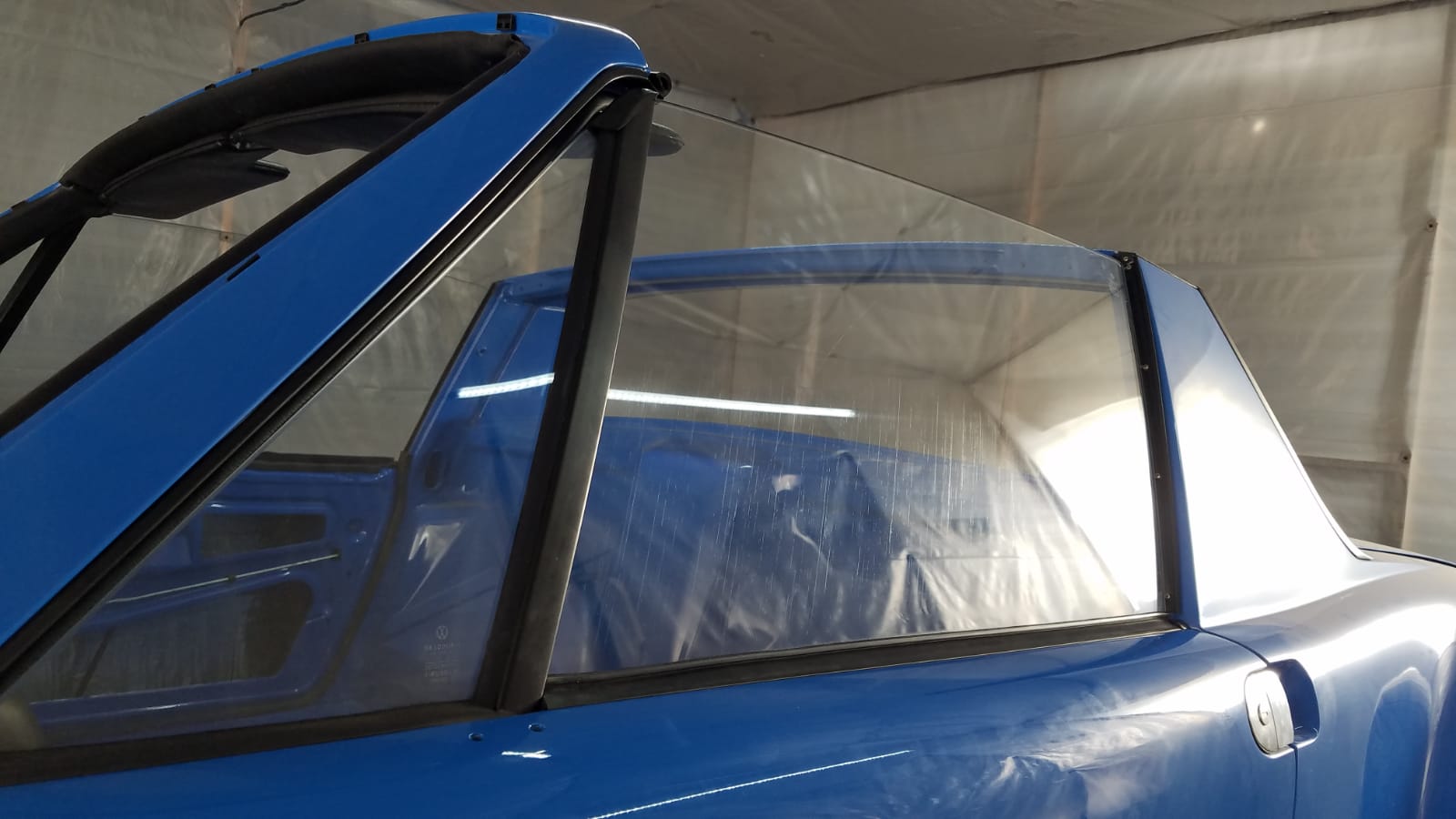

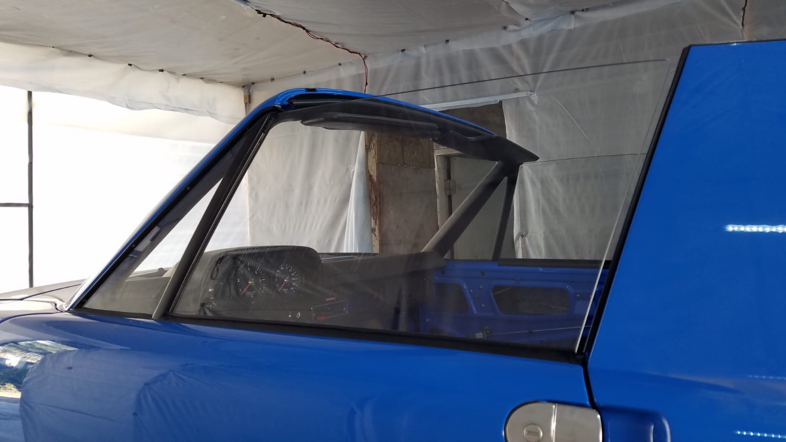

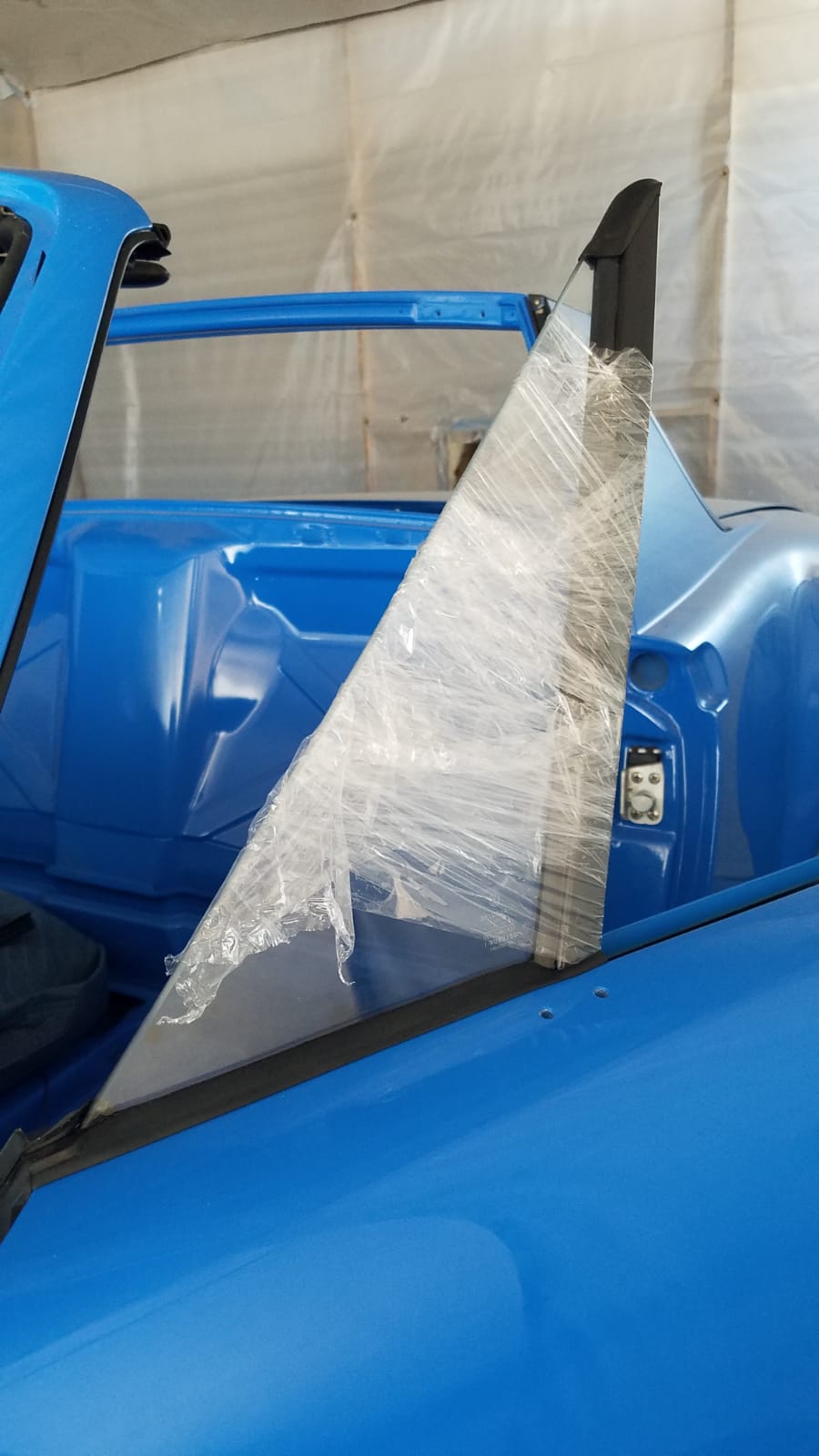

Kept going with my doors yesterday and got quite a bit along. The quarter window and frame went in without too much trouble using some soap for lubrication. Per instructions on here I wrapped it in packing plastic so it wouldn't slip out of the seal.

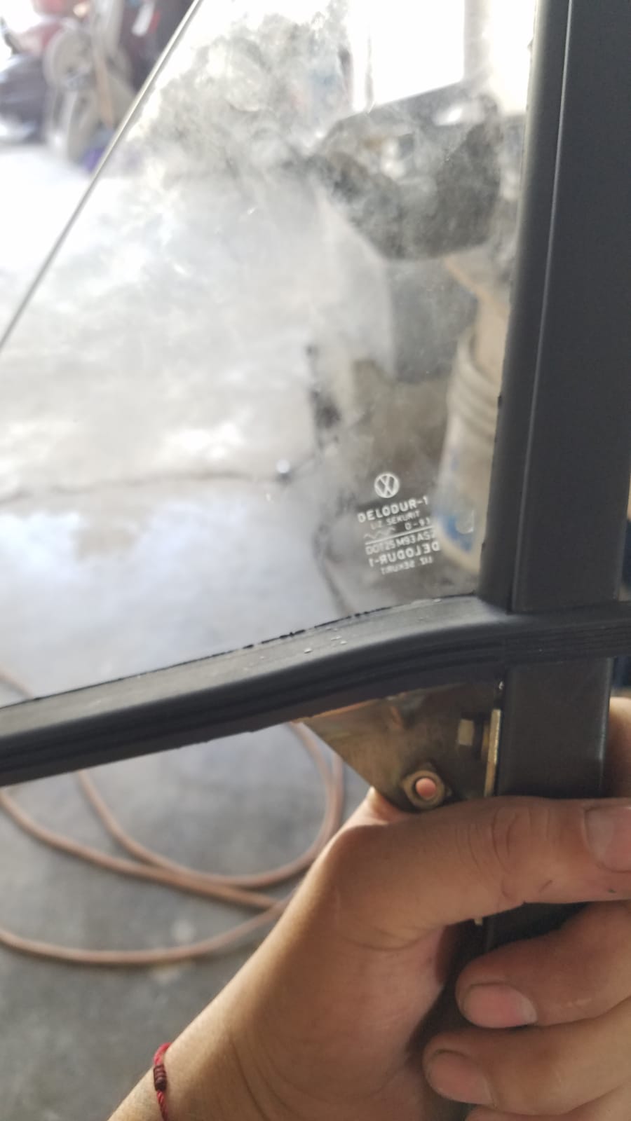

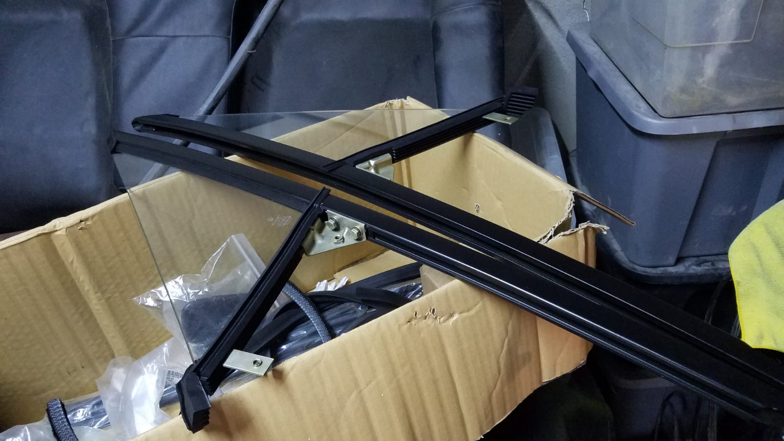

From there I moved onto the door window installation. Cut and trim all the new 914 Rubber parts, the aluminum channel, window scrapers and seals.
I had to do a little bit of adjustment on the end cap because it wasn't lining up with the aluminum channel.

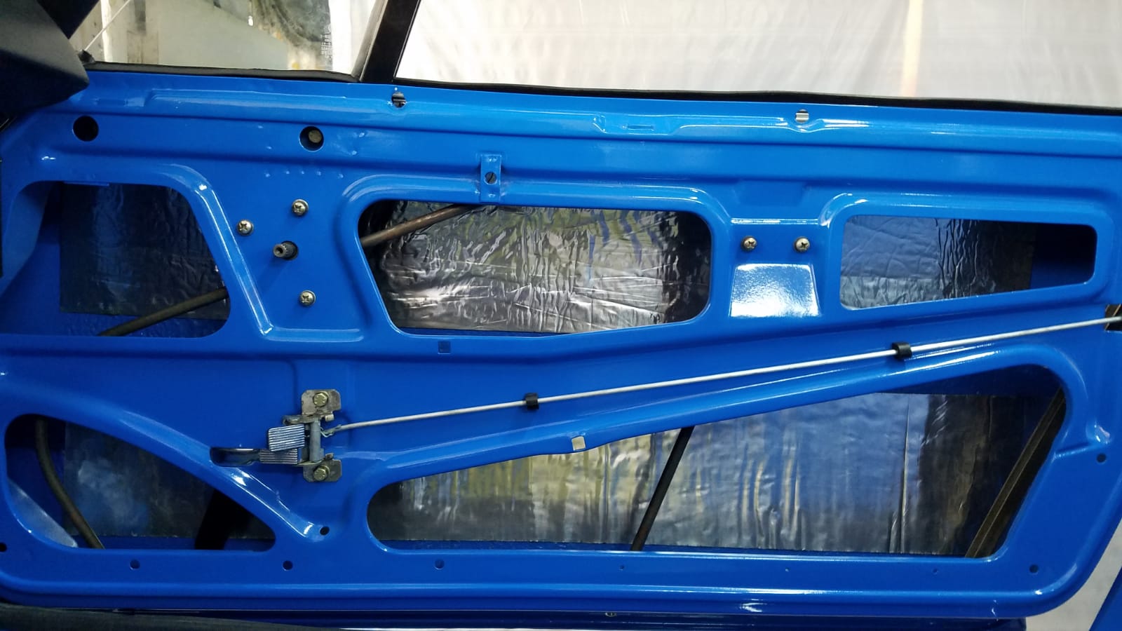

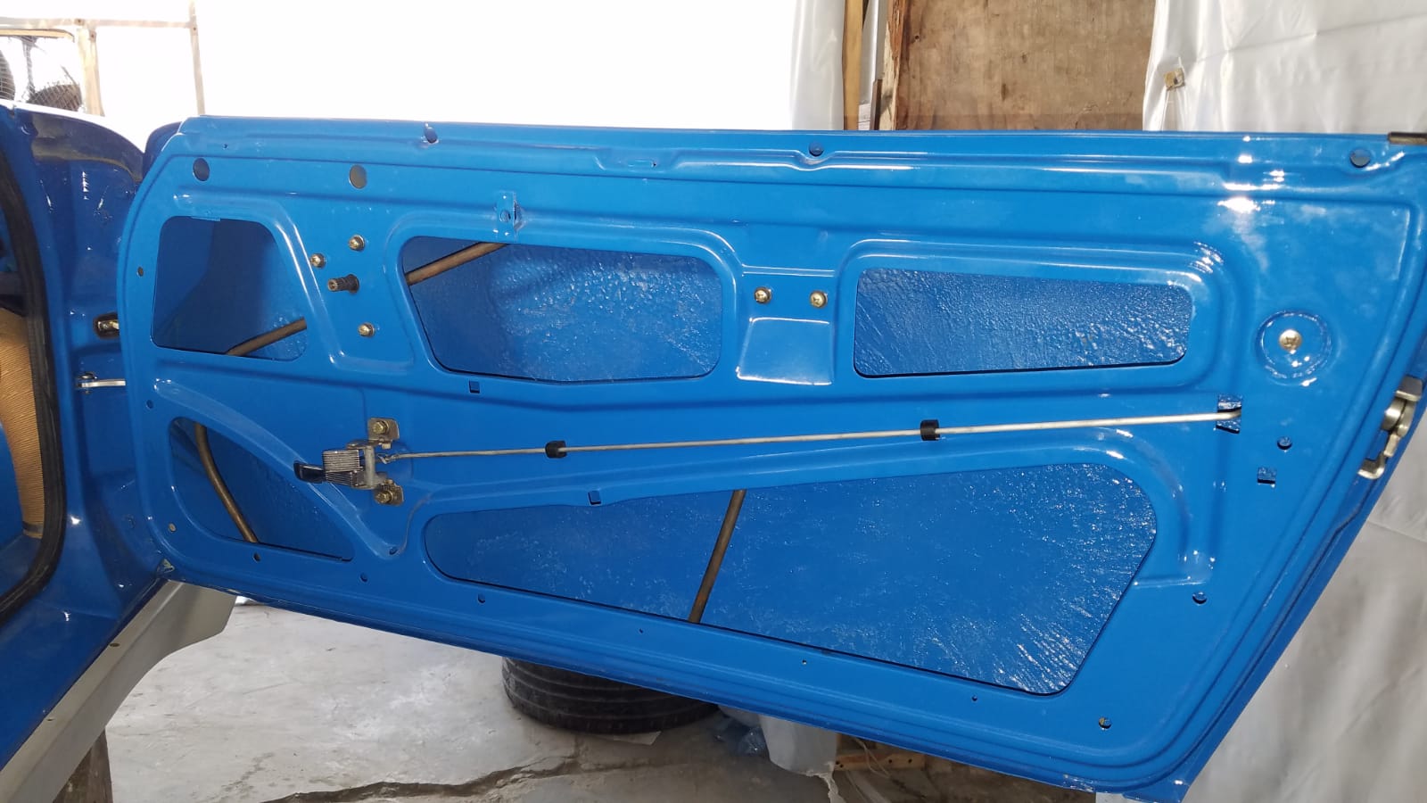

Then I added a couple of strips of sound deadener material.

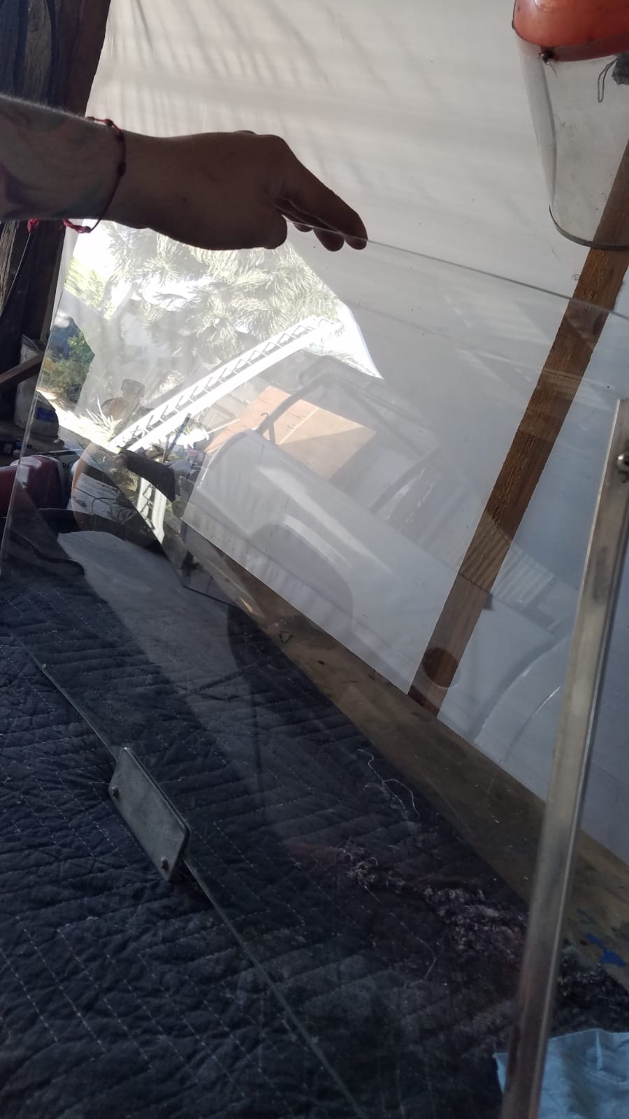

Next install door windows and make sure they roll up and down without binding. The garage door lubricant I used seems to have worked out well. Pretty happy with the window fitment but I really can't do any more adjustment on it until I get the top on and all the seals installed.

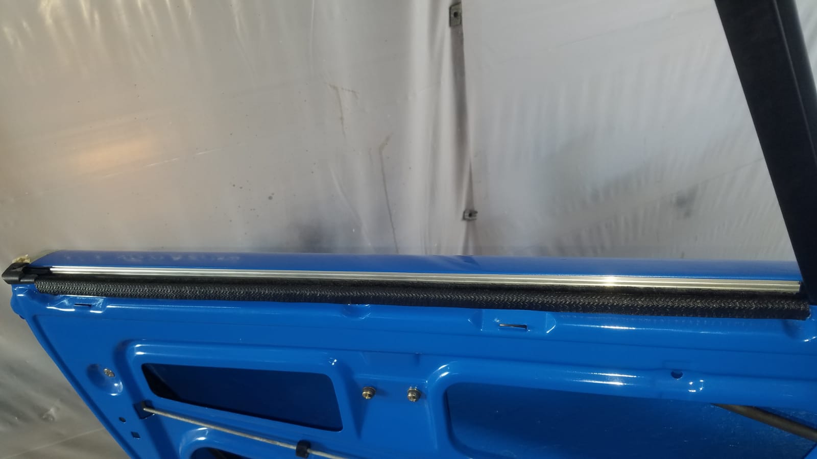

Here is a shot of the outer seals installed and trimmed.

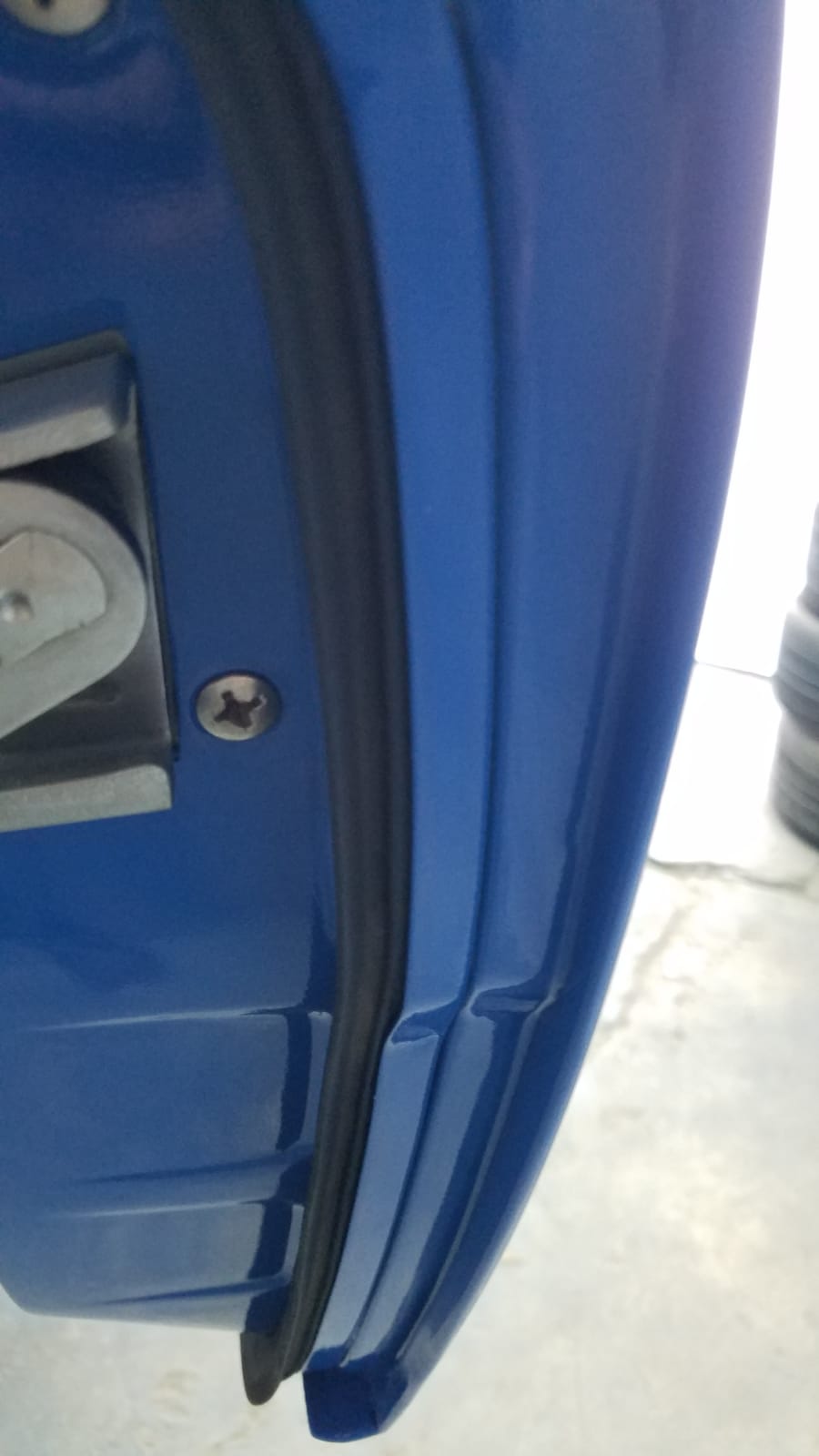

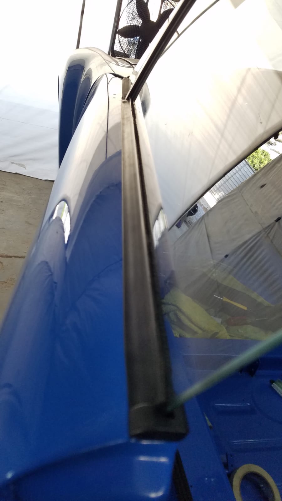

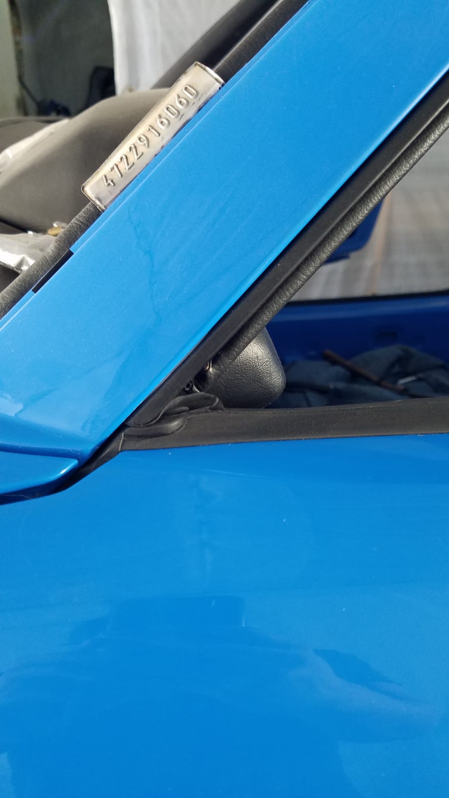

Moving forward, door seal installed.
