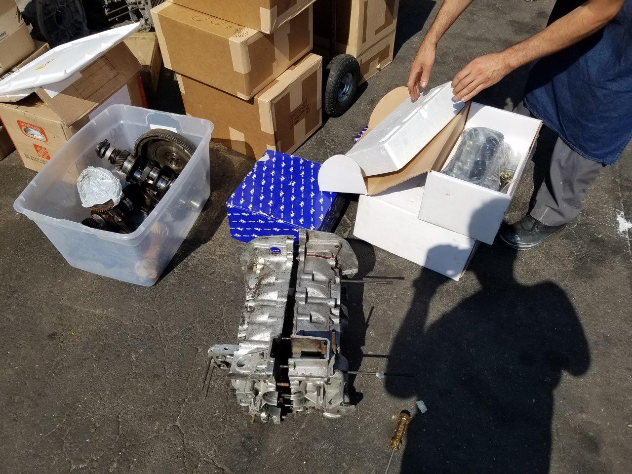

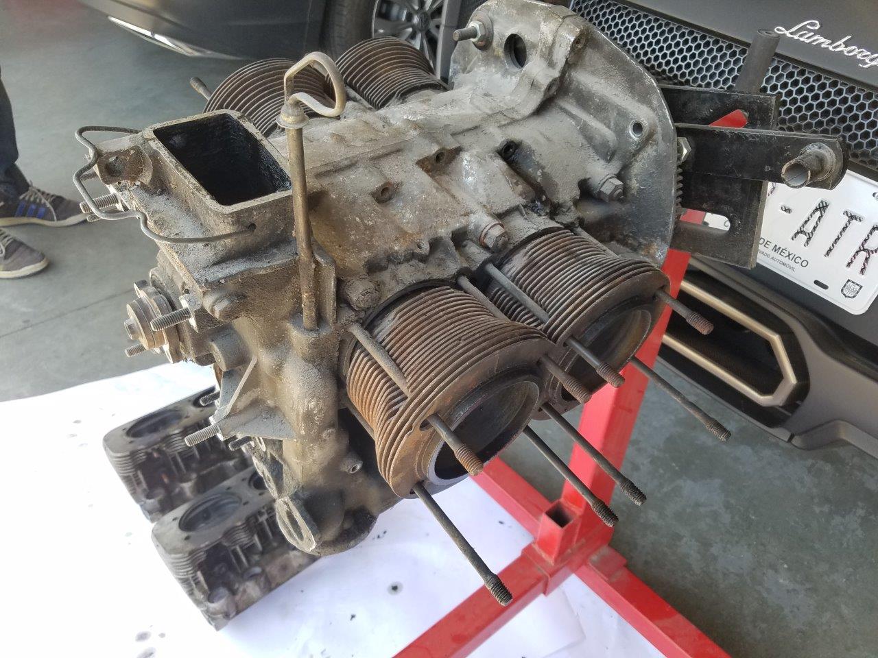

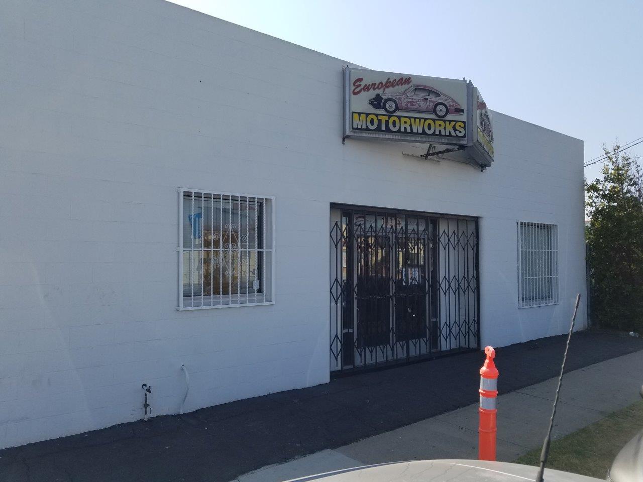

Last week I took my engine on a little trip to LA, some of you might recognize the place. It has been great working with them, Jorge and Carlos have been great to work with.

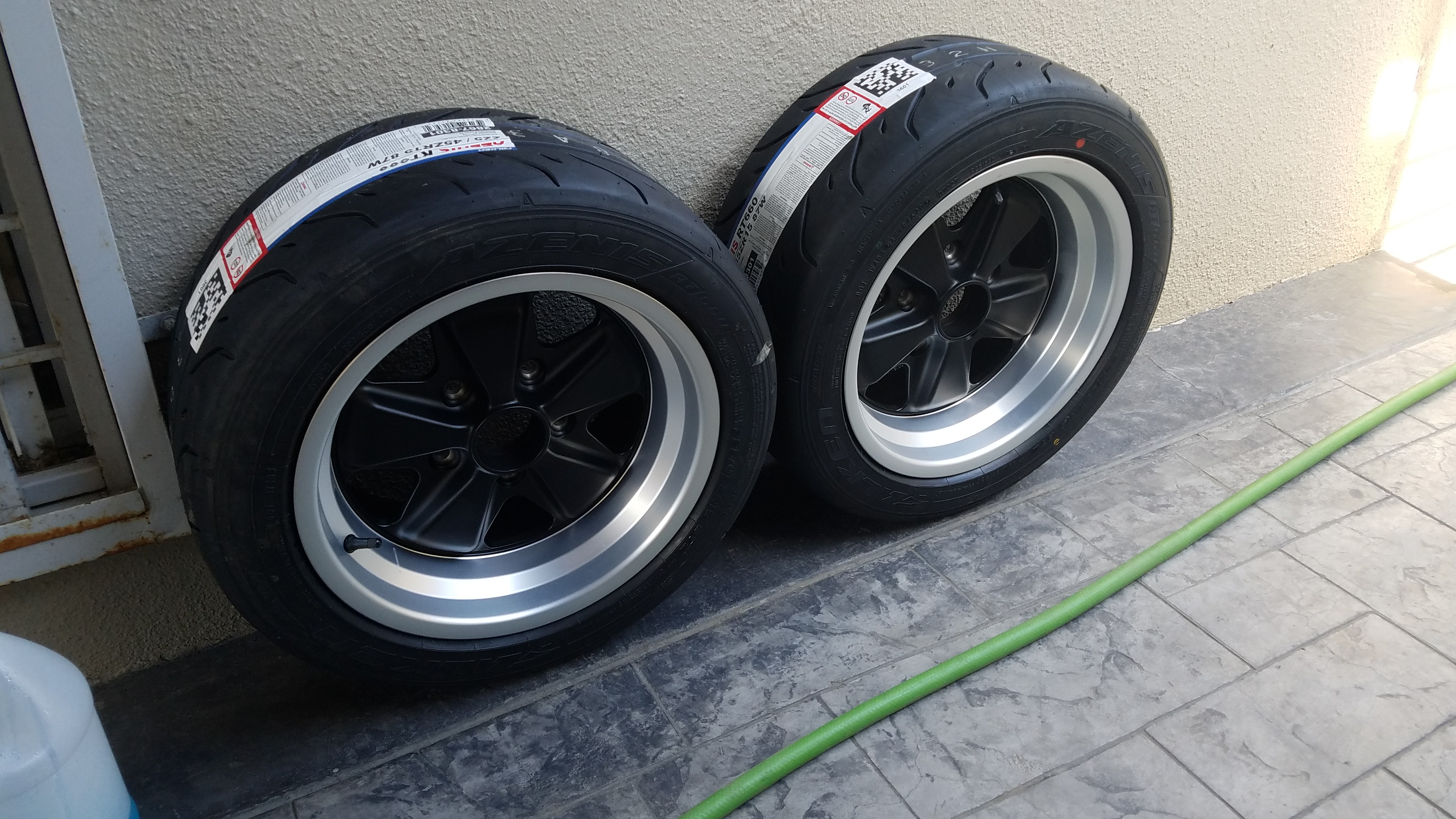

Got my boy some new shoes. Bought these from Maxilite wheels and I think they look great. Sizes are 8x15 and 9x15, tires are FALKEN AZENIS RT660 225/45ZR-15 and 245/40ZR-15

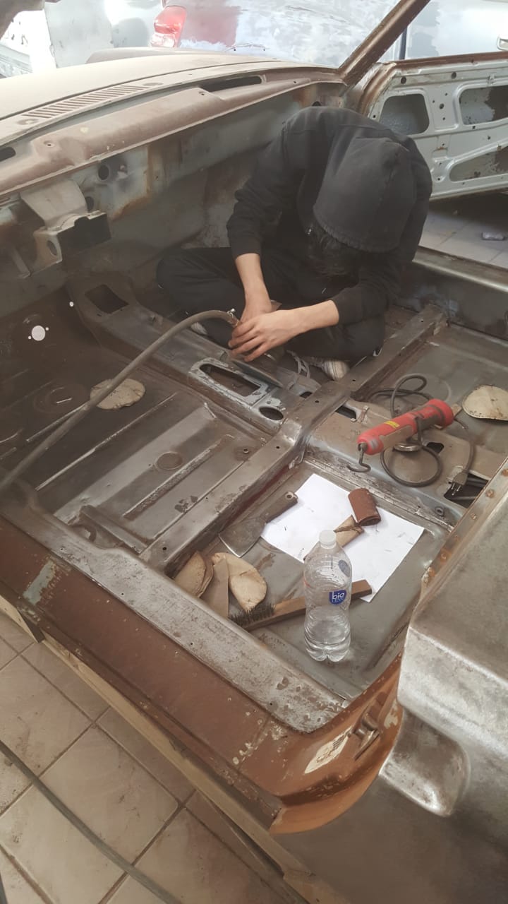

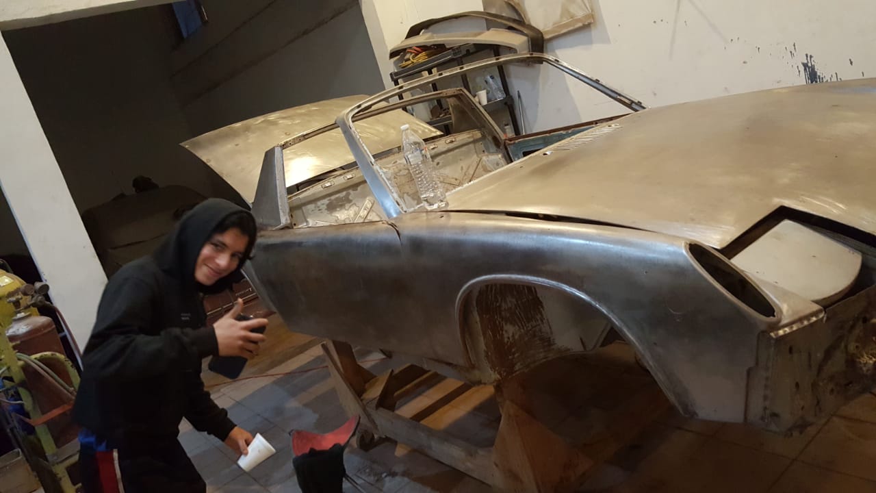

During my kids summer break I put him to work on all those little jobs everyone loves to do (IMG:style_emoticons/default/happy11.gif)
He actually did a pretty good job at it

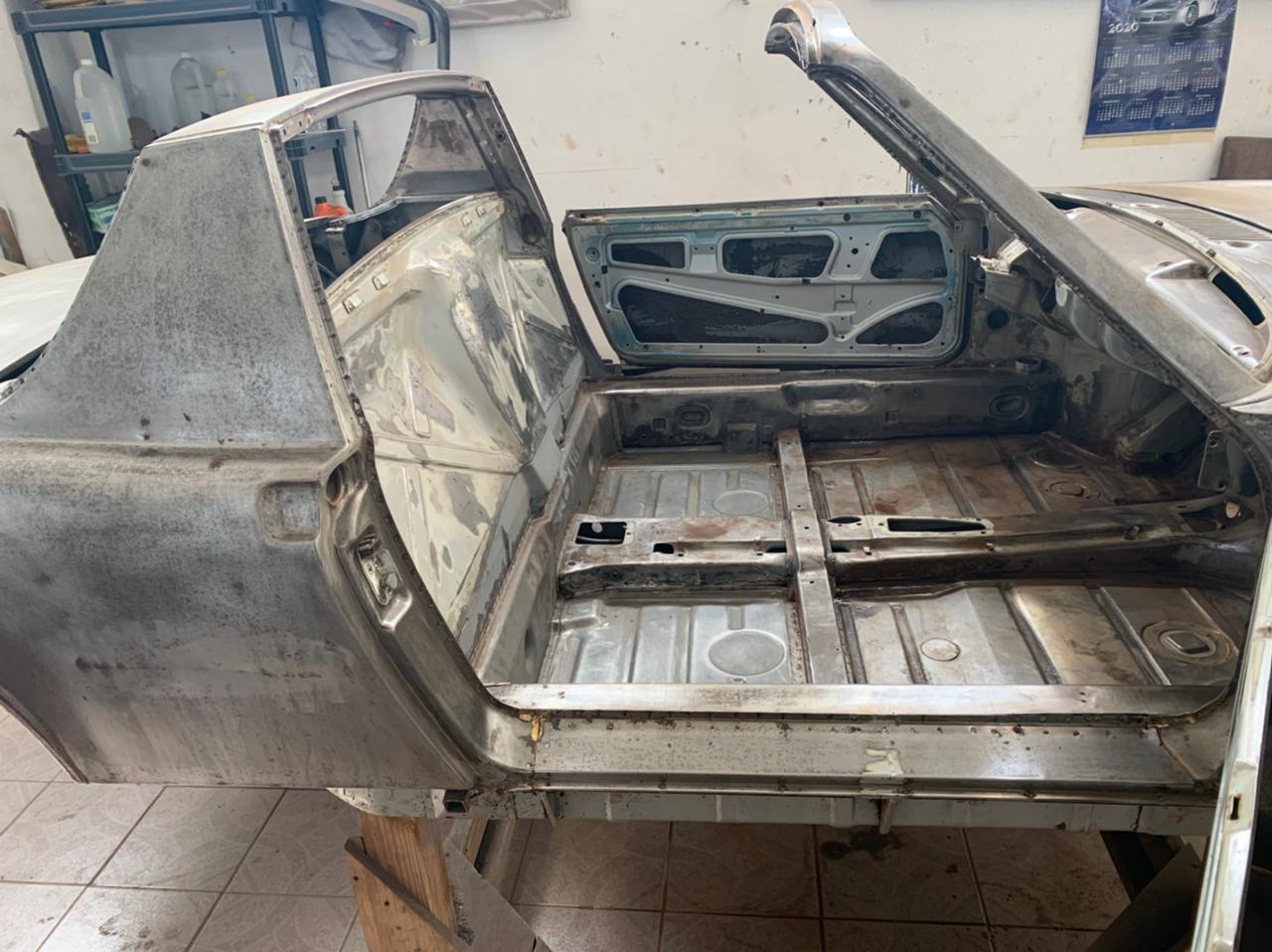

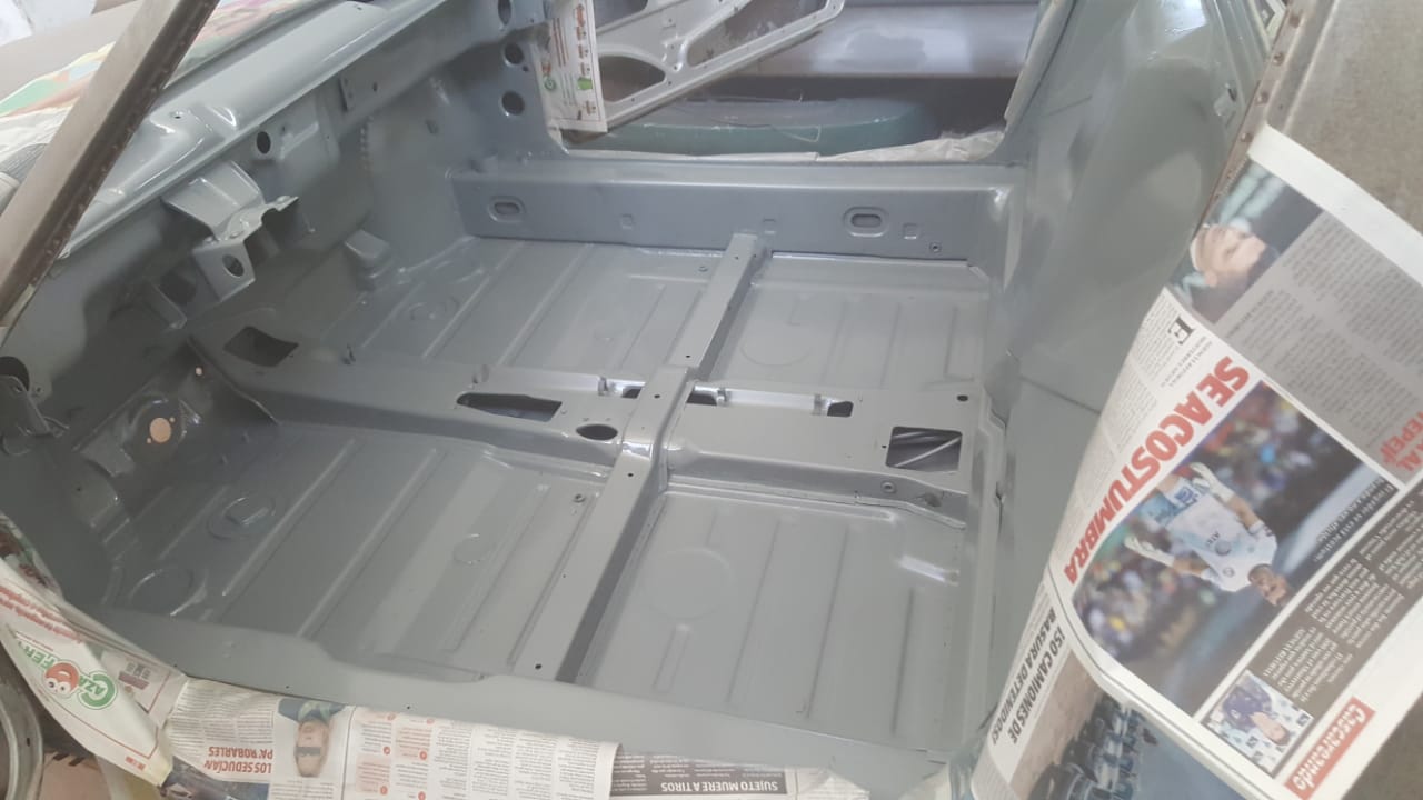

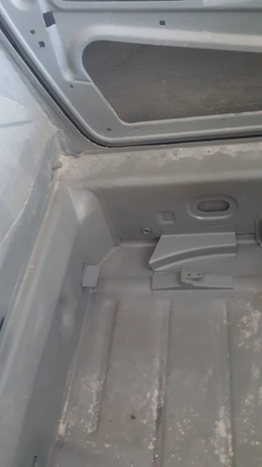

Primer inside the cab so it doesn't rust again.
Here it is, ready for the bodywork to begin (IMG:style_emoticons/default/aktion035.gif)

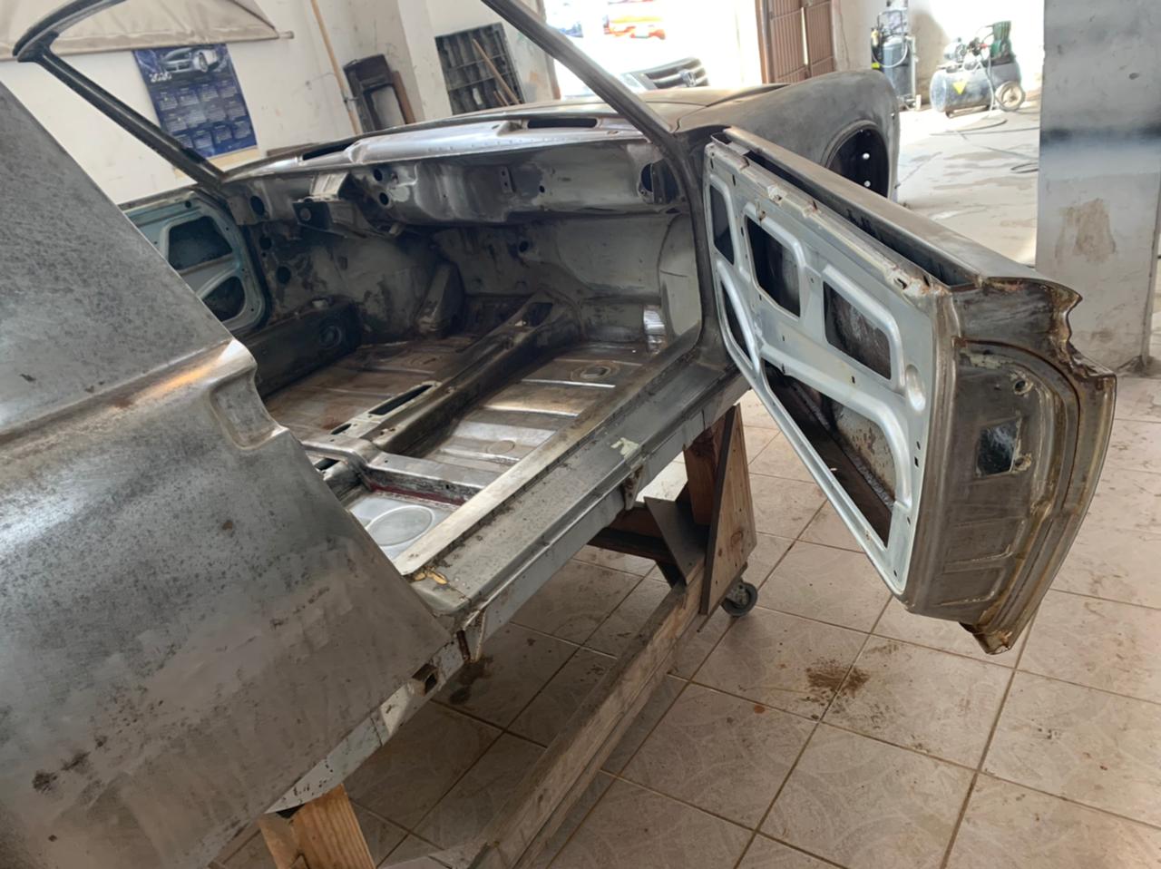

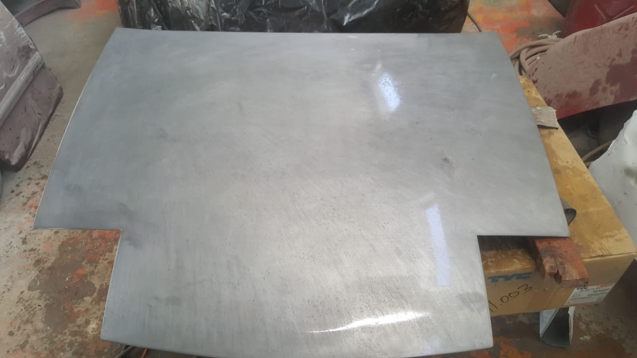

Work continues on the metal prep prior to epoxy primer. Had to work in sections to get the epoxy primer on before the panels developed surface rust again.
autopro
post Aug 6 2021, 01:22 PM
Post #50
Posts: 306
Joined: 14-January 18
From: San Diego / Tijuana
Member No.: 21,797

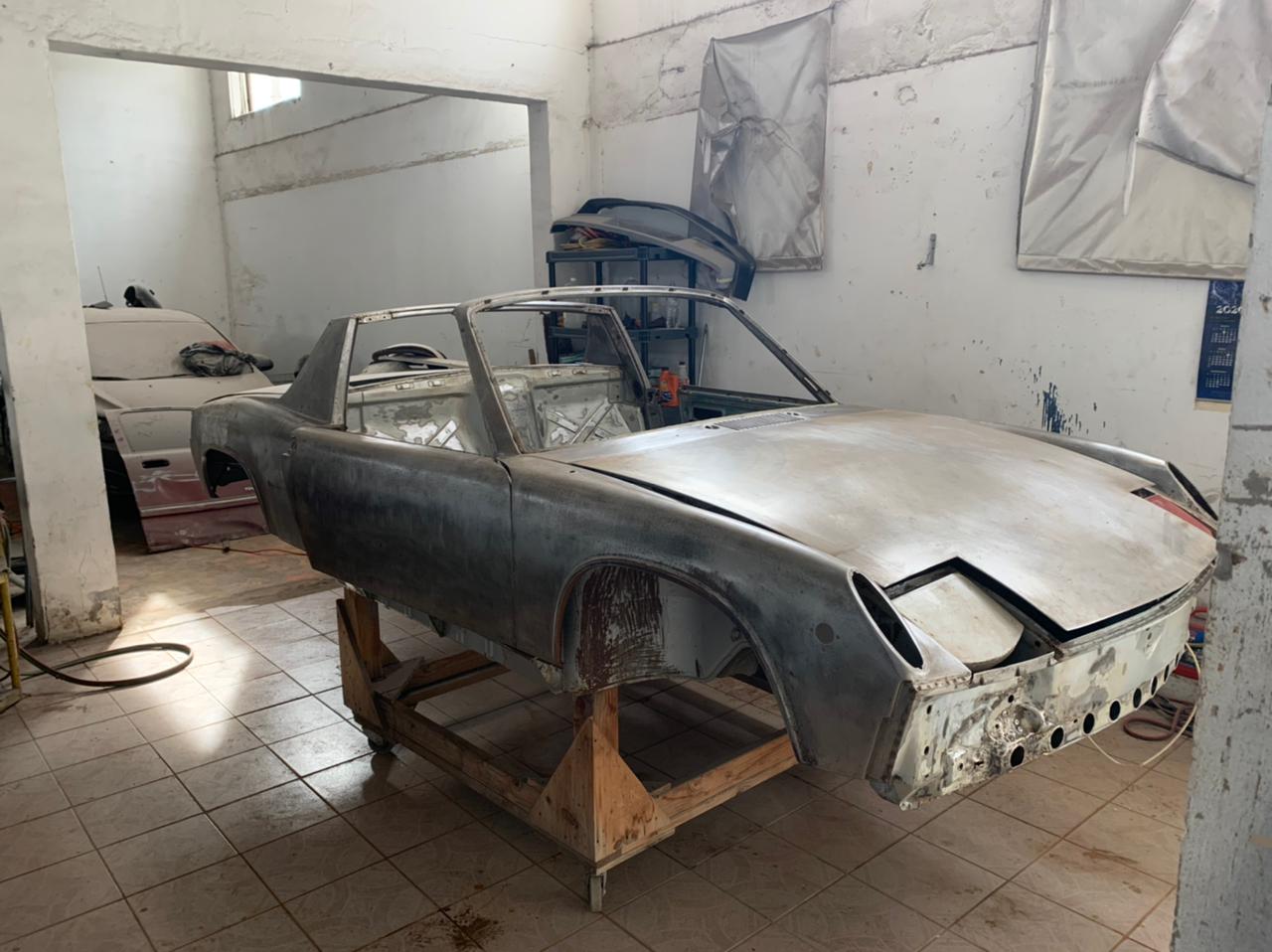

A few more. I was able to finish the whole car and now it will be ready for body work.

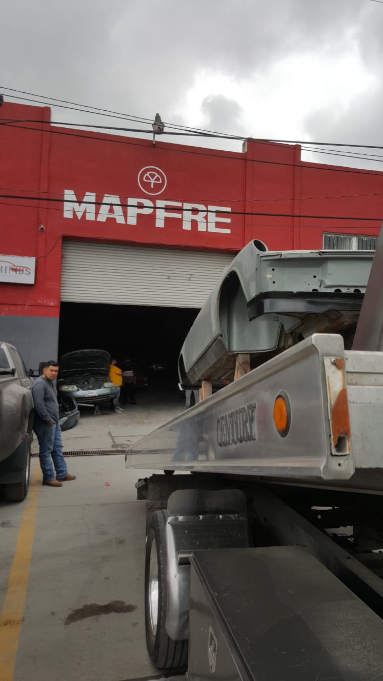

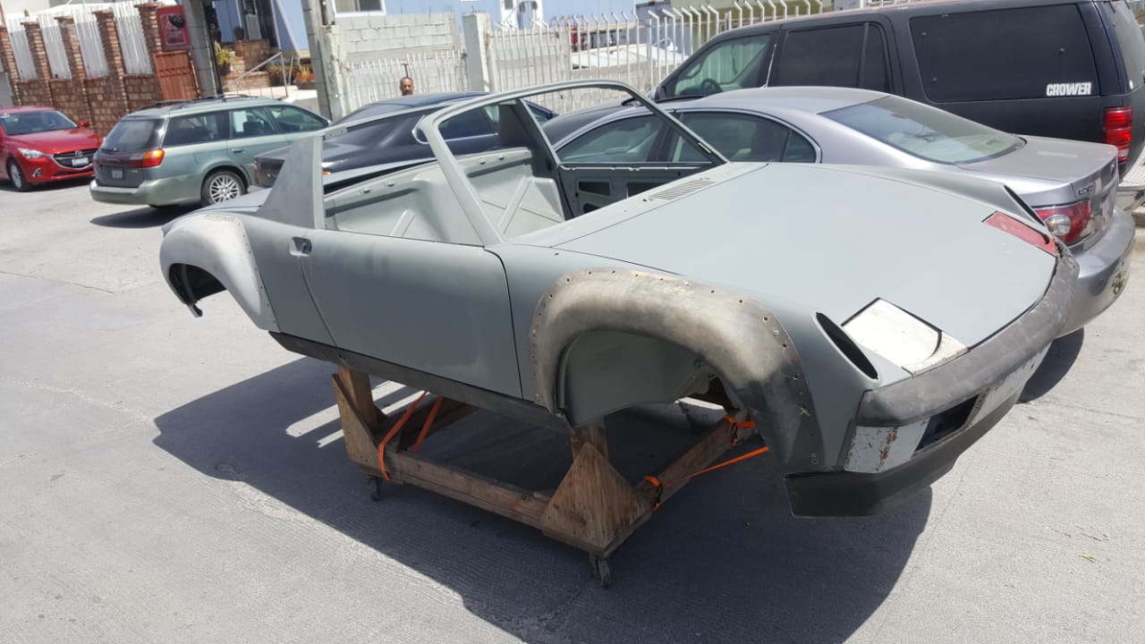

Well now that the whole body has been taken down to bare metal and epoxy primer applied, it went to my friends shop to get the body work done (IMG:style_emoticons/default/smash.gif) . I really hate doing body work and my friend has a really good bodyman and will finish it a lot faster and better than I ever could.

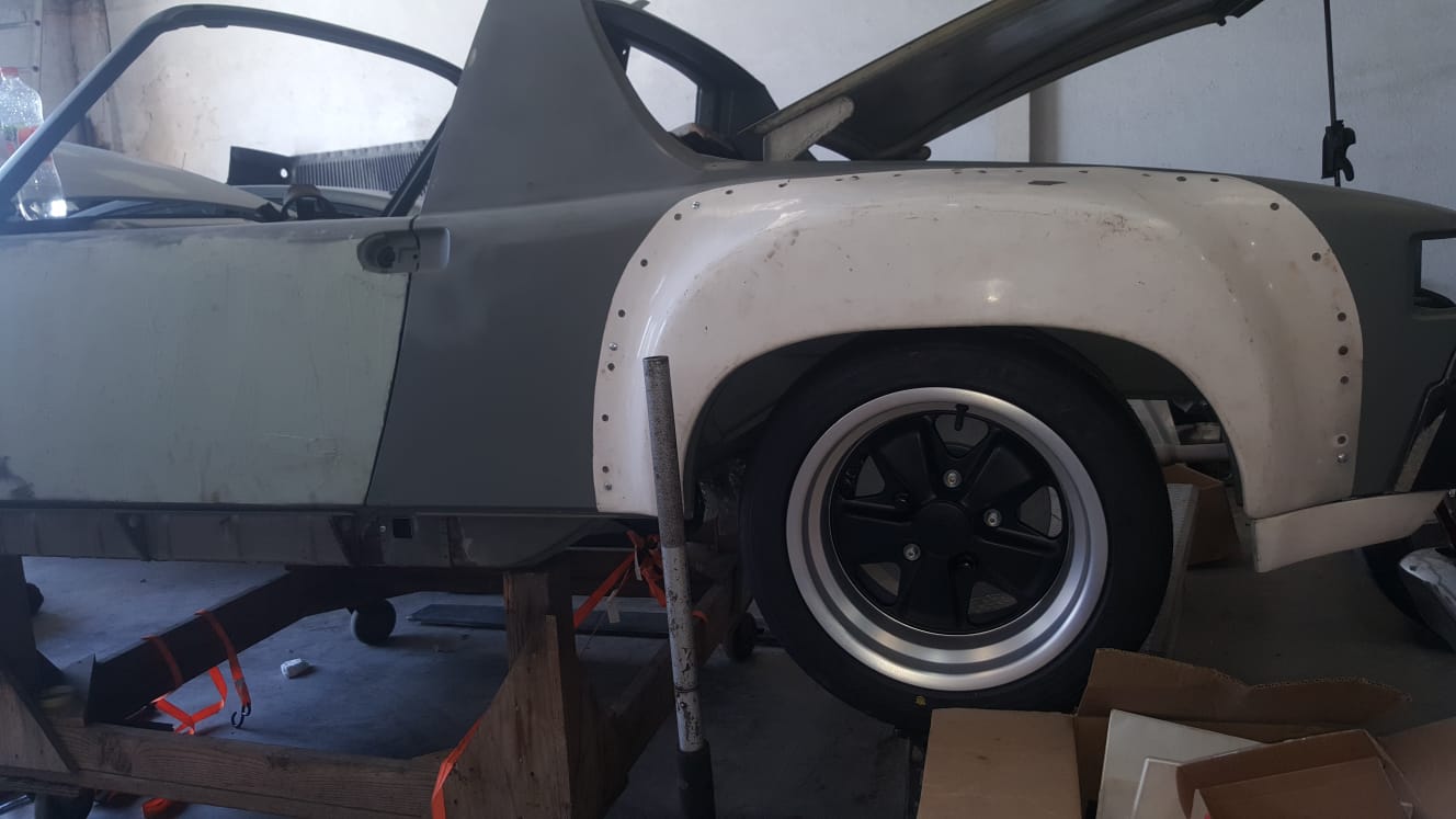

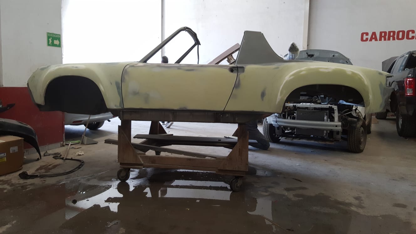

Upon arrival at my friends shop, couldn't wait for the work to begin (IMG:style_emoticons/default/biggrin.gif)
First thing I did was install suspension and wheels to check the fitment of the fenders. At this point I didn't have the front tires, but I got them before the final fitment of the fenders.

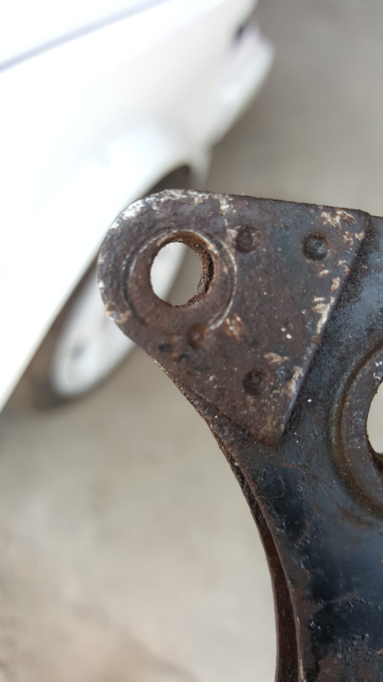

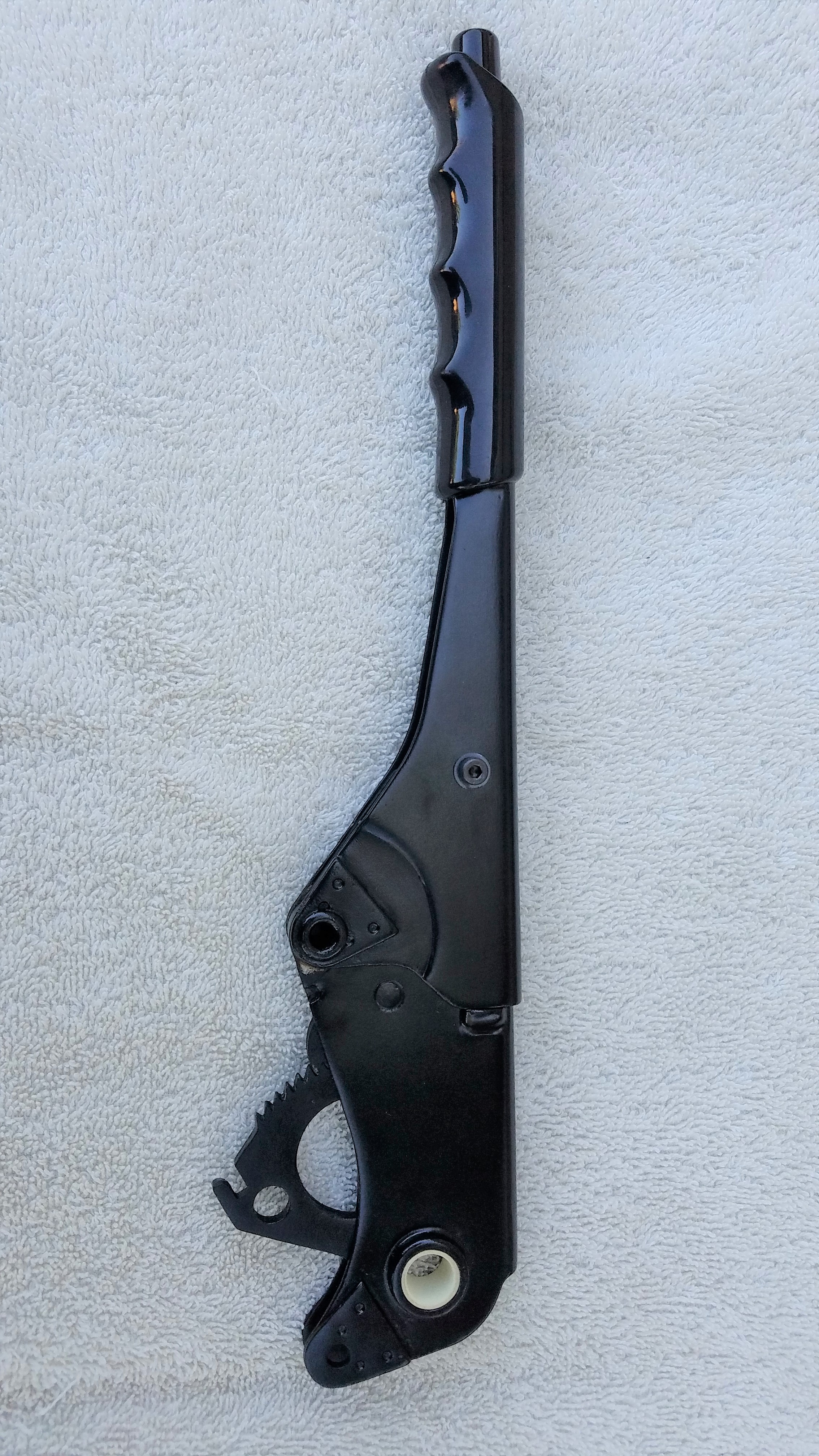

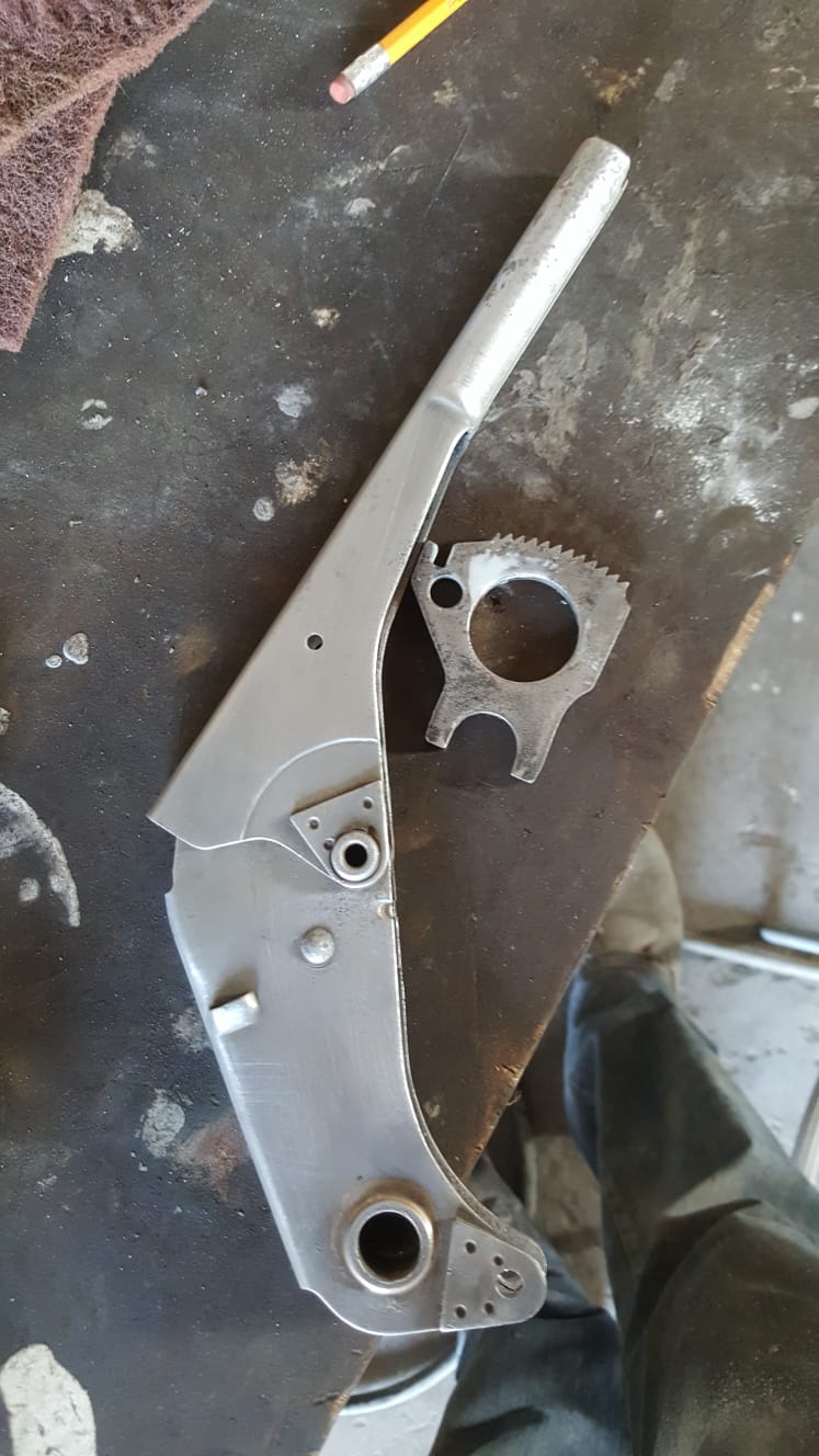

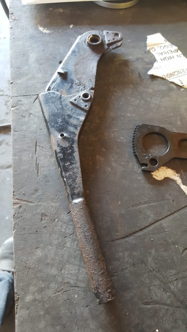

Now that the car is at the body shop, I can concentrate on working on restoring other parts. First up was the handbrake, it was in really bad shape and thanks to parts availability I was able to get it working again.
Here is what it looked like when I first removed it from the car. It didn't have the spring, handle or any of the internals.
The hole for the cable was deformed so I welded it up and then drilled a new hole
autopro
post Aug 25 2021, 08:35 PM
Post #54
Posts: 306
Member No.: 21,797

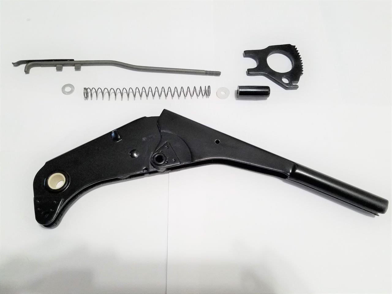

Removed all the paint and rust
Here are all the parts that I had to get to make it functional
And the finished product

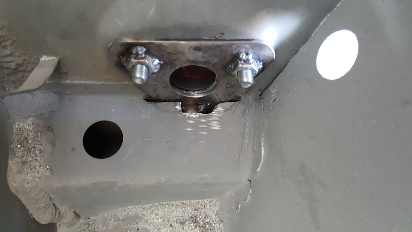

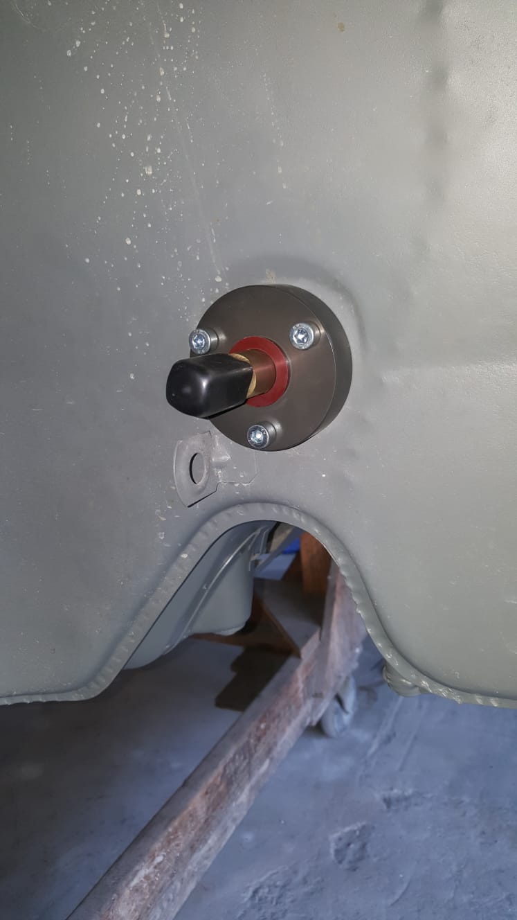

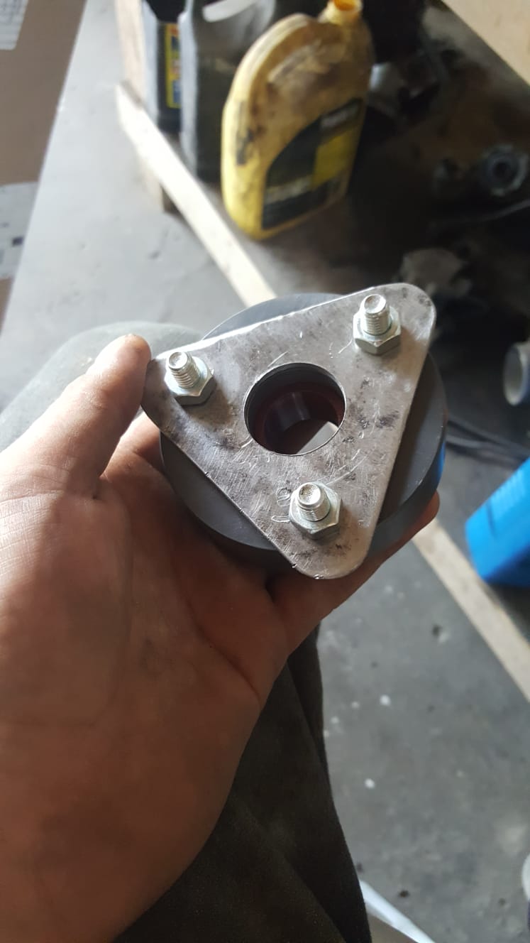

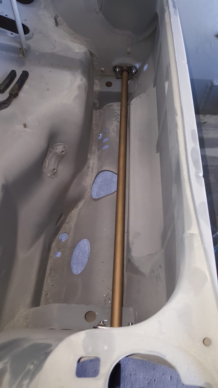

Another thing on my to do list before paint was the front sway bar modification. I bought it from GR German Parts Restoration. Made the bracket for the inner fender well, and then drilled the holes to fit the sway bar. Here I'm checking the alignment prior to welding the bracket on.

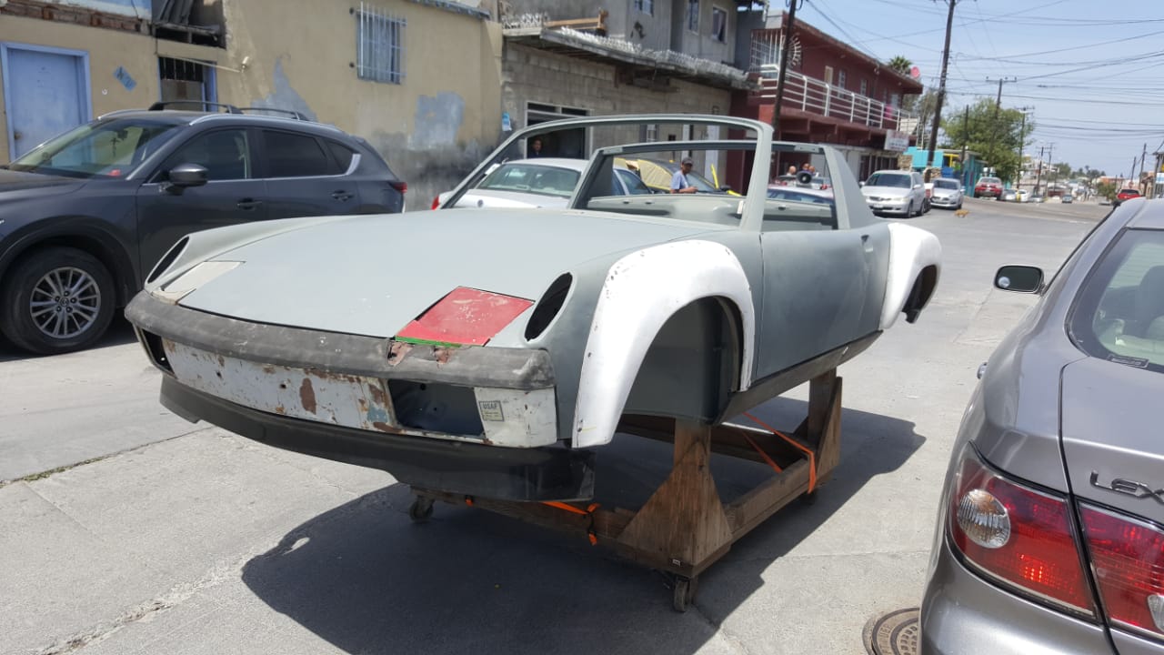

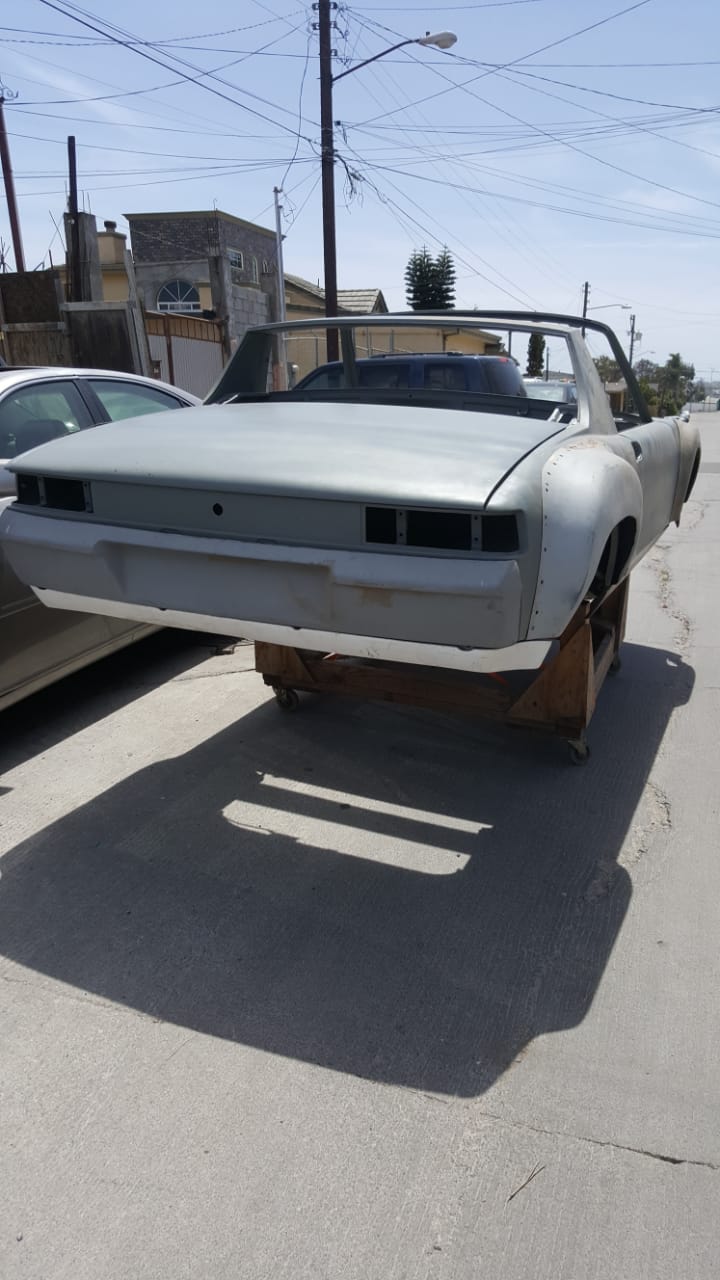

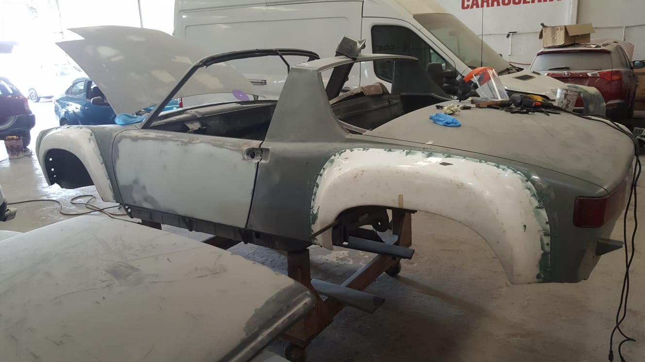

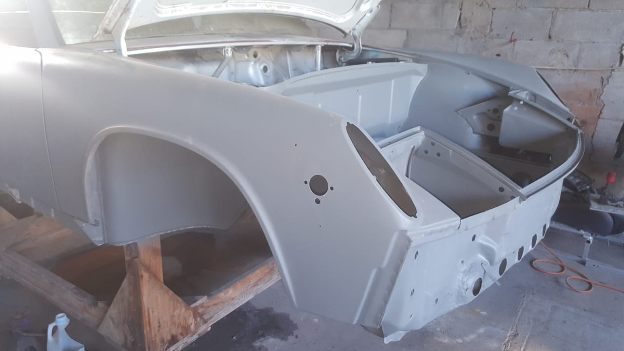

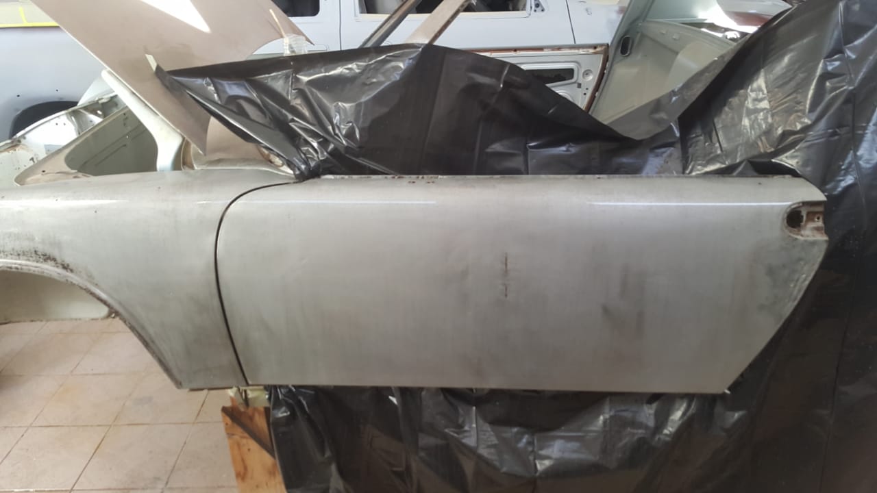

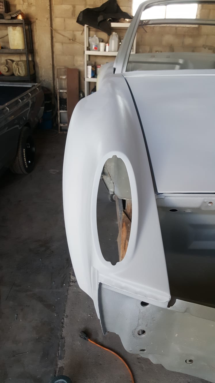

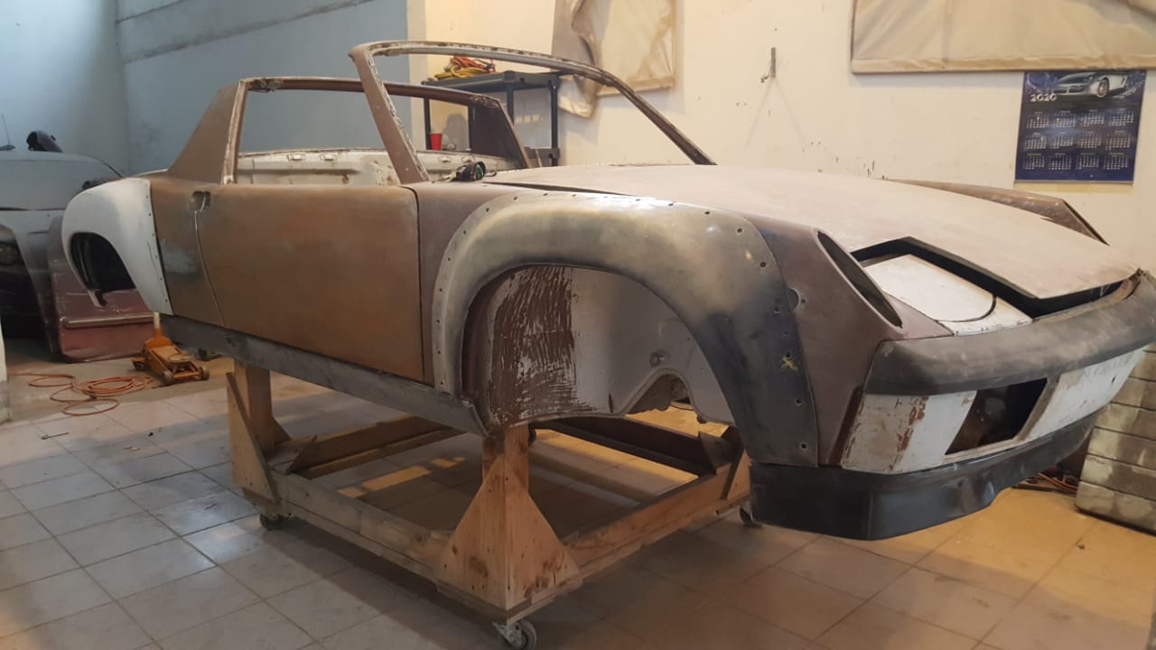

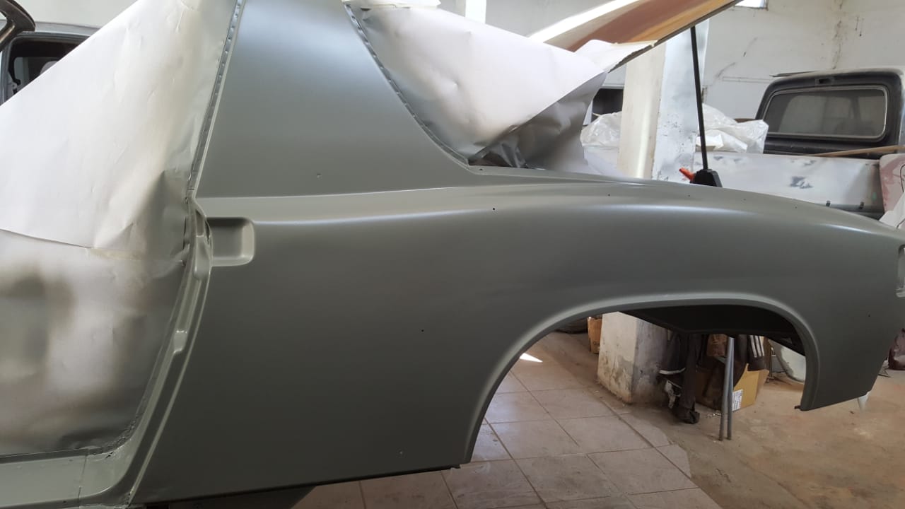

Lots of bodywork has been going on, here are some of the highlights. Cutting the fenders took a bit of courage, but I love the widebody look so no looking back now.
Here most of the body work is finished and from here I will be taking it to a garage I have to do the final blocking and getting ready for paint.

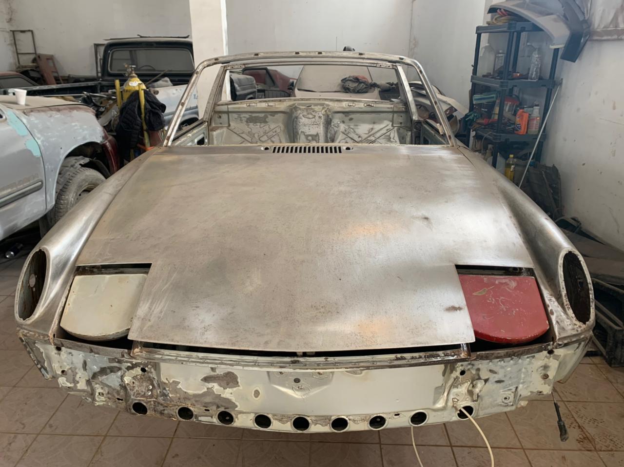

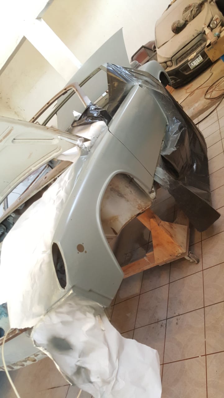

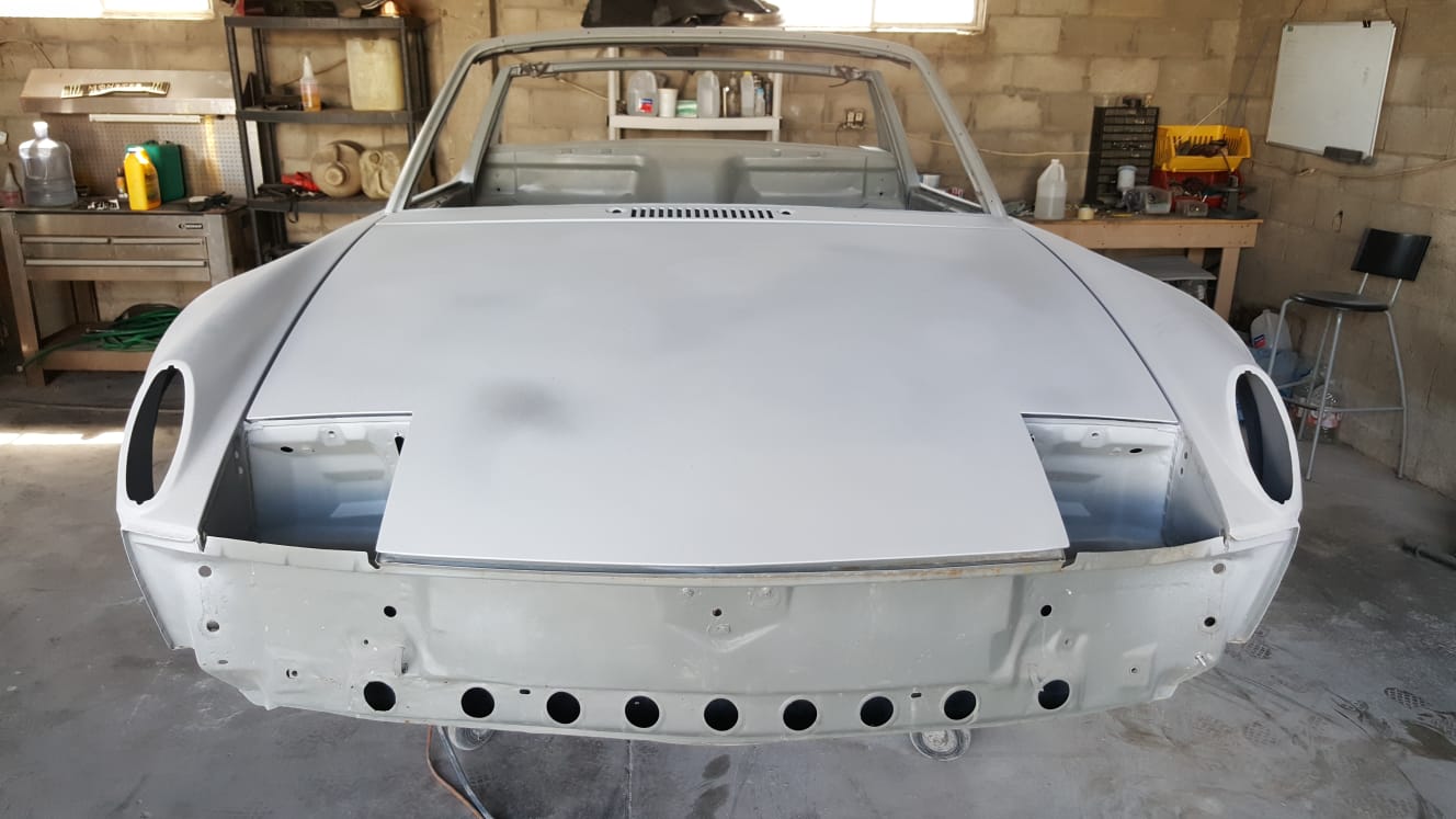

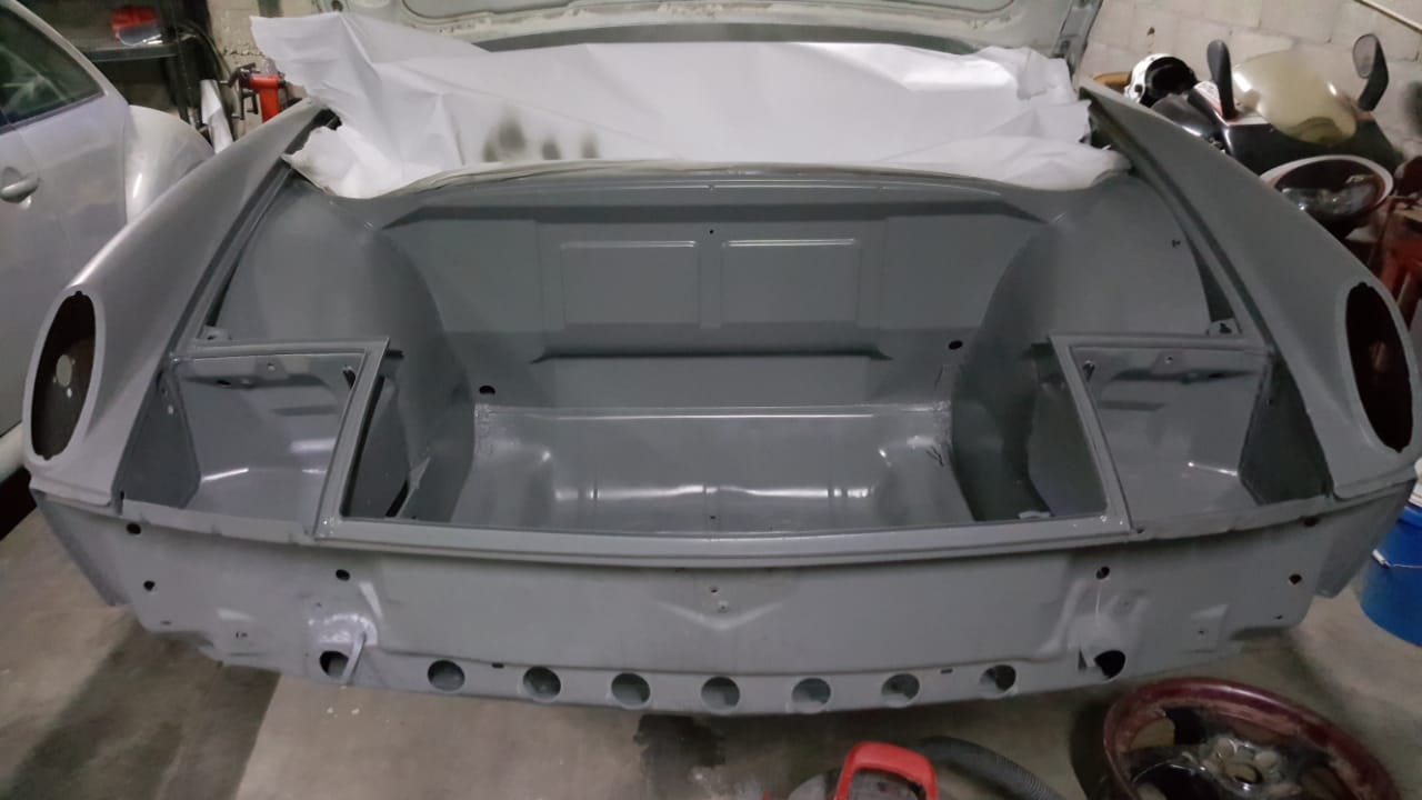

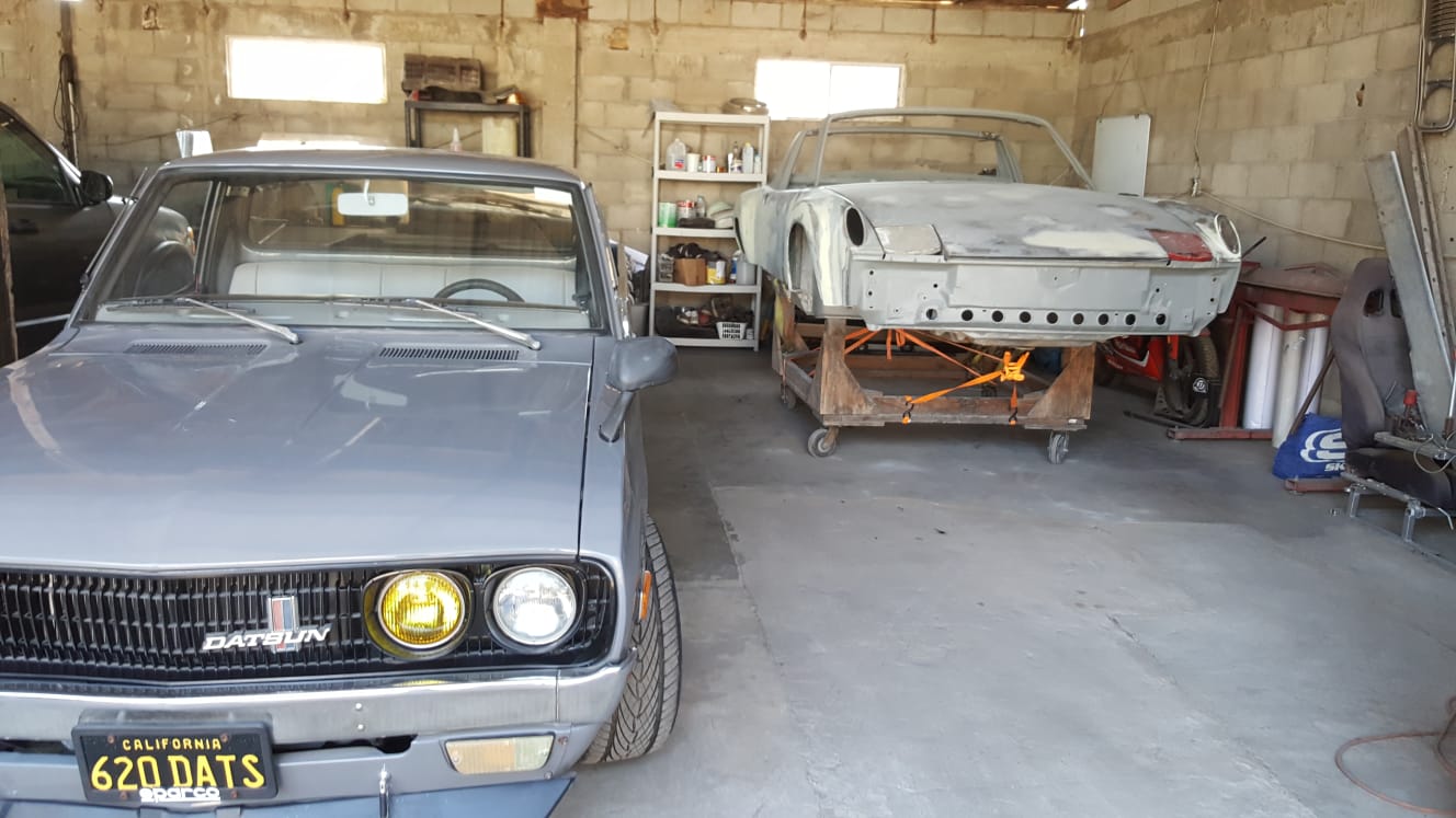

Got it back to my shop, hopefully I won't have to move it again. It is always stressful to move it with the dolly on a flatbed tow truck. I'm always afraid its going to fall off.
Front end nearly complete

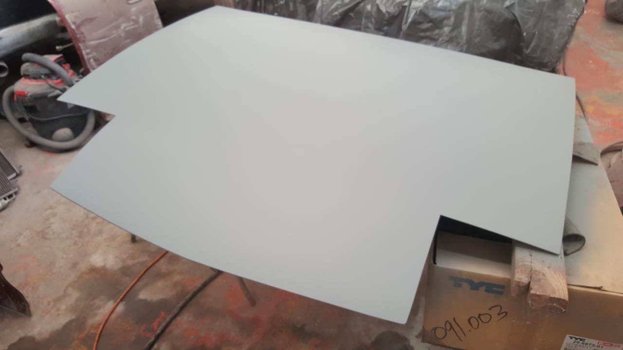

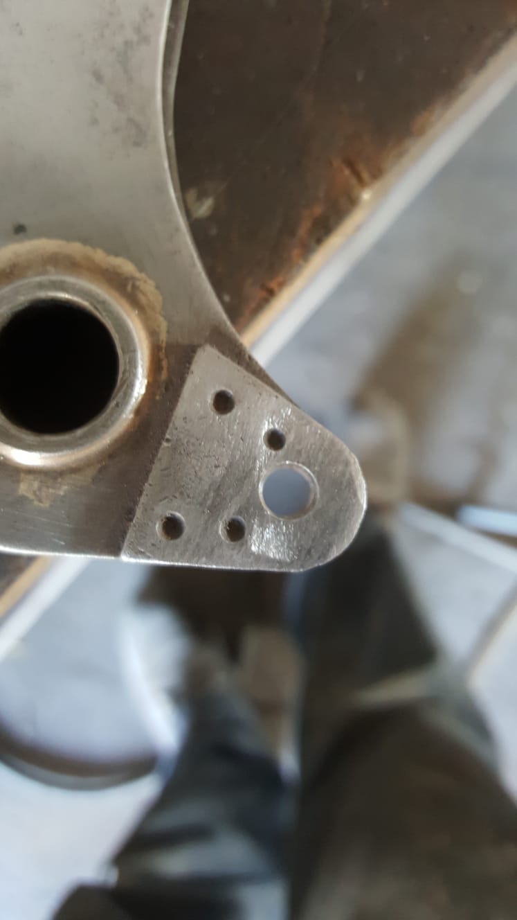

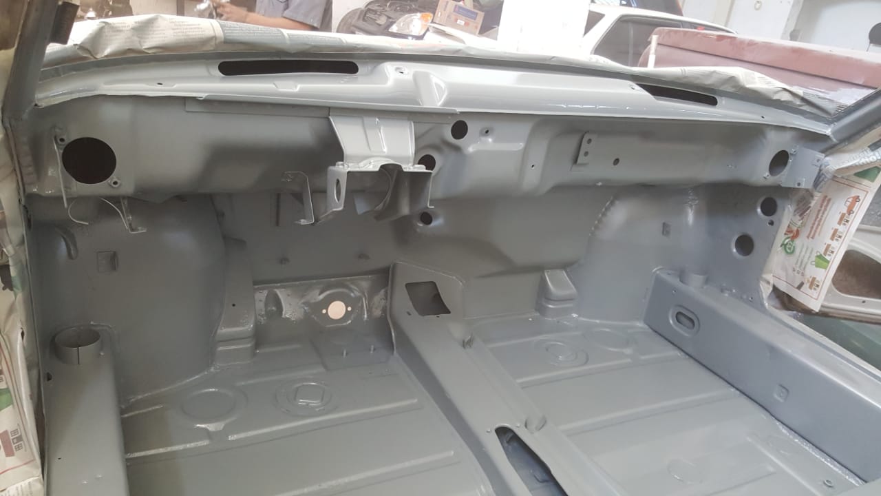

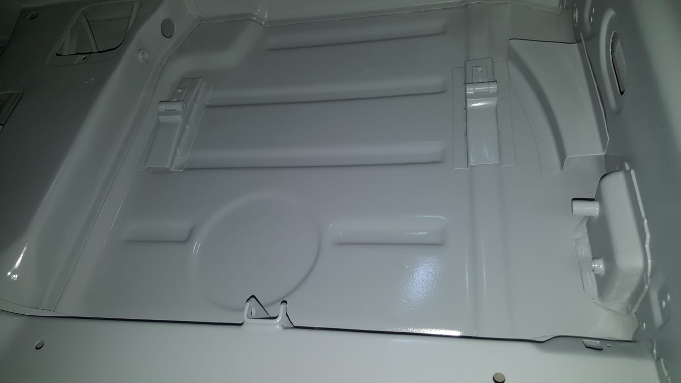

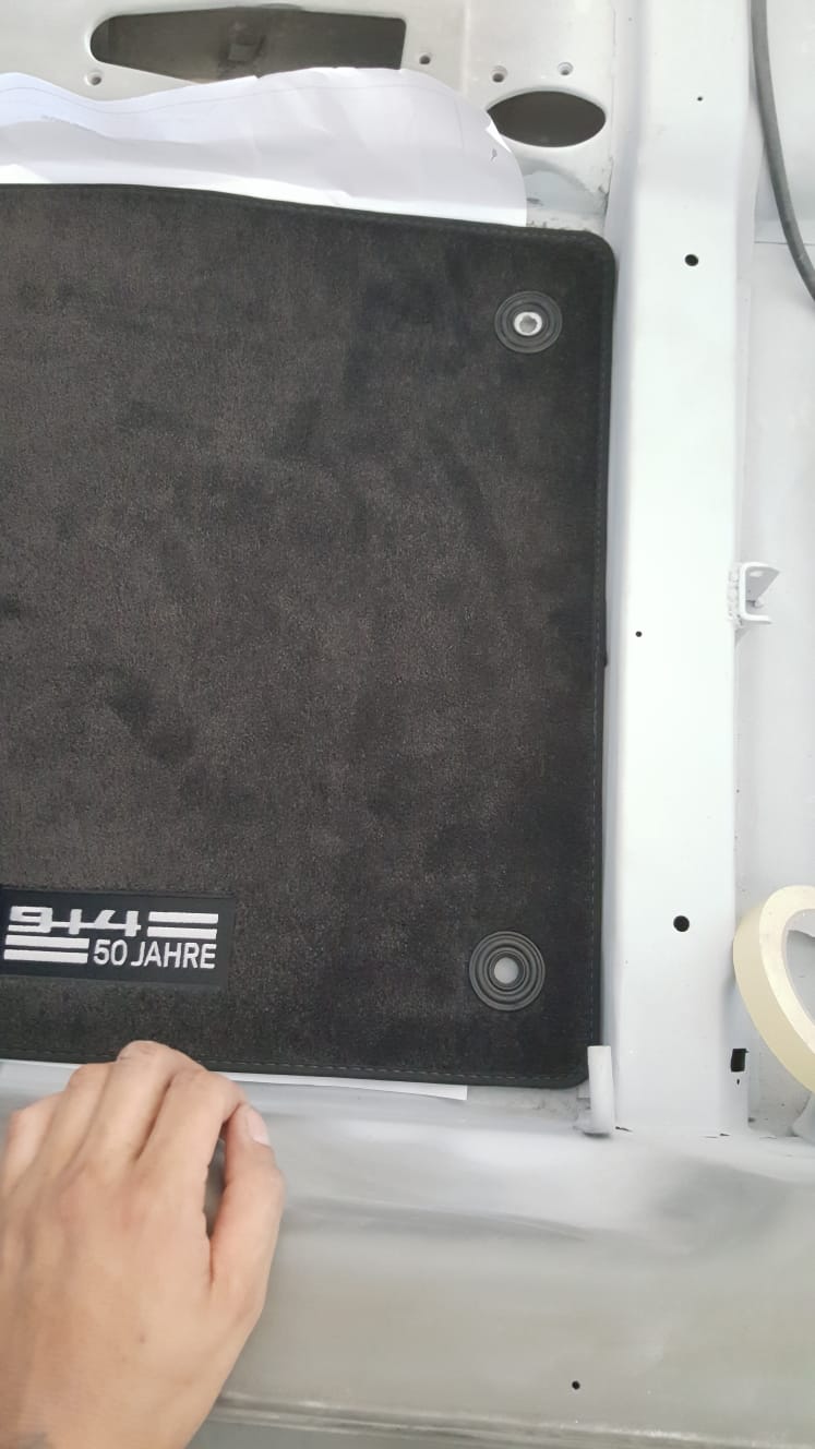

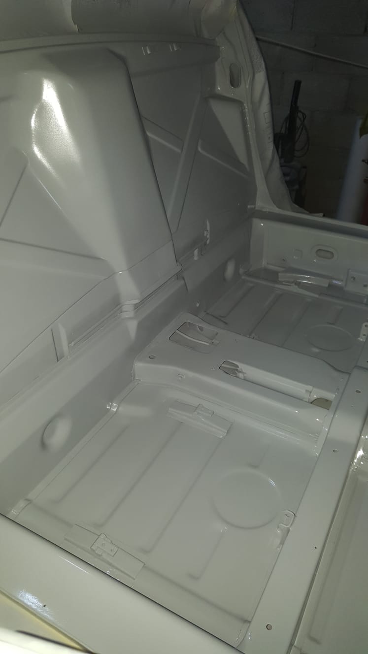

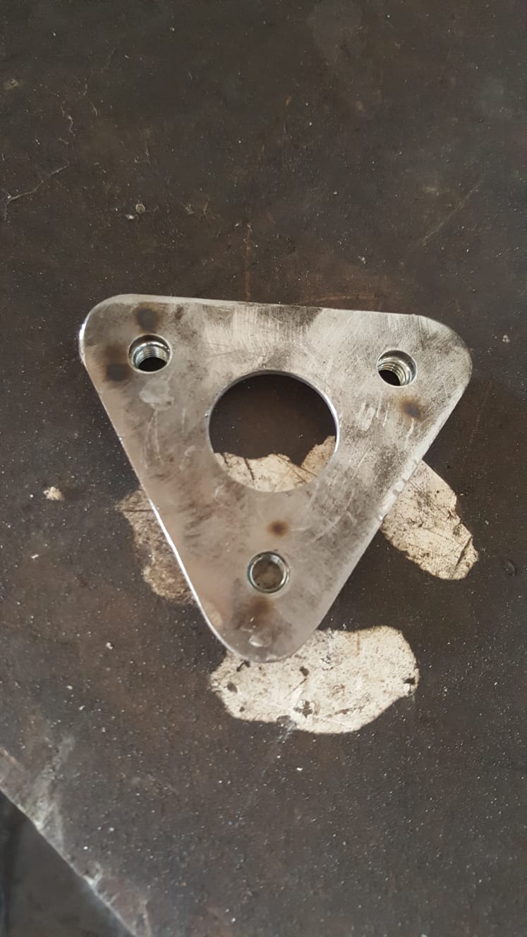

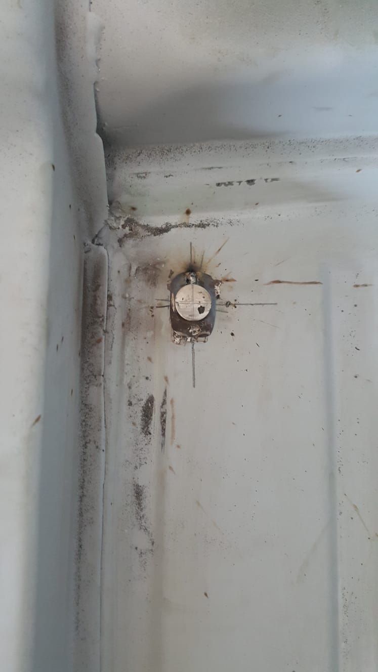

I still had to take care of some details for the floor so I thought this was a good time to get them off my list. I needed to add the hand brake cable guide and the rear bracket for the small cover.
Then I had to make some of the little posts to hold the floor mats in place.
All finished on the inside and now it is basically ready for paint, finally (IMG:style_emoticons/default/blink.gif)
