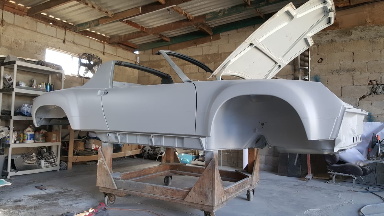

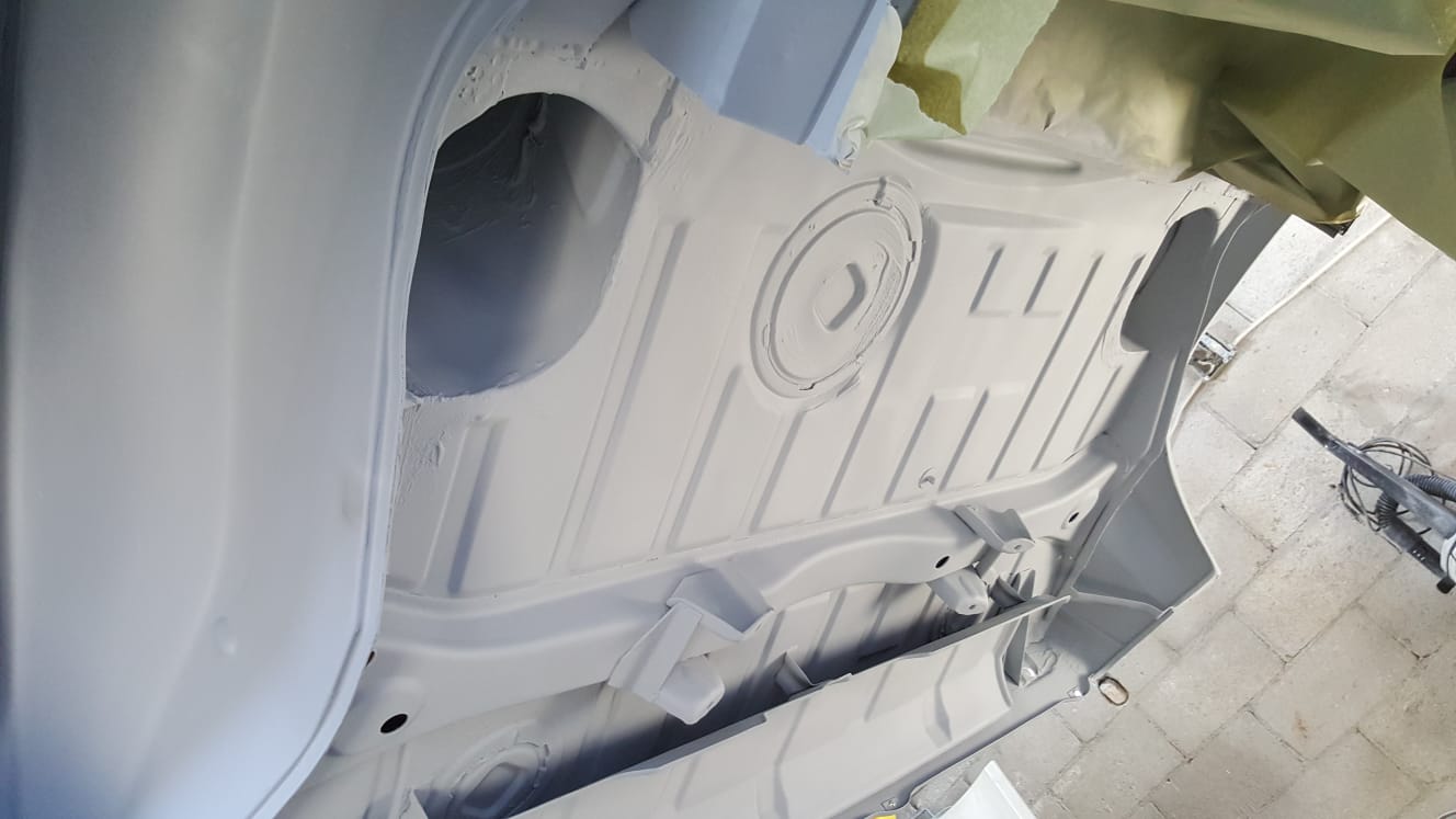

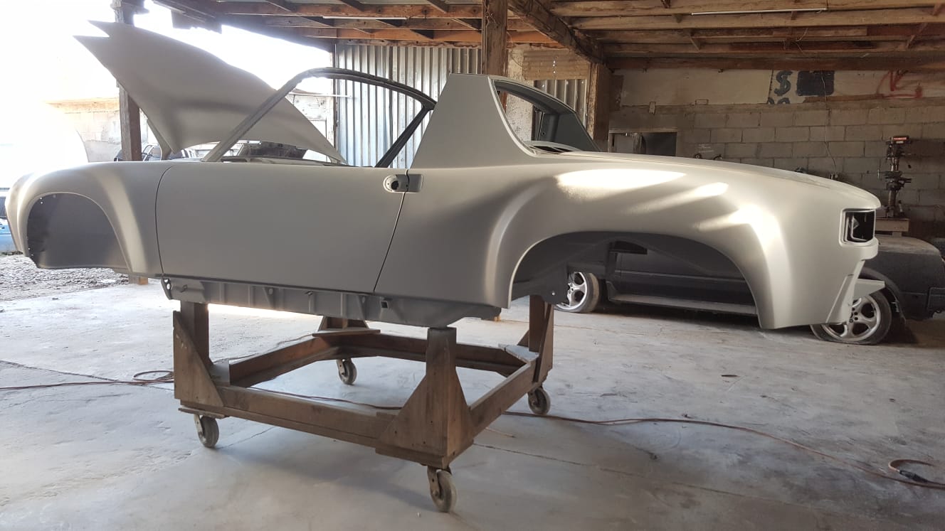

Finished first round of guide coat and blocking and now the car is in full primer. Ready for the second round of guide coat and blocking, then a third one (IMG:style_emoticons/default/wacko.gif)

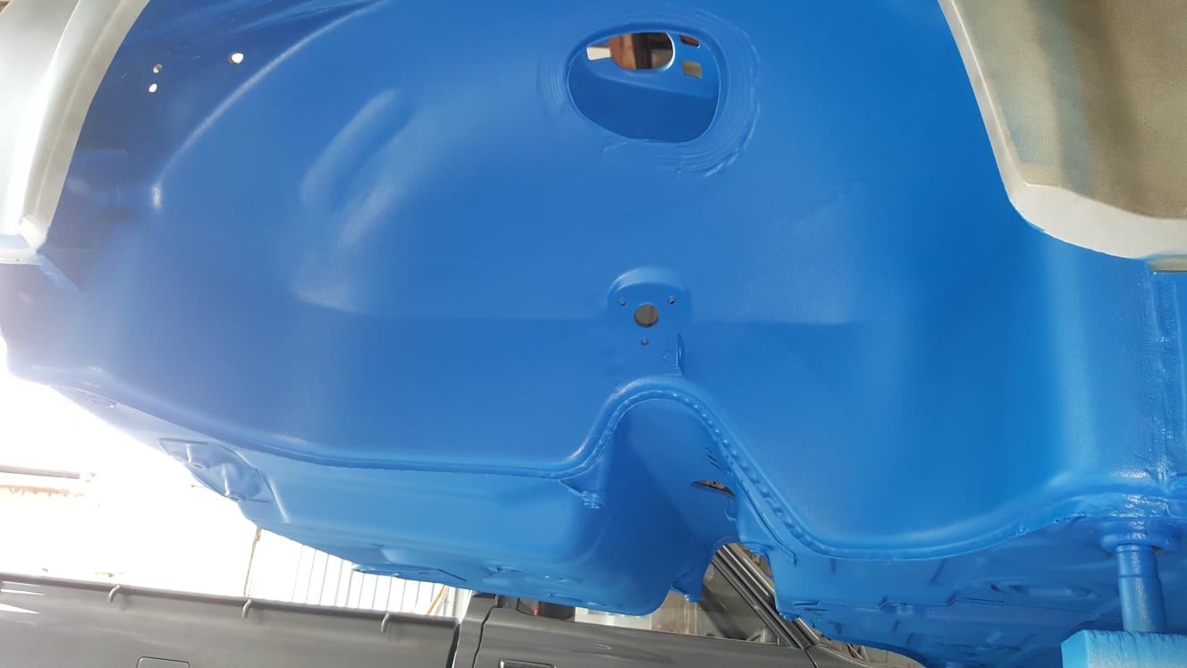

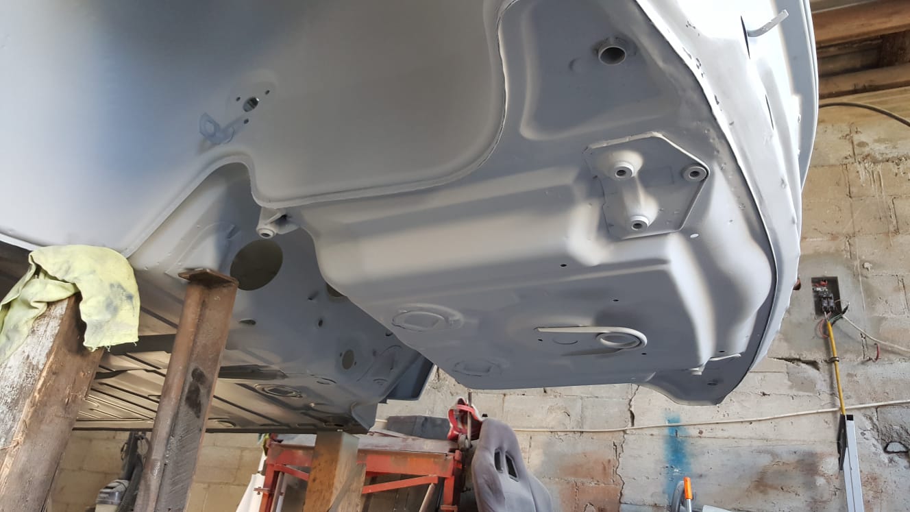

I turned my attention to the wheel wells to make them nice and pretty before I spray on the Raptor Liner. I already ordered the tintable 4 liter kit and it should show up early next week.
And some full shots to see it in its current state.

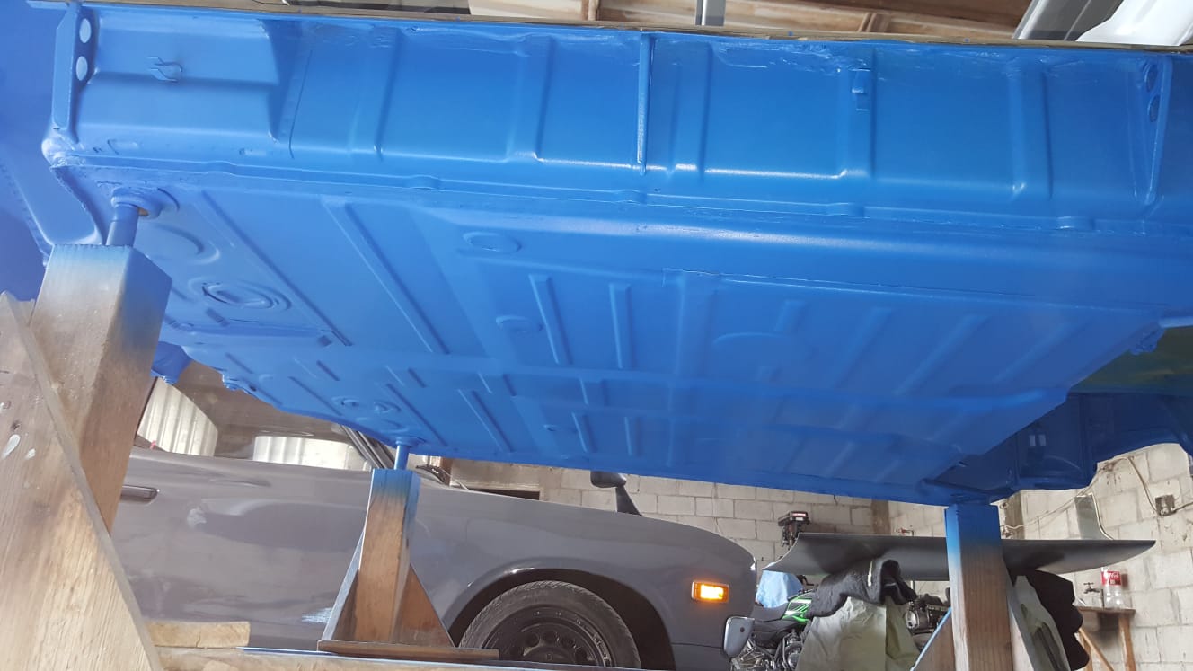

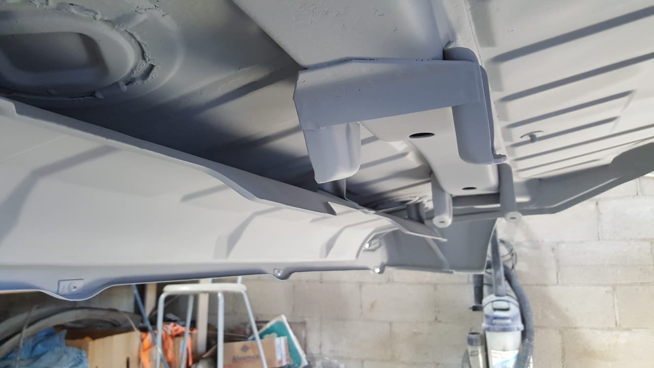

Underside of the car is now finished, just waiting for the Raptor liner to show up and start spraying some color (IMG:style_emoticons/default/beer3.gif)

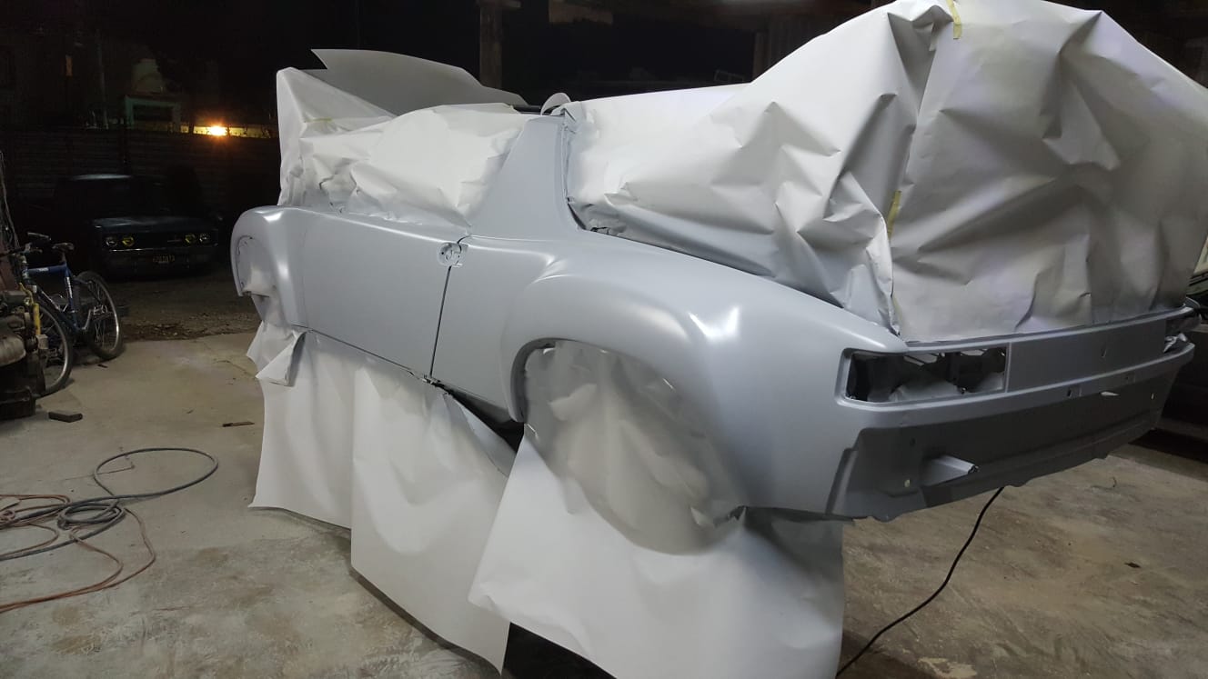

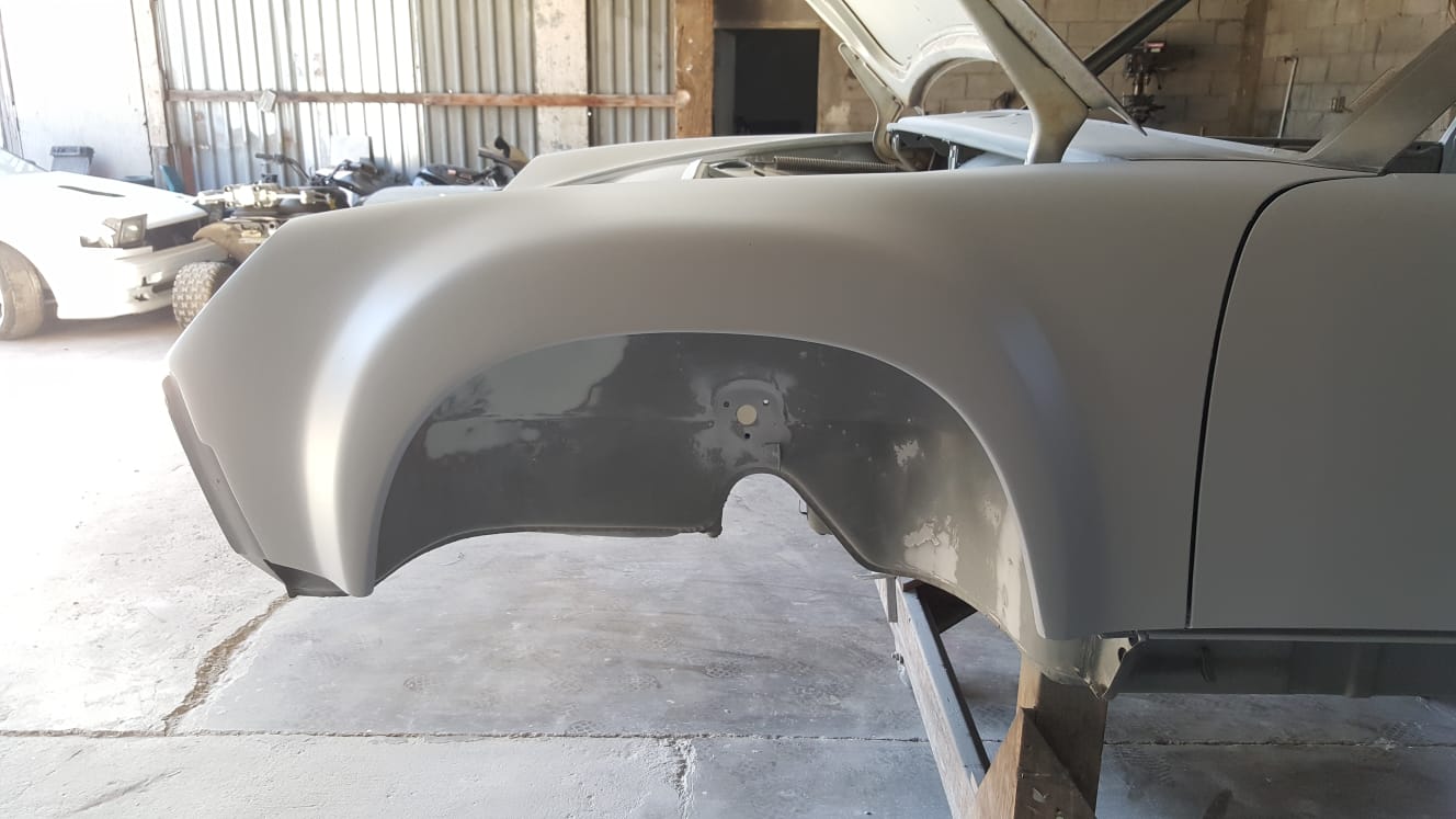

Not too much to show this week but I did get a few things done. I blocked the hood and sprayed some more primer on it. I think after this second round of blocking it should be really good. Also got a little bit of work done on the firewall, for some reason it had some small dents that were bothering me so I decided to fix them also.

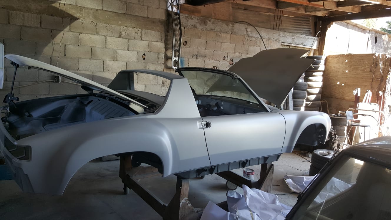

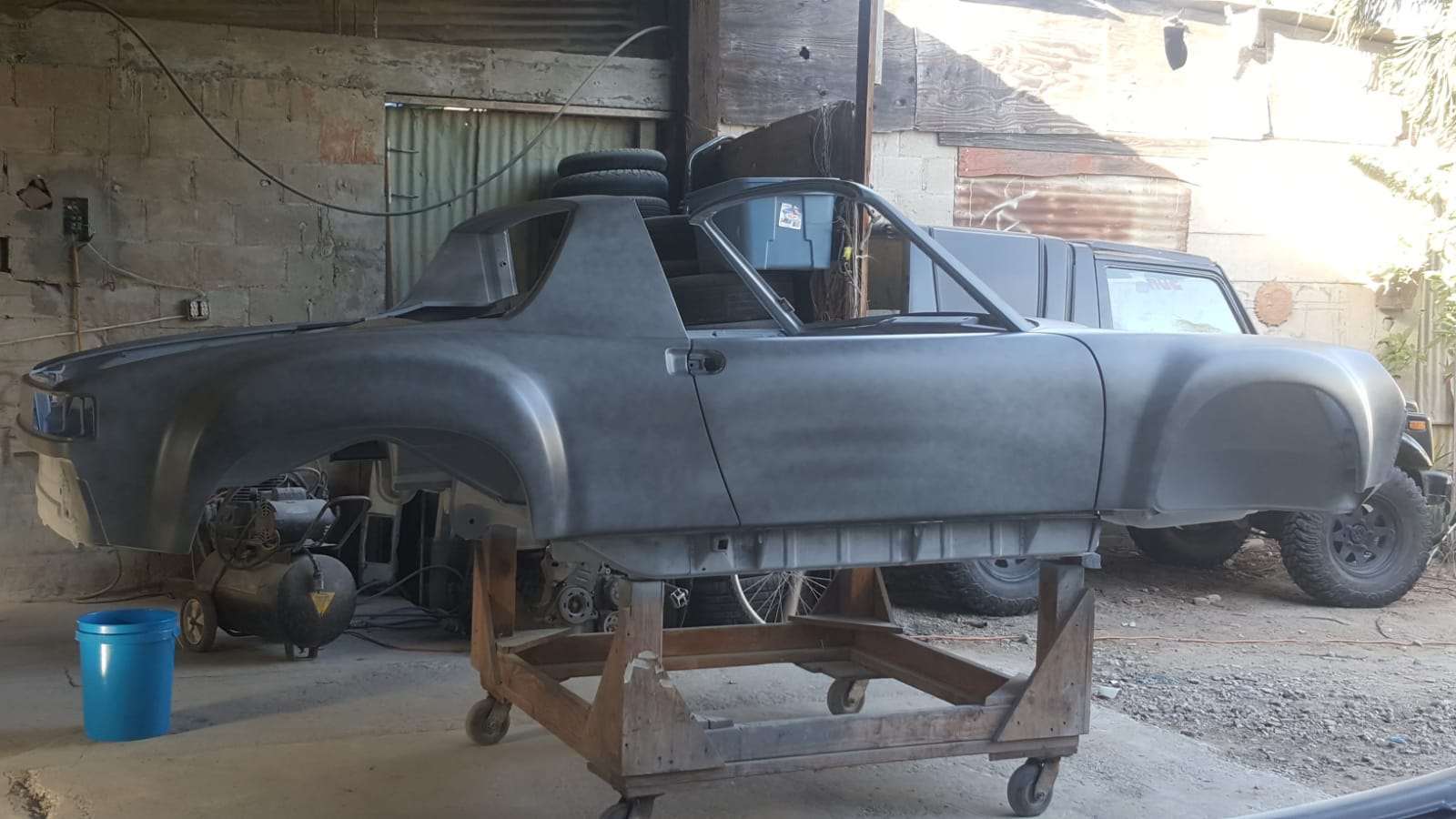

So before spraying the Raptor I wanted to finish priming the body. I finished blocking everything after the second round of primer and I only found a few spots that needed attention. Here is the 3rd primer round and the guide coat applied. From here I will be blocking with 220 and then 400 and 600 wet and it should be ready for paint.

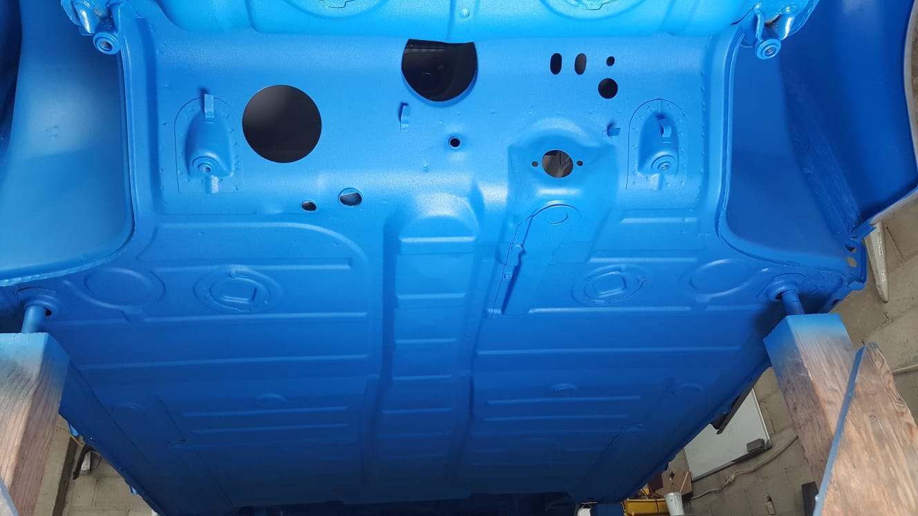

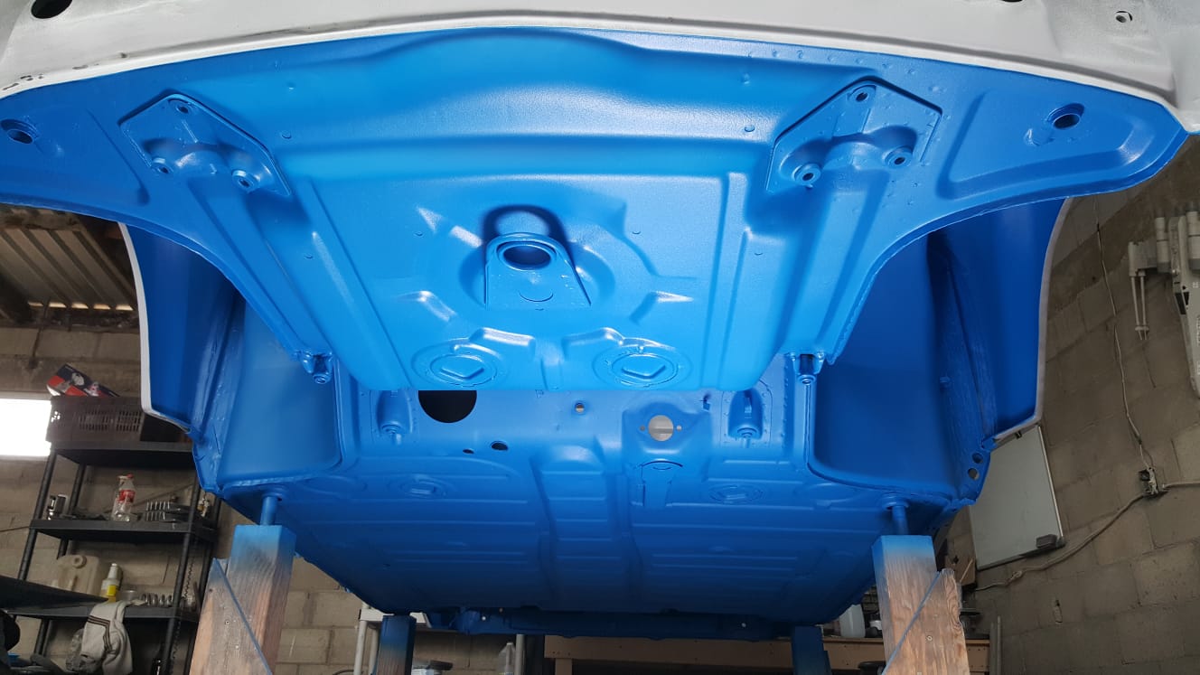

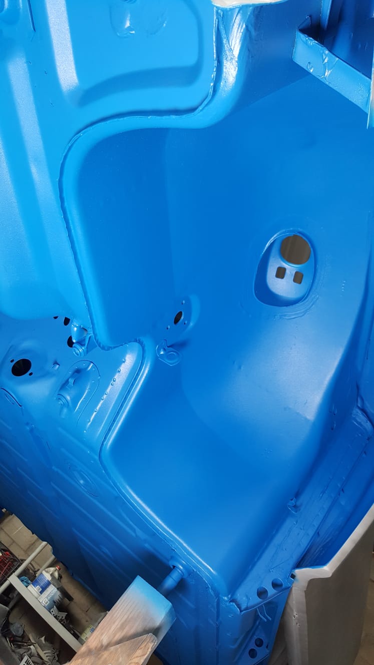

Finally we have some color and most of the hard work has been finished. This week was getting the underside done, I went to the paint store and they were able to match the Raptor to the color I will be spraying on the car. Since I wanted a smoother texture, I modified a spray gun from Harbor Freight by drilling the tip out to 2.0 I also reduced the raptor liner by about 5% and that seemed to give me the texture I was looking for. I was very surprised at how well it covered and how easy it was to spray. I bought the 4 quart kit and I still had a bit left over once I was done. I did the floor, lower engine bay and the wheel wells.

Hey Pedro. That came out great, I was wondering about these bed liners as a undercoating. Price is right and being able to tint it is awesome. Nice job.

Hey thanks Shivers, in my eyes it's very economical. The kit cost me $113.00 on Amazon and it came with a free gun even though I didn't use it. Paint for tinting it was $35.00, so $150.00 to do the whole underside of the car is pretty decent.
