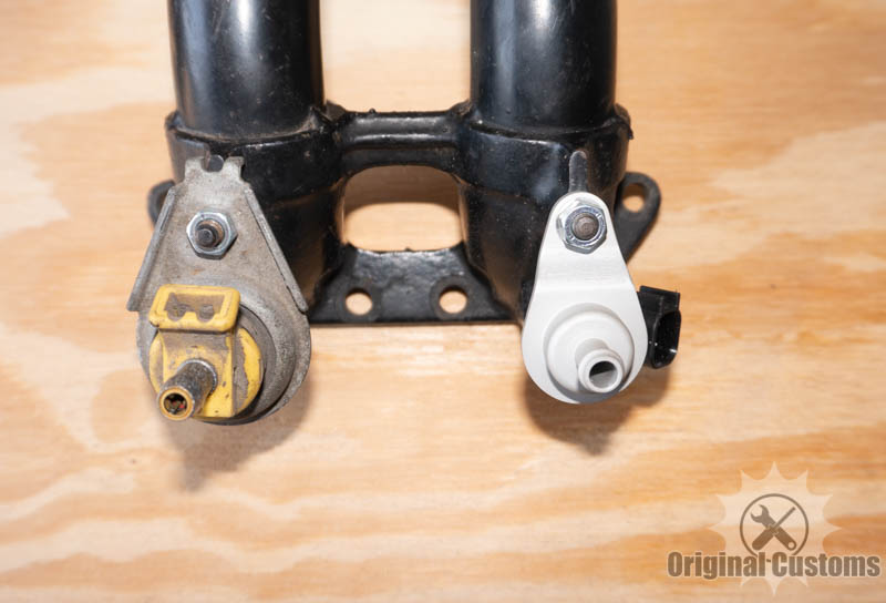

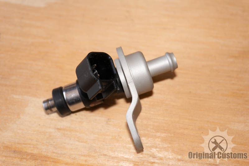

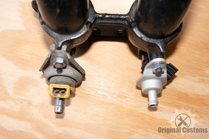

I've been working on upgrading the components of my custom fuel injection setup. One of the upgrades I've had in the works for awhile was adapting the newest Bosch injectors. These have an improved spray pattern, are high-impedance, and are available in a variety of spray volumes. And they're TINY!

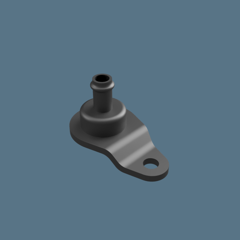

But like any of this stuff, you can't just bolt them on. I decided to make some fancy adapters that would look mostly original. This was one of my first projects to help teach myself Fusion360 CAD modeling.
Got a couple 3D prints from some of our members, which illustrated a few issues with my design. A few changes were made and I pulled the trigger on an initial run of 20 pieces (5 engines).
Just received these parts back from anodizing and did a final test fit. Everything looks perfect. So it's time to install this and my upgraded AAR on my 1.7 Turbo and see how these new additions help things.

Nice to have an option. I see this new bracket is not indexed to the tine on the manifold. What keeps the injector bracket from rotating around its bolt and moving from side to side?

Is there any reasonable way to have the electrical connector point the same way as the stock injectors?

Nicely done, for your future runs, please add some big fillets between the "sheet metal" part and the cylindrical part, also at the nipple to larger diameter corner, since these are direct metal moulded parts

Very nice. My only concern is have you added another potential leak point in the system where the injector mates with the bracket?

QUOTE(Jeff Bowlsby @ Apr 15 2018, 05:33 PM) *
Nothing, I suppose. I'm not sure why they would be moving around. These will use the stock fuel rails as well, so that should provide some additional rigidity to guard against that concern. If I do another run I'll look into adding these tabs. I didn't add them initially because I was concerned about machining costs.
QUOTE(Dave_Darling @ Apr 15 2018, 11:37 PM) *
Nope. (IMG:style_emoticons/default/sad.gif) It does rotate freely, so you can put them left/right/down or anywhere in between.
QUOTE(barefoot @ Apr 16 2018, 07:07 AM) *
I'd love to hear more about what you mean. These are CNC machined from aluminum, but you said "direct metal moulded parts" so I thought maybe you meant DLMS/3D-metal-printing. I understand that adding fillets would add strength, but it doesn't seem relevant to this part (no strength necessary). If you're seeing something I'm not, let me know.
It looks like if the bracket rotates, the injector could come loose so its seals could become loose. The bracket will rotate if its nut becomes loose or otherwise fails to prevent rotation. The OEM fuel rails when installed will not prevent this rotation.
Install an injector as in your photo and loosen the nut. Does the injector tilt when the bracket rotates? If so, the gaskets may not seal against the pressurized fuel.
Believe me, your idea is interesting...if it works. The harness connections actually align better when they lay off to the side like yours do. What are those - Delphi or Weatherpak connectors that would be needed? They could be mounted to an existing harness, not sure about an adapter to a D-Jet/L-Jet harness - seems not to be the best solution.
On the injectors, what are their flow ratings and how well do they substitute for stock injectors?

QUOTE(Jeff Bowlsby @ Apr 16 2018, 12:25 PM) *
I know what you mean about tilt. I thought about that and I'll be doing some 'forceful' testing of their resistance to leaking. That's paramount. But again, this is how most injectors are installed these days -- and the upper o-ring system is a tight fit. Lots of compression to ensure a tight fit. And Bosch provides machining specifications which were all used in the making of this part. So this isn't a part I completely made up -- it's built to the factory design specs for these injectors.
It's a Delphi connector and if everything works out I plan on offering uncrimped connectors for converting a harness or an adapter plug that will retain the original connectors. Obviously an adapter is less preferable, because of the corrosion issue.
The smallest available from DeatschWerks is 42lb/hr @ 3bar/43psi. Converting those to 2bar/28psi results in 34lb/hr, which is pretty close to stock 2.0 injectors. BUT I'm pulling that stock flow rate from your Injector Substitution thread which doesn't specify the fuel pressure those flow rates are measured at. So if the listings in your thread are already at 3bar, then that changes things. There are other sizes available, including 31 lb/hr @ 3bar. So sizes shouldn't be a problem.

I think I need to order some 90-degree elbows...

The chart indicates a 300 kPA test pressure for all listed injectors and that = 43 psi, info which came from the reference literature I created the chart from. Based on that the 1.7, 1.8 and 2.0 injectors flow at 18, 26 and 37 lb/hr.
The fuel rails I have seen are stable, brace the injectors to each other and do not allow injector tilt.

QUOTE(McMark @ Apr 16 2018, 11:04 AM) *
Or perhaps extend the fitting a bit and have it make a ~75 degree bend?
Even though the fuel connection is with a rubber hose, there will be vibration induced to the hose attachment nipple. With a sharp corner where the nipple ends, thats a stress riser with may result in fatigue failure and a big pressurized fuel leak. We always use a large a fillet as possible in aircraft fuel system parts.
I thought you were using direct metal moulding, but CNC machined parts can easily incorporate fillets.

QUOTE(Dave_Darling @ Apr 16 2018, 02:23 PM) *
--DD
The problem there is that the 1.7 an 2.0 runners have the fittings at different angles. So any angle I build in will make two versions necessary. (IMG:style_emoticons/default/pinch.gif)
This was what I settled on as the best solution to that issue.

QUOTE(barefoot @ Apr 16 2018, 03:55 PM) *
(IMG:style_emoticons/default/thumb3d.gif) I can see where that would be helpful on the nipple.
