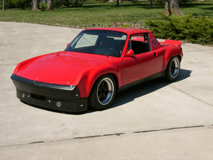

carr914
post Jun 7 2005, 03:25 PM
Racer from Birth
Posts: 135,199
Joined: 2-February 04
From: Tampa,FL
Member No.: 1,623
I run 15x8 (no spacers) on the front and either 16x8 or 15x9 in the rear. I need tn to shave the rear flares for the 9s. I have a set of 16x7 that will soon go on evilBay if your interested.
T.C.
Picture is with the 8 & 9s

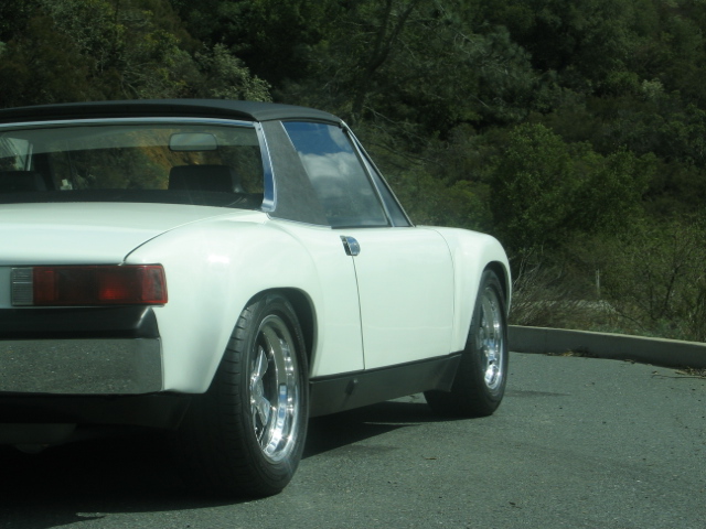

elmonte
post Mar 23 2009, 11:28 PM
Posts: 225
Joined: 31-March 03
From: Danville.ca
Member No.: 499
This question is always a good excuse to post a picture. Here's 15x8 w225's on all four corners with 1/4 inch spacers

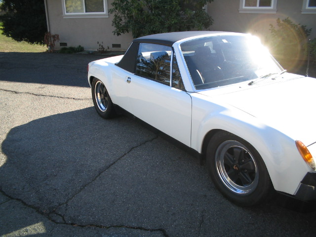

elmonte
post Mar 23 2009, 11:44 PM
Posts: 225
Joined: 31-March 03
From: Danville.ca
Member No.: 499
Here it is with 7x16 w225's. rears are 911 offset and fronts are 951 offset with the same 1/4 inch spacers
Racer
post Mar 24 2009, 07:06 PM
Posts: 787
Joined: 25-August 03
From: Northern Virginia
Member No.: 1,073
QUOTE(elmonte @ Mar 23 2009, 09:44 PM) *
951 7's and 911 7's have the same 23.3mm offset. 951's have "sunken" lug bolt holes, as it were and the smaller lip.. making them look like 911 6"s

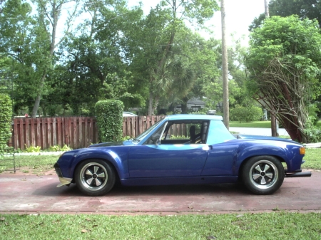

jfort
post Mar 25 2009, 07:00 PM
Posts: 1,195
Joined: 5-May 03
From: Findlay, OH
Member No.: 652
I have 7x16 on front with 225/50 and spacers off a 944 and 8x16 with 245/50 on the rear. I didn't have the front spacers yet when the avitar pic was taken. filled out nicely.
