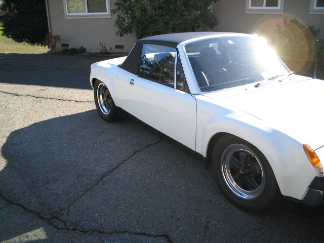

This question is always a good excuse to post a picture. Here's 15x8 w225's on all four corners with 1/4 inch spacers

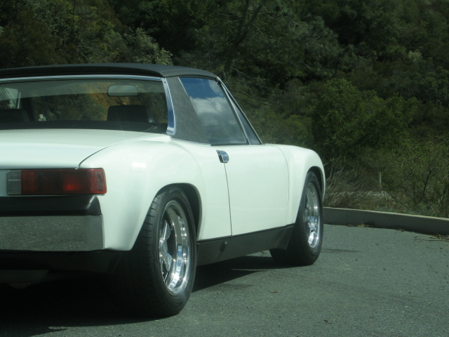

Mar 23 2009, 11:44 PM
Here it is with 7x16 w225's. rears are 911 offset and fronts are 951 offset with the same 1/4 inch spacers
