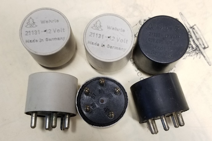

Also my 72 has white relays in it, They have the correct part numbers and manufacturer but I have never seen white ones.
I know some 911s use a red relay for teh fuel pump and it carries more amperage that the black relays.
Is there anything different about the white relays?
Higher/low amperage?
