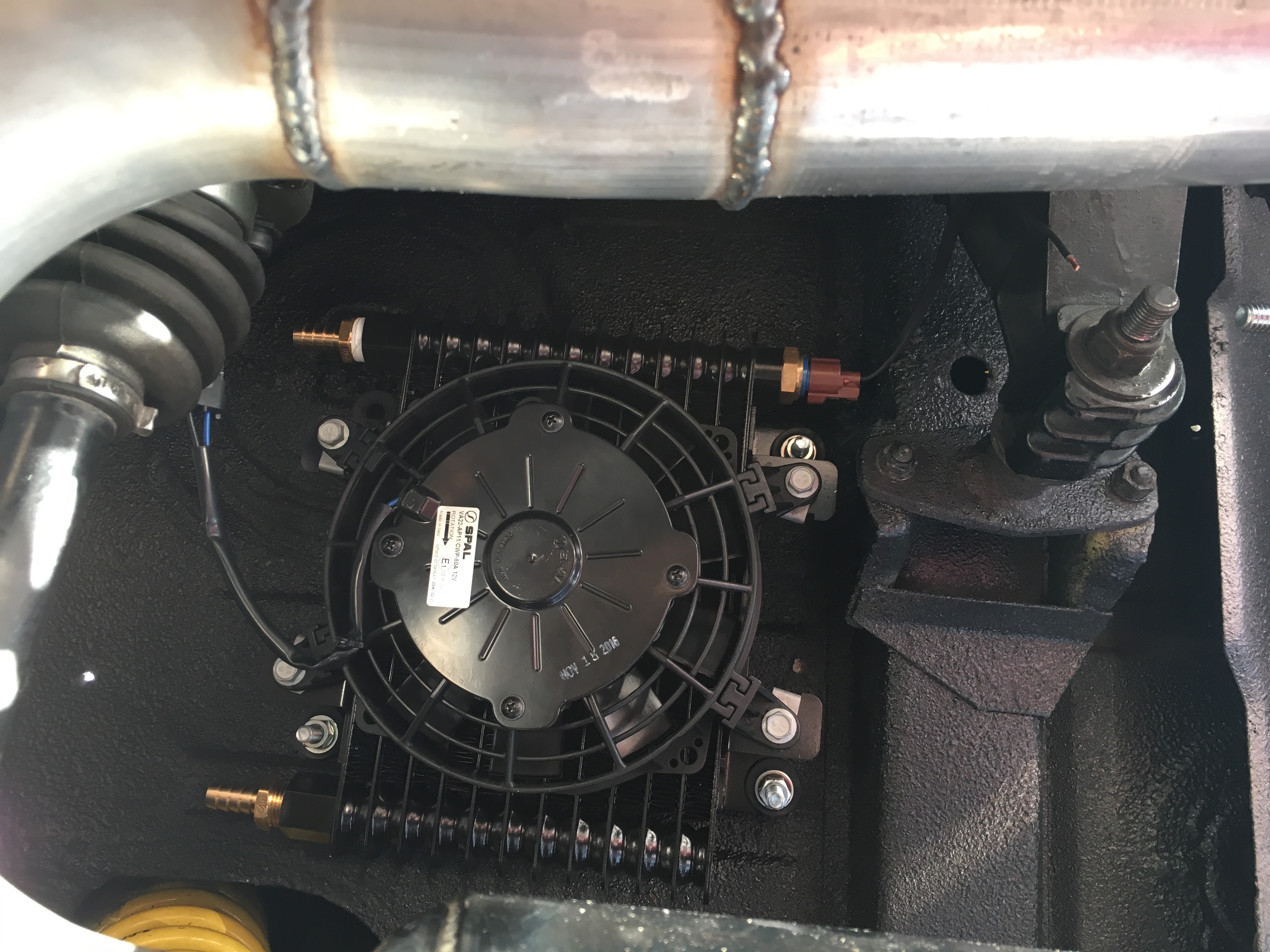

Summit racing and Amazon both carry this B&M kit that has the fan and thermostat built in. Fits nice in the rear next to the trans and lowered my temps significantly. I think it’s like $275 or so.

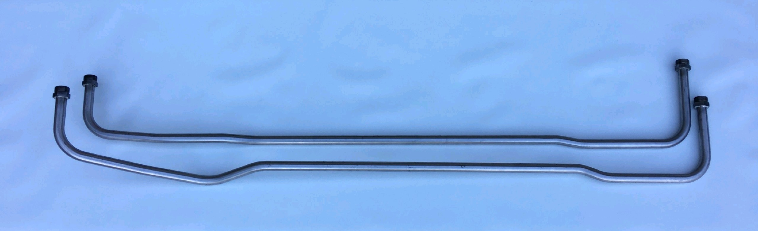

If you do decide on a cooler, Ben (mb911) has now reproduced beautiful 914GT oil lines to run to the front of the car to install a ducted front cooler.

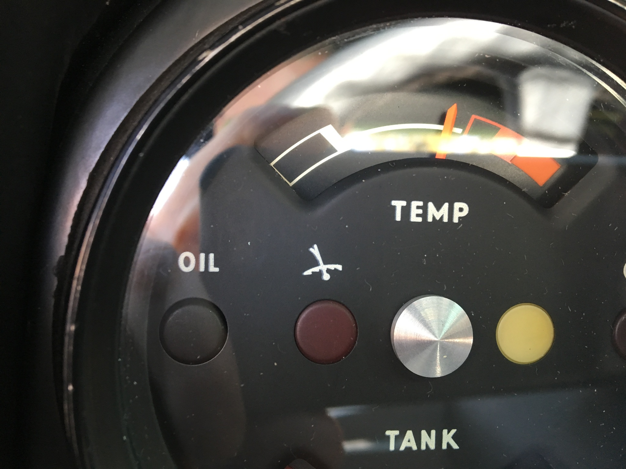

cal914
post May 8 2018, 09:52 AM
Posts: 319
Joined: 12-April 12
From: United Kingdom
Member No.: 14,366

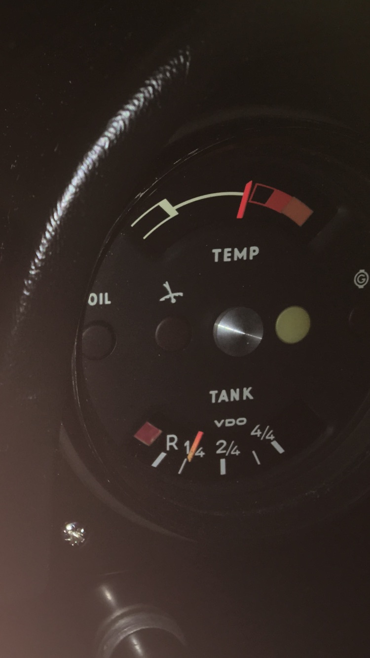

This is where the temp gauge was yesterday with out side temp at 28 degrees (82 F),the motor has less than 1500 miles on a complete rebuild ,at the time of the pic being taken I had been sitting in traffic for about 10 mins ,before that the gauge was steady at about 5mm from the red
Is the temp to high for this engine
914forme
post May 8 2018, 09:57 AM
Posts: 3,896
Joined: 24-July 04
From: Dayton, Ohio
Member No.: 2,388

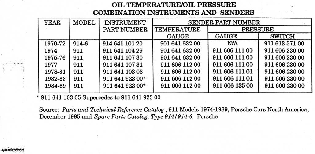

Another item to consider is oil temp sender and gauge mis match, that will cause them to read differently.
I have a chart somewhere that shows the matched versions. (IMG:style_emoticons/default/confused24.gif)
Found it (IMG:style_emoticons/default/piratenanner.gif)

QUOTE(914forme @ May 8 2018, 11:57 AM) *
(IMG:style_emoticons/default/agree.gif) Now we're talking.

cal914
post May 8 2018, 01:19 PM
Posts: 319
Joined: 12-April 12
Member No.: 14,366
QUOTE(914forme @ May 8 2018, 07:57 AM) *
The part number on my gauge is 914-641-101-10 that number doesn’t appear on the chart above ,the temperature sender is from my friends 6 are these 2 things compatiable or could this be the problem
mskala
post May 8 2018, 01:58 PM
R
Posts: 1,935
Joined: 2-January 03
From: Massachusetts
Member No.: 79
Part number is close, should be equivalent, but this is what I have.
You can pull the sensor and check its part number, and/or just order the correct new one.

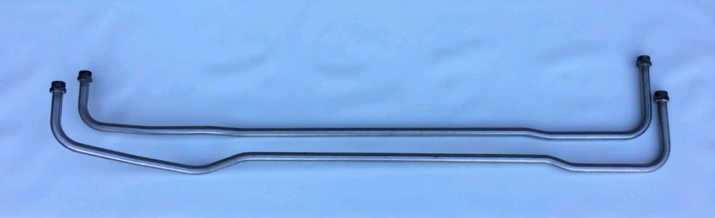

mb911
post May 8 2018, 05:55 PM
Posts: 7,592
Joined: 2-January 09
From: Burlington wi
Member No.: 9,892

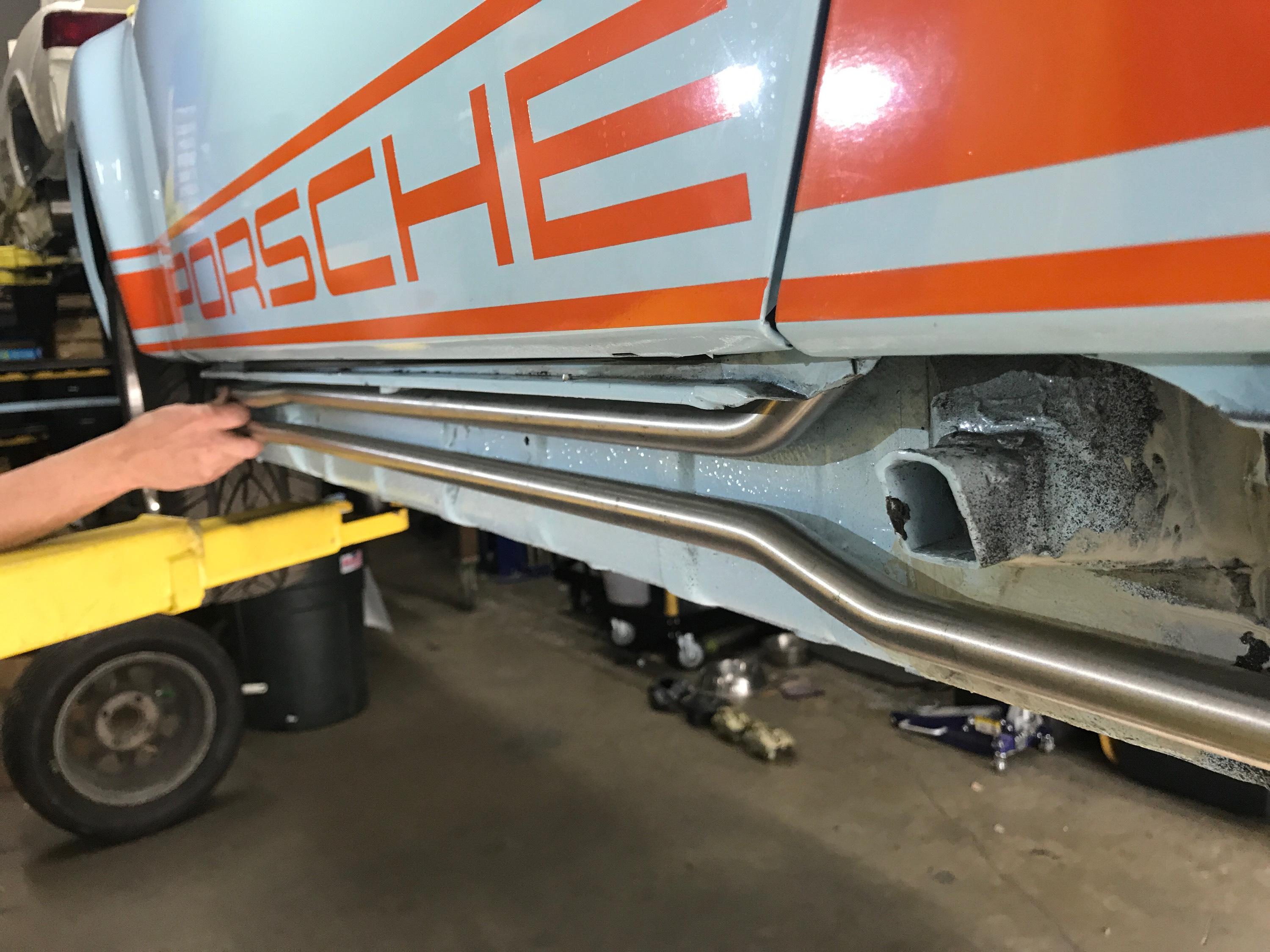

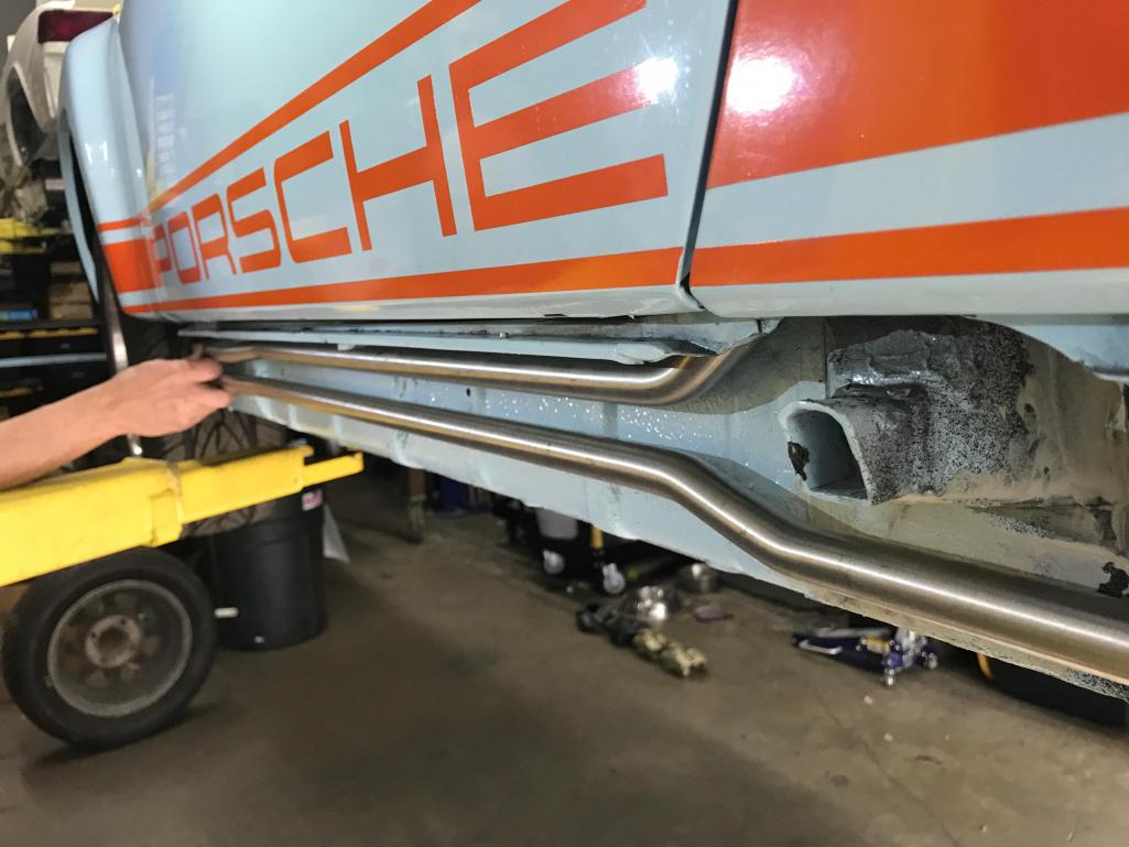

I will run it on my 2.4 s spec.. Thats why I had these made..(50 sets)Attached Image Attached Image
GeorgeRud
post May 8 2018, 06:00 PM
Posts: 3,725
Joined: 27-July 05
From: Chicagoland
Member No.: 4,482
Those surely look beautiful! Another thought is to check the sender in boiling water to see where it reads on the gaug.
