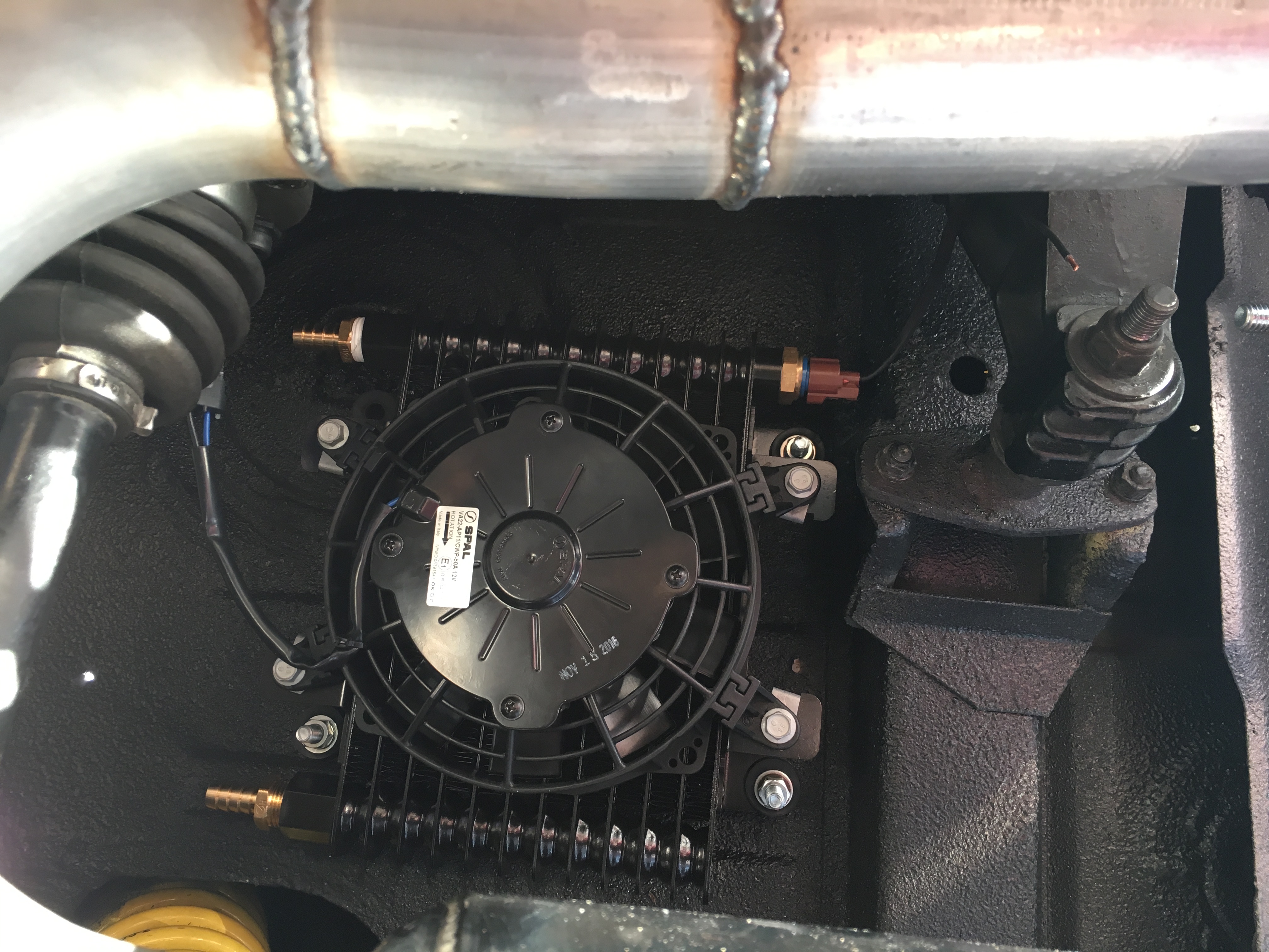

A couple guys have sucessfull fitted one at the trans under the car.
JmuRiz
May 8 2018, 07:22 AM
I plan on fitting one in the transmission area...with thermostatic fans.
I'll mount it and run aeroquip lines, see how it works and either go with higher quality lines (if it cools well) or go full front mount (if it doesn't cool well enough).
My car will be a street car.
Heck Henry at Supertec even mounted one in the engine lid and it worked just fine for the 2.7 it was on. This was on an original 914/6 chassis so the owner didn't want to cut any holes.

Summit racing and Amazon both carry this B&M kit that has the fan and thermostat built in. Fits nice in the rear next to the trans and lowered my temps significantly. I think it’s like $275 or so.

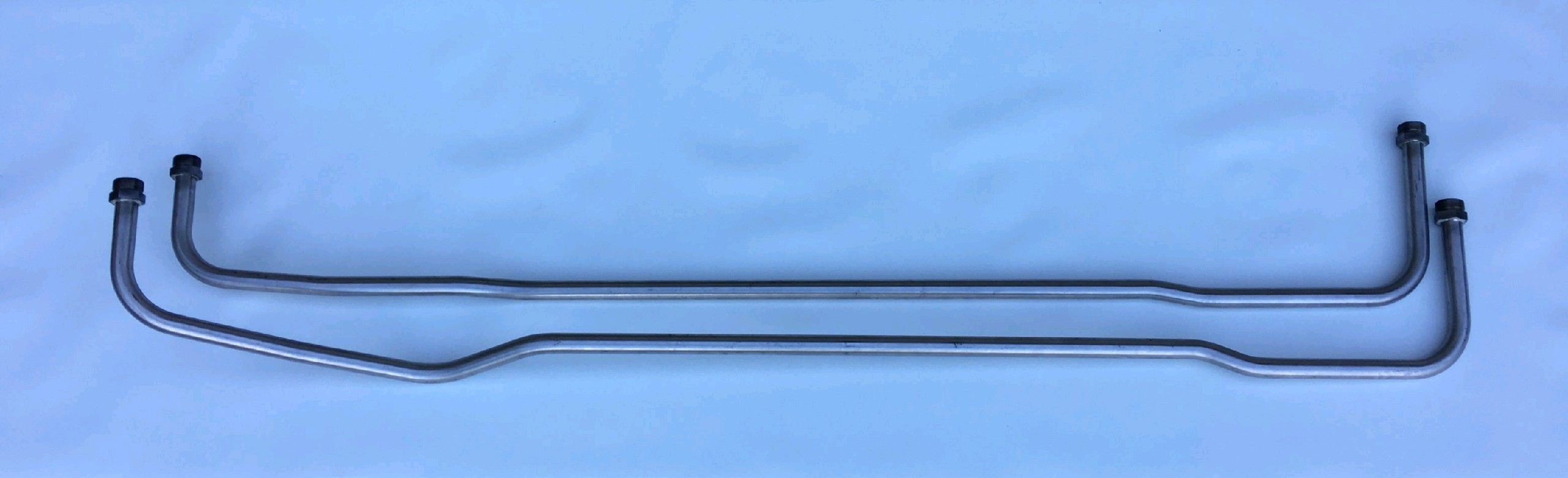

If you do decide on a cooler, Ben (mb911) has now reproduced beautiful 914GT oil lines to run to the front of the car to install a ducted front cooler.

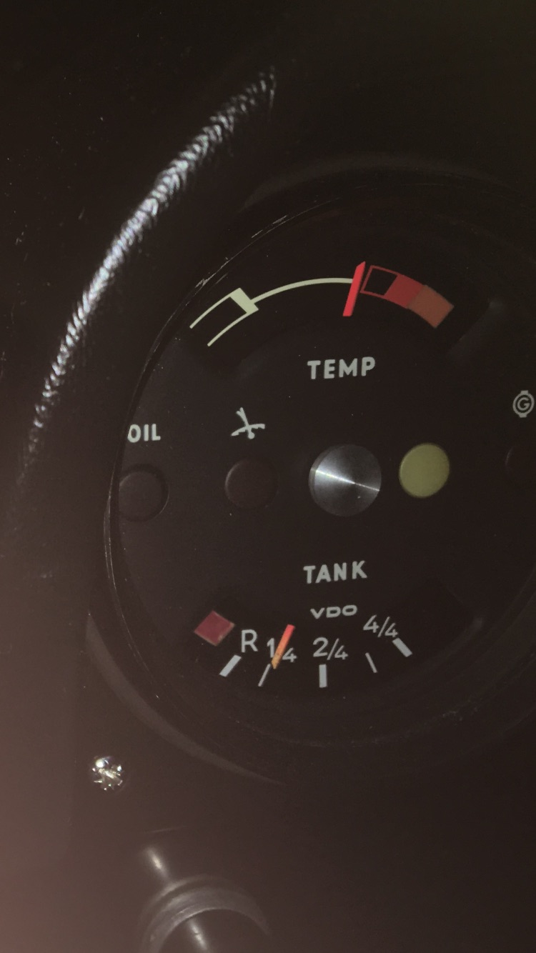

This is where the temp gauge was yesterday with out side temp at 28 degrees (82 F),the motor has less than 1500 miles on a complete rebuild ,at the time of the pic being taken I had been sitting in traffic for about 10 mins ,before that the gauge was steady at about 5mm from the red
Is the temp to high for this engine

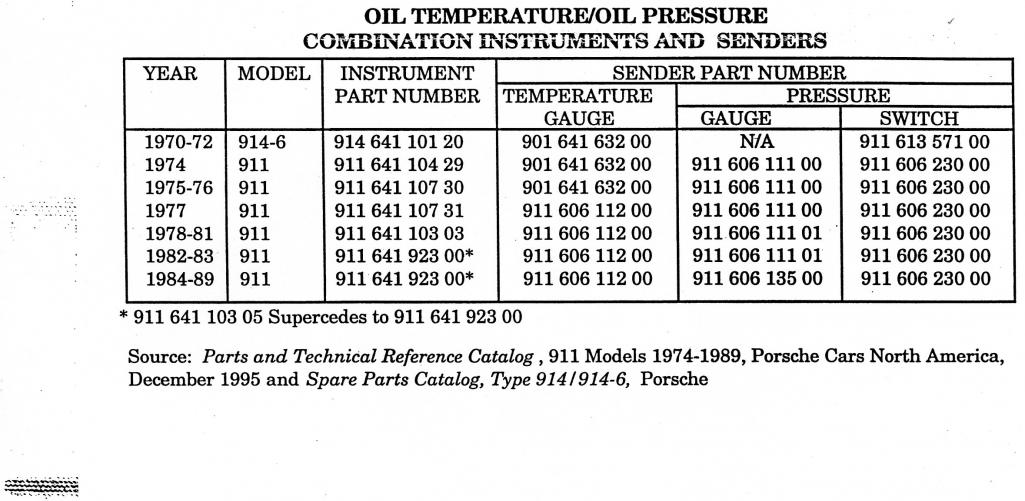

914forme
May 8 2018, 09:57 AM
Another item to consider is oil temp sender and gauge mis match, that will cause them to read differently.
I have a chart somewhere that shows the matched versions.
Found it

cal914
May 8 2018, 01:19 PM
QUOTE(914forme @ May 8 2018, 07:57 AM)
Found it

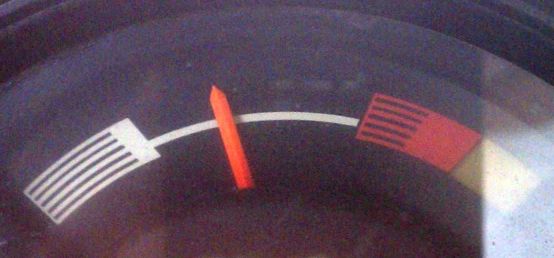

Click to view attachmentThe part number on my gauge is 914-641-101-10 that number doesn’t appear on the chart above ,the temperature sender is from my friends 6 are these 2 things compatiable or could this be the problem
mskala
May 8 2018, 01:58 PM
Part number is close, should be equivalent, but this is what I have.
Click to view attachment You can pull the sensor and check its part number, and/or just order the correct new one.

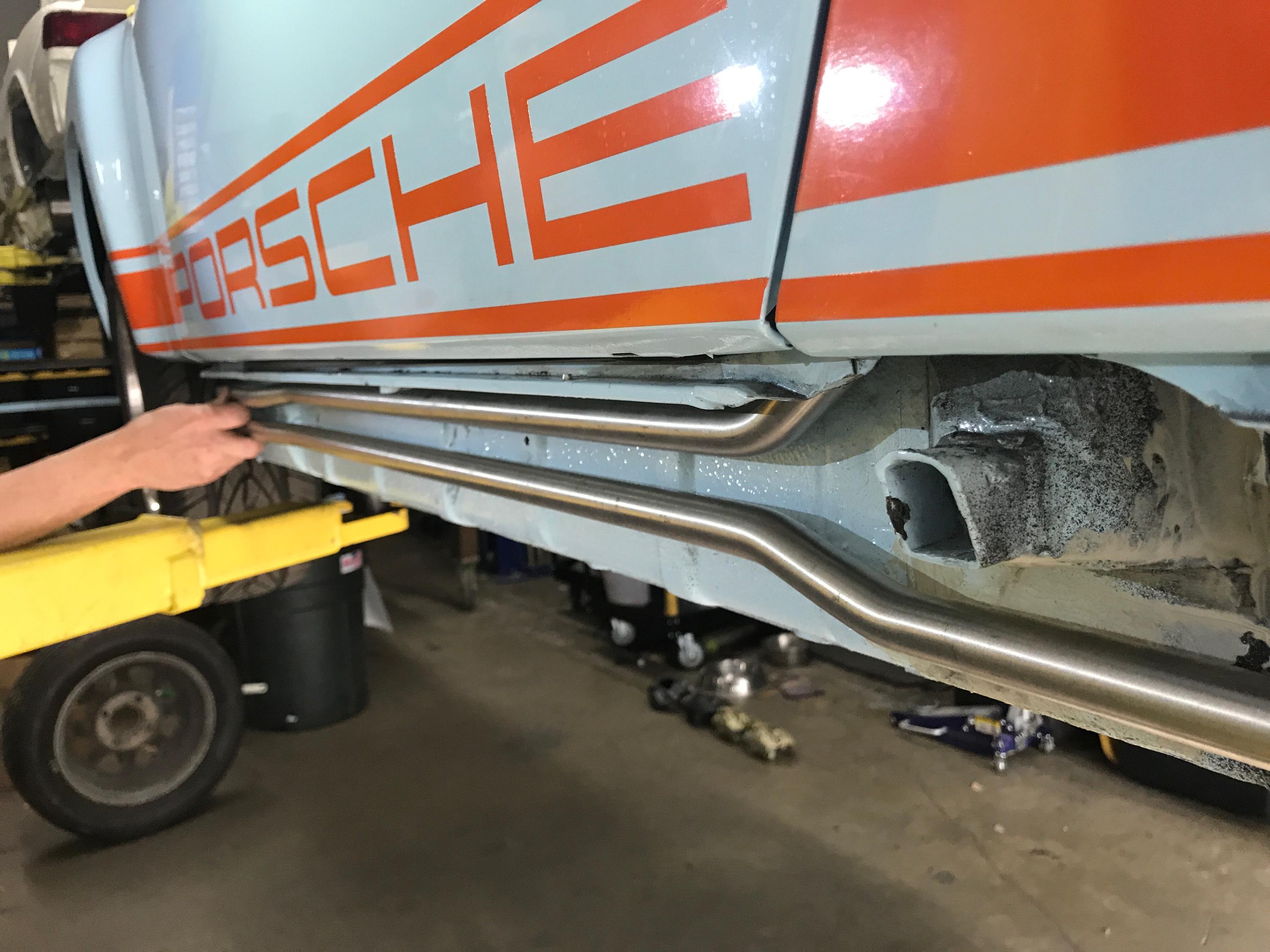

mb911
May 8 2018, 05:55 PM
I will run it on my 2.4 s spec.. Thats why I had these made..(50 sets)
Click to view attachment Click to view attachment
GeorgeRud
May 8 2018, 06:00 PM
Those surely look beautiful! Another thought is to check the sender in boiling water to see where it reads on the gaug.

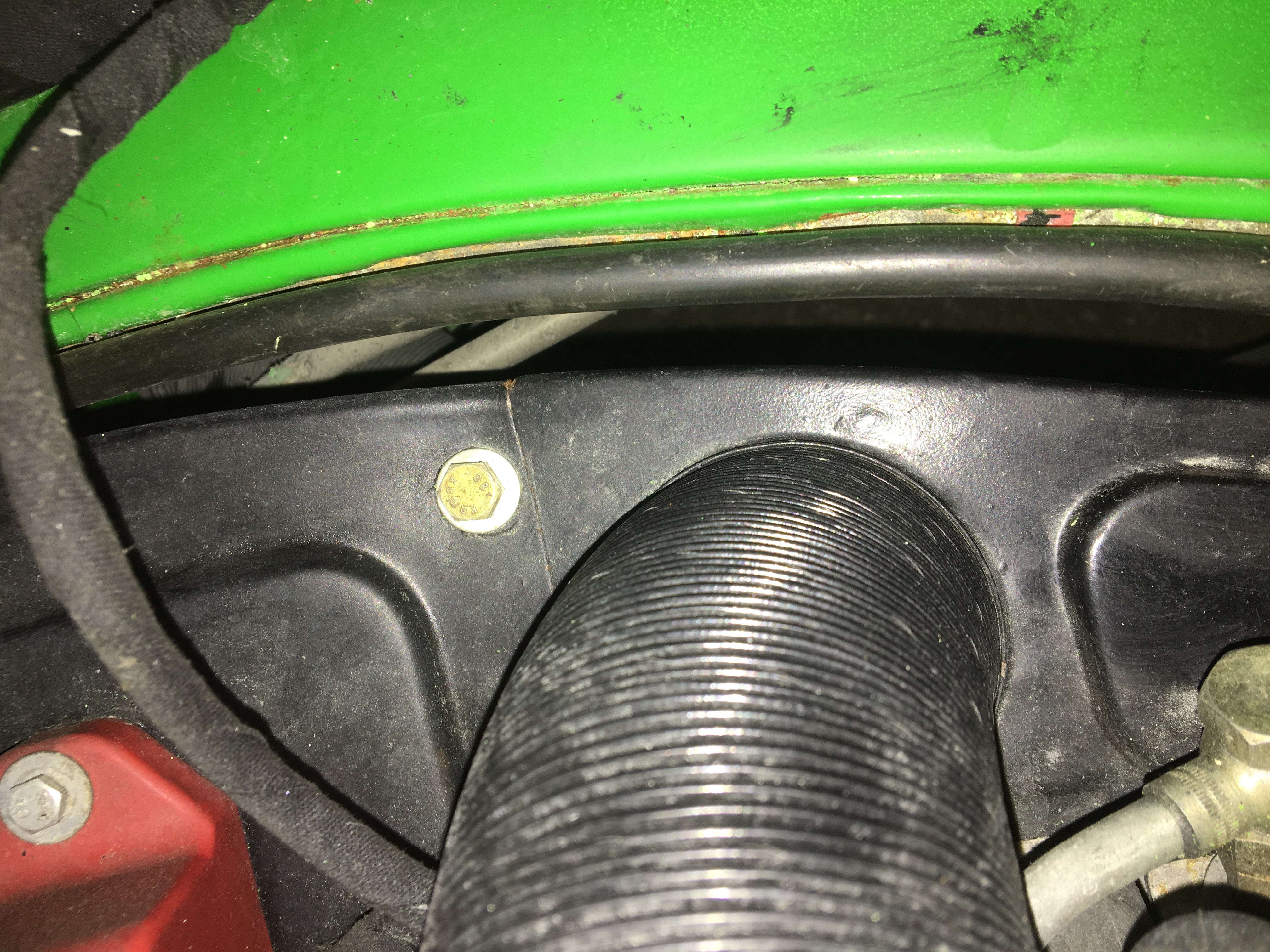

Are the ducts that take air from the cooling fan shroud down to your heat exchangers connected? When I first bought my 914-6 with a 2.3L it was running hot. I re-installed those 2 ducts to the heat exchangers and it helped a lot. Make sure the heater valves are also installed. Those exchangers need air moving through them or they become heat sinks. The driver's side H.E. is right under the oil cooler.
