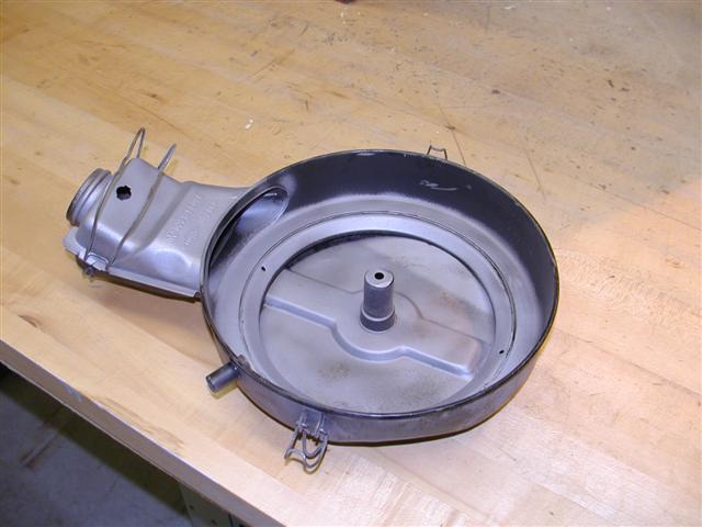

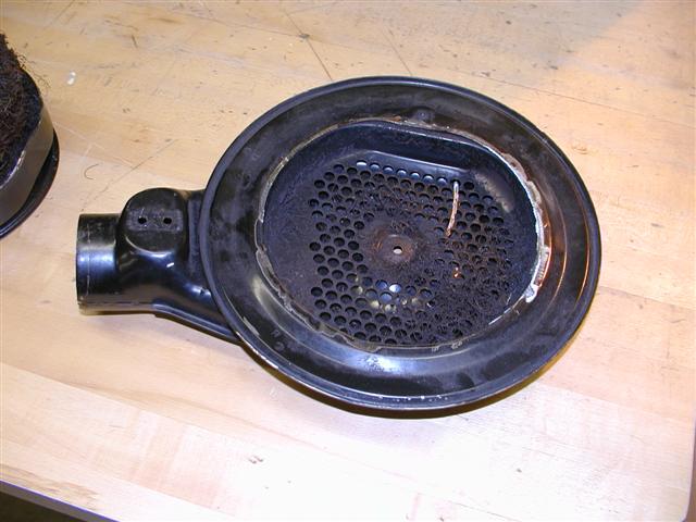

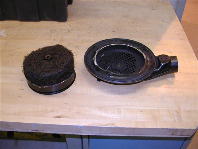

I finally took the old spare air filter I had lying around and adapted it to a paper filter.
I cut out the inner wall of the bottom piece.
I cut off the filter element of the inner piece. (man that was some ugly filter element) (IMG:http://www.914world.com/bbs2/html/emoticons/sawzall-smiley.gif)
I sandblasted the insides.
I welded up the inner seam.
Painted it black.
I then bought a 2" x 8" (CarQuest Part # 88094) round air filter and installed it.
It appears to work great and even sounds a little meaner than the old one.

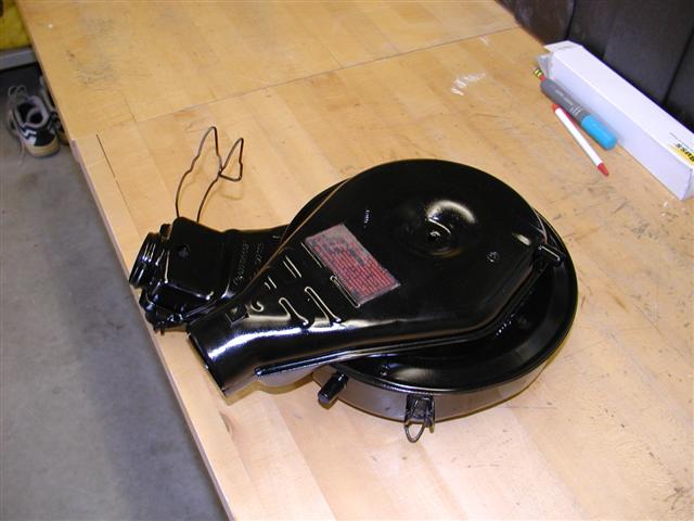

tracks914
post Jun 9 2005, 07:07 PM
Canadian Member
Posts: 2,083
Joined: 15-January 03
From: Timmins, Ontario, Canada
Member No.: 153

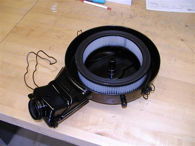

tracks914
Canadian Member
Posts: 2,083
Member No.: 153
Filter installed. (IMG:http://www.914world.com/bbs2/html/emoticons/smilie_pokal.gif)

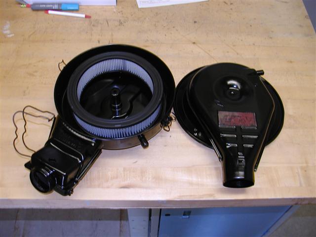

tracks914
post Jun 9 2005, 07:08 PM
Canadian Member
Posts: 2,083
Member No.: 153
New and Improved. (IMG:http://www.914world.com/bbs2/html/emoticons/biggrin.gif)
