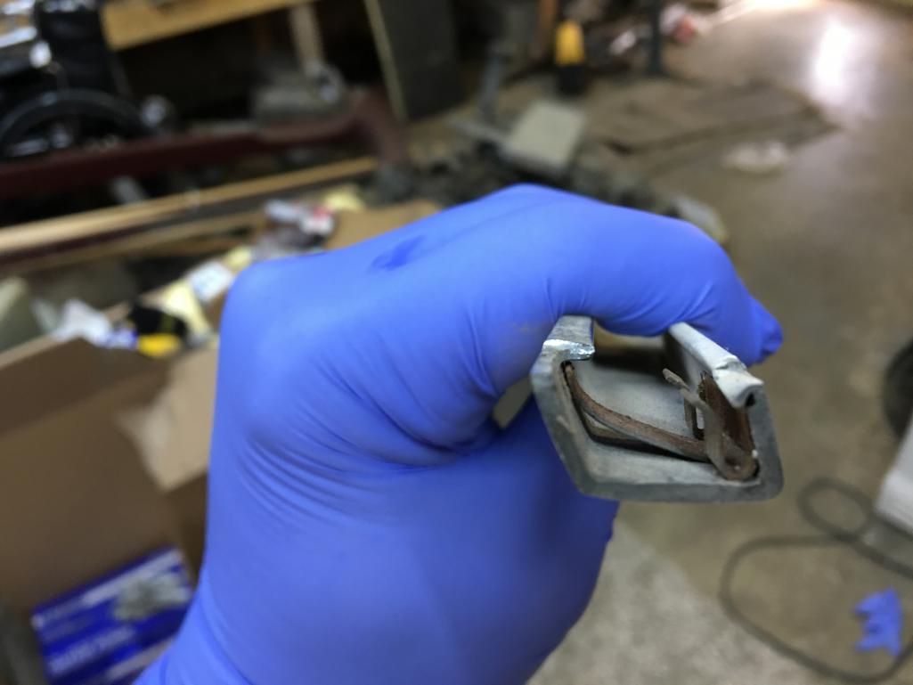

altitude411
post May 21 2018, 06:34 PM
I drove my 6 into a tree
Posts: 1,306
Joined: 21-September 14
From: montana
Member No.: 17,932
clips go like this. I'm not totally sure but I thought there were four clips for the targa trim? (IMG:style_emoticons/default/confused24.gif)
