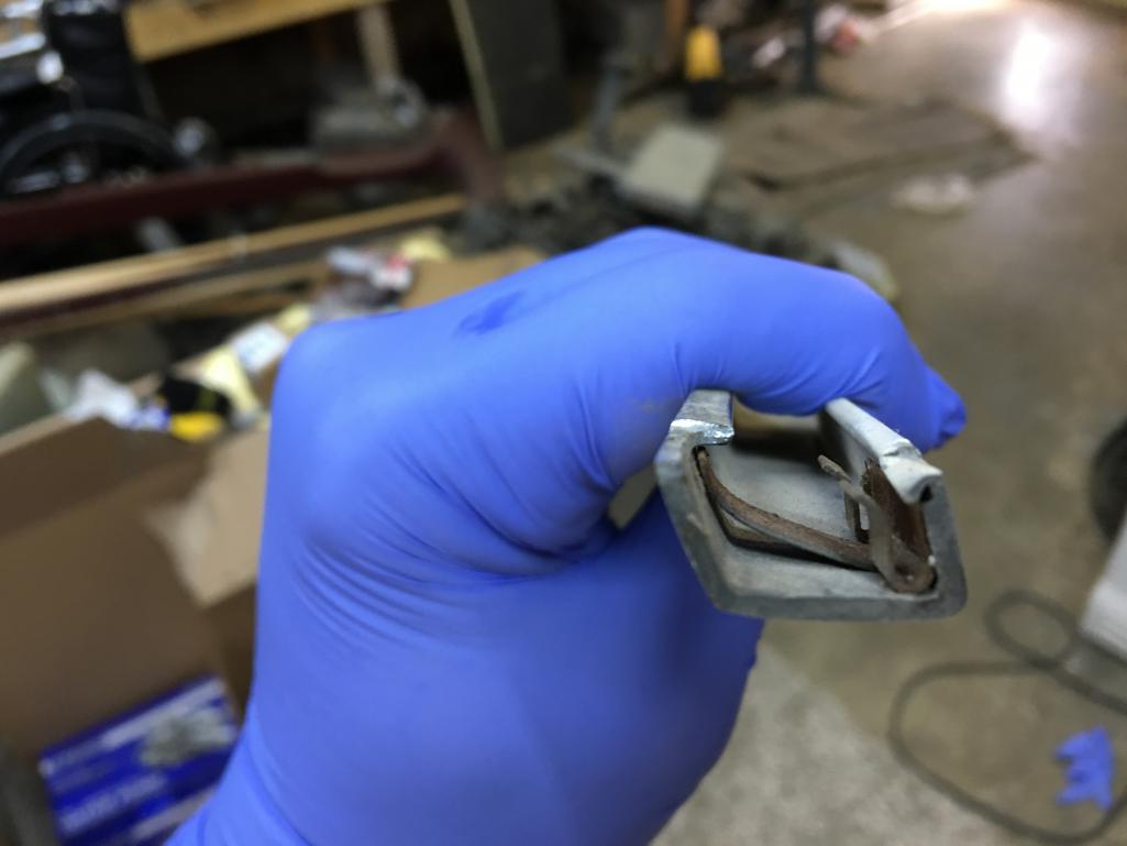

I have 3 clips. I assume that the clip part that hooks onto the flange goes in the bottom of the inner rail of the chrome bar.
Do you put the clips in the chrome trim and slide the chrome trim on the flange?
Do you place the clips on the roof and push on the chrome trim? I have tried and can't get anywhere.
If I try and slide the chrome trim with the clips in the chrome trim piece on the roof the clip breaks. If I put the clips on first and then pop the chrome trim piece on the clips pop off the flange.

Clips go into the targa trim. Then place it into position and push it on. No sliding it along.
altitude411
clips go like this. I'm not totally sure but I thought there were four clips for the targa trim? confused24.gif

Well, I cut the vinyl off the flange, cleaned the glue off the flange, and it clipped on like it is suppose too. Easier once you got all the crap off the flange.
