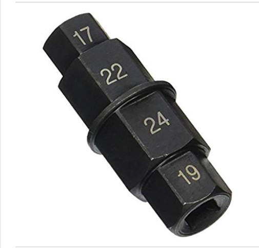

I had this motorcycle axle tool on hand- amazon prime, walmart, bike shop etc

QUOTE(MM1 @ May 28 2018, 02:55 PM) *
Thanks for being a great host!
I like that. Thanks.
