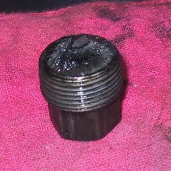

Sure is, get the drain plugs from an early 901 (911/912) transmission, exactly the same except 17mm male end.

Where do I get these? Looked on pelican and couldn't find them.

You'll only find them used.
