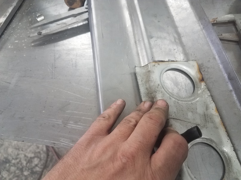

Are those two layers of steel with the grill in between? I can do it, but it won't look as pretty as that.
sixnotfour
post Dec 1 2018, 06:10 PM
Post #263
Posts: 11,275
Joined: 12-September 04
Member No.: 2,744
yes, but does not have to be ...your style... (IMG:style_emoticons/default/smash.gif) (IMG:style_emoticons/default/welder.gif)

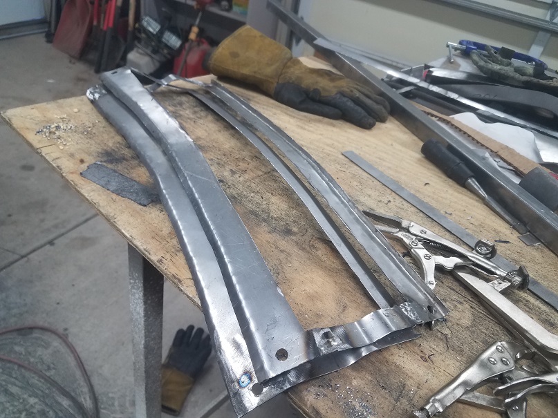

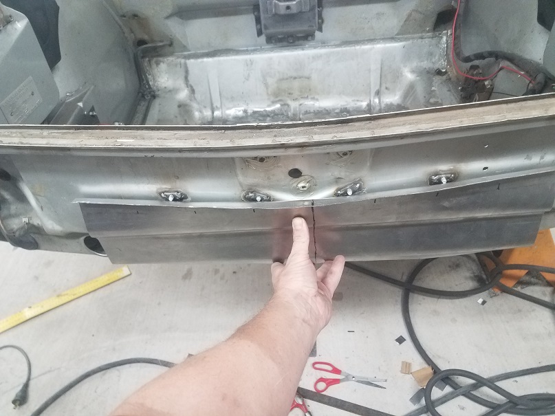

Started with some 20g and will do two layers All the metal is cut up. Since I can't cut a straight line for the life of me I made the strips a little bit wider and it overlaps the oil cooler hole. I will will grind it down once all together. I Had the bottom piece cut but it tuned into a shitshow, will need to make a a template
That's looking good, just how I started mine off. It's a fairly easy project that just takes time. When you consider what they cost to buy it's a rewarding task to complete yourself.

Good luck! One part I found essential was the fold in the metal across the top. Without it the whole thing lacked any rigidity.

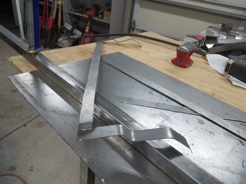

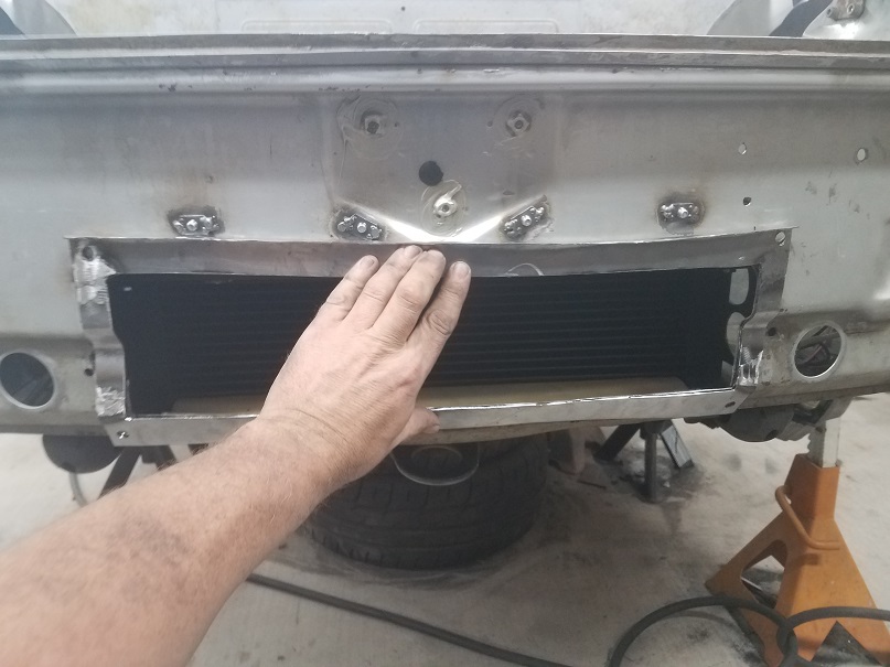

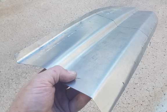

Made some progress, only feel lukewarm about how it turned out. But I might change my mind after some more finishing.

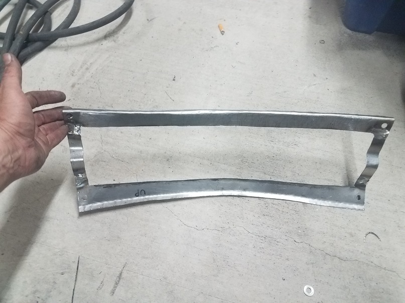

Member No.: 447

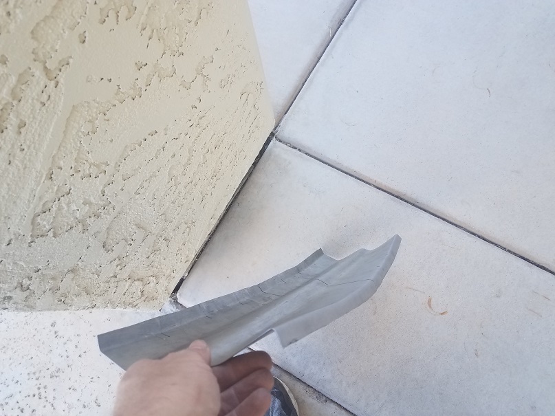

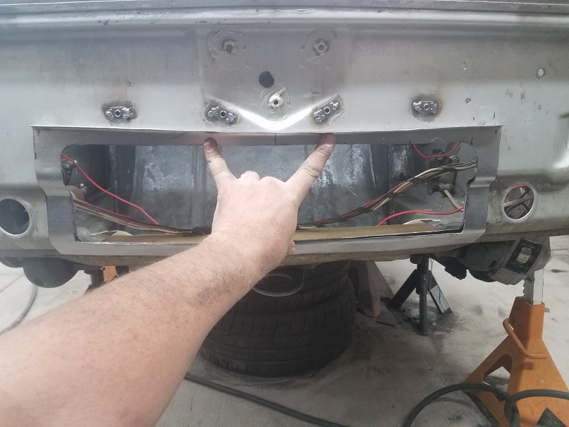

A little lunch time bendy session. One bend is a little off, will fix that when I cut out the center hole. Next up is a stretch and shrink session to match the radius of the front of the tub. I get the shrink and stretch backwards, lets hope I don't screw that up

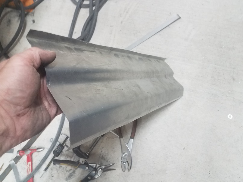

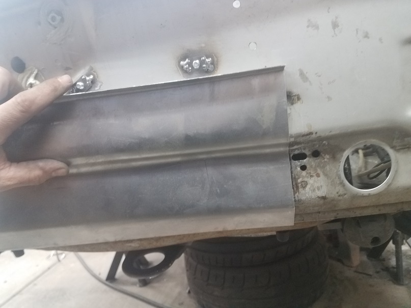

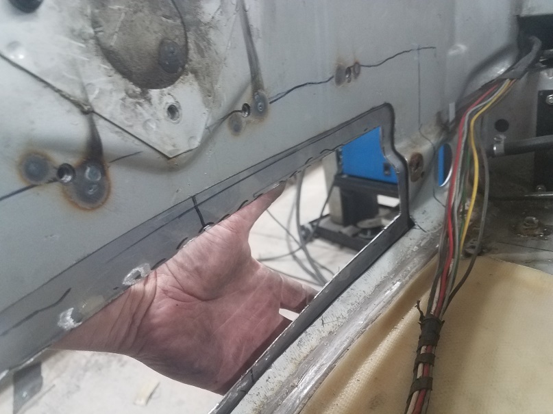

stretch the top and shrink the bottom. It is close. will screw it down to the car and cut out the middle. My only fear here is that I have a bunch of tension built into the curve and once I get the inside free, it may be over bent

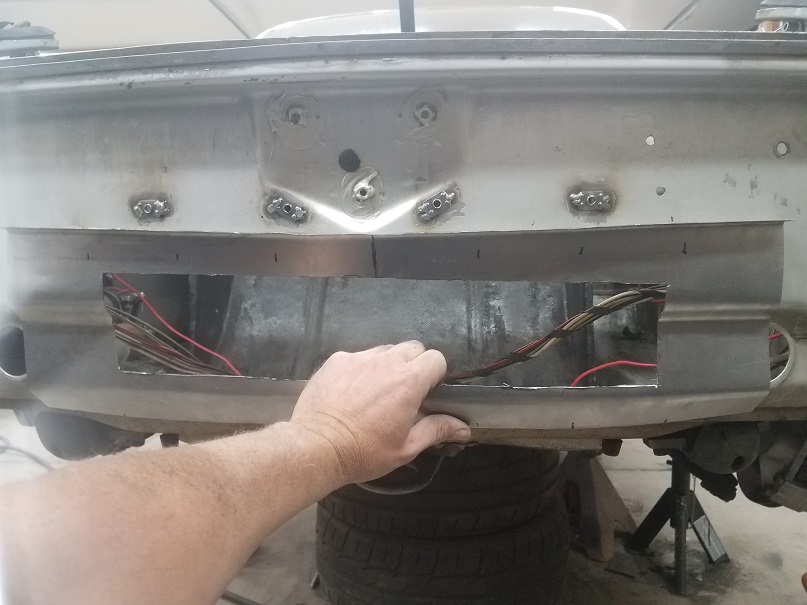

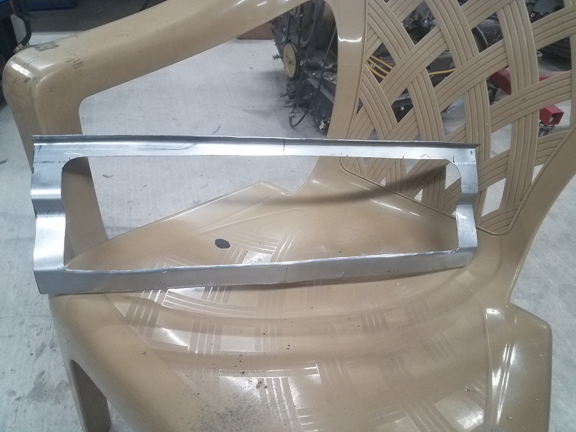

How about them apples?
Really happy with this so far. The hole is very conservative, will cut to match the opening in the tub later. More fitting along the bottom is needed.

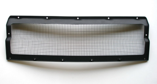

I ordered some mesh, based on Stephen's grill material from Pegasus
Coarse Mesh Stainless, #4 x.047 Wire, 18" x 24" Sheet
