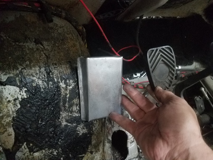

Whipped up a dead pedal tonight. I did this similar to the factory GT part. A little fine tuning is needed and I'll weld up the corners & weld it to the tub. Getting the dynamat off the wheel well is an asspain.

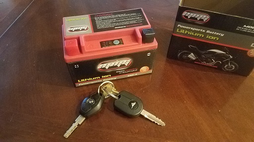

Well, looky here. This thing is tiny and featherweight. I got the same battery (i think) as Andyrew was using.

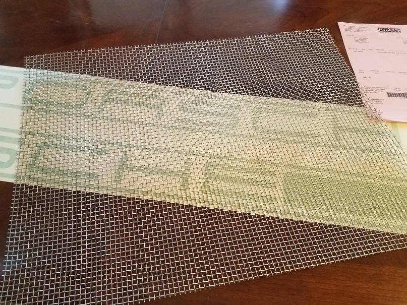

Care package came from Pegasus racing, for the oil cooler grille (stainless). Now to figure out how to attach it to the mild steel frame. I have tried welding stainless to mild steel a long time ago, it wasn't pretty. I am thinking I can drill through the grille and just weld the mild steel front to the back. Can anyone offer some enlightenment?

What about small tabs welded at each corner that hold in the screen without welding the screen to the frame.

That would be the easy button Mark!

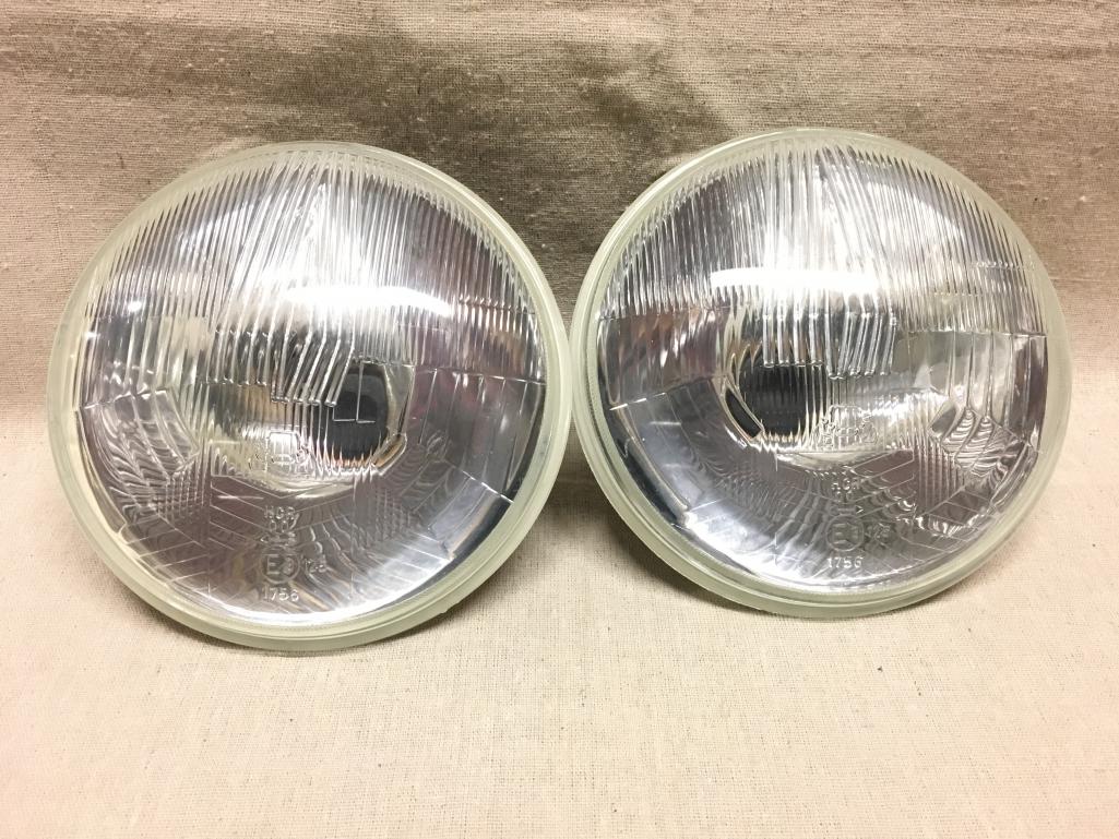

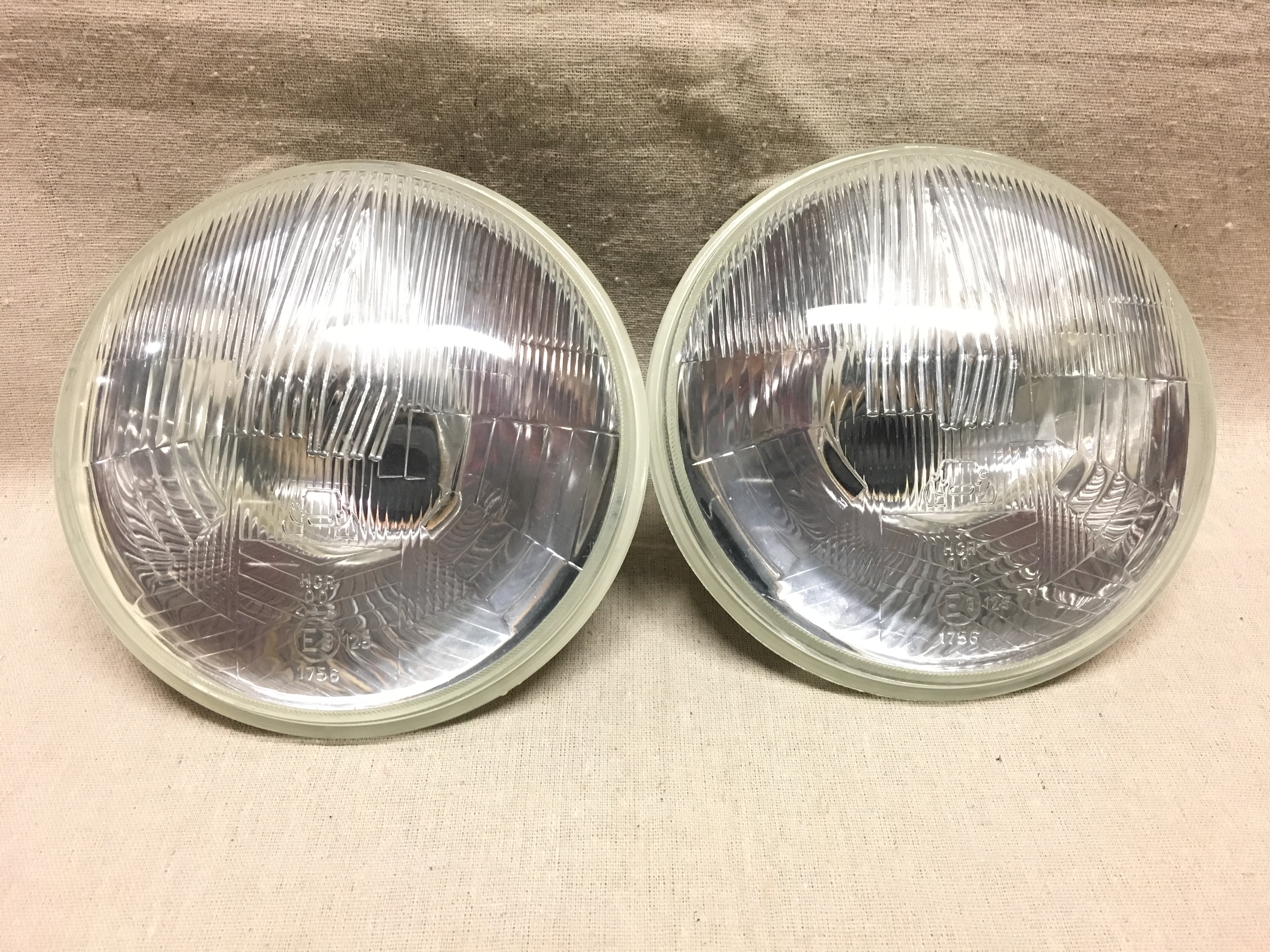

However, I got a set of used Cibie H4's off of a 924. I think they are the z beams. one says DOT and one does not - otherwise the pattern on the lenses looks identical. not sure what I have here, but the price was good.

Travis RE: GT oil cooler grille
http://www.pbase.com/9146gt/oil_cooler_cov..._repro_finished
You may have seen this, but thought I'd post it on the thread anyway. This excellent set of photos document a real GT grille and a duplicate fabricated to match. Couple of points to note:
1) the grille material is not 'woven', it appears to be straight and just 'laid over'
2) the duplicate grille looks to have used epoxy or JB weld to secure the grille material to the frame
All this FYI. Keep posting on the build progress, BTW some great work in there!

Travis the woven looks just fine. I was actually not going to run one at all but this has me thinking I might. From the pbase site it almost looks like it's staggered but maybe straight. Hard to tell..

It does look straight on the pbase pictures, but I like the texture with the weave. Thanks for the link Tony! I have been poking around his site for ideas and totally missed this one. Ben, If I get this done in one shot I should have extra grill material, enough for one more and can send it to you gratis.

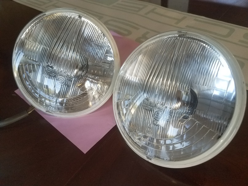

Z-beams look like these
Your set looks more like the standard H4 European pattern with the sharp cut and the kick up the right side. They make a huge difference over the standard sealed beam head lamp.

QUOTE(914forme @ Dec 13 2018, 05:29 PM) *
I think you are right, they were just advertised as Cibie H4's. The ones I have have 19 & 47 on the glass and the top center vertical flutes have more flutes than your picture. I have Hella h4's and I think they are off a motorcycle - anyways they are chalked up/etched on the inside of the lenses. So it was time for a replacement and at $100.00 I don't think it was a bad deal.

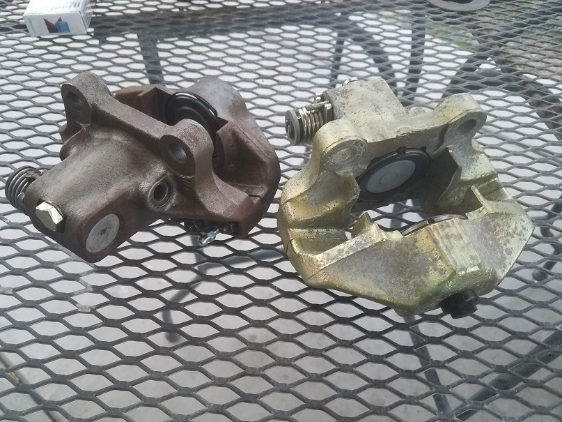

I have to quit buying shit (IMG:style_emoticons/default/laugh.gif) 914-6 rear calipers with a fresh rebuild came in the mail today from another world member.

I do have a set of SC rear calipers in good shape. Also a set of PMB redone 911 rear calipers with the spacers removed (just don't have the pins or spreaders). I saw the 914-6 calipers and couldn't resist.
