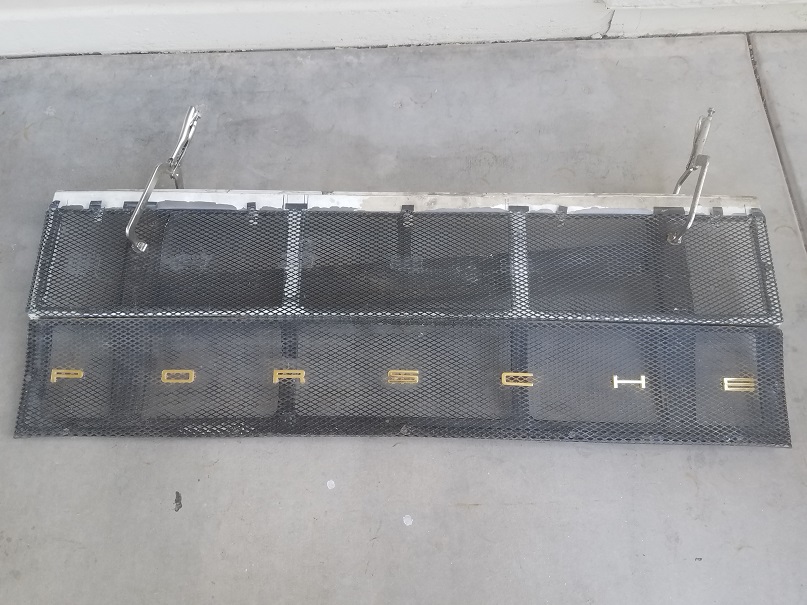

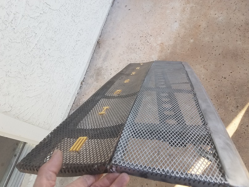

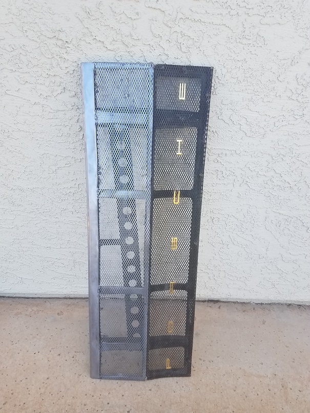

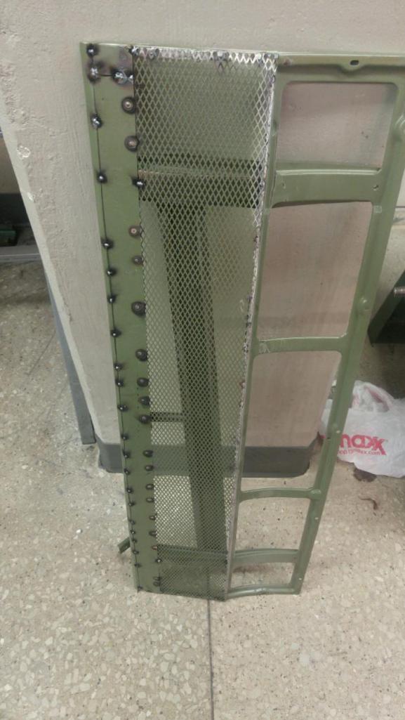

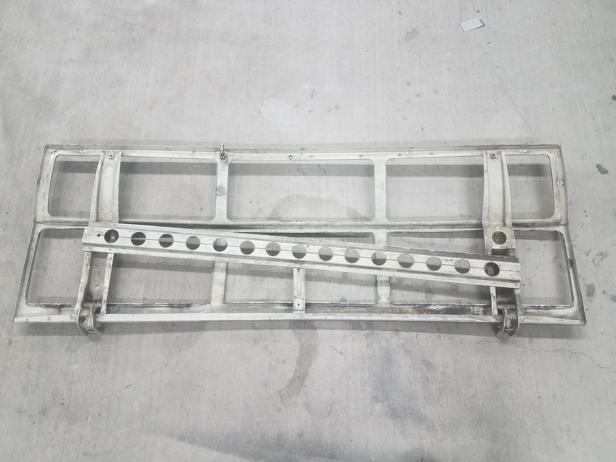

Successfully lightened up the cross brace. I also ditched the mesh support tabs and will pin the back edge of the grille to the flange I made. Anyone know where to get weldable pins?
914forme
post Dec 30 2018, 07:42 PM
Post #323
Posts: 3,899
Joined: 24-July 04
From: Dayton, Ohio
Member No.: 2,388
Do you have another engine grill, I would just cut them off and tack them on, and use the OEM push on retainers.
Or, you make the. Steel stock the size you need, grind a taper if you want to jazz them up a bit, and cut to size, use push on clips, or speed nuts.
The CSOB way, a couple of small machine screws and use some nuts, and loctite.

Travis,
I stole this from my thread but this is my version. Attached Image
TravisNeff
post Jan 1 2019, 08:45 AM
Post #326
Posts: 5,082
Joined: 20-March 03
From: Mesa, AZ
Member No.: 447
Thanks for the pic Ben.
Hmm. Screw the pins, I weld the back grille in place! Also I see that the center supports should have more of a bow than what I have.

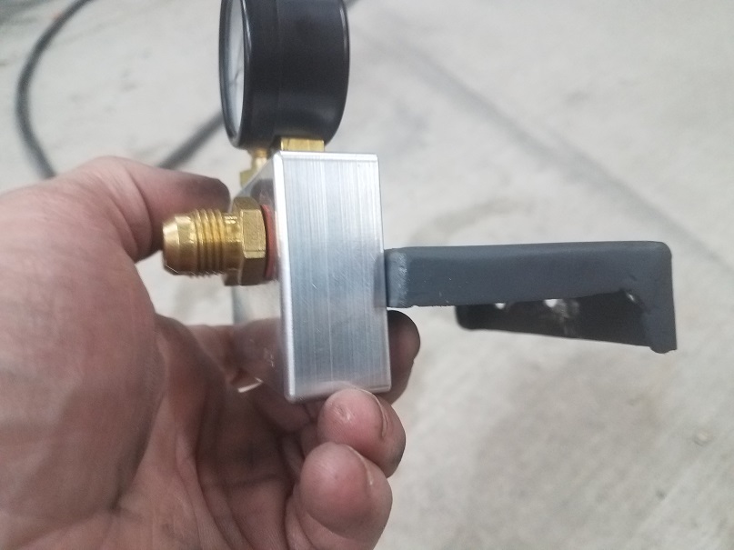

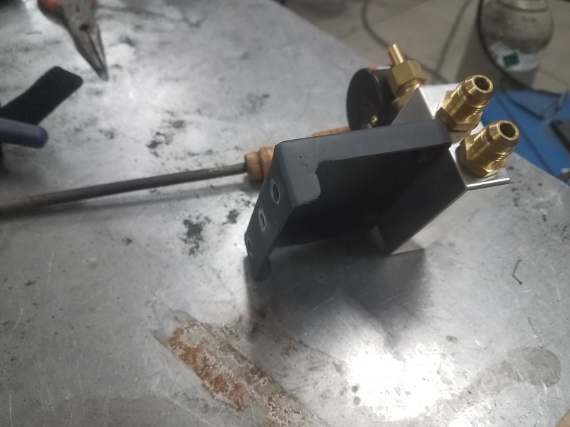

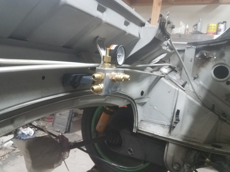

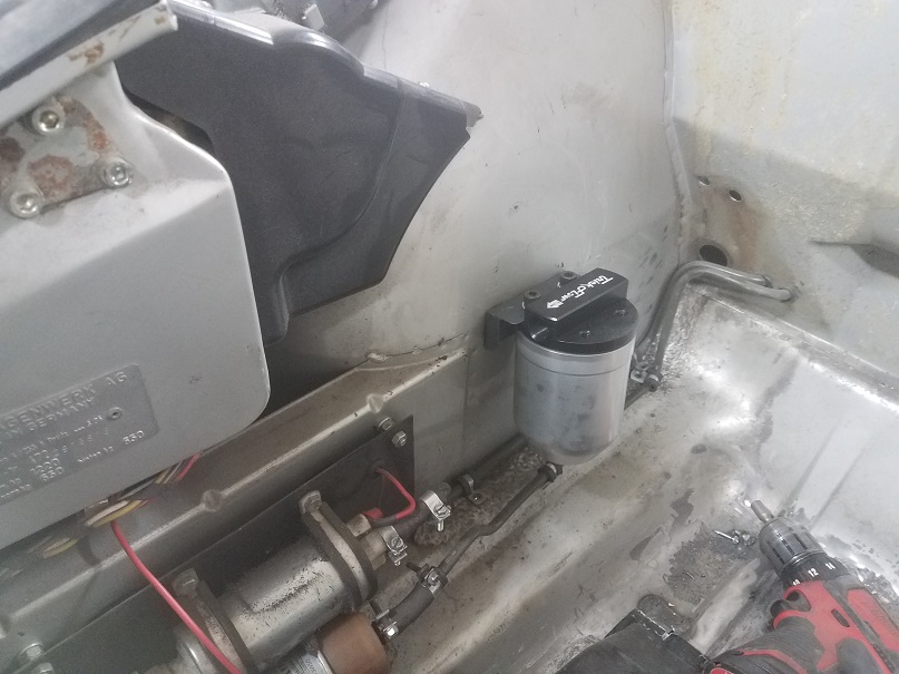

The adventures of bracket man..
914forme
post Jan 5 2019, 07:22 PM
Post #335
Posts: 3,899
Joined: 24-July 04
From: Dayton, Ohio
Member No.: 2,388
Well Bracket man that is a super job
bbrock
post Jan 5 2019, 08:30 PM
Post #336
Posts: 5,269
Joined: 17-February 17
From: Montana
Member No.: 20,845
Nice work Bracket Man! (IMG:style_emoticons/default/thumb3d.gif)

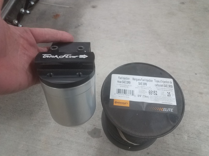

Bracket Man, my hero! (IMG:style_emoticons/default/cheer.gif)
Hey @TravisNeff I really like this set up.
Where did you obtain the filter? I also have the
PMO reg. & gauge. Will be using with Weber’s.
May I steal your idea. (IMG:style_emoticons/default/poke.gif)
TravisNeff
post Jan 5 2019, 10:39 PM
Post #338
Posts: 5,082
Joined: 20-March 03
From: Mesa, AZ
Member No.: 447
@Dion

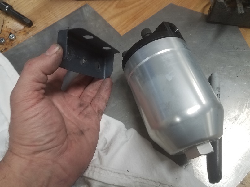

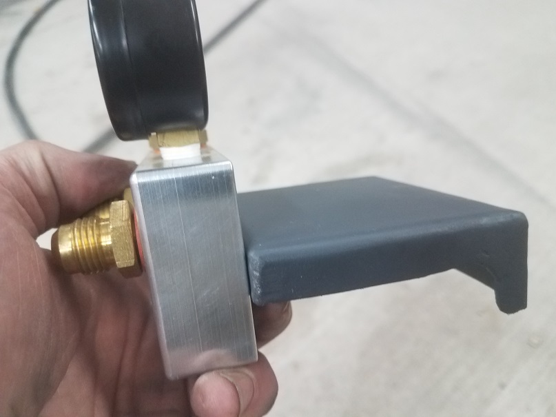

Absolutely! I got the filter from Summit and it wasn't a gazillion bucks.
https://www.summitracing.com/parts/tfs-23006
My mount is right about at the crease in the fender well. I can get the canister off to replace the filter, just barely. I wanted to put it in the engine bay where the OE pump would go and then it would be a super easy R&R of the elements. But OCD set in and I started worrying about the engine bay heat and the aluminum being a heat sink.
The brackets were easy, I was trying to make a battery tray for my mini battery and bent it a little too short. I cut it in half and made 2 brackets out of the scrap, how lucky is that!

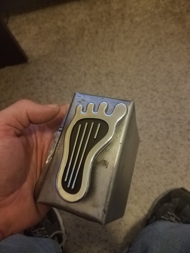

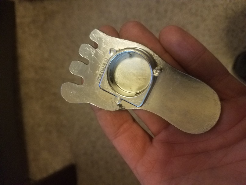

Time to start thinking about the dead pedal again. This has the right amount of ridiculous for me. I will need to cut off the rear attachment piece (it was made for a floor dimmer switch) and figure out how to mount it. It is not magnetic so i can't weld it on.
