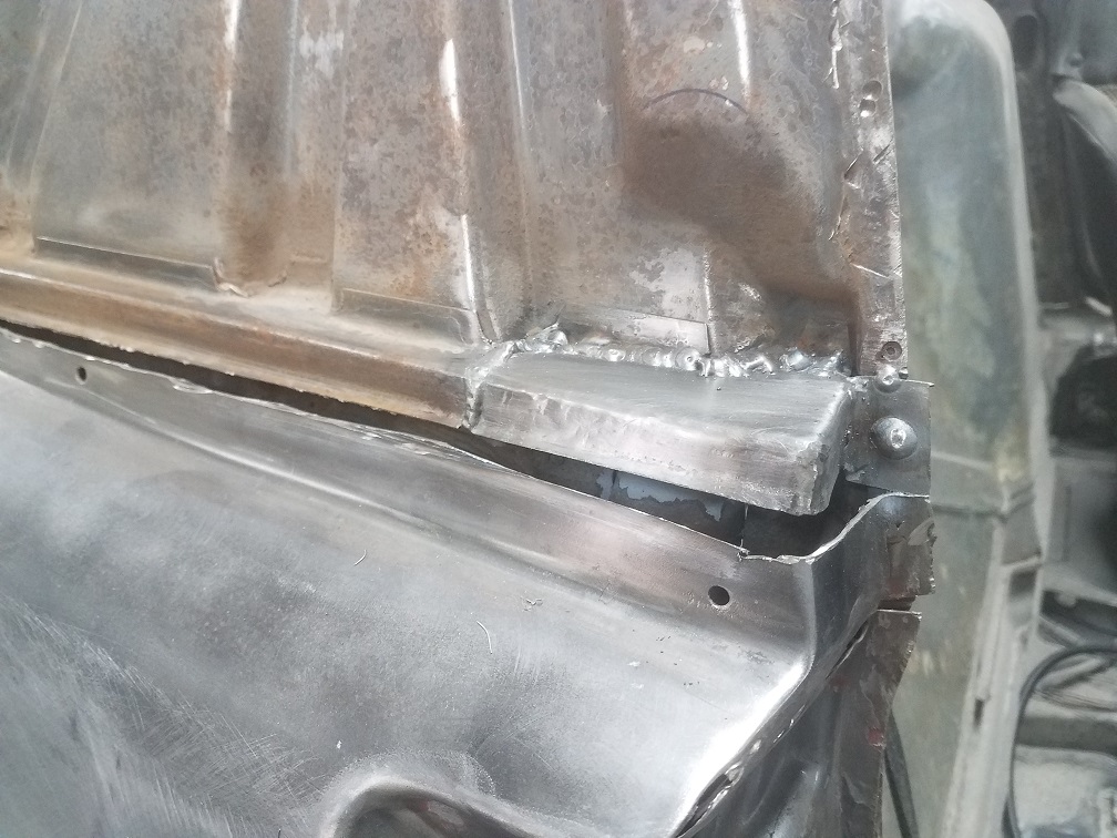

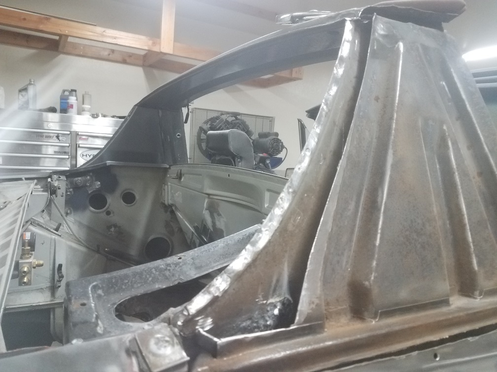

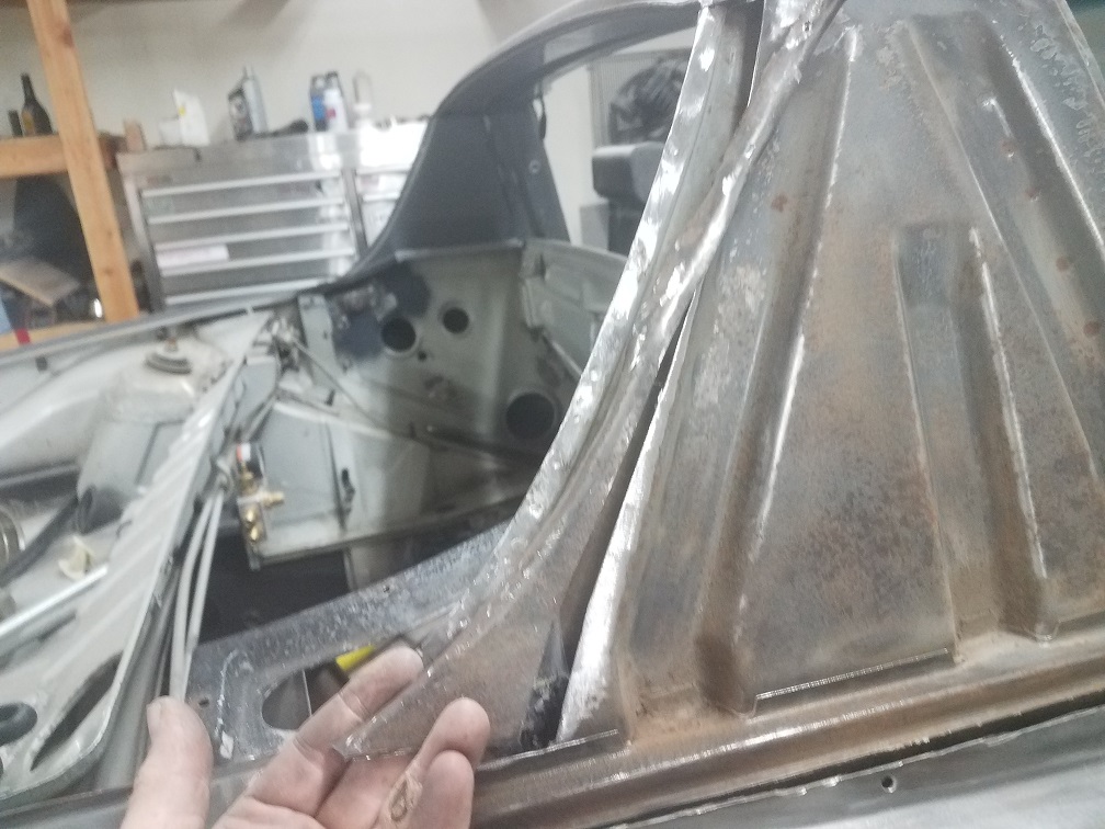

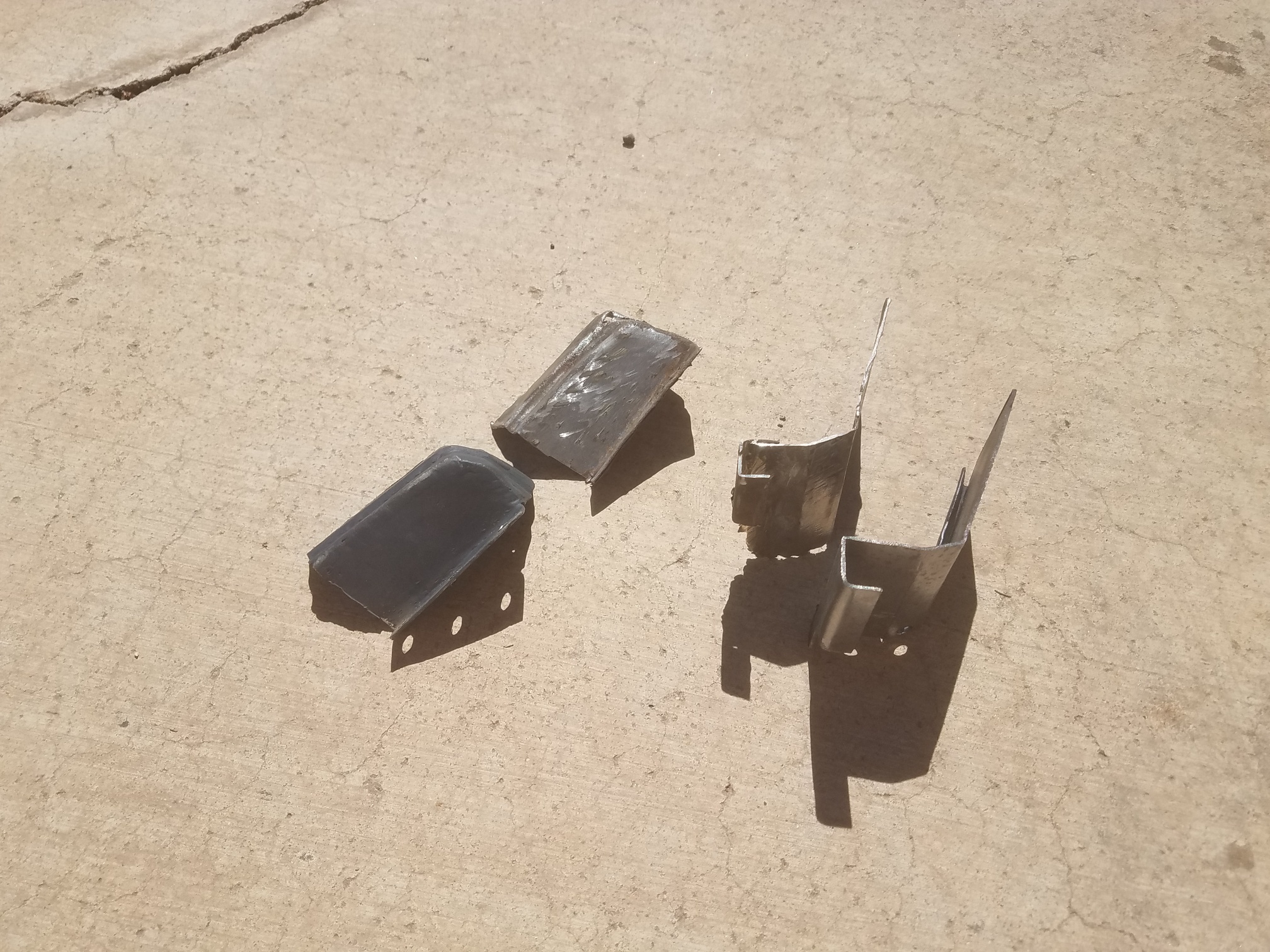

You cannot leave me unsupervised. I noticed that the rear quarter next to the engine grille was sticking out a good 5mm more than the drivers side. So i drilled out most all the spot welds along the top and was able to get the panel close. However, the sail did not want to budge, there was something in the way.
Off comes the sail panel. When they repaired the car they left the flange on the roll bar piece, the old quarter panel and welded the new one on top. While they were digging around they cut and bent the roll bar structure out of the way. So I found that the bottom horizontal reinforcement piece was bent up in the back and that was causing my problem. I heated it up with a torch and beat the fucker back to where it should be.
Then Noticed the front horizontal reinforcement was cut and bent all to shit, so I made a new piece and welded it in.
No to figure out how to make the rear of the roll bar piece. I tried last night and it didn't turn out. I think I will have to make it in two pieces and weld it together.

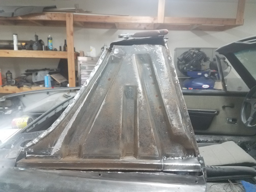

I got the rear part of the roll bar piece in and welded back on the sail. Will share a pic of that later.

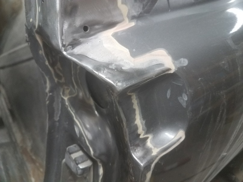

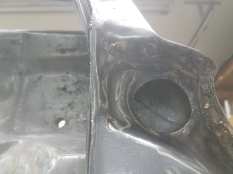

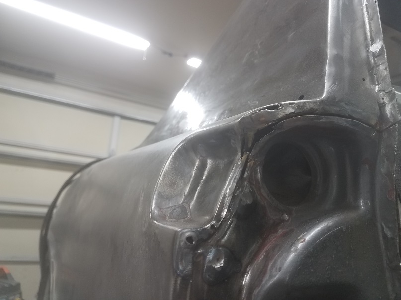

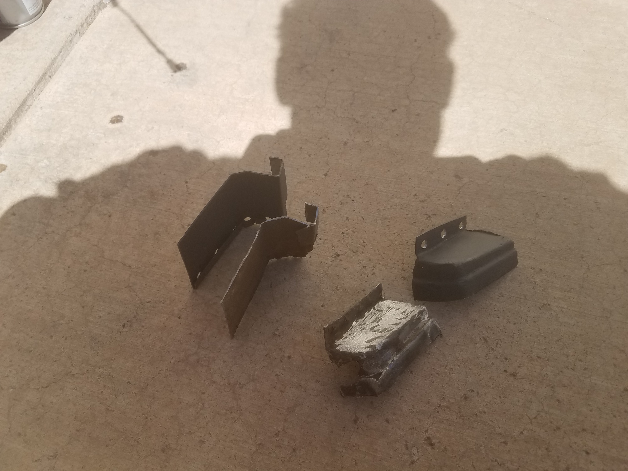

Anyways, take a look at the passenger top of the door jamb. Lots of braze and the metal is like tin foil. I will have most likely cut it out and fab up a new piece, as it will just blow apart if I try to weld it.
So I was there scratching my head and figured I would take a look at how the drivers side was done and I would have a good reference. Well, what do you know. LOTS of bondo! Lessee what's under it? Ugh.

Was the braze around the air vent tubes? If so, you can thank the factory for that. Makes it a pain to work in that area, but makes sense that they did it that way.

Drivers side door jamb had been replaced with a used. they lap/seam welded it on with braze. If they had it in nice and straight I would leave it be. but was done poorly and either I bondo bomb it like before or try and make it right. The door jamb was rust bubbling in a couple of spots where the quarter panel met the jamb, so the problem will come back if I don't get them apart and take care of it. Not sure about the snorkel.
I guess I am going to have learn a few new skills LOL.

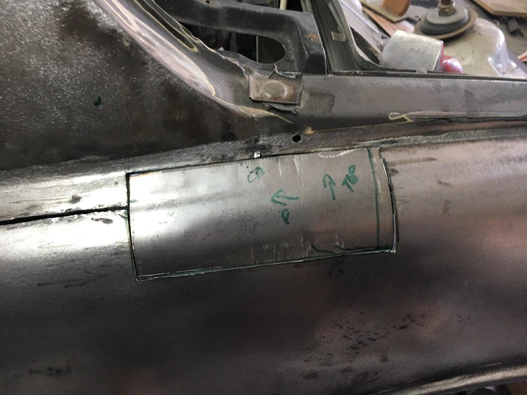

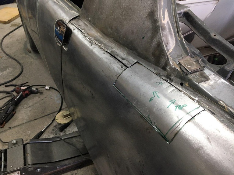

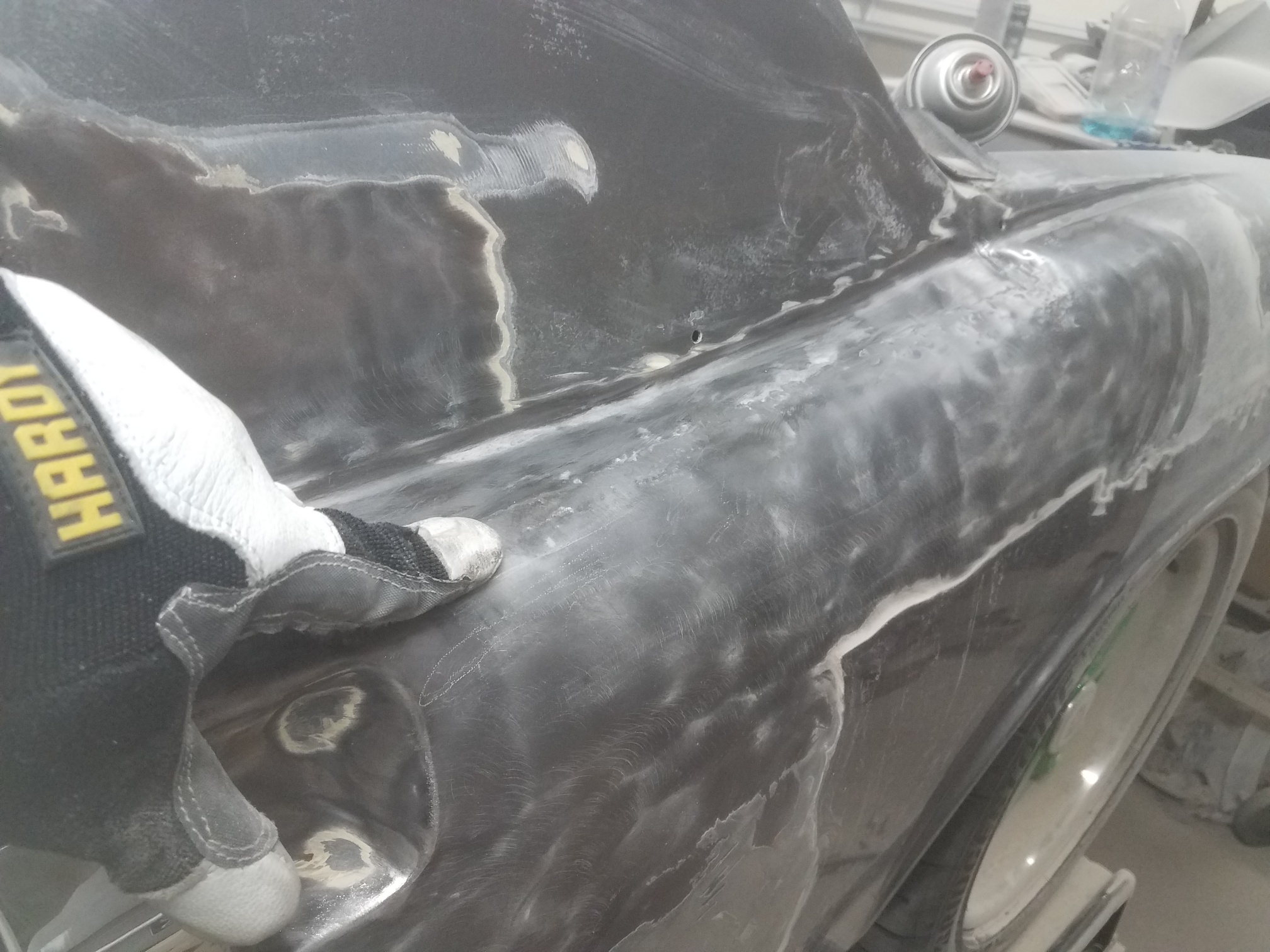

I figured I would take the paint off the edges of the quarters and doors. There was a weird angle on the front quarter. Pieces were rusty and the patch was junk. Looks like the drivers sail was replaced too. 1/4 of bondo to cover the welds.
Spent the morning fabbing parts

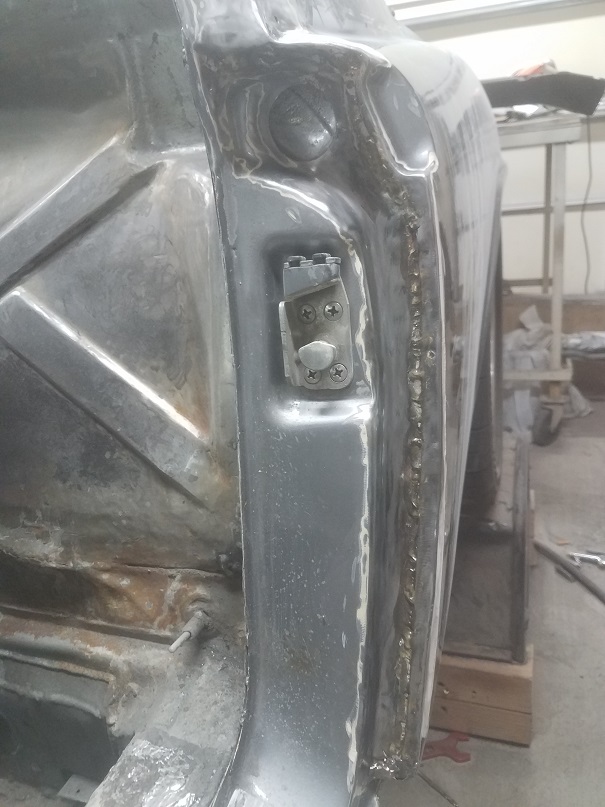

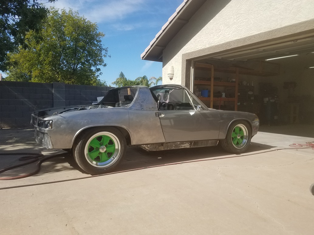

Been busy with life and other never ending projects. Anyways, I got the car back onto the ground and hopefully gives me a little more inspiration to move forward.
I am replacing the passenger door jam, and have to figure out how to massage the door gaps at the back of the door before I weld it in. The passenger side gap is about 10mm at the top. The lockplate is at 1039mm as it should be.
I have a feeling there is more massaging to do on the rear quarter. I hope I don't have to cut it. This has always been a problem on this car, the rear quarter was replaced at some point and they didn't get it right.

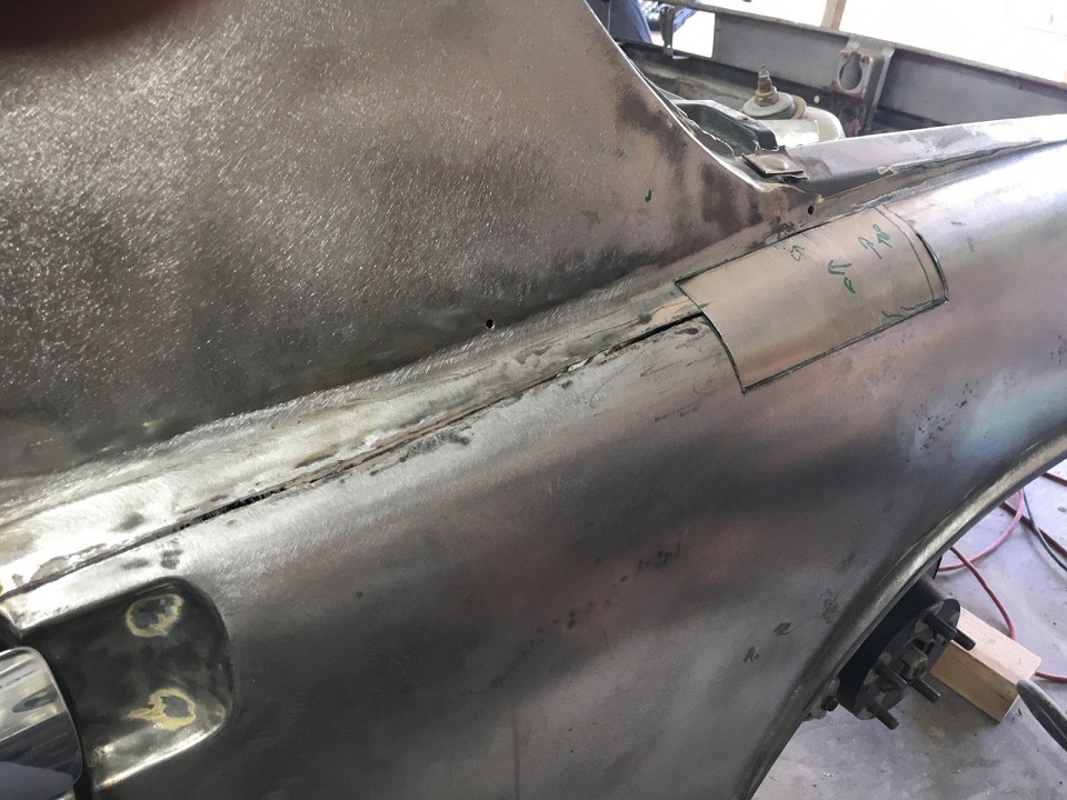

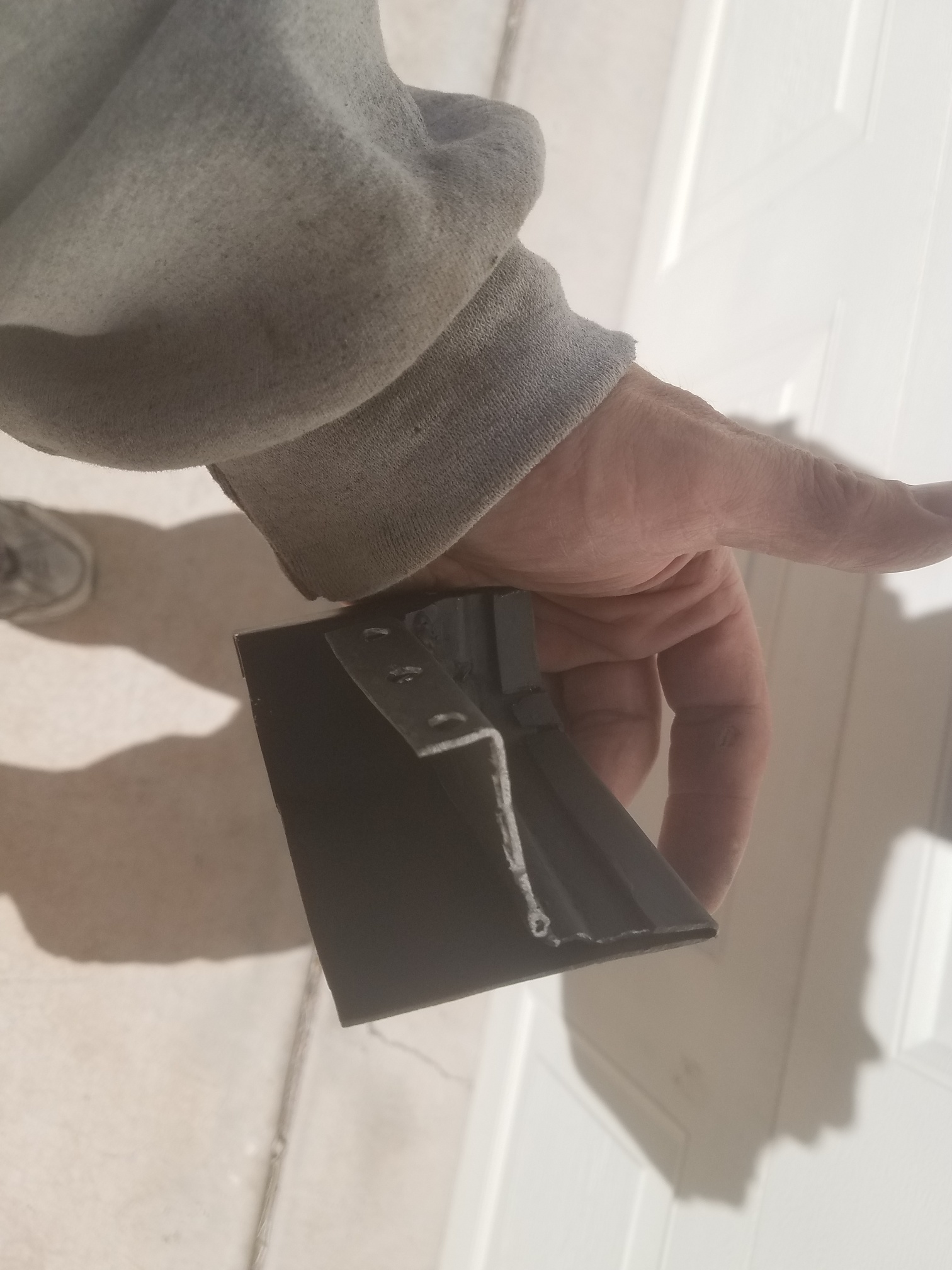

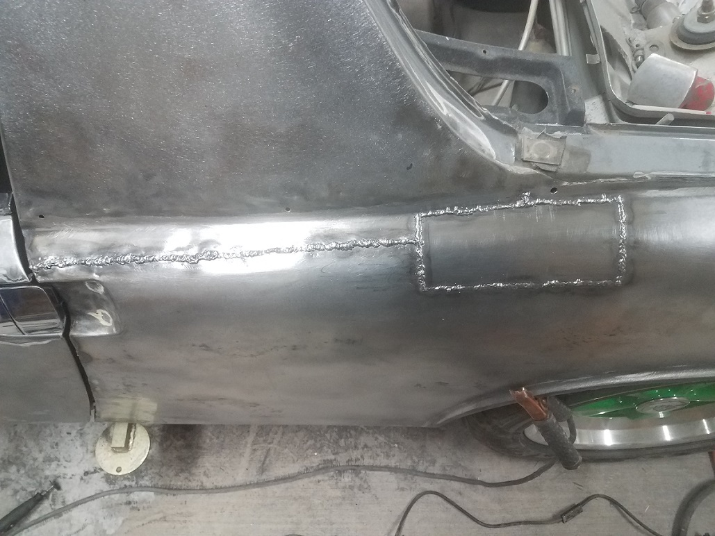

The cutting continues. Turns out the sail panel on the drivers side was replaced at some point. They didn't do a butt weld, but a lap weld and left a good half inch of the sail behind the fender.
I cut through the weld and pulled out the excess metal and will be able to butt weld the joint. To make that fit the way they did, the fender line is a bit lower than the top of the door. I am hoping to get the shape back a little better.
At the back of that joint was some seriously jacked up metal, cut that out and made a patch for it. Put a new door jamb in and tacked it to the body.

TravisNeff
post Nov 10 2019, 10:34 PM
Post #400
Posts: 5,082
Joined: 20-March 03
From: Mesa, AZ
Member No.: 447
Frankensteined. I haven't welded in a lotta months, we will see how this looks once ground down.
