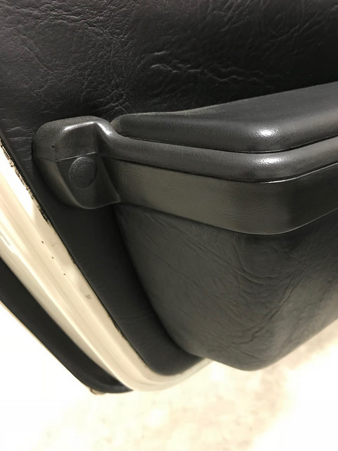

Background: I'm sending the door card from my 1971 to be repaired.
(IMG:http://www.914world.com/bbs2/uploads_offsite/farm1.staticflickr.com-7438-1531701156.1.jpg)[/url]
First remove the two plugs at either end of the door pocket. Fingernails or a plastic spudge will do it. They are a little sticky, I guess so they are less likely to pop out.

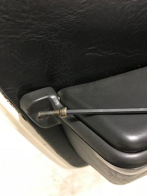

Then, insert an Allen wrench (4mm? Mine are unlabelled!)
(IMG:http://www.914world.com/bbs2/uploads_offsite/farm2.staticflickr.com-7438-1531701158.4.jpg)
orthobiz
post Jul 15 2018, 06:37 PM
Posts: 1,758
Joined: 8-January 07
From: Cadillac, Michigan
Member No.: 7,438

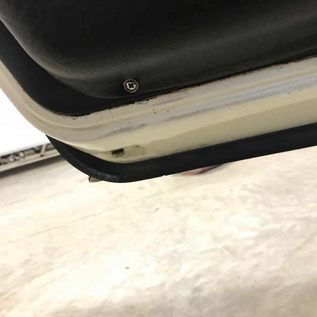

There are three screws at the bottom of the door pocket. Remove all three. Do not be surprised if they don't match! The originals either have a washer or a "built in" washer.
(IMG:http://www.914world.com/bbs2/uploads_offsite/farm2.staticflickr.com-7438-1531701472.1.jpg)
The pocket will now come off. This particular car did not have the spring that shuts the pocket lid. If it's there, you'll have to unhook it from the card.

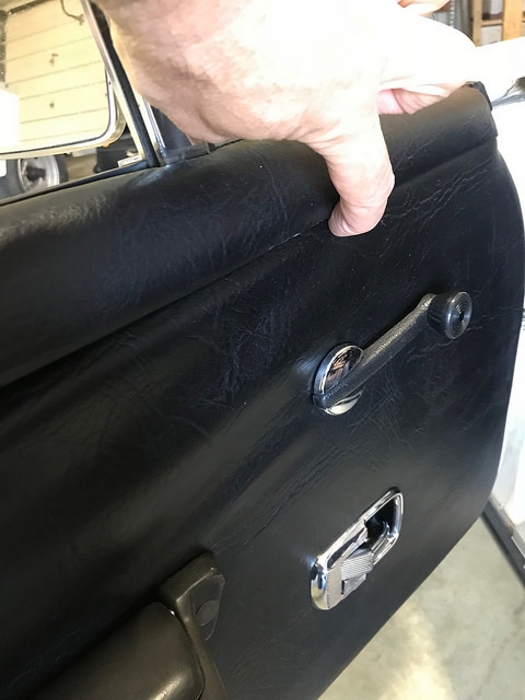

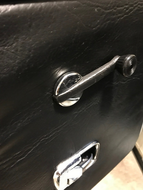

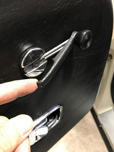

Next, the door handle.
(IMG:http://www.914world.com/bbs2/uploads_offsite/farm1.staticflickr.com-7438-1531701608.1.jpg)

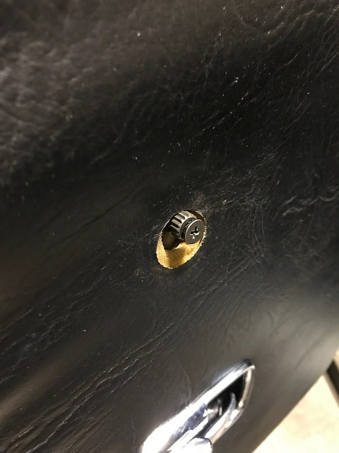

Pop the plastic cover off the round part that rotates against the panel. They vary a bit by year; they have little tabs that snap on, mine came off by hand. A screwdriver there could damage the vinyl! Also, just pull it away enough to get at the underlying screw, overzealous pulling could deform the plastic where the hand knob is located.
(IMG:http://www.914world.com/bbs2/uploads_offsite/farm2.staticflickr.com-7438-1531701473.2.jpg)
A Phillips screwdriver works here. I put the screw back in so I wouldn't lose it.
(IMG:http://www.914world.com/bbs2/uploads_offsite/farm1.staticflickr.com-7438-1531701473.3.jpg)

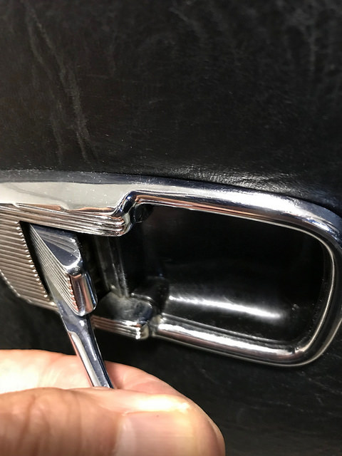

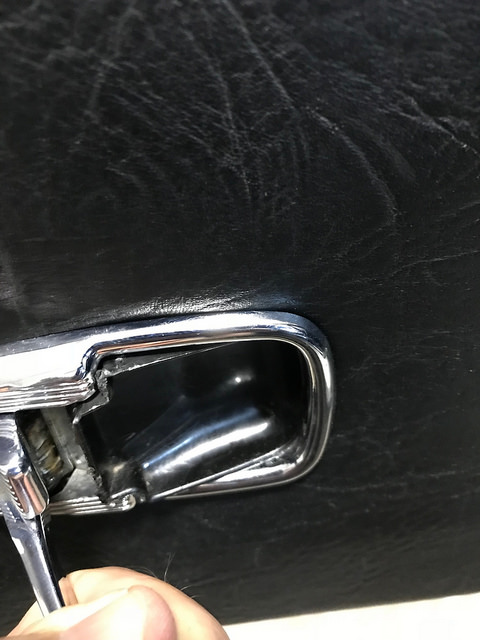

Next, the inner door latch. Notice all the metal and how the later cars are different.
(IMG:http://www.914world.com/bbs2/uploads_offsite/farm1.staticflickr.com-7438-1531701881.1.jpg)
I used a screwdriver to pry the plastic liner out, all the time worrying that I'd break something. Slow and careful and I was OK.
Here it is partially out.
(IMG:http://www.914world.com/bbs2/uploads_offsite/farm2.staticflickr.com-7438-1531701881.2.jpg)

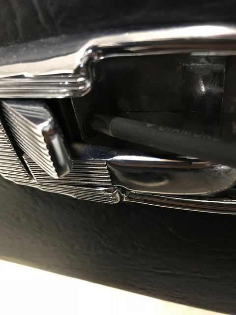

A Phillips screwdriver inserted at the base of the inner metal.
(IMG:http://www.914world.com/bbs2/uploads_offsite/farm1.staticflickr.com-7438-1531701882.3.jpg)
Metal liner is out. I reinserted the screw.
(IMG:http://www.914world.com/bbs2/uploads_offsite/farm1.staticflickr.com-7438-1531701882.4.jpg)

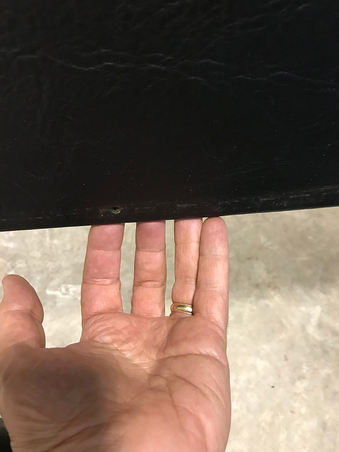

Now for the most daunting task. Popping the panel out of the door. Brad Mayeur says 8 fingers, dig your nails into the space between the door and the card and give it a quick yank. In another post, boxstr says a flat instrument like a putty knife and give a little twist. Both ways will work.

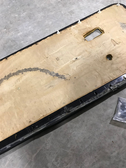

(IMG:http://www.914world.com/bbs2/uploads_offsite/farm1.staticflickr.com-7438-1531702167.1.jpg)

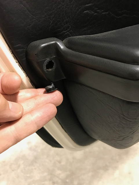

I suggest find a place where your fingers will fit and pull. In my case, a few of the plastic anchors were missing so it was easy to pick a starting point. Then work your way around the bottom and up both sides.
Pull the door card away slightly and lift up, the panel will now come out. Success!
You can see where the bottom of my pane was missing anchors.
(IMG:http://www.914world.com/bbs2/uploads_offsite/farm1.staticflickr.com-7438-1531702167.2.jpg)

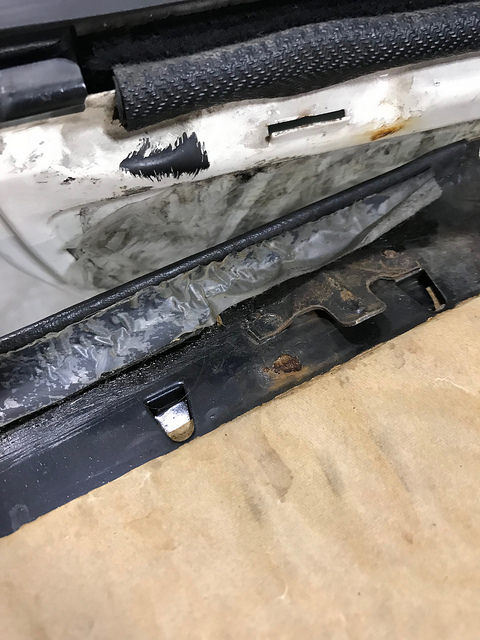

In this pic, I lined up the metal tab with the slot in the white painted door to show how it will eventually go back together. Of course, it's upside down but you get the idea. You'll see it when you take the card off the door.
(IMG:http://www.914world.com/bbs2/uploads_offsite/farm1.staticflickr.com-7438-1531702281.1.jpg)
