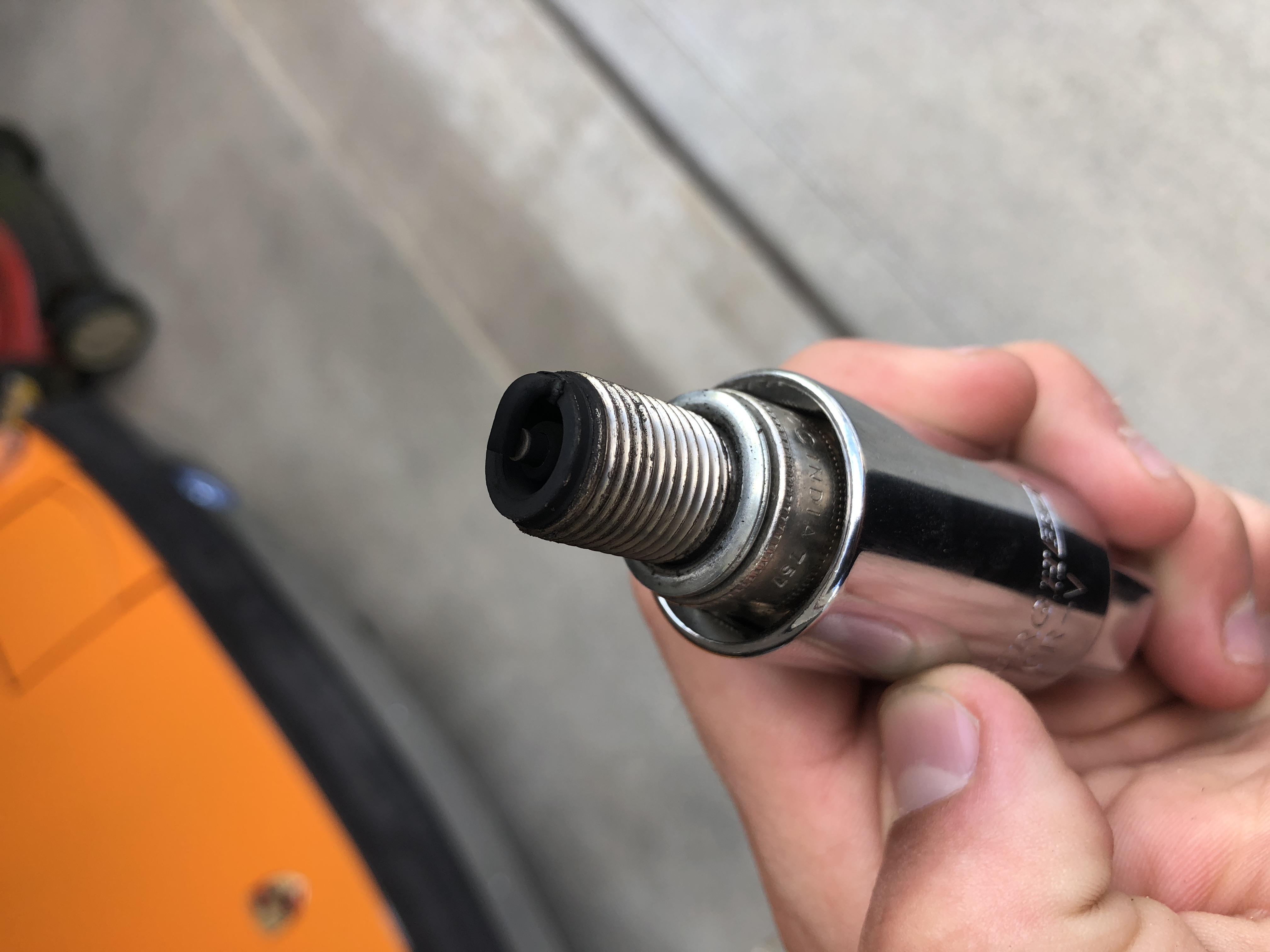

brianp626
post Sep 15 2018, 03:02 PM
Post #27
Posts: 21
Joined: 29-July 18
From: Indiana
Member No.: 22,351
**BUMP** Update, car starts now. Will run and drive but not great. Pulled the a spark plug and they look like this. This is brand new. Lol. Ideas on what would cause it to run this rich? Attached Image
