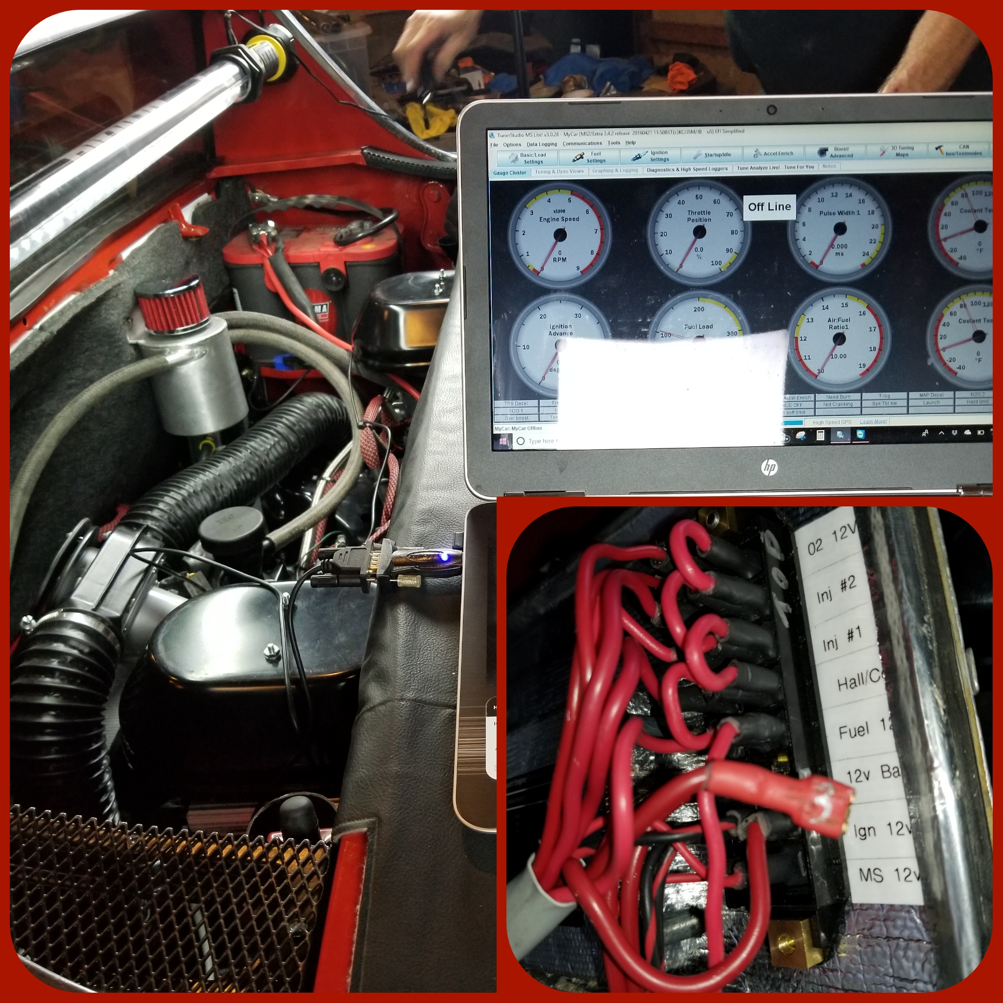

I am running a microsquirt (MS2) system with ITBs and a wasted spark. I am pretty happy with it so far. It has a pretty steep learning curve but we are starting to get all of the kinks worked out. Some of the components have had issues, but I was able to go to the local auto parts store and get what I needed. Hopefully we will be able to get it on the dyno next week for some fine tuning.

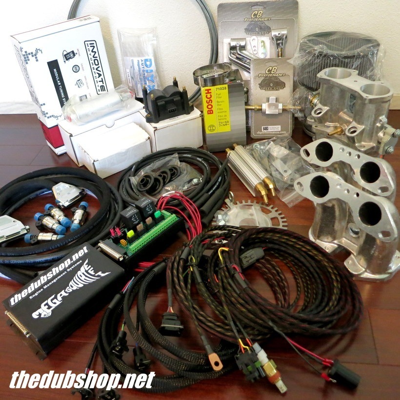

Anyone using this Magasquirt package from the Dub Shop? http://thedubshop.com/dual-throttle-body-f...gnition-type-4/
Looks like a nice complete package but seems a bit pricey.
