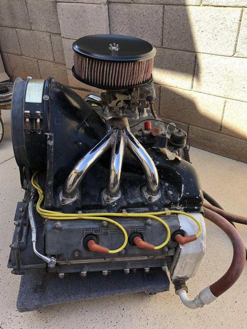

I saw this motor on Hemmings today, I bet one could adapt the Holley EFI to this:
