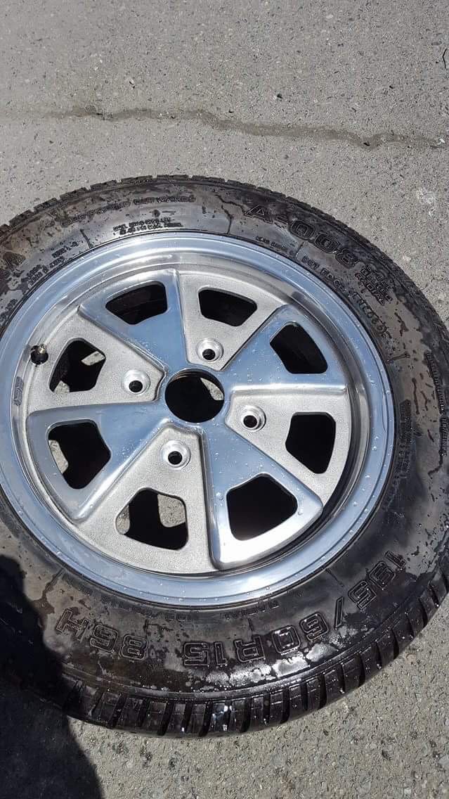

Looking for centre caps for my wheels. Can I use the flatter style caps for these or do I have to use, the cup style?

Only in the back.
The flat caps won't fit the front wheels.
