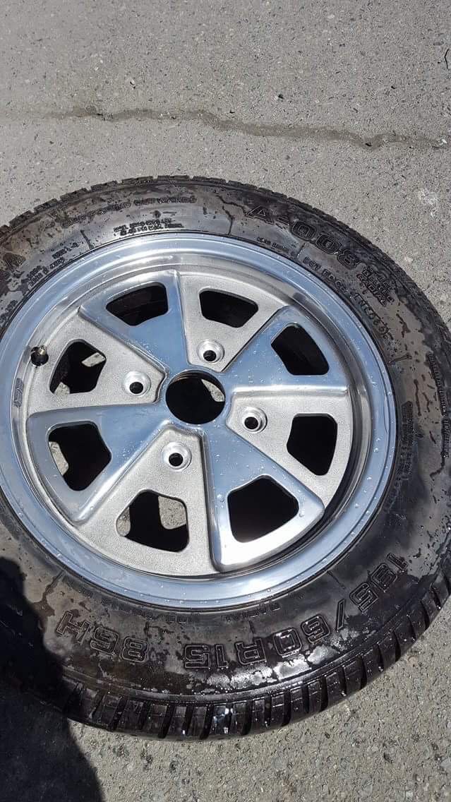

Looking for centre caps for my wheels. Can I use the flatter style caps for these or do I have to use, the cup style?
Valy
Only in the back.
The flat caps won't fit the front wheels.

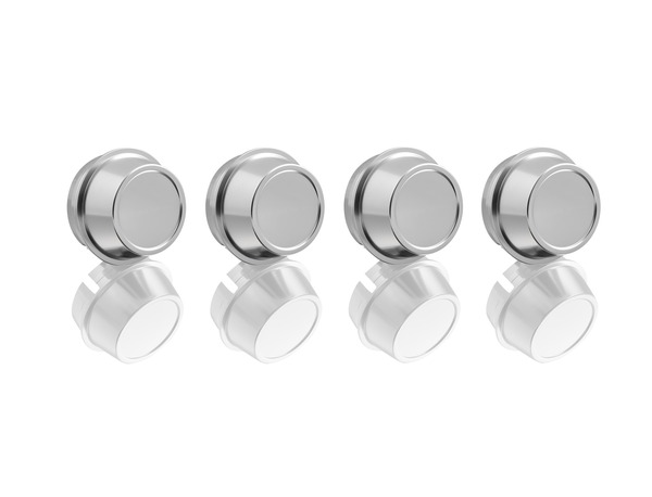

eric9144
914 rubber sells reproduction caps and they're fantastic IMO
$85/set https://shop.914rubber.com/914-wheel-center-caps-914LCC.htm
dr914@autoatlanta.com
Mikes caps fit fine and they are inexpensive. We have his caps and also have highly polished stainless steel that are about the same price. Those three, factory , mikes, and our polished ones are all that fits the factory hole
