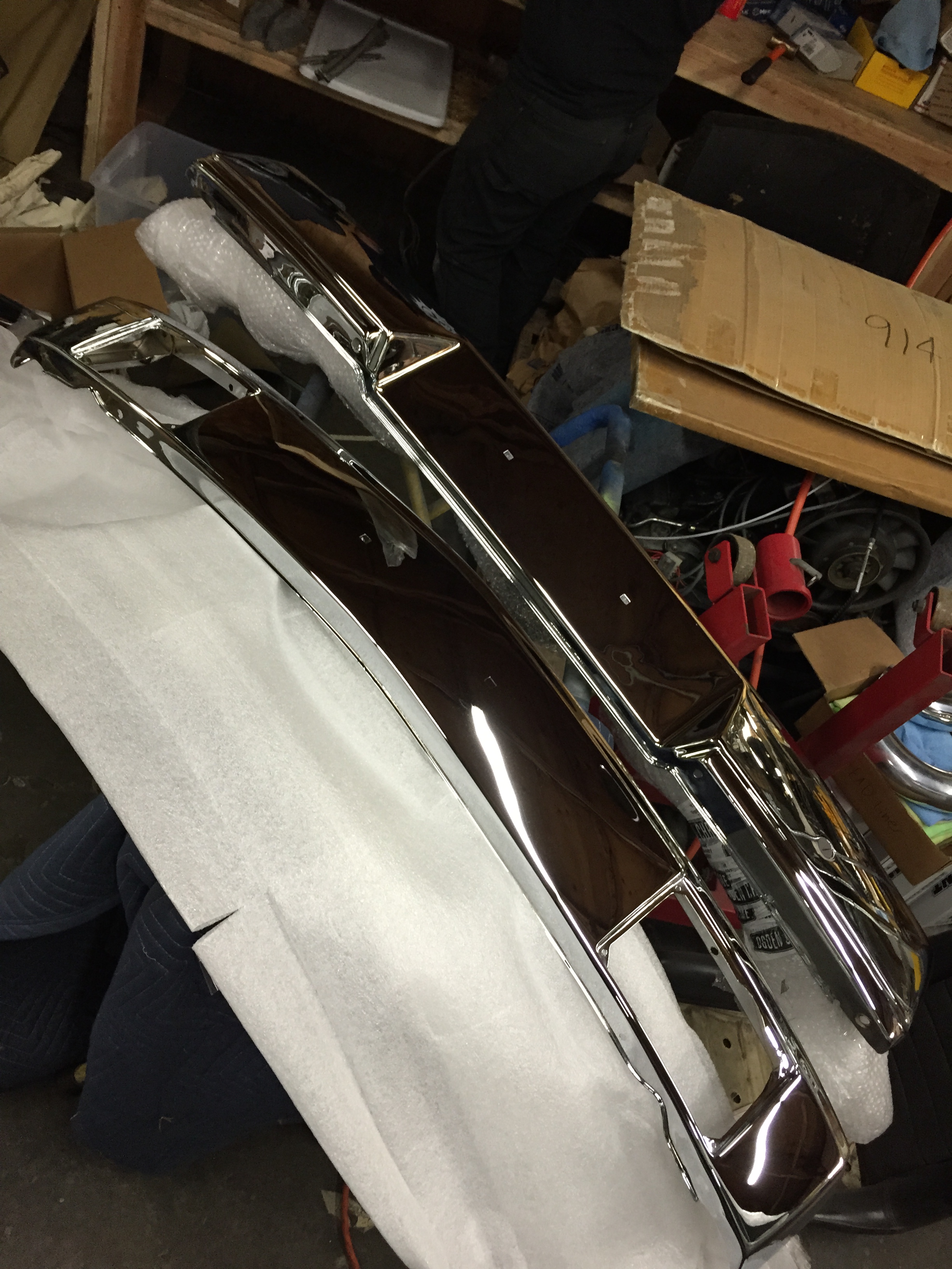

napasteve
post Aug 13 2018, 02:30 PM
914 driving winemaker
Posts: 511
Joined: 2-January 13
From: Napa, CA
Member No.: 15,327
Back in 2014 I bought a set of early painted bumpers here in the classifieds. I took them to Mark/Tim at Original Customs and they filled holes and straightened them AMAP. They then sent them to Ogden Chrome. $700 each for the chrome job. No problems with fit. Note the rear bumper is from 70-72.
horizontally-opposed
post Aug 13 2018, 03:30 PM
Posts: 3,456
Joined: 12-May 04
From: San Francisco
Member No.: 2,058
QUOTE(napasteve @ Aug 13 2018, 01:30 PM) *
^ That's what I'm talking about... (IMG:style_emoticons/default/drooley.gif)
Thanks, Steve!
