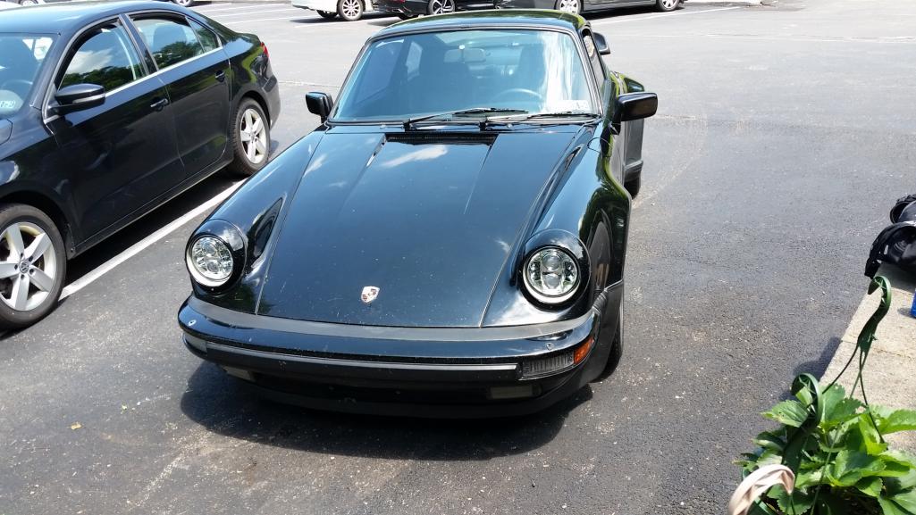

I went with Carmagic (Engelbert; rothaus on PelicanParts) LED headlight for my 930. Engelbert was very responsive to questions and everything fit nicely.
The headlight light pattern has that sharp cutoff at the top between light/no light as many vehicles have today.
The headlights also has an extra wire that can be connected to the running lights for DRL. On the 911 this is very convenient as the running light wires run through the headlight bucket and were a breeze to connect.
The high beams are primarily 4 high powered LEDs on each lamp which lights up everything in sight. The primary LEDs do not dim or turn off when the high beams turn on.

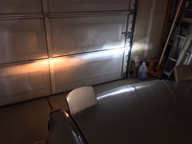

QUOTE(Chris914n6 @ Aug 14 2018, 06:48 PM) *
If you really want LED then you need to get the whole unit. There are good rated headlights on Amazon down to about $100/pr.
My problem with the LED bulbs (914rubber) is they glare like high beams are on. I know from the last rally it sucks to be the 914 in front. Adjusting the HL down shortens the throw so it's kinda mute.
I put in HID retrofit bulbs. At least the geometry matches the reflector and it shows on the road as the pattern didn't change. Also super bright and lower amps. You need a good quality E-code (European) sharp cut off housing. (Bosch/Hella/Cibie) The Chinese made ebay low buck special won't cut it.
I really need to take a night to do the comparison photo thread now that I have the LED bulbs to include.
Here’s my comparison.in the garage. Pattern looks identical at this distance.
