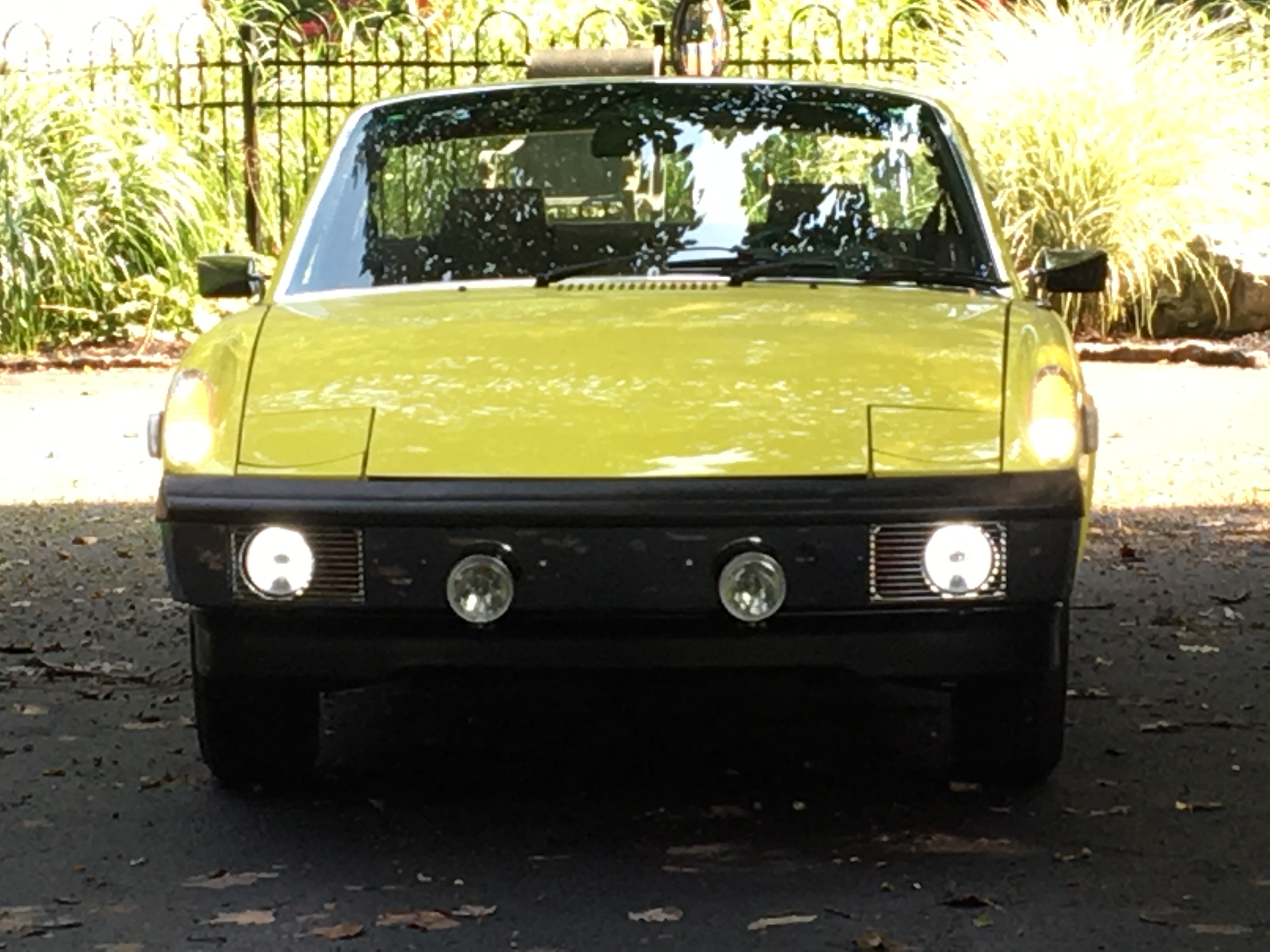

While my engine was gone for the rebuild I was bored so I made up some led bulbs for the fog lights to match the parking lights from spoke. I think it turned out pretty good for a daytime running light look. They are not bright as I selected a 35w equiv. led.

Looks nice Ralph. Did you get the transmission sorted yet? Never mind just saw your other post.

Awesome! I am thinking of doing this as well. Can you share where you got the LED lights from and how you convert the fog light housing to fit the LED.
Thanks.

I thought I took pics but can’t seem to find them. Anyway I removed the bulb and cleaned out the stock bulb housing. Picked up a 35w equivalent from super bright led, need to find the part number, and fit it to the original bulb housing with clear silicone and let them set. Installation was pretty standard from there. They go in pretty much like stock. Not sure how they will perform as a fog light but the intent was to use them as a DRL.

Great idea ! I would like to convert late fog lamps to LED
