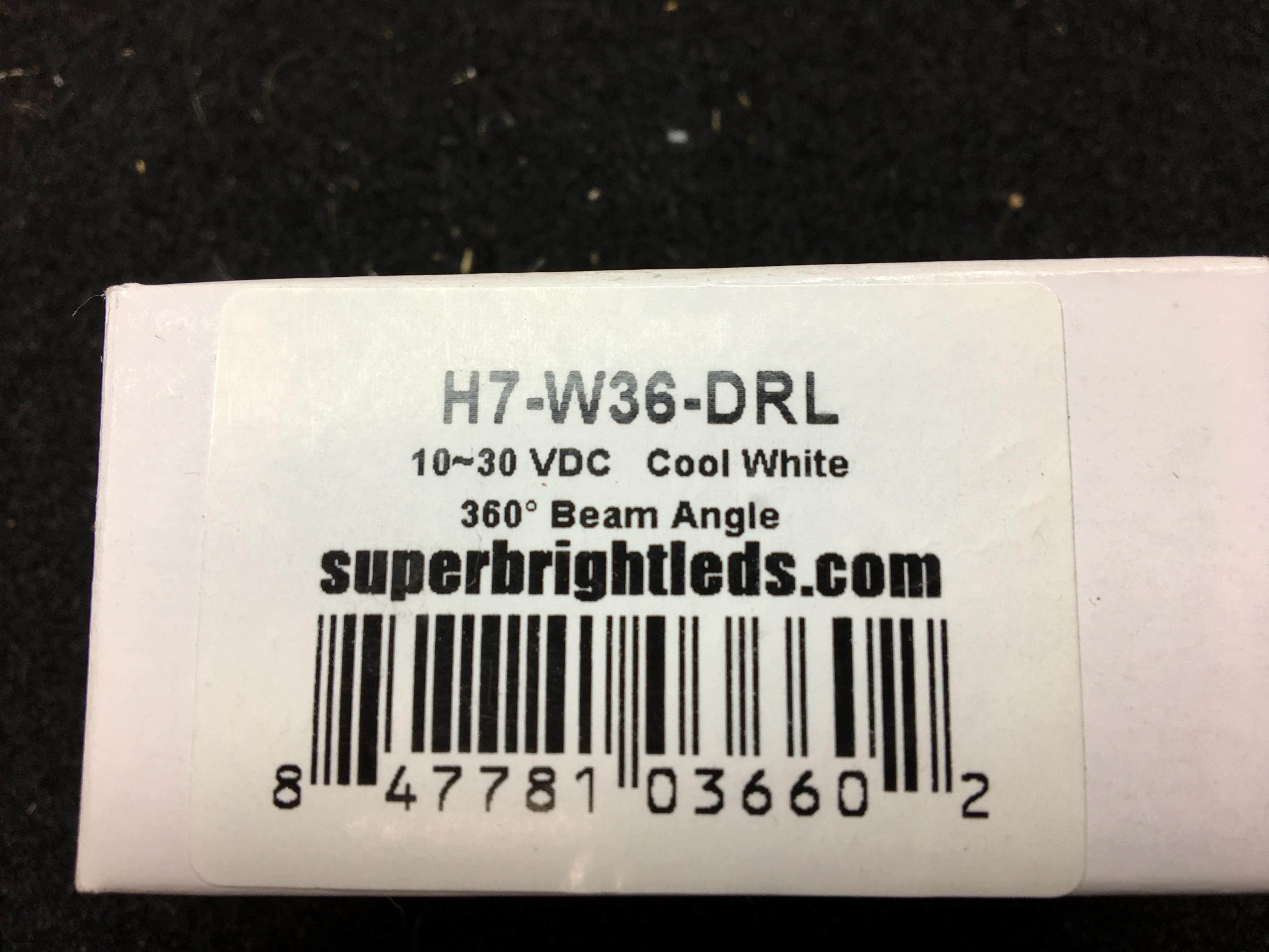

I thought I took pics but can’t seem to find them. Anyway I removed the bulb and cleaned out the stock bulb housing. Picked up a 35w equivalent from super bright led, need to find the part number, and fit it to the original bulb housing with clear silicone and let them set. Installation was pretty standard from there. They go in pretty much like stock. Not sure how they will perform as a fog light but the intent was to use them as a DRL.

Alright, you lost me there. So the new bulb base is a smaller size and it is glued in with Silicone? I didn't find the LED equivalent bulb at Super Brite but then again I'm not that bright myself. av-943.gif

rgolia
This is what I used. Base is smaller than stock. Click to view attachment
